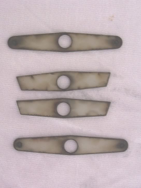

Ok, since the complete kit doesn't exist yet, I will be building as Glenn sends things to me. At this point I have the parts for all the tail feathers, the scale hinges, control horns for the tail, the seat and the sub-wing. What I'll start with is the control horns.
These are the parts for a horn, the material is G-10 or FR-4, you have two inner pieces and to outer. As you can tell they are laser cut, so I used 250 grit sand paper to get the char off and rough up the surface. This is the first time that I have used this material and found it quite easy to work with and strong.
I next took a dowel, wraped some wax paper around it and lightly clamped it after making sure everything was lined up. Oh yes, you will notice that the large hole is offset a little so care must be taken to make sure of proper alignment. This offset is for adjusting for the thickness of the hinge material. The thinner side goes forward. I then used thin CA and let it wick between all layers. This is the way I did it, you may have a diferent method.......whatever works best for you.

Once glued then you can sand to an airfoil shape. Be careful not to go too far out so as not to weaken the tabs on the end. You can make them look like they were welded on like the real ones if you like.
For shaping I used a coarse file and sand paper. While it didn't really take that long to do three of them, I can see where a 1" belt sander would really shine.........Gotta get me one of those.
Here they are finish, well almost. When you paint them the little file and sand marks really show up, so will go back over them with finer paper and repaint.

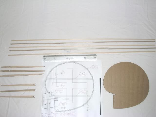

Here you see all the parts to make the rudder. You have the three balsa and two ply strips that you laminate to get the rudders outer shape. They are soaked and glued (I use Titebond) around the cardboard pattern.
The two ribs get laminated from two balsa and one ply each. Then you have the carbon fiber rudder post.
The twelve inch scale gives an idea of the rudders size.

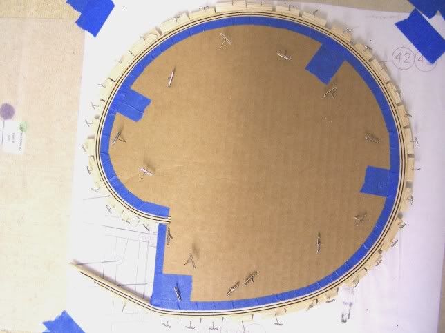

Here's the two rudder ribs after glued.
Using the provided cardboard pattern, (two pieces taped together) The laminateing went rather quickly. I put a cuple inches of hot water in the bath tub and let soak for about 15 minutes. I used Titebond for the glue.
I pinned blocks all around the rudder and let dry over night.

Here's the rudder with the ribs and post tacked in place. need to do more sanding to get the proper size radius.
Also did not glue the bottom of the post as a hinge and control horn need to be located and then another hinge at the bottom of the post.
Hopefully I'll get the lighting better for the photo's.
Next thing is to make the hinges with material provided.
Del

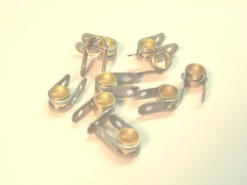

Here are the parts for one hinge, soft steel strap that needs to be bent in a U shape (laser cut), a 11/32 brass bushing that will go inside the strap and a locking color for each side. They will be pinned through the post.
Next you see the strap clamped to a 11/32 steel dowel. Make sure you have it centered and just use your thumb to roll the strap around the dowel. It forms very easy.
Del
Del

Here's a couple of straps bent, you can see how the brass bushing fits in it nicely. I also tapered one end of the steel dowel a little to help shape the rebend later.
Del

Glenn provides a piece of 1/4 ply with a notch on one end. You can glue a piece of 5/16 dowel on each side of the notch.
I used an old screwdriver, ground a radius on the end and that's what I used to tap the rebend strap down. After that I used the steel dowel that I tapered a little on one end to tap down through to make the correct size for the brass bushing.
And here we have a finished hinge. You can eather CA or solder the bushing in the strap.
Only ten more to go.
Del

I got a couple emails asking for a little more info on the hinges. It is really a lot easier than one might think. Once I did the first one to figure out how I wanted to do it, I knocked out the rest of them in about an hour.
The tools are very simple, nothing really special, just mostly things that Joe modeler would have around the average building shop.
First the ply rebend fixture, all you do is glue the 5/16 wood dowel on each side of the slot. I did have to sand the slot width out a little. I used an old Craftman 1/4 screwdriver, ground a radius on the end that closely matches the brass bushing radius. It just has to be close, the 11/32 steel dowel will give it it's finished size and shape. I also ground a little more taper on the steel dowel to make tapping it through the hinge easier. A small visegrip to hold the strap while forming it around the dowel.
The only other tools I used was a vise to hold the fixture and a small hammer.

Here is the strap on the fixture (not shown is a clamp holding the bottom of the strap), and useing the screwdriver just tap the center strap down, (the hinge comes off easy so you can see how much further down you need to go. You do not want to tap with the hammer too hard as the strap might bend off center some.
Here you see the dowel tapped through the hinge to size and shape it correctly.
Join Date: Oct 2003
Location: Hamilton,
OH
Posts: 1,141
You can see here how nice the dowel sizes the hole, the bushing fits in very nicely.
Here's the rest of the hinges.

After I finished the hinges I decided to solder the bushings to the straps. I did four of them, then checked to see how they fit on the carbon fiber shaft. A couple of them evidently warped a little from the heat as they did not slide easy, so I will probably CA the rest of them to avoid that happening again.
Next back to work on the rudder now that I can locate the hinges and control horn.

A thought – mayhaps you’d want to solder the brass to the steel strap while its held in a pin fixture – that would keep everything square, and prevent distortion. Another thought that occurs is wondering if this wouldn’t be a good application for that JB Weld schtuff?

Hey Del - Your not wasting anytime with the parts.
Also, you figured out the hinge pieces making some really nice parts. Your making it look sort-of easy. It took me a wee-bit to figure all that out. Ok, a few beers were involved. I do agree with you that gluing the hinge to the brass is the way to go. To me it's simpler and quicker; plus the steel basically welds to the brass tubing. I guess I better get some more parts up to you keeping this build-along moving. Your parts are looking real good - Glenn

OK, now we'll get back to the rudder. I did some more sanding and shaping so when it's covered it will give the illusion of a steel tubing frame.
Glenn provides a lenght of 7/32 brass tubing which you will slide all the way through the carbon fiber post. Use some pliers and flatten the end some to match the thickness of the frame. I did that about an inch up from the end in a tapering fashion. You then notch the first balsa layer and glue both ends. I used thick CA.
I then layed the rudder back on the plan and marked the location of the hinges and horn on the post. Slide one of the locking collars up to the top mark. I put a small CA tack to hold it in place, with a center punch, very lightly mark the center of the collar and drill a hole all the way through. I used a #55 drill. Then put one of the provided brass brads through the hole, snip off the excess and a small drop of thick CA on each side of the brad. You can now slide on a hinge and another collar, mark, drill and pin it. The hinge is now captured between the collars and will rotate on the rudder post. Make sure the second collar is NOT tight against the hinge so it turns freely.
Next slide the horn on to its location, (remember that the hole is offset, make sure that the thin side is to the front), making very sure that it is square with the post and glue. I tacked it with thin CA then went around the post with thick. You can now glue the bottom of the rudder frame to the post and add the gusset for a little extra strength. You then locate and pin the second hinge in place repeating the same procedure as the first one.
