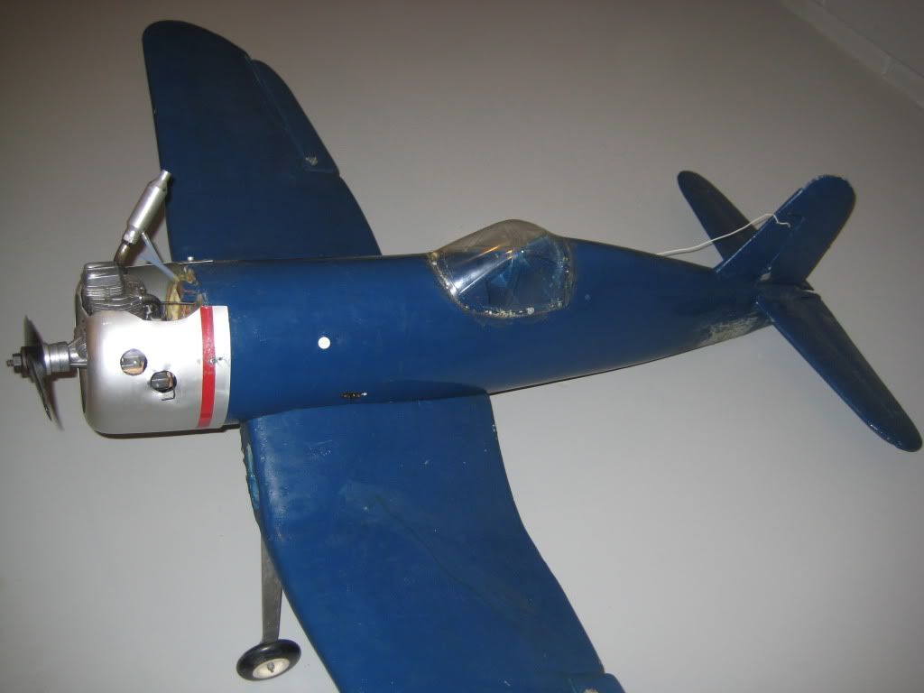

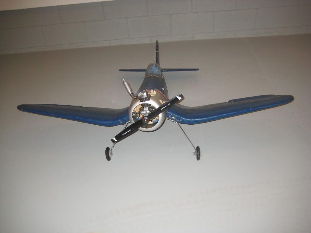

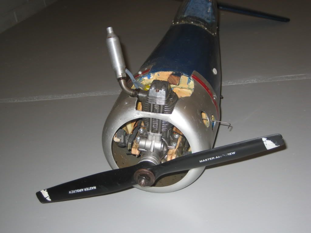

Sure do miss a couple of the shops in Denver for that very reason. These guys were modelers/builders from way back and there wood supply consists of nothing short of being able to build a small, full scale, yacht. If you grabbed a piece of wood that they wouldn't use themselves, they would snatch it up and get you a new one for free just because it was their. Oh yeah and they only accepted cash, no credit cards, no checks. Talk about old school.. In fact all the wood that had been replaced for this build, and there was quite a bit of it from a flood that went from my 2nd floor clear into my basement, came from their. I know it isn't a Royal kit but neat in it's own sense.
Shane

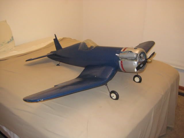

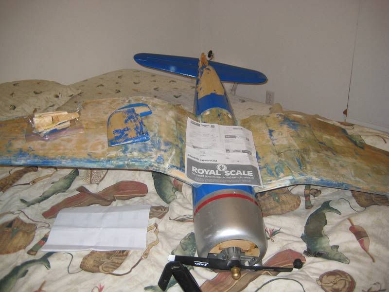

Heresmy royal corsair as it sits today with an o.s. 1.20 four stroke surpass.

Are those 2 separate planes or the same at different times?

same plane at 2 different times. When I got her She was covered in monokote and had an o.s. .61 fx. The covering was old and wouldn't iron down so i stripped her and glassed theplane. First time glassing. I made the mistake of using cloth for doing body work on cars because I could get it in bulk. Should have used 3/4 ounce cloth. originally probably weighed around 6 pounds with engine and electronics but now weighs 13 and 1/2 pounds. I'm going to use one servo for each aileron due to slop in the bell cranks, and will be building a laser cut royal corsair from a local kit cutter. Also if I wreck her I have nothing to lose as a fellow club member and friend of mine bought it last winter at a swap meet airframe only for 40$ and once I found out it was a royal I traded him a zenoah 38, 68" pitts bipe, and 88" big stick for it. I'v got around 50$ invested into it. she will be maidened this spring.
