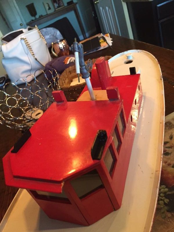

The first one I am overhauling is the fireboat. The first question I have is the standard MEPS motor any good? Should I upgrade it? If so, to what? I plan on removing the mechanical controls and using a ESC with BEC with the existing motor. What ESC is a good economical one? Also, Ive attached a pic of another MW Fireboat with question about some fittings on this.

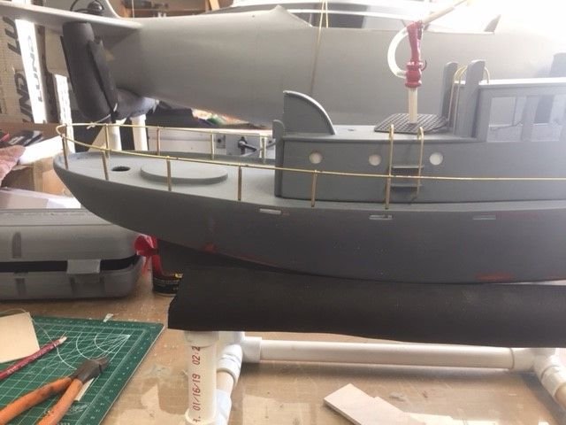

I have been out of town for a while, so my progress isnt as far as I had hoped for. Ive added some color, painted the interior, fitted stack, radar hand rails etc. I hope to get some color on it this weekend. One issue Ive noted is that my father did not seal the inside of this boat. as the aft and forward bulkheads are solid, I can only get so much of it sealed. What is a good sealer? Poly, epoxy, or just clear enamel?

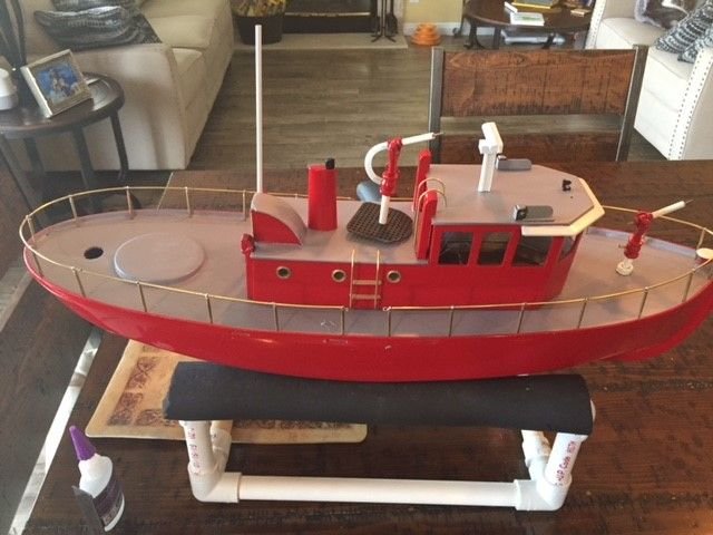

Ive been off for a while and havent been able to get much done on this boat, but as parts come in I am getting the electronics fitted and have started building the brass railing, something I have never done before. I think its coming out pretty nice!

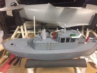

I have been slowly working on getting all the electronics and wiring run and its looking pretty good. The LEDs are mostly working, the rudder, prop and rudder tiller are all installed and shes nearly ready for a test run.

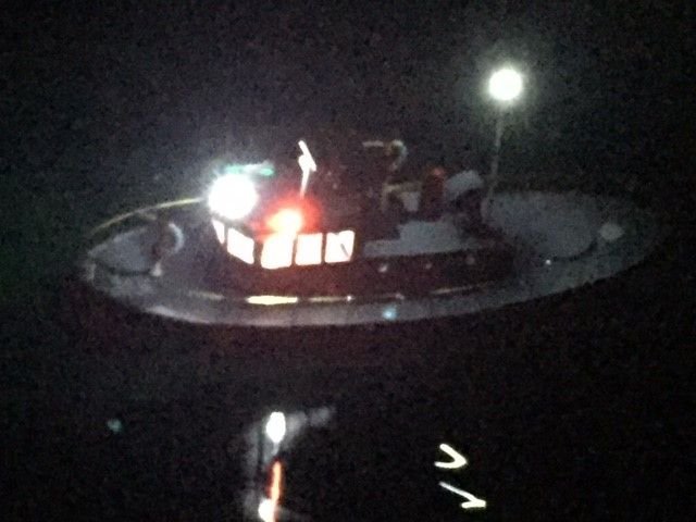

So I have finally moved and found a few minutes to get the boat out for its maiden voyage in the pool! One think Ive found is that the 550 motor is too much for this boat, as it seems to have a bit of torque roll and will dip the starboard rail into the water when you really nail it. If you slowly roll on the throttle it realy gets up and goes. so much so that I think it may need ballast in the bow to keep it lower in the water, but IM not sure how to get more weight in there as its all sealed up. However when just putting around its looks and runs pretty good. Looks super at night with all the lights on and the fire monitors will squirt around 15-20 feet. Its a pretty fun boat! I still need to finish some details, but it is working and pretty fun!
I have a couple of thoughts for you:
1) Smaller battery pack(s). That would lower the power you're putting to the motor and will reduce your rolling issue
2) Add some expo into the throttle, will do the same thing.
3) Smaller motor, though to do so will mean probably having to replace the prop with something of either less pitch or diameter to keep from overloading it
I personally would start out with option 1 as it will also reduce the brightness of the lighting. To me, the picture has them looking too bright
