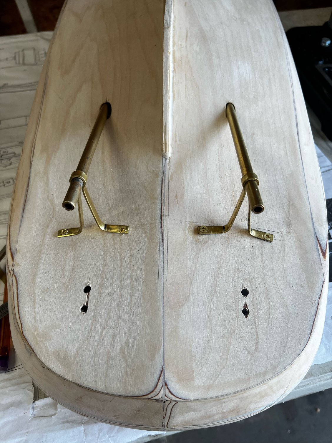

My first few tries drilling Brass did not go well, so I invested in a Drill Press and new drill bits. I got 118 degree drill bits and filed off the curl. Set the Drill press to it's lowest speed, and I got nice clean holes!
I used a countersink bit to make a clean screw location. These will get evened up in length next and installed.

I have finally gotten out to my garage and started working on this. Took a different route for the Prop Shaft mounts.
updates coming soon!

I finally figured out how to create some better prop shaft supports. Thank you RC Addiction and JakonyRacer for your build threads!
Using a Oetiker style crimp pliers, I was able to get a very nice bend around the drill bit.
Nice and tight fit!
I created two at the same time, and bent them at the same time, so they would be identical.

I made some PROGRESS!
Got them both screwed down, and they're within 1/32" tolerance mirrors.
I plan to solder the two pieces together after I get tubes epoxied to the Hull!

Default Prop Shafts Epoxied!
My next step is getting my motor mounts installed then Kort Nozzles. Going to wait until everything is turning to solder the Brass Supports to the Tubes.

Soldered the prop shaft supports, one solid piece now! Next is Epoxy and 404 Peanut butter on the prop shaft mounts, where they connect to the hull. This will allow me to trim the screws sticking out inside. Then it's Steering Servos!
Covered the boat with Aluminum Foil to protect the wood from flame and solder dripping.
"Propane Propane"(My. Lahey voice) and some pipe Solder ftw.
Cleaned up with the Dremel nicely!

Bit surprised that the soldering of the tube supports and epoxying of the tubes is done before watterproofing the hull?
Other than that a very nice build!
The kort-nozzles separately steerable?

Supports Epoxied in place.
Super18 (10-08-2023)
The hull is getting two layers of fiberglass over it. Then it's getting White Gel Coat. I'm NOT going back to drill through fiberglass and Gel coat(which cracks easily).
The Kort Nozzles each have a servo, so yes they can turn separately. I plan to have at least two Drive modes, Harbor and open water. Harbor will be twin screw control(dual stick), open water will be parallel steering and throttles(single stick).

Ah, OK wasn't aware you were going to glass and gellcoat it. In that case I can see the point of doing it like this.
I expected the hull to be given a few coats of filler and paint (how I used to do it way back when), so I was a bit puzzled by that construction.
