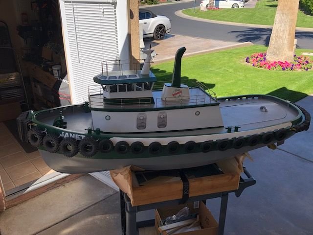

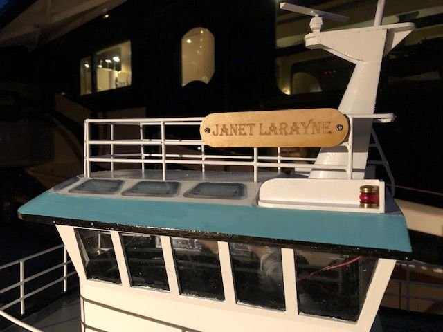

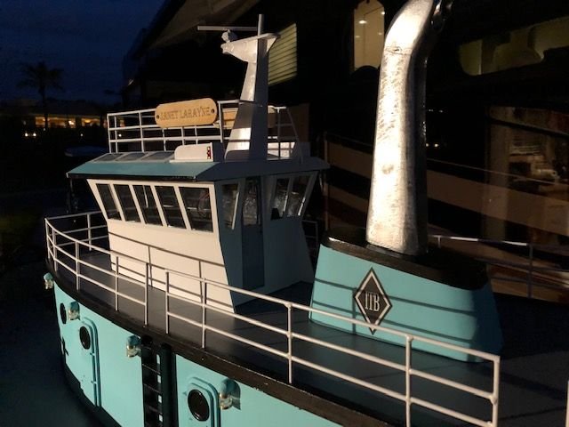

Update on my 76 inch Shelly Foss Tug Boat. Finally found time to finish it this past month by taking in to our motor coach to Palm Springs and setting up a wood working shop in my Casita. Installed all the hardware and painted it Foss colors. Then had a change of plans and changed it to Island Tug and Barge (Seattle) colors since our next door neighbors are the owners of that tug company and he was considering buying the tug at one time. Manson now owns it and has painted it Red and White. Now the owner of ITB is interested in it again now that he sees it the way he would paint it. He thought it might be for sale again. The following are the paint scheme of Foss Tug (original colors) and then the repaint a few weeks later to what it is now. Ready to launch it after I get my order of 200 lbs of steel shot through Amazon next weeks to add ballast to it (after I put it in the water) the tug weights about 40 lbs without the 12 volt Blue Top AGM battery and removable ballast.
Has twin Pittman motors on separate speed controllers with a Futaba 2.4 ghz twin controller Navy transmitter. Sound board and smoker too.
76 inch Shelly Foss Colors
76 inch Island Tug & Barge (Seattle) colors (formerly Shelly Foss)

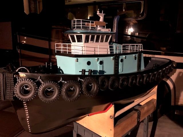

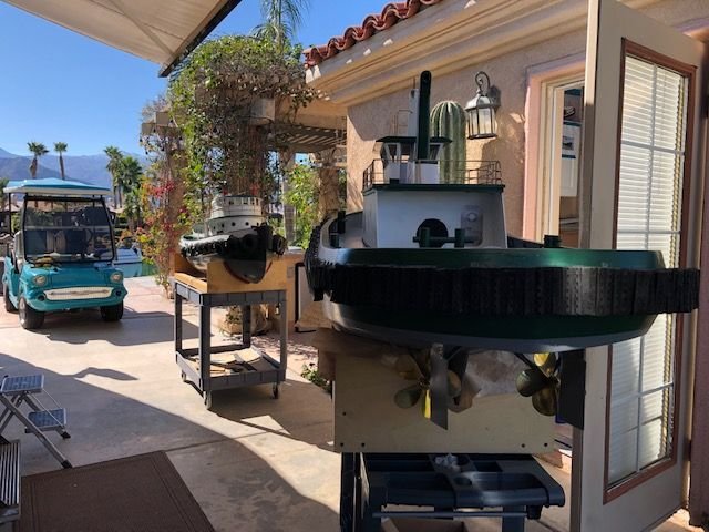

Well now that I am done building the 85' harbor tug (other post) and the 76 inch Shelly Foss that Martin at Aerodesign helped me design, Martin is redesigning the 85' foot Harbor tug cabin to go on the Shelly Foss Hull. The Shelly Foss Hull by far a great platform for building almost any stable twin screw hull and it was fairly easy to work with light plywood to make the hull look like a steel hull. I am going for a mid century looking tug now that resembles the older style tug look but with twin screws (big electric motors and 5 inch counter rotating 5 bladed props) so I can pull large objects in the canal. I am thinking red on white cabin and black hull would complete my fleet.
Thanks to Martin for collaborating with me to laser cutting many of the structural elements including the cabin. Expecting two very heavy boxes of laser cut plywood to show up in the next couple weeks.
Maybe with the look of a 1954 tug like this with a more modern Shelly Foss hull under. Painted red on white with a black hull
