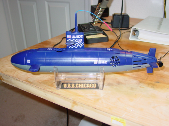

Here is a picture of the sub, cheaper than a old Nikko sub from the 80'

This is cool. I bought mine and had range problems. I extended the receiver antenna about a foot. It helped quite a bit. I also made a longer prop shaft so the propeller is outside of the body where it should be. This should increase its top speed. I had the thing apart and was amazed at how well its put together. Amazing for only $19 at Wall-mart. I am going to put some high capacity AA NiMh for some longer run times. Thinking of more mods. Hmmm...
Sean

To extend the operating range & dive depth try the following:
1) Add additional waterproof sealants to the the receiver box & the joints connecting the sub's three motors.
2) Replace the "stock" transmitter antenna with a "rubber ducky" antenna. I used a Radio shack replacement antenna from product # 60-4328. The N.P.A. part # A90441. Save the "stock" transmitter antenna.
3) Re-route the receiver antenna to the inside the sub's hull, from it's present conning tower mast location. The sub's receiver antenna should be able to reach all the way to the rear of the sub, just above the "side thruster" motor.
4) Drill a 1/16" hole on the sub's deck ( right in the middle of the two 1/2" slots). Now mount the "stock" transmitter antenna on the sub's rear deck with a 1/8" dia. X 1/2" stainless steel nut & bolt. You now have a modified Wal-Mart submarine!
Modified Wal-Mart Sub spec: Operating range 40 to 50 feet (on surface)
........................................ Max Diving depth 6-7 feet ( in swimming pool water)
........................................ Max speed (submerged) with modified TRAXXAS prop #1534 , ... 50-55 feet per min.
........................................ Sub power source: Four AA 1.2 Volt Ni Mh 2300 mAh
