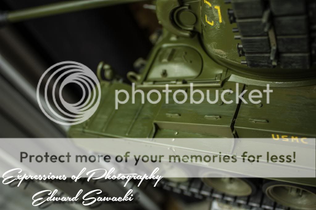

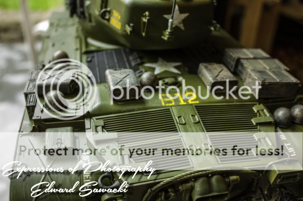

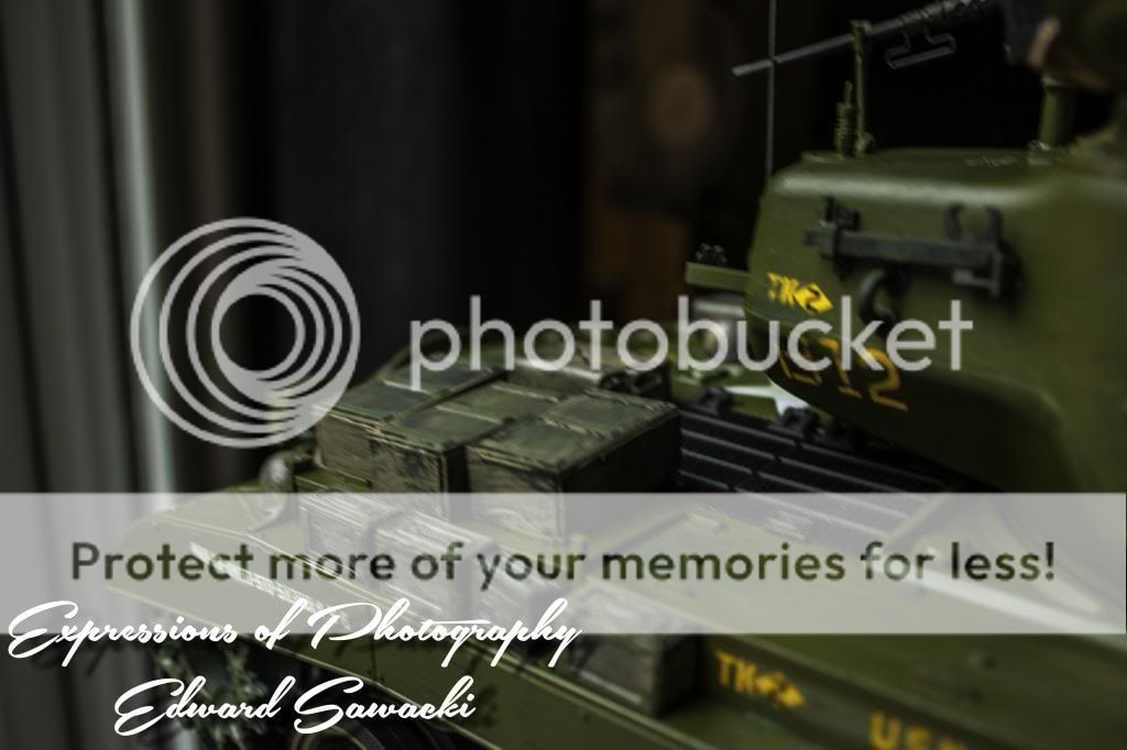

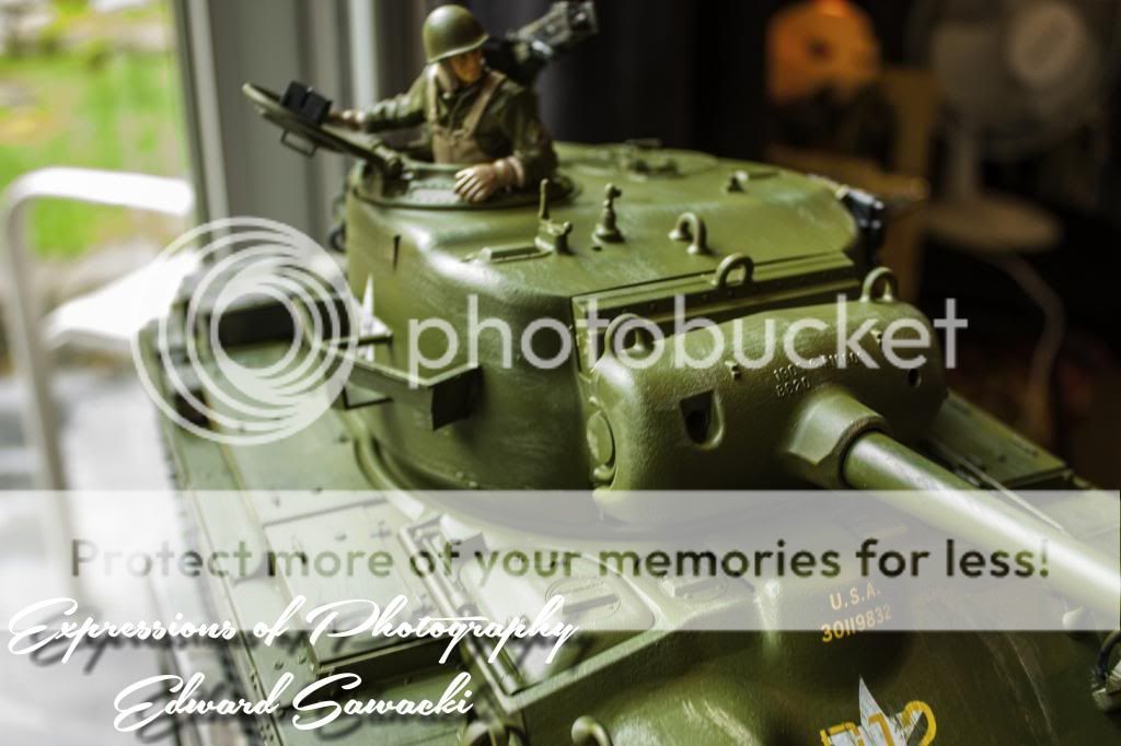

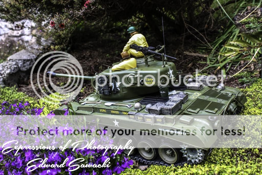

Thumbs up Tamiya 1/16 M26 Pershing Tank

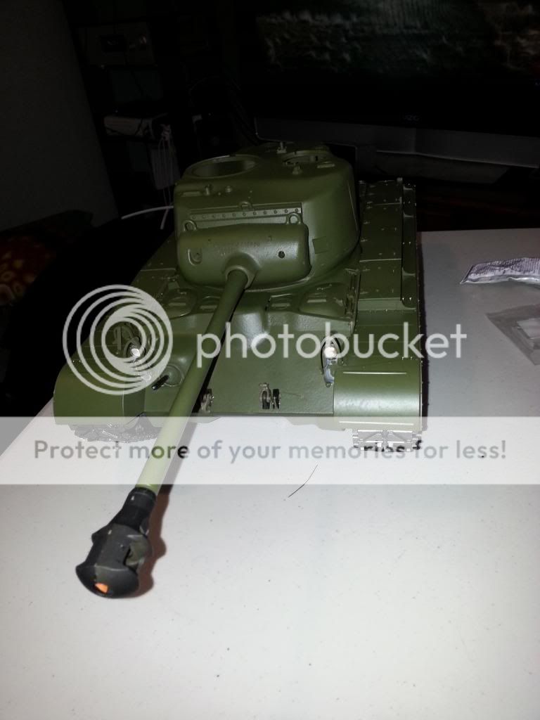

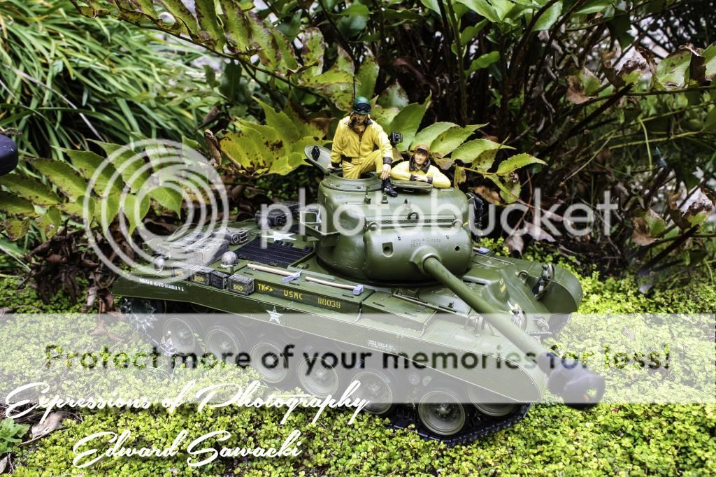

I have wanted a RC tank since the late 1970's/ early 1980's when a older kid had a RC Tamiya Tank at our local school playground. I always kept my eyes open for deals and would shake my head at the price of these realistic RC tanks.
Fast forward and I am 45 years young and I finally purchased a RC tank. I knew it had to be from Tamiya with the MFU sound unit and from WW2 era. I never was a fan of the Sherman Tank or even the Super Sherman but I wanted a tank that represented the good ole' US of A! I never even heard of the M26 Pershing and did a little research and found out it did see combat during WW2 and kicked some German butt!
I also liked the price that was a bit easier to swallow than some of the pricier tanks I saw on Tower. The kit is flawless and Tamiya is king when it comes to scale and realism. All the pieces fit together perfectly and no seems show in the finished tank. The space for the electronics is a little cramped and I even used a 2200mah 2s Lipo to get a little more room. My only complaint is the clutch on the turret is a bit sensitive and after some tweaking it works without issue 98% of the time. Getting rid of the Tamiya NIMH plugs and replacing them with deans helped greatly.

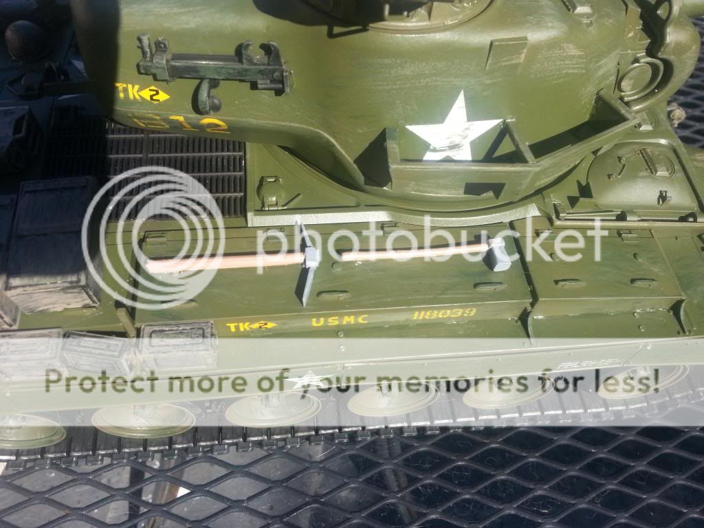

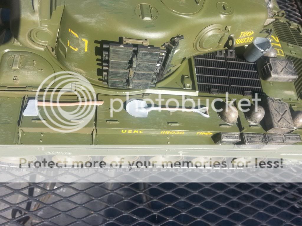

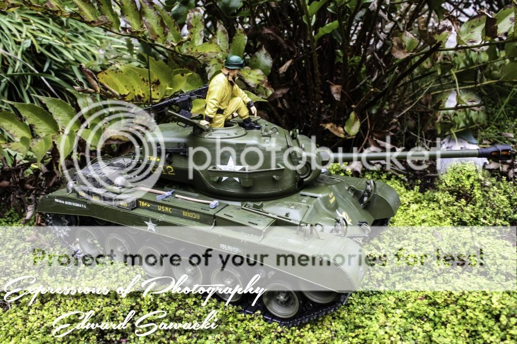

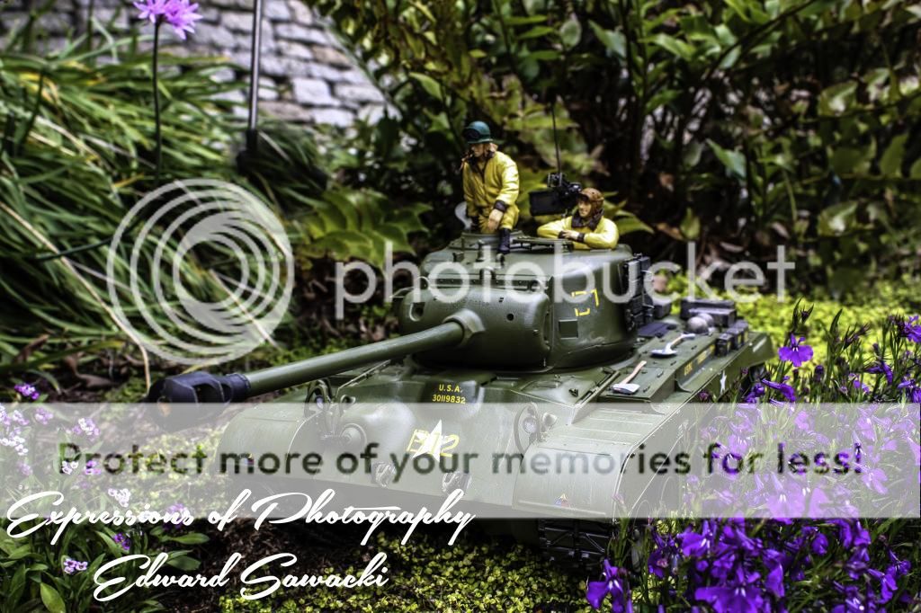

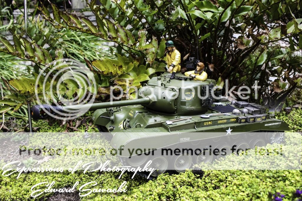

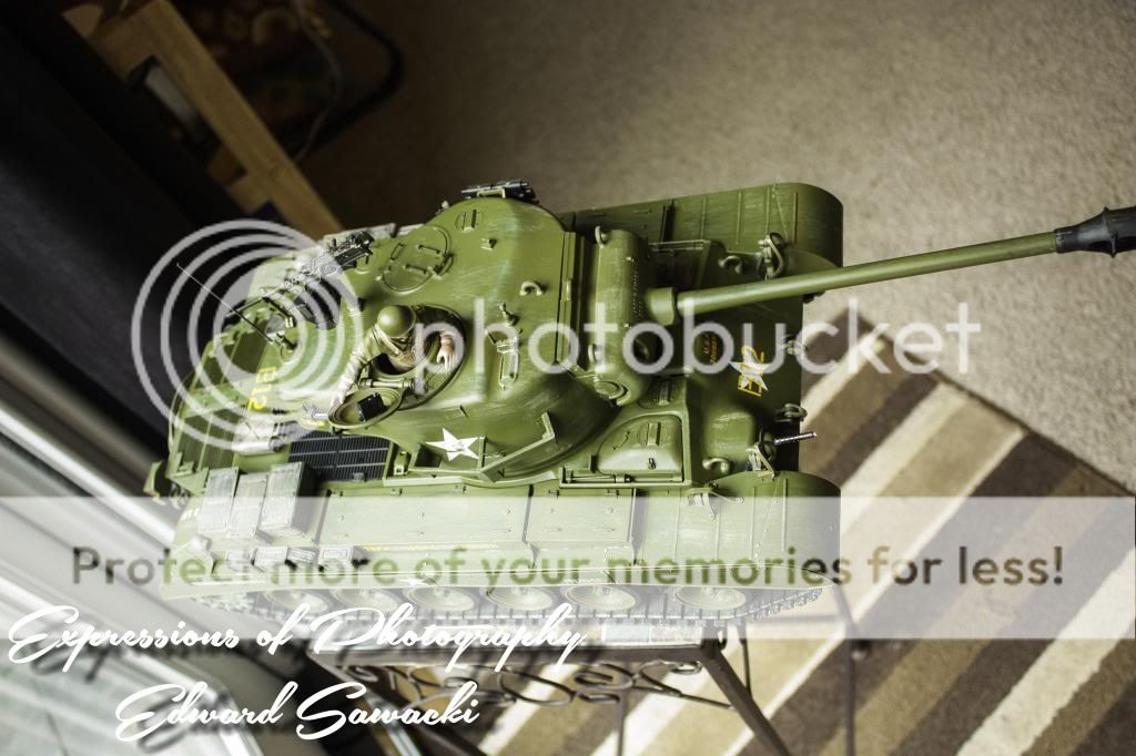

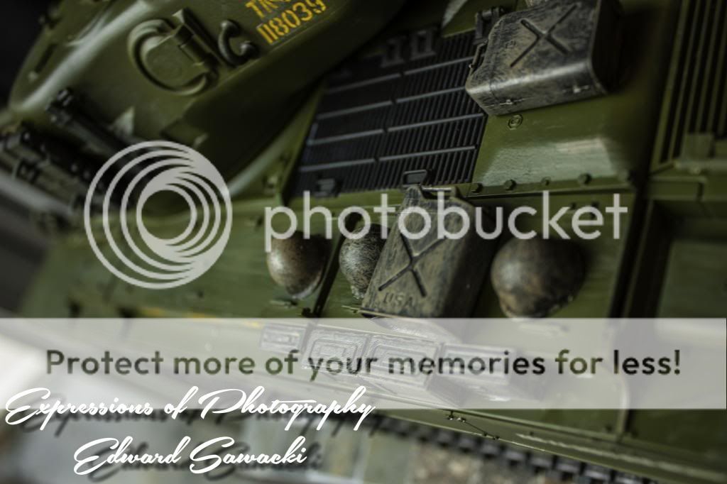

I will spare you the build photos and show you how it turned out. I added 1/16 scale shovel, ax, pick ax, and buckets and some weathering.
And the added 1/16 scale items (cell phone pictures sorry I was being lazy)

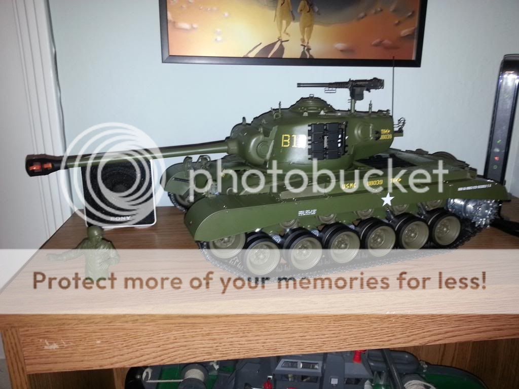

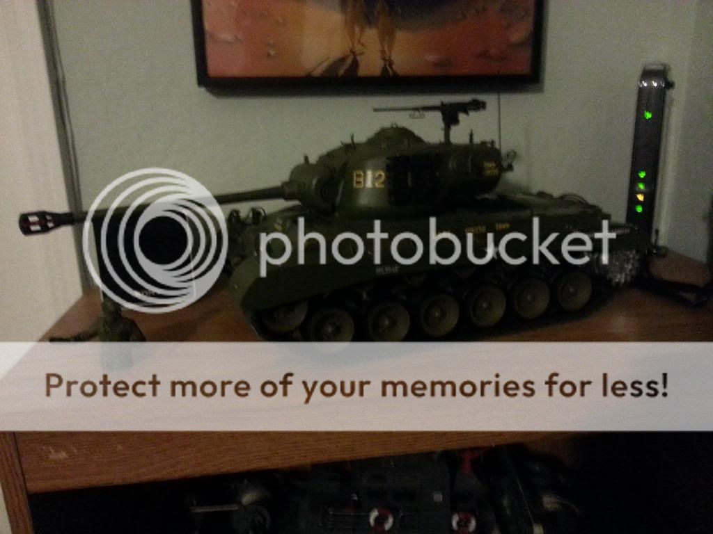

Thanks Guys! I have some more updates to show you and I would be happy to post the build photos! All I need is to find some other Tankers! I will get some recent photos of the small scale updates I have done this after noon. Here are my build photos and stumbles!
This is just a copy and past from my build thread.

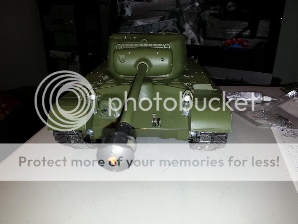

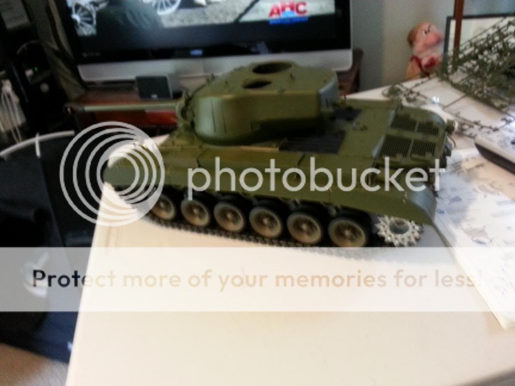

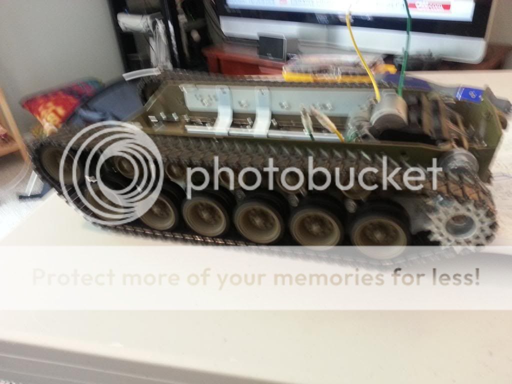

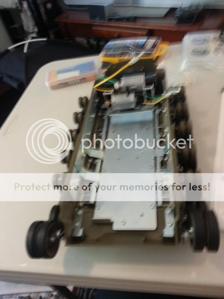

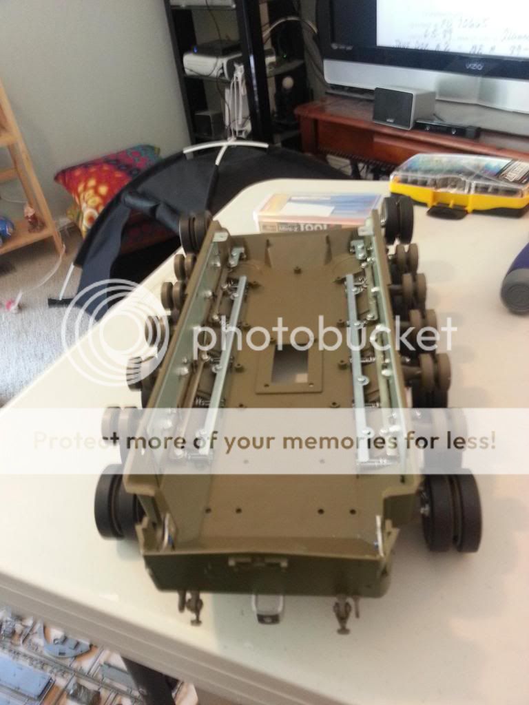

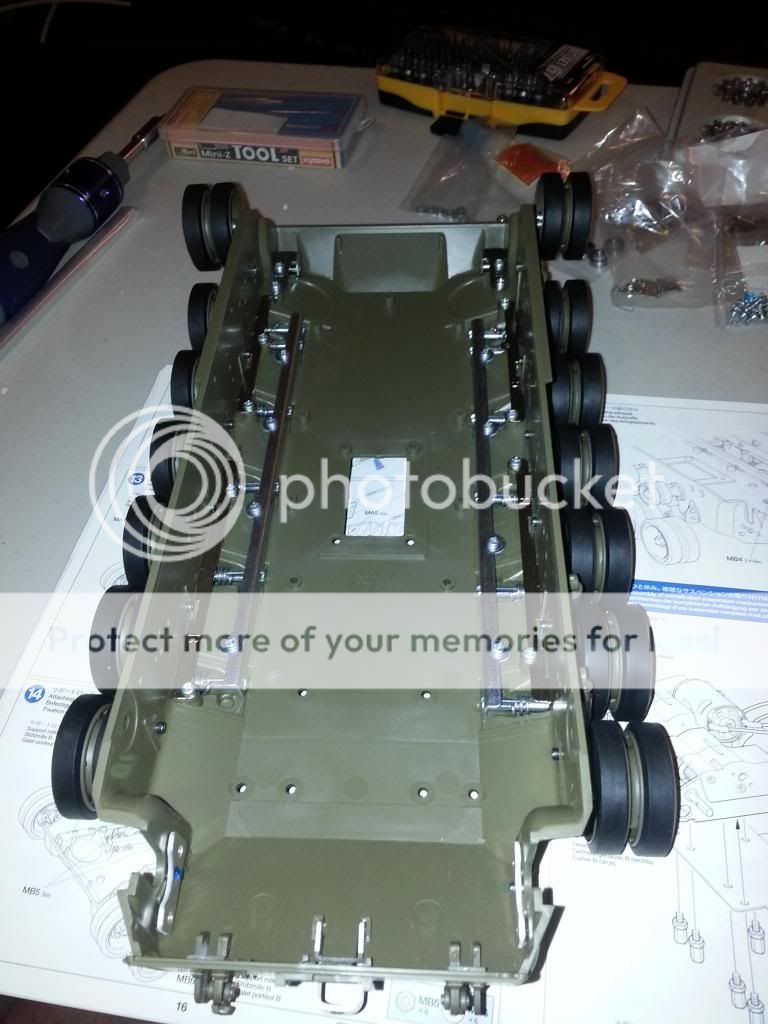

My Tank arrived Friday late afternoon and I started building! I have a few minor problems along the way but the build went smoothly and fairly fast since this was my first tank build.
I did have a issue with getting the tracks on and after staring at it for 30 minutes realized the front wheel needed to be rotated down so the top of the tank fits and the tracks also fit properly. After that everything else was easy.
I finished the build late Sunday night and what a build! Man that took forever! 3 days (about 28 hours total build time)
I plan on touching up the paint here and there and building the ammo boxes and Jerry cans. I also need to paint the figure but other than that it's done.
I am using a 2s lipo 2200mah battery and it fits well inside the tank. I changed out the Tamiya plug for a Deans plug and added a audible lipo low voltage alarm inside the tank. All my RC's run of lipo's and I can't ever imagine going back to NIMH's
Here are some picture that I took as I was building it. I'll get some better shots in the sun soon as well as some video. I apologize for the poor cell phone pictures.
I love Tamiya Box's
Look at that Box Art!
Corporal Socks the Cat inspecting the packaging
The build starts! (not pictured is the pre painting I did. Tamiya TS 28 Olive Drab

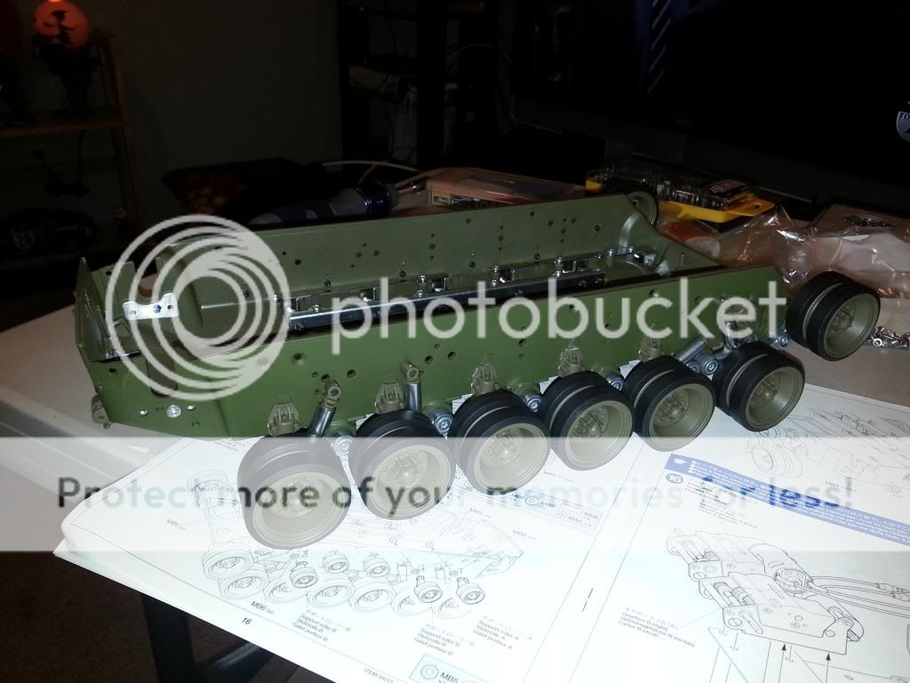

Got the track wheels on notice I have the front wheels on wrong! Took me ages to figure that out.
Sergeant Winters the Cat taking a nap.
Backing brace

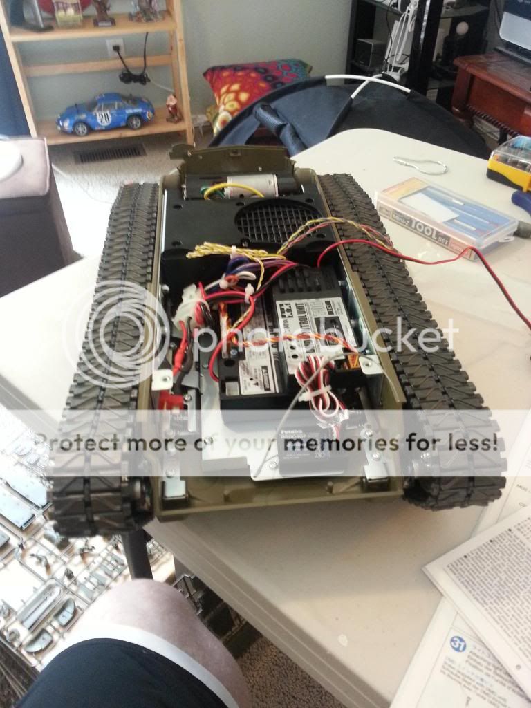

Motors and gears installed.

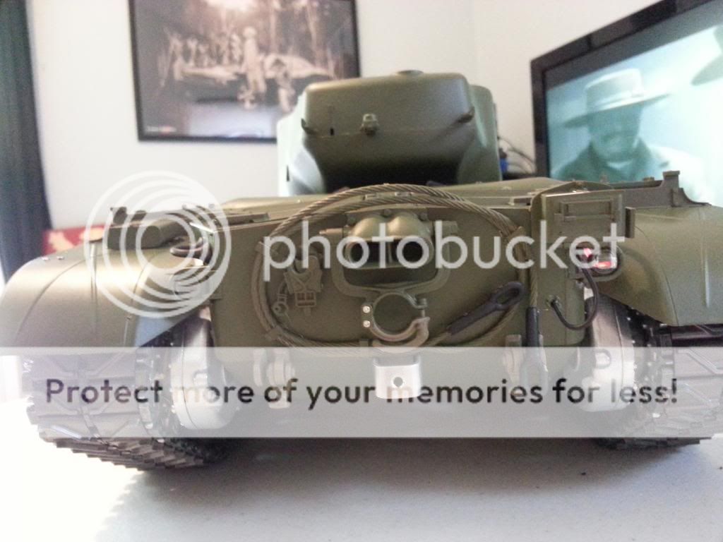

Tracks on wrong! I figured out I needed to rotate the front wheel down after ages of banging my head.

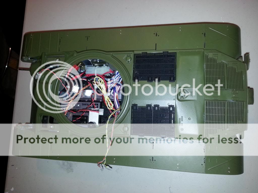

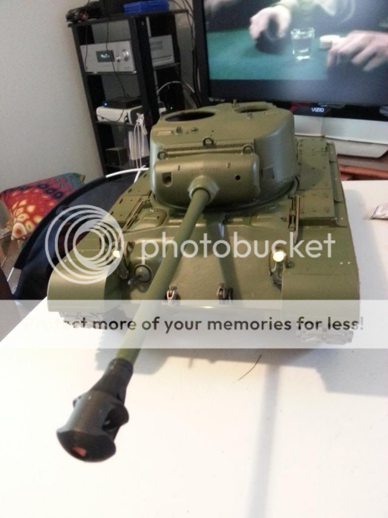

Electronics installed! No room for all of these wires!
Top of tank installed. What a mess of wires!
Trying to clean up the wires
Sergeant Winters on Patrol!
Turret on! I reinforced the turret with epoxy
Dreaded white stuff from using CA glue. I quickly switched to E6000 glue and will retouch with paint.
Lights working! check!
Rear light working! check!
Starting to look like a tank!
Done!
Done!

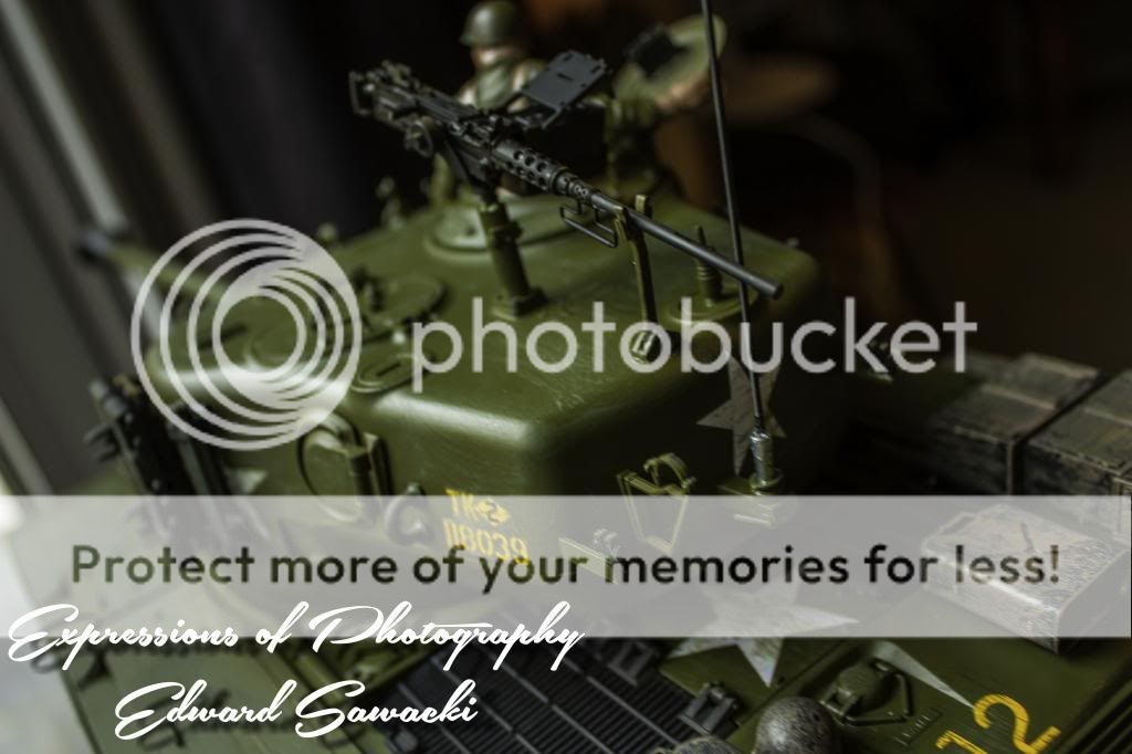

I went with my own decal theme and do not care if it's historically correct or not and added a flex antenna to the rear. Works like a champ and I am happy with the kit, build, and how it turned out.

Sine the build I also replaced the other two Tamiya style plugs with deans, did more wire organizing, and the turret rotates perfectly. I did add some decals to the ammo box's and wooden box's as well as paint the two buckets and ad U.S.A. decals to them (don't want any German's steeling them and claiming it's was their's).

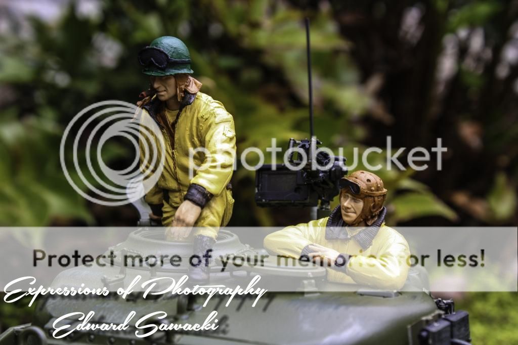

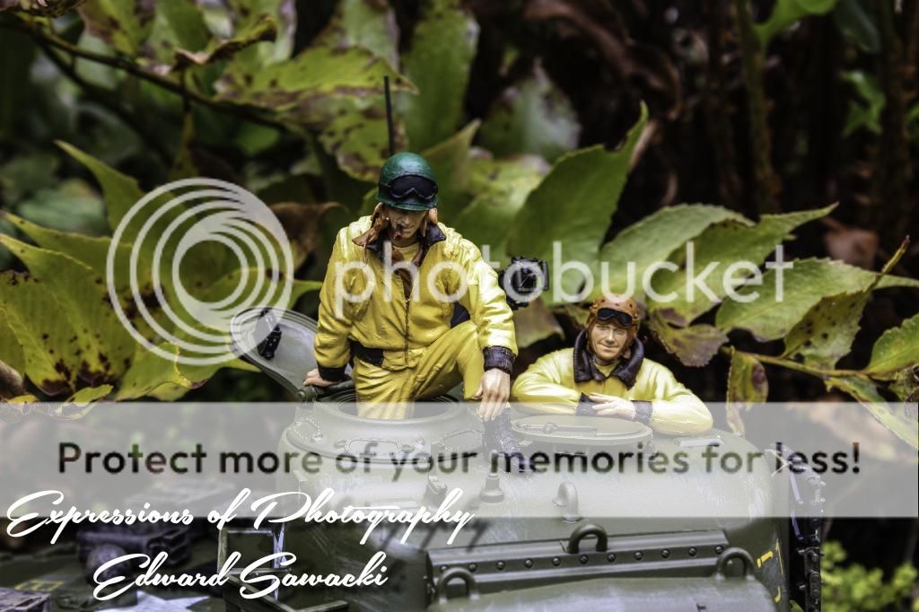

I also ordered some SOL US Tank crew figures..... I know they are for the Sherman but I would think they would be happy with the upgrade to the M26! lol!

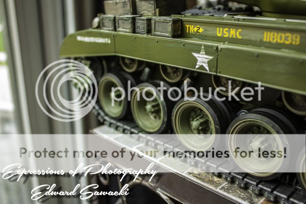

Looks great! I like the abrasions and the decals. The figures look good, too. One small historical correction: your tank is from B Co, 1st Tank Bn, 1st Marine Division. The Marines didn't get the Pershings until the Korean War. So, Koreans and Chinese would be stealing the buckets. Also, the figures look like they are from 1st Armor Division, US Army.
They're all really well done and it looks like you're having fun doing it. So, ultimately that is was matters most.

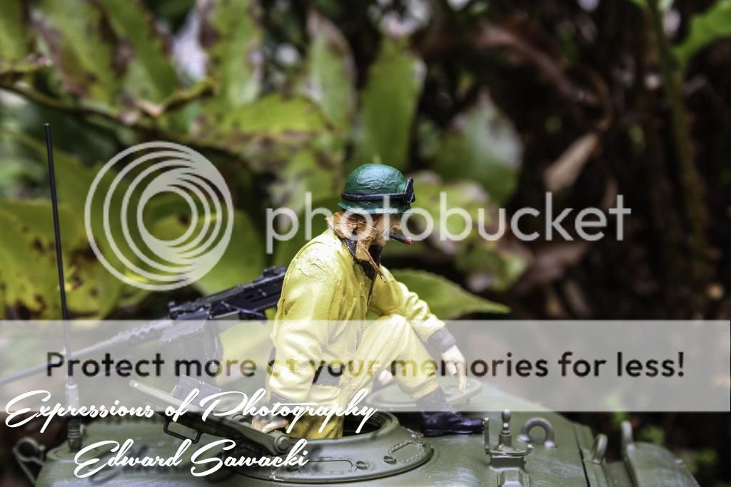

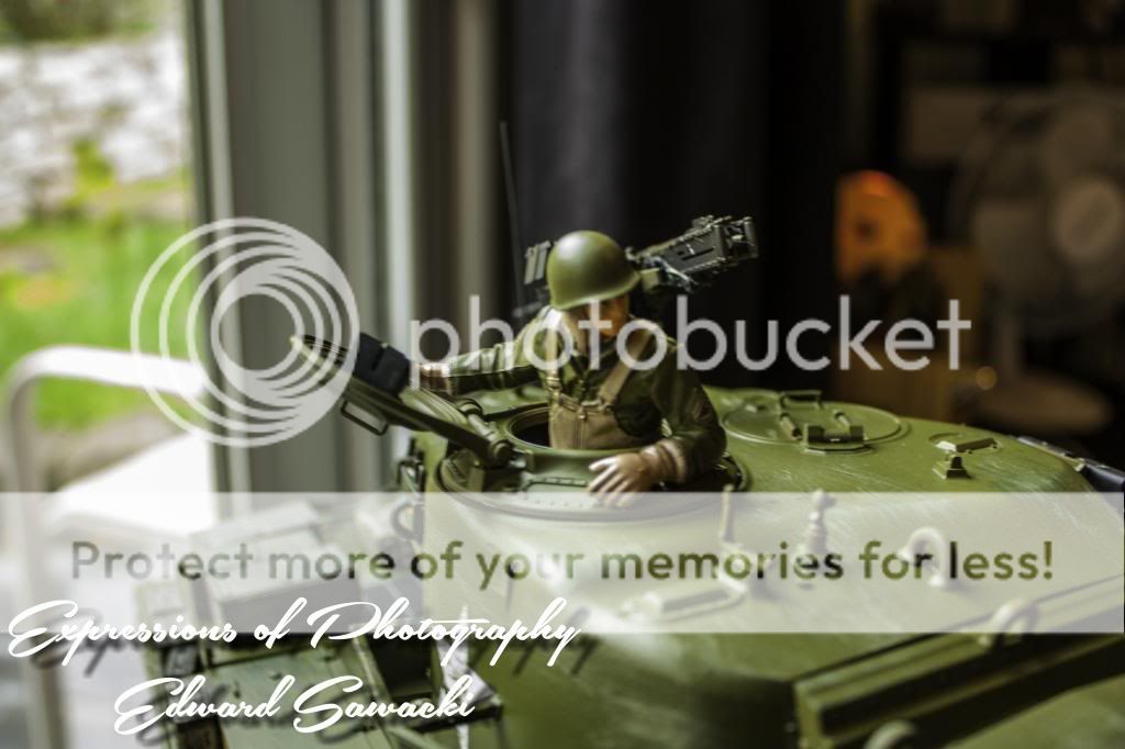

I got my Sherman Tank crew from Sol models in Korea. and the detail is great! I painted them using acrylics and made the cigar out of a round toothpick. I think I have done all I can do on this tank. The metal tools are a nice touch and the hanging buckets with USA logo on them also add to it. I might add some sand bags at some point but I don't want to over do it and make the tank look busy.
