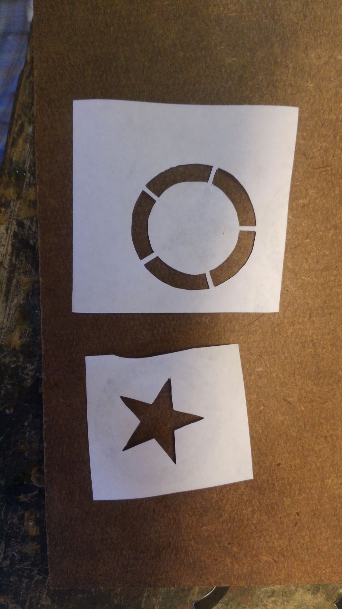

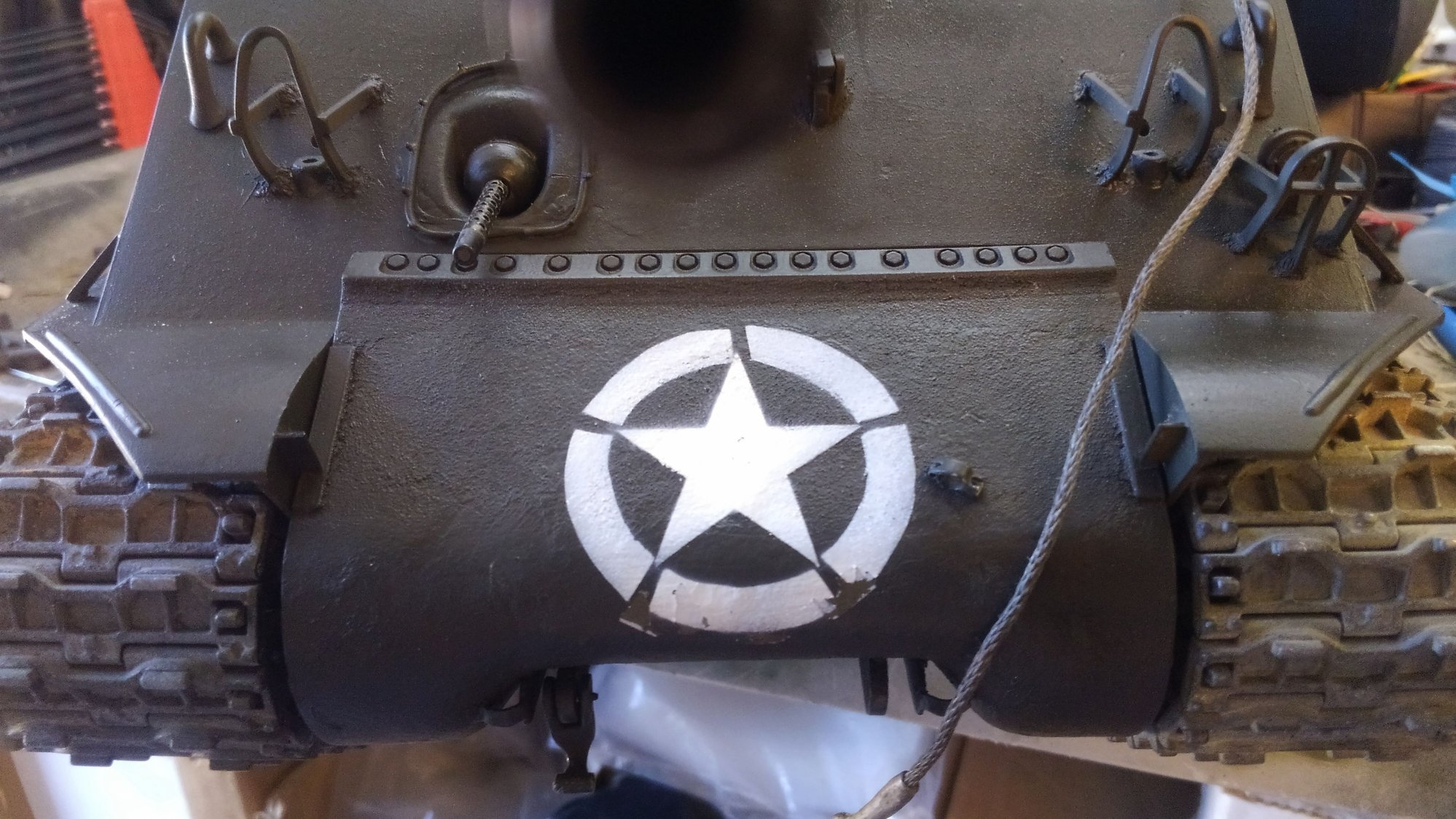

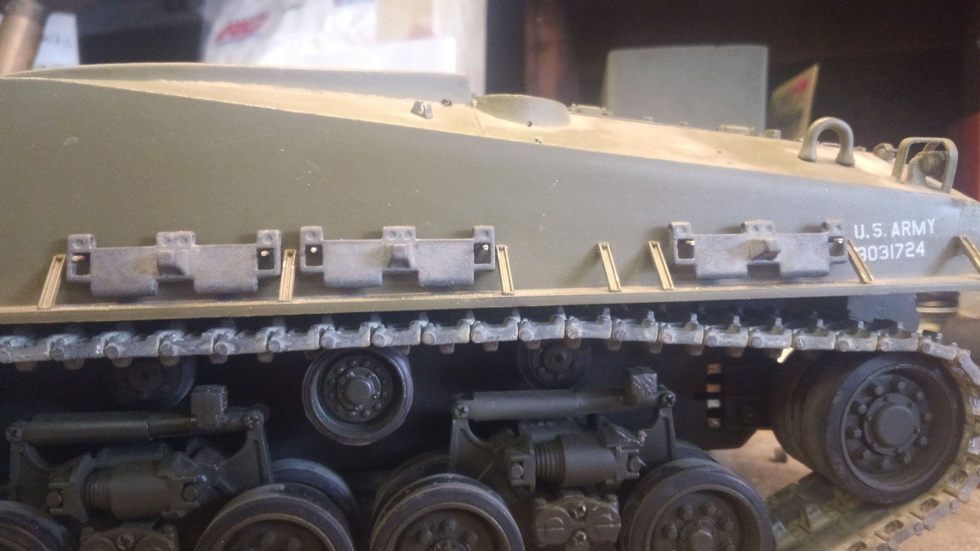

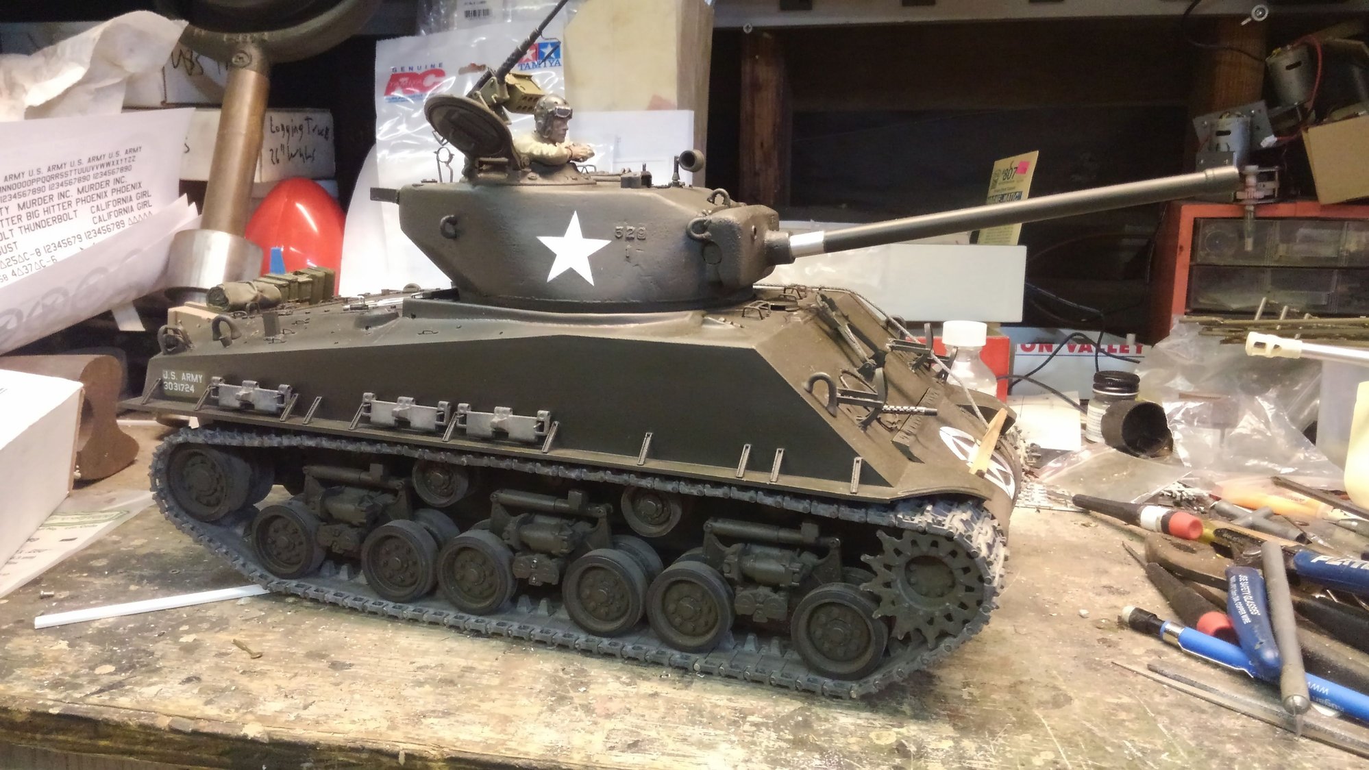

I got the stars and USA number finished. It has a number from about September 1944 production, to fit with the HVSS, no Muzzle brake and the split loaders hatch.
I finished the tools and mounting them on the hull. I mixed them between Tamiya tools that I salvaged off another hull, and HL tools.
I trimmed up the Tamiya sledge so the head was true and made a correct scale mounting bracket for it soldered out of brass strip.
I wanted to put the invasion star on the turret side, but was afraid the tank would look too gaudy with it along with the Katy Perry pin up painted over the lower hull star. I did a bunch of research, period photos and some documentation and the TM for color and marking of US Vehicles.
The "Invasion star" the star with a circle, I always thought came out just for D day, but infact it was in use much earlier. The circled star was designed to be used for aerial recognition, not for vehicle sides. The stencil had broken lines in the circle to hold it together, (I have a real one) and the broken lines in the circle were supposed to be painted in by hand after spraying on the vehicle. The sides were to only get the star from the center of the same stencil. However, it just depended on the depot guys and how lazy or hasty they had to be to get things marked. Often AFVs got the circle on the side as we see in photos, some got it on all possible spots some got painted only in one or two. The emphasis post D day was on aerial view, especially when applique armor or things were going to cover up the sides and front any way. Rear deck or turret top was essential. Especially when some units began to use black to add cammo to their tanks. I bet this is a big flaw in FURY, those tanks should have a circled star on top somewhere to be correct, and I don't recall seeing any stars on them at all.
More or less, it looks as though, if there were stars on the sides of the hull or turret, it could have been one or the other or both places, and it was about 50 /50 with the plain star, or the whole circle included. And occasionally you find one where somebody spent the time to paint in the circle brakes.
A lot of you guys know this or bits of it already, but I thought I would post it because as much as I know or thought I knew, I didn't know the details, and I wanted to be accurate.
So, unless you are copying a photo of a particular tank, decal how ever you like, as long as the stencils are the correct size.

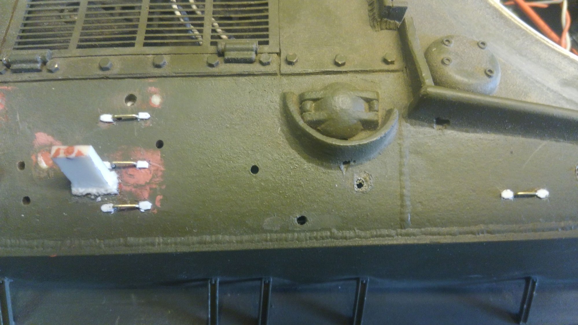

So last night I went out and installed the ETO armor tail lights and ran the bulbs through the hull. I realized that they way Tamiya designed them, and how they actually light up, is not how the real tail lights work, I know because I have vehicles that have them. The tail and stop light on the left should not operate with the black out stop white light on the right. The little convoy markers at the bottom of both are useless in real life let alone on a model, so I only put one bulb in each tail light.
I did not mount the head lights yet. I am pondering not installing them since they were removed except for night driving so they wouldn't get shot up.
I also am not going to run the lights off the TO Mf unit. Im going to use a 4AA pack to do it on a switch, if I even ever bother to do it. I just feel like Im not really into lights for some reason.
