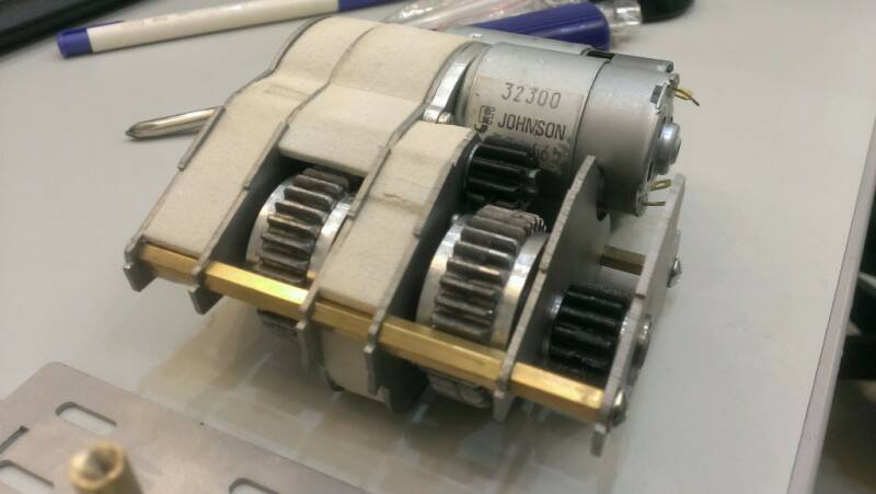

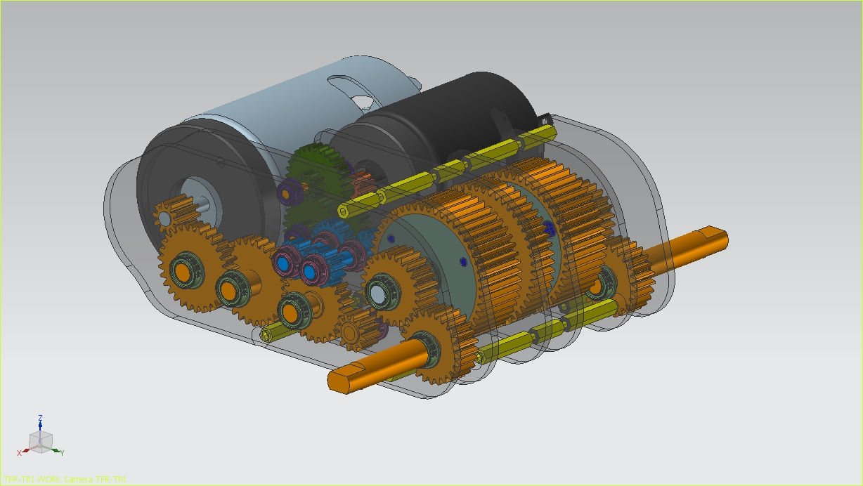

Hello Chris,
In the RC tank scene in East/SE Asia, a DIY dual clutch/flow gearbox is a popular upgrade to Heng Long tanks. The Tamiya Leopard 2A6 has the same design.
Basically, one motor moves the tank forwards and backwards while the other (usually smaller) steers the tank. This design guarantees the tank to always run straight. It will also allows smoother steering but the power-efficiency is worse. Not really a problem when the main motor is a 550 or coreless. I am not sure if the real Centurion uses this design, but most modern tanks (like the Leopard 2) do.
-Sheep

Hi,
Unfortunately most of these gearboxes are homemade by fellow modellers.
Some are listed on Taobao (Chinese version of ebay) but you usually have to get in a waiting list and wait for a few months before they can complete your unit.
They do sell plans for like €1 and I think you can cut the aluminum shell and buy the cogs to make one yourself. The principles are really the same as the Tamiya Leopard 2, but these homemade gearboxes are usually full-metal.
- Sheep

Hi Chris,
The most difficult part is to make the cogs go smoothly together. The gearbox I have posted was made by Chinese modeler "Flying Swallow" and the design is still not perfect after 2 years of constant improvements.
The easiest way to get a differentiate steering gearbox is to buy the Tamiya Leopard 2 gearbox, then replace the gears with metal ones.
- Sheep
