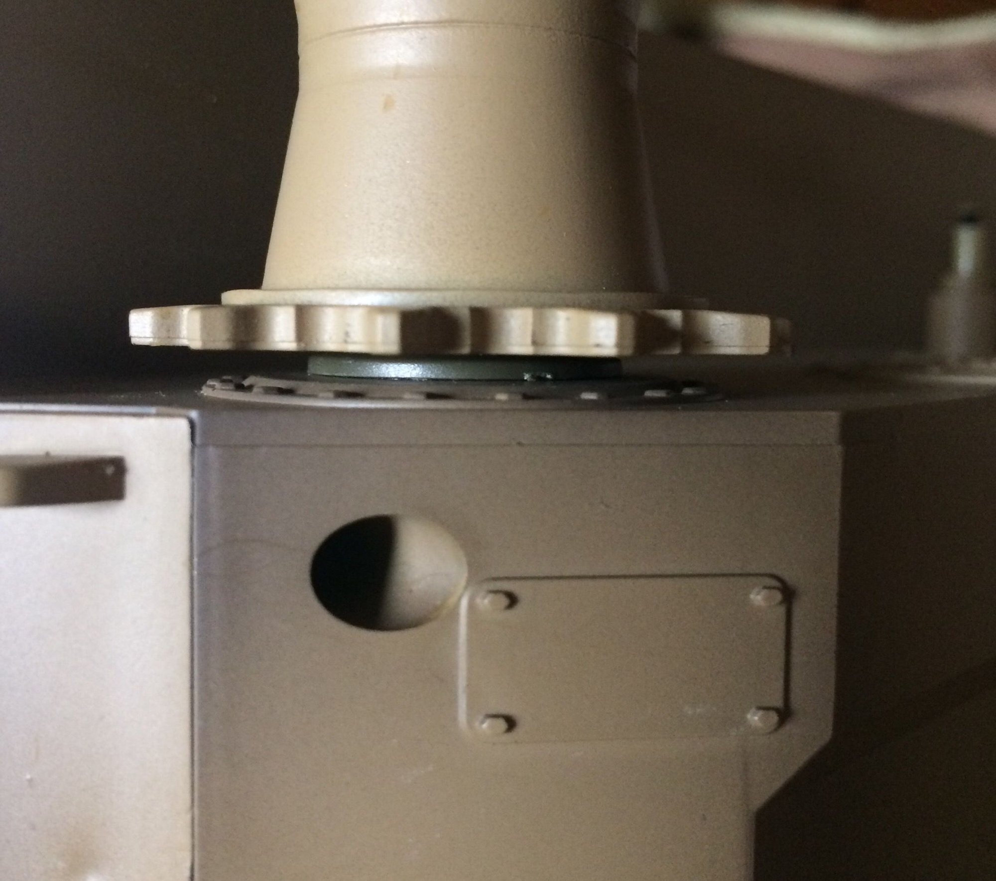

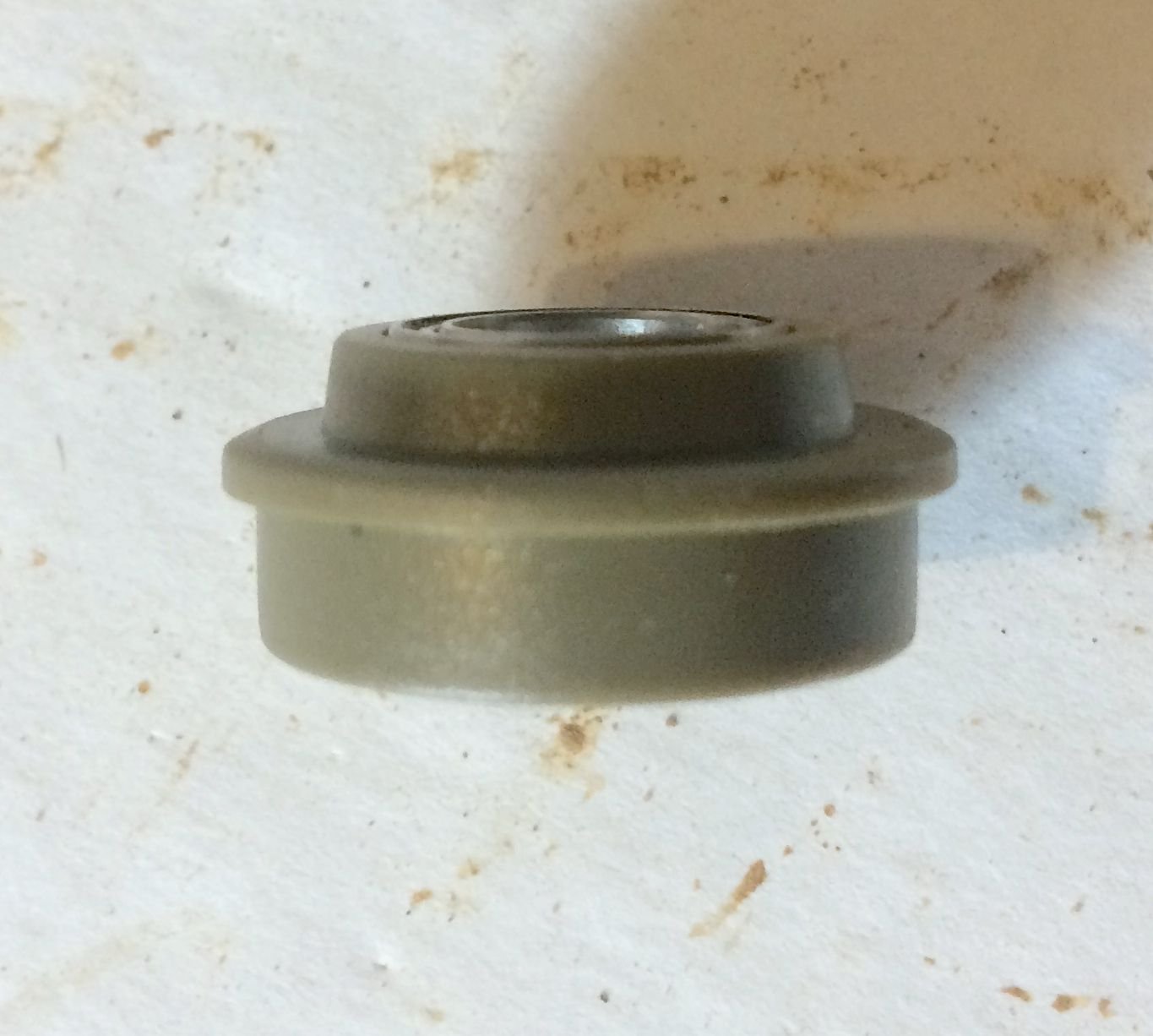

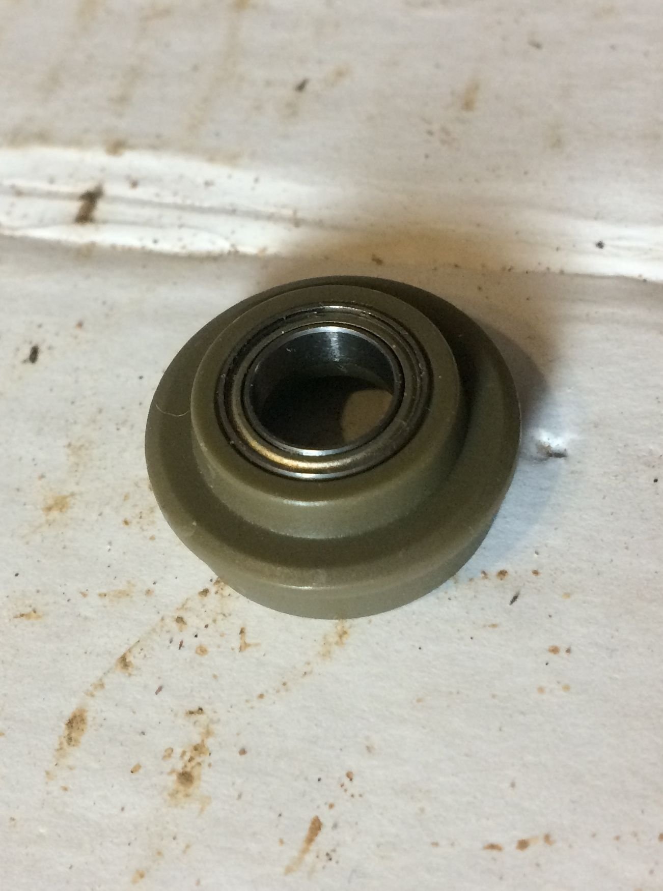

While servicing on my T-90 last week and finally having a chance to install a set of factory Heng Long T-90 drive axle support bearing I ordered, I notice something. Their diameter looked similar to the hull opening on my Heng Long Abrams. So being intrigued I pulled out my stripped HL Abrams hull and to my surprise the T-90 drive axel support fit like a glove!
I installed an extra set in one of my Abrams and it has been working GREAT! Fit is super clean and blends in like it belongs there. Considering these are less than $16U.S. delivered for a set it is a cheap and highly effective improvement part.
Here is a photo of the Heng Long T-90 drive axel support bearing set and what it looks like install in an HL Abrams hull. Your constructive comments, input and question are welcome.

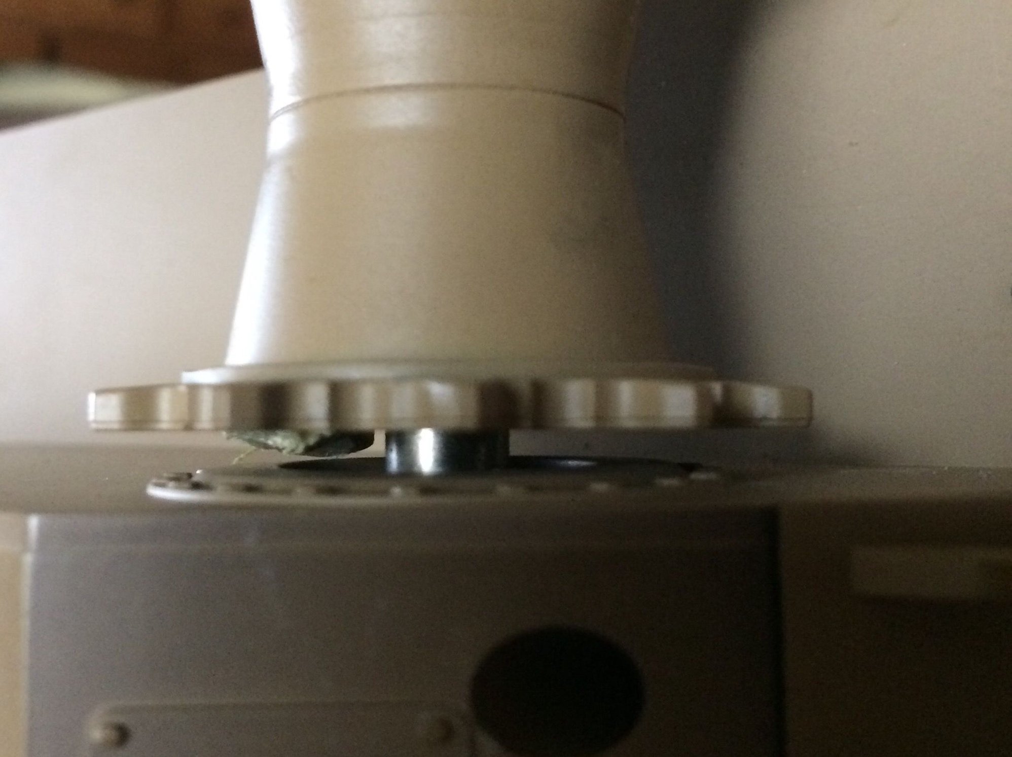

Here is a photo of the support installed and what it looks like under the sprocket. Followed by a sprocket without the support. Keep in mind these do still need to be glued/epoxied in place. HL recommend CA glue but my past experience has taught me to use epoxy.

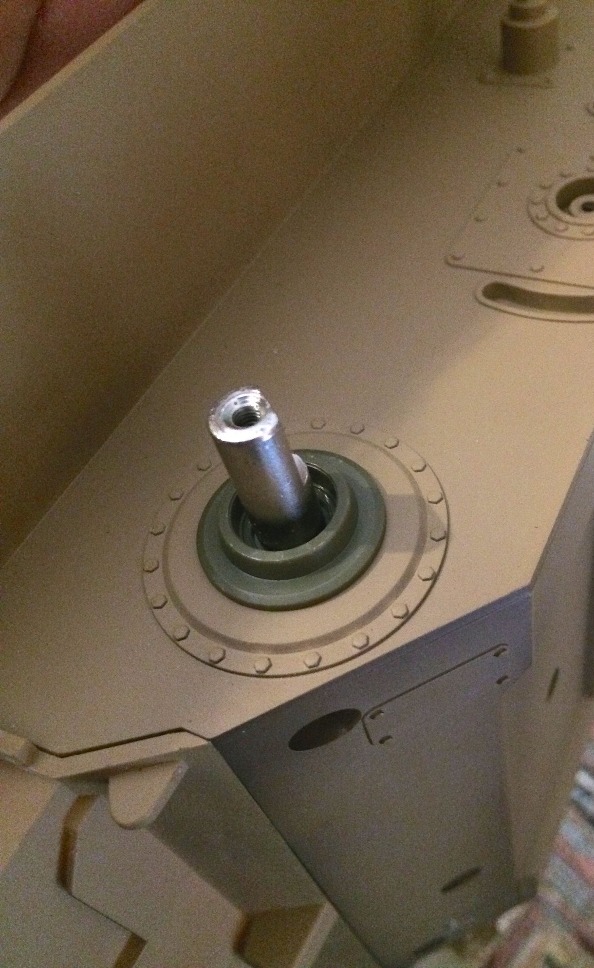

Here is another showing the support has more than enough room inside the sprocket.

Can I ask what did you do to pop the old one out? Did you drill it to the size or what tool do you use? =]

Figured it out. You technically have to destroy your old one to get this new one in. I could've just buy the god damn bearing and put it in the current fitting. Stupid me.

NO that is incorrect. The old 5.3 tanks did not come with any supports like the new 6.0+ tanks do. All that was there prior was a large whole.

The newer tanks v6.0+ comes with the same axle support but without the bearing (in your picture, exact same size and fitting but without bearing). I bought one of these. The old fitting was completely glued on. SUPER hard to get it off. I forgot the fact that I can just pull the bearing out and install it on the existing fitting =.=

This thread was started before HL made an axle support for the Abrams. The use of the T90 support was the only off the shelf HL option at the time.
They new factory axle support mount is a plus. Yes it only needs the bearing. Sorry you had to take the long way around but you learned a lot in the process so it’s still a win win.
