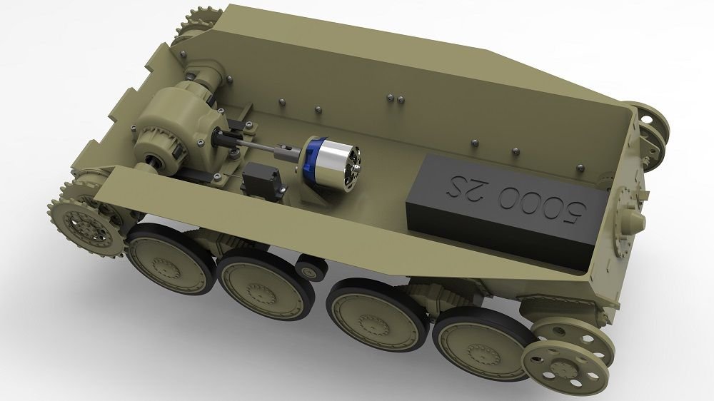

Got the Differential install figured out and fully mounted properly, driveshafts sorted as well as the brake drums. Still need to finalize how I want to do the brake bands. First Diff I bought had a bad ring gear, but the replacement is good. The diff barely fit and I had to clearance the front hull plate to get it in there. Total gear reduction is about 1:32 (1:4 in the diff, and 1:8 in the final drive) so it will have monster power, but a low top speed with a brushless outrunner. I haven't done all the math to figure out the motor KV, but pretty soon. I'm printing the diff cover as I type this, and will section the hull soon and trial print that - it will print in 2 parts.

It says above that you'll print the lower Hull in fdm, but from that fantastic print quality in the photo I'm guessing that you printed the prototype in resin? It looks really great, you're getting a most excellent print quality.
Sorry to mislead - that's the CAD model post processed in imagining software, not the actual print. Prints look like Prints look unfortunately! I've printed some of the bits here and there, but getting close to printing the lower front hull section to test the drivetrain fit. Just calculating gear ratios now - I might need to redo the final drive ratio.

My jaw hit the floor with that last photo before I read the follow up post. Some very nice work, there!

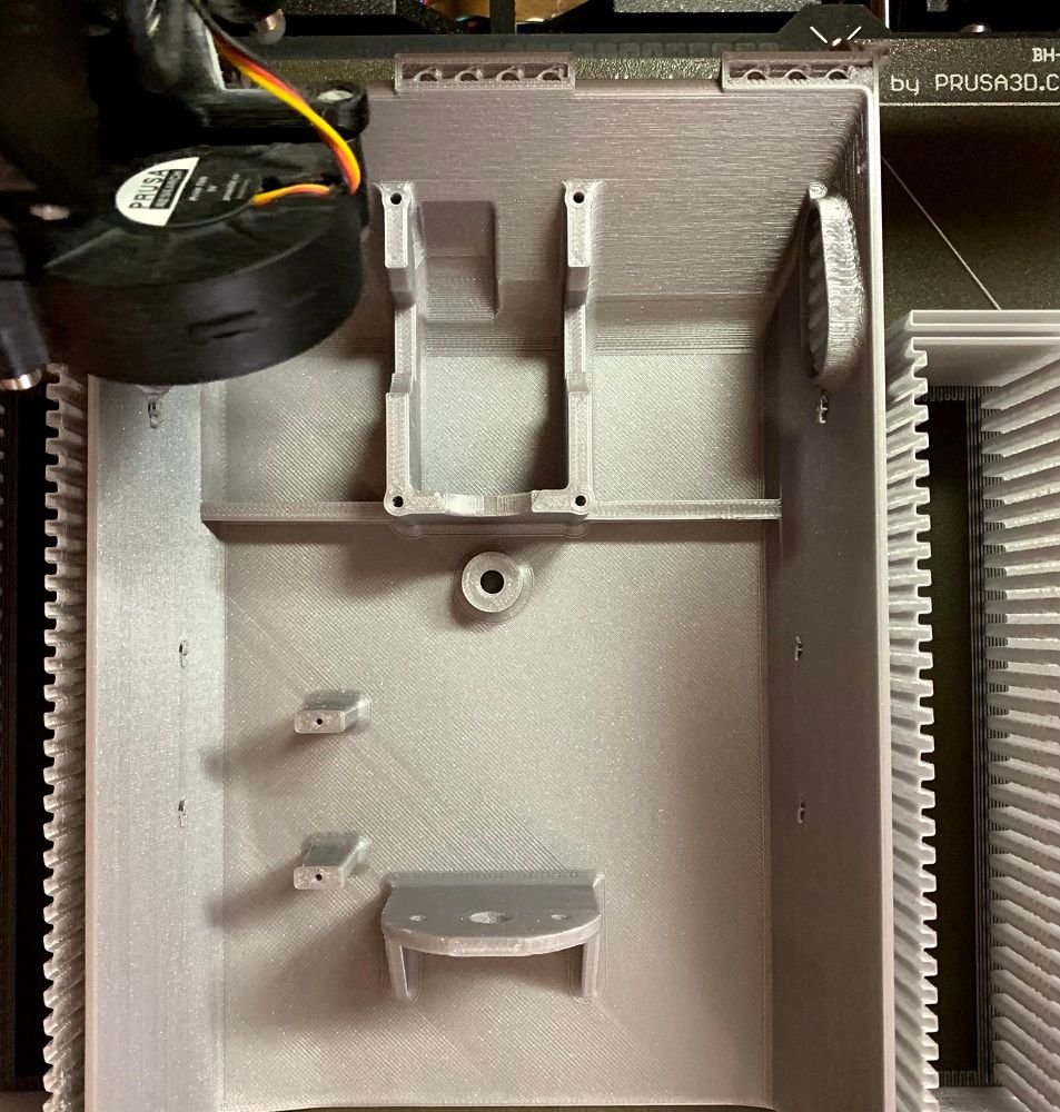

Lots of details this eve. Printed the diff cover, brake drums and brake covers. Finalized component placement and put fasteners bosses on all the bolt on parts and holes in the hull to mount them (very tedious!). Designed the track tensioner and refined the brake bands and mounting. Did lots of other little tweaks all over too. Bearings and driveshafts on the way, and I think I have a motor in my airplane stuff good enough for a trial. Split the hull, and am printing the front half now to test parts fits - it BARELY fits and fills the entire build plate, which I guess is perfect really lol. Print quality is turning out excellent. Even at 1/12 scale, this is a pretty itty-bitty tank. When I eventually get to the Tiger, that will be something else to break up for printing.

Good to see you use a Prusa. I've got one too, I'm just now getting it running. Great project for the Prusa!

Its a really great printer, with lots of potential ahead, particularly in software. This was just a trial print for general settings, and even in draft mode I was impressed. I used scale thickness for the hull, but the bottom is a bit too thin for scale; will need to make a bit thicker which means I have to tweak .... well dang near everything lol. Differential fits well though.

Glad you like the Prusa. I'm looking forward to making lots of tank parts with mine. What material is the hull? You may be surprised by how strong it is - even at scale thickness. I have Tomas Fudor's 1/6 Hetzer to print - although I cannot print all the hull parts with Prusa.
How are you joining front and rear hulls?
B
Bob,
This is just PLA. Studied lots of materials, and given stiffness is right up there in my requirements PLA has a great mix of properties. I'll add some stiffening ribs here and there and it will be good. I'll probably both glue and "bolt" the hull halves together and have an interlocking mating flange. Just tweaking a few of the fits then will add those features and reprint here in just a bit, but overall really pleased both with the results and the design process. I don't enjoy all the fussy little exterior details because they are really just decoration, but really enjoyed designing the suspension and drive system. Gun mount will be fun too.

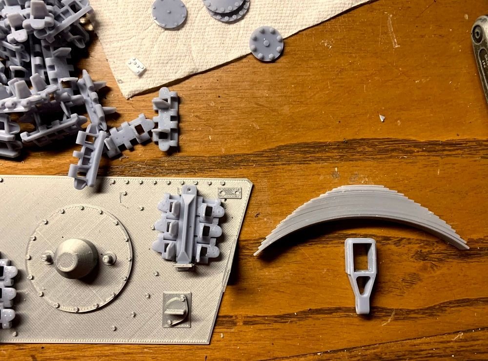

So, one big experiment worked out better than I hoped. I took a gamble and made the springs exactly like the real thing - Same number of leaves (16) and exact scale thickness and camber of the springs. I individually modelled each spring printing each separately and assemble them in the full scale way. Much to my delight, they feel just about perfect, giving supple articulation and looks like just about the right amount of support.

Looking good! Looks like your tracks were resin printed? I've printed quite a few 1/6 resin links - they fit together wonderful. Not sure if they'd hold up to powered RC use however. The resin parts seem strong, but brittle. I've had decent luck mixing a toughened resin with an ABS like resin.
Will be interesting to see how the "springs" hold up over time and use. Really cool project -a real gem.
Bob
Thanks Bob. I wonder at longevity too. Given how little it will actually get driven around I suspect it won't be an issue, but we'll see - I did use the "ABS-like" resin. I can FDM print them but I liked the look of the SLA ones better. Spring are a good question too, but the combo of thinness and number of springs leads me to believe they will work pretty good. I've got all the springs printed now - all 64 of them! and need to get some metal rod for a couple things including mounting the leaves, and mounting the pack to the bogeys. Of course, testing and refining is half the fun, and I can always print more! Even making all my own stuff, this ain't cheap to build. I've used more than 40 bearings already plus $100 worth of fasteners and more stuff to order still.
