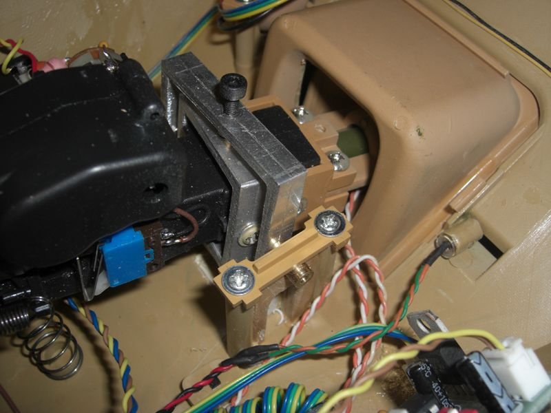

I'm going to build an outer square frame for the my SU-100 with bearings on the top and bottom for traverse. A smaller square frame inside that frame with bearings on the left/right will take care of elevation. Saw a person do it that way and it was very effective on their Ferdi.
like this:
just square aluminum extrusions, slice off a bit and attached pivots and bearings.

That's pretty much the exact same setup I have in my 1/6 hetzer, just a little smaller. I found that it works very well, and I haven't had any trouble with it even though it's holding a .50 caliber paintball gun that must weigh at least a pound and a half.
