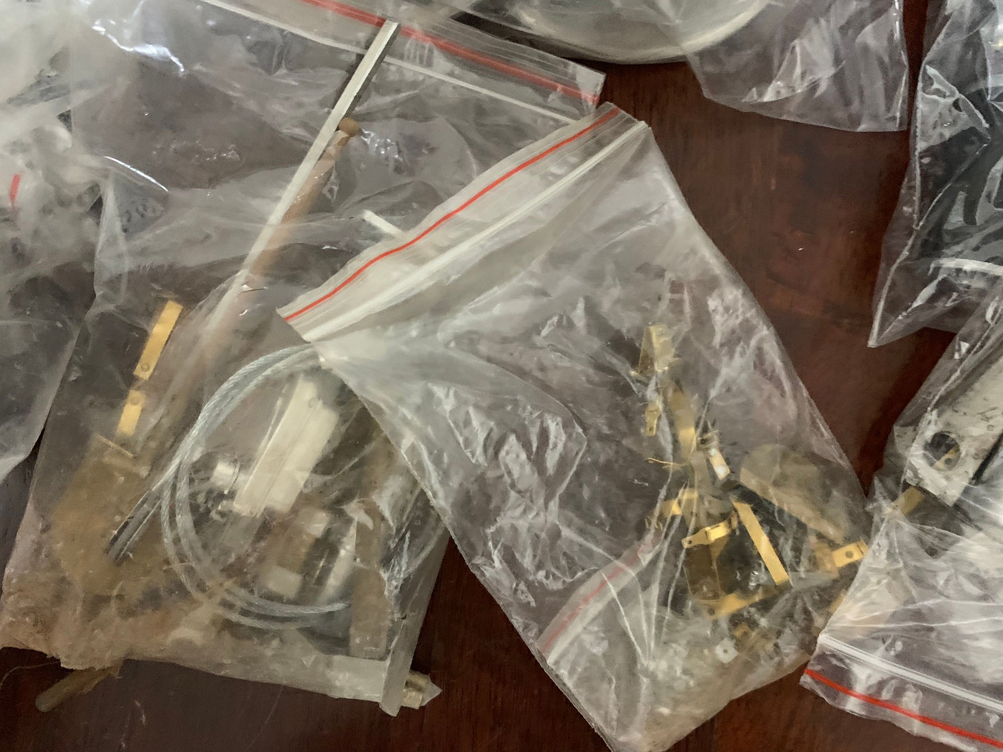

No ,the tools, jacks,spare track links, Fuel cans are all optional. They charged me an additional 405USD for it.
I first contacted them at the beginning of 2017 about the releasing of Luchs assembly kit. They asked me to pay the full amount and wait for 12 months for its delivery. So , this time I paid immediately I heard it was in stock.

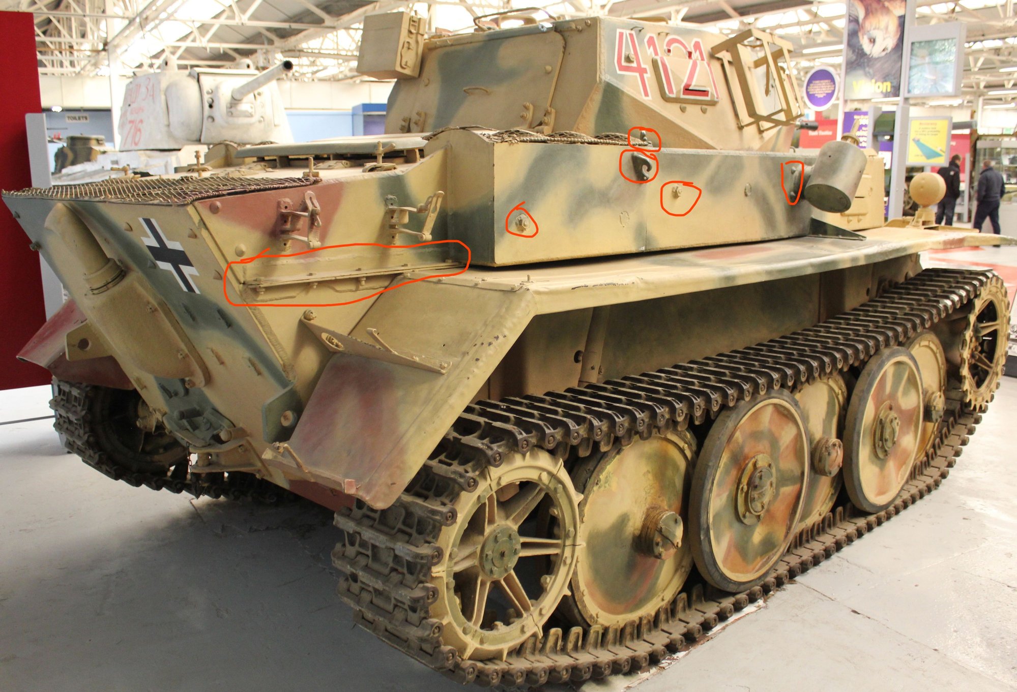

did many hours of online research, and found out the kit doesn't come with many details. I added as many as I can.

Awesome Build! Lucky for you for sure. Wouldn't get to worried about the details as they changed and were modified like any other tank. Even in the small amount of production on the Luchs it had an "early" and "mid" production. Biggest give away is the rear turret hatch. Don't have reference in front of me but one was more square and the other rectagonal. Also the Compass mount bracket on top of the turret in front right of the commanders hatch was later in production.
