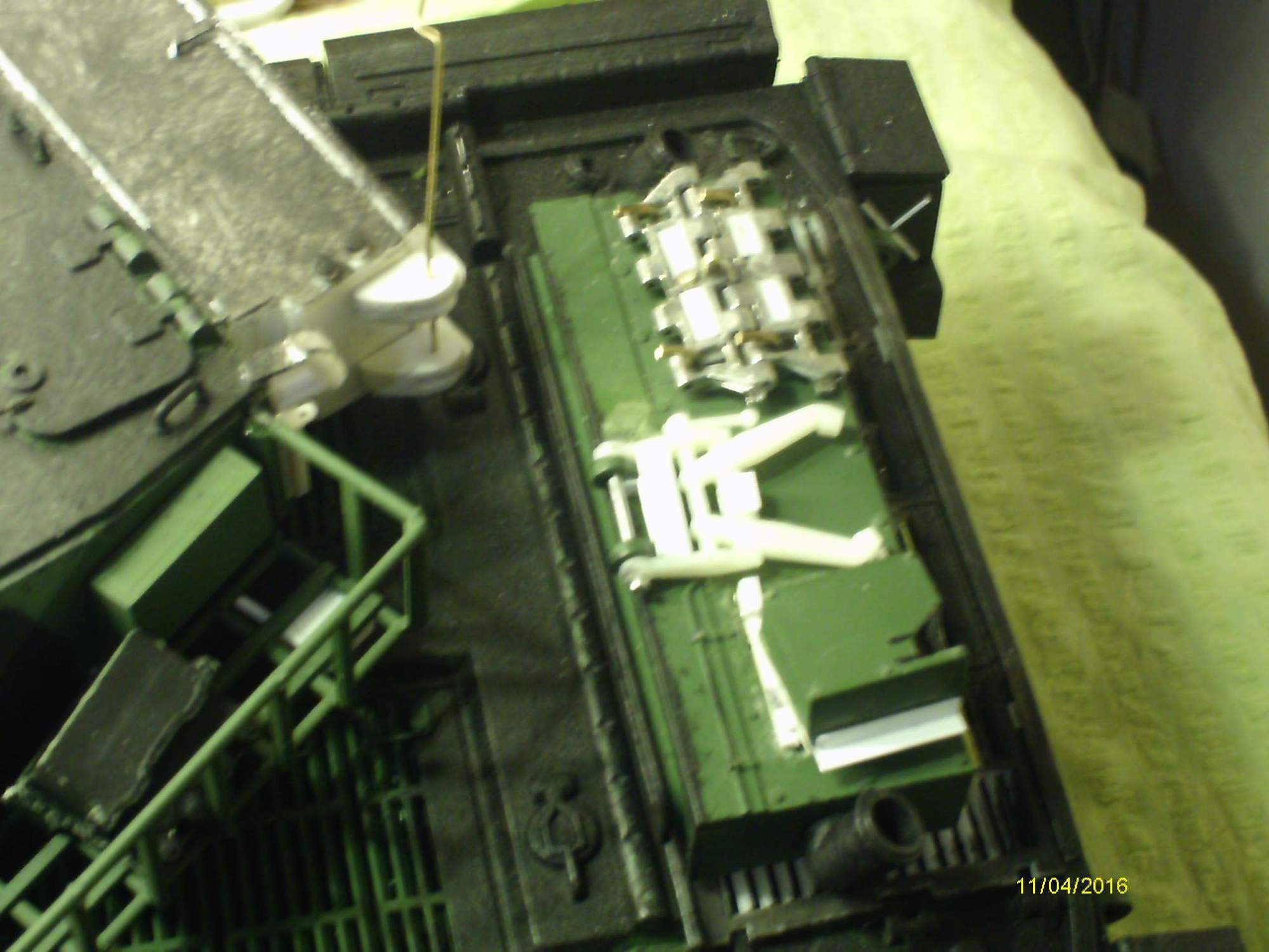

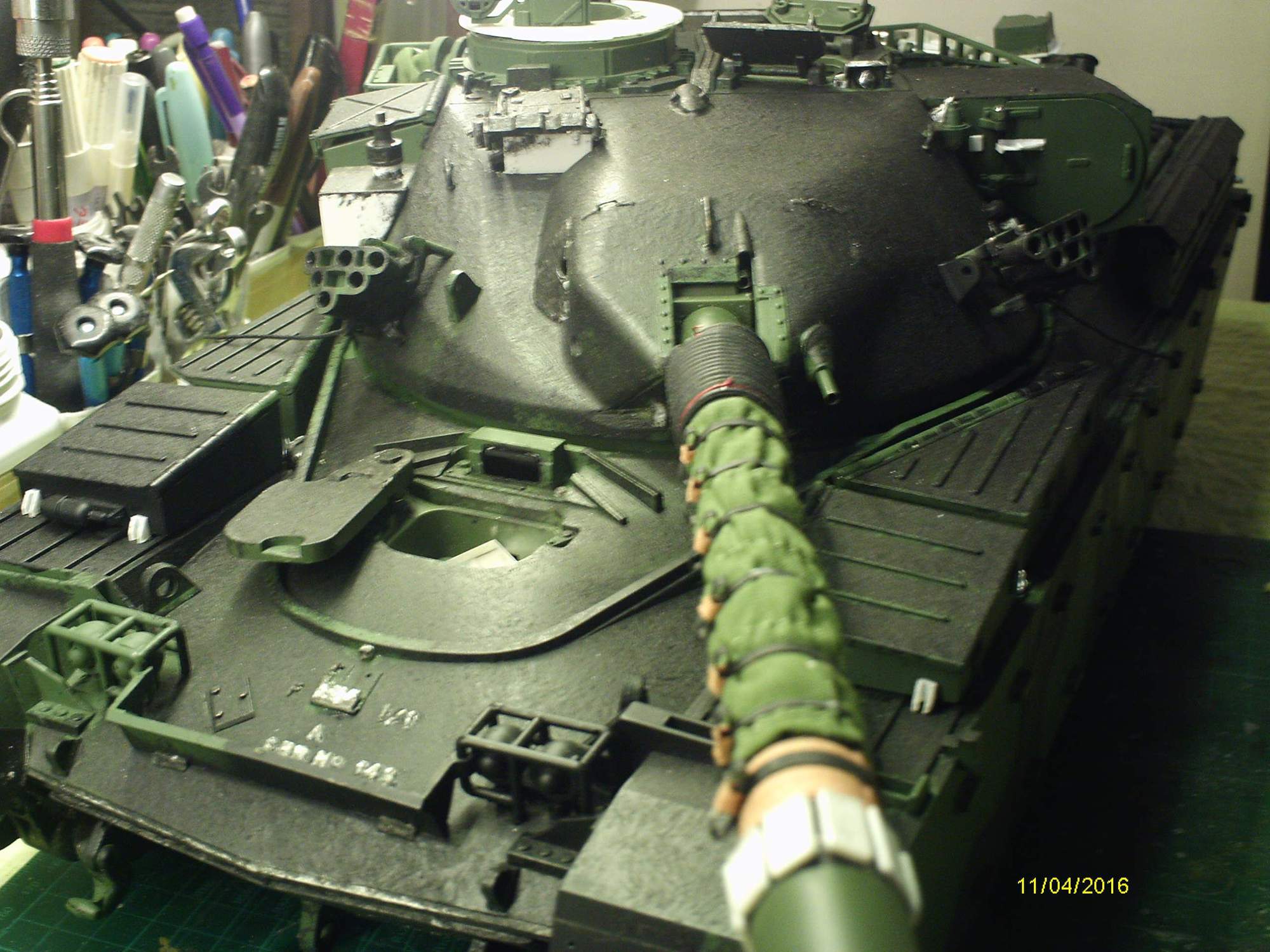

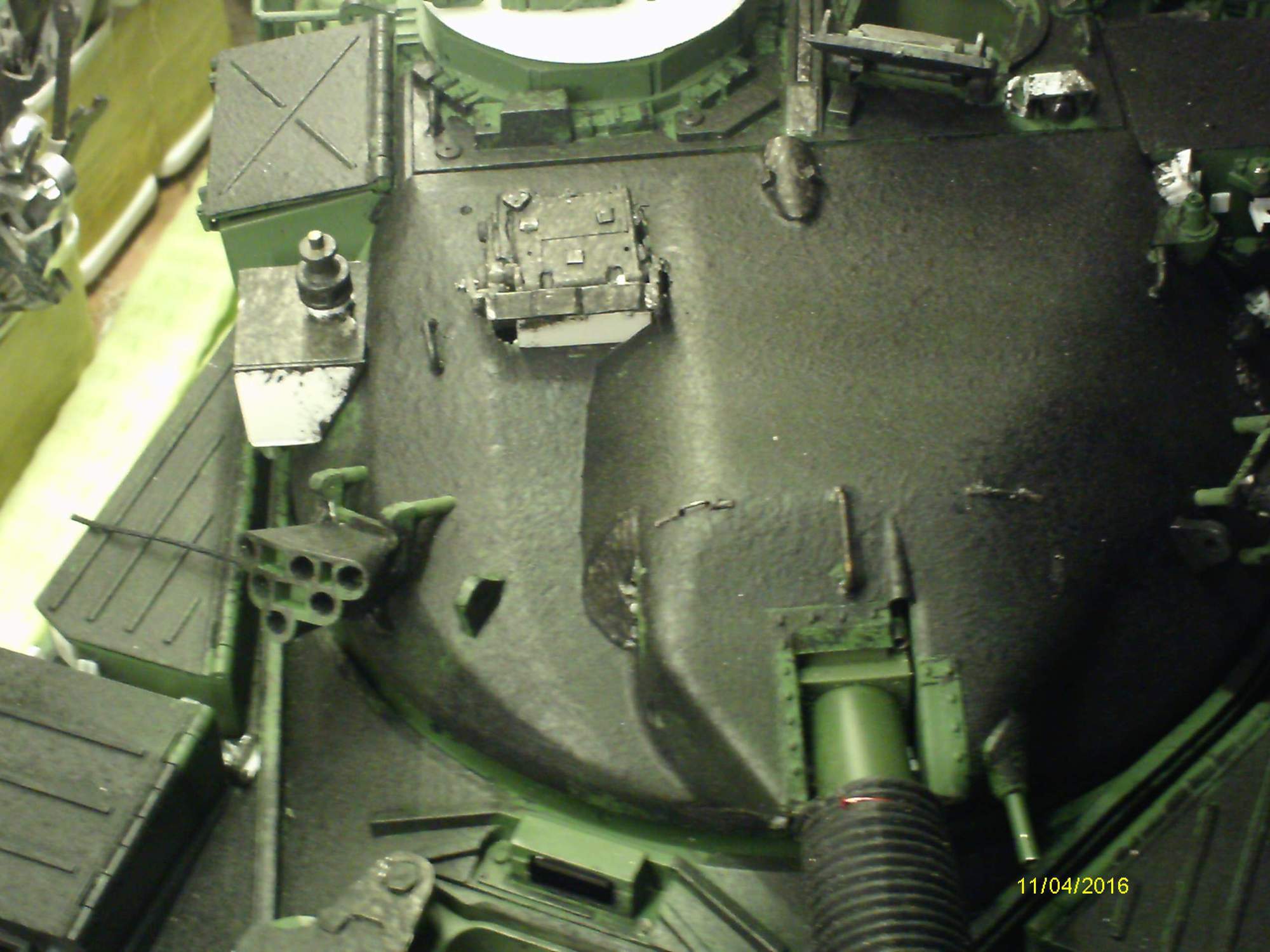

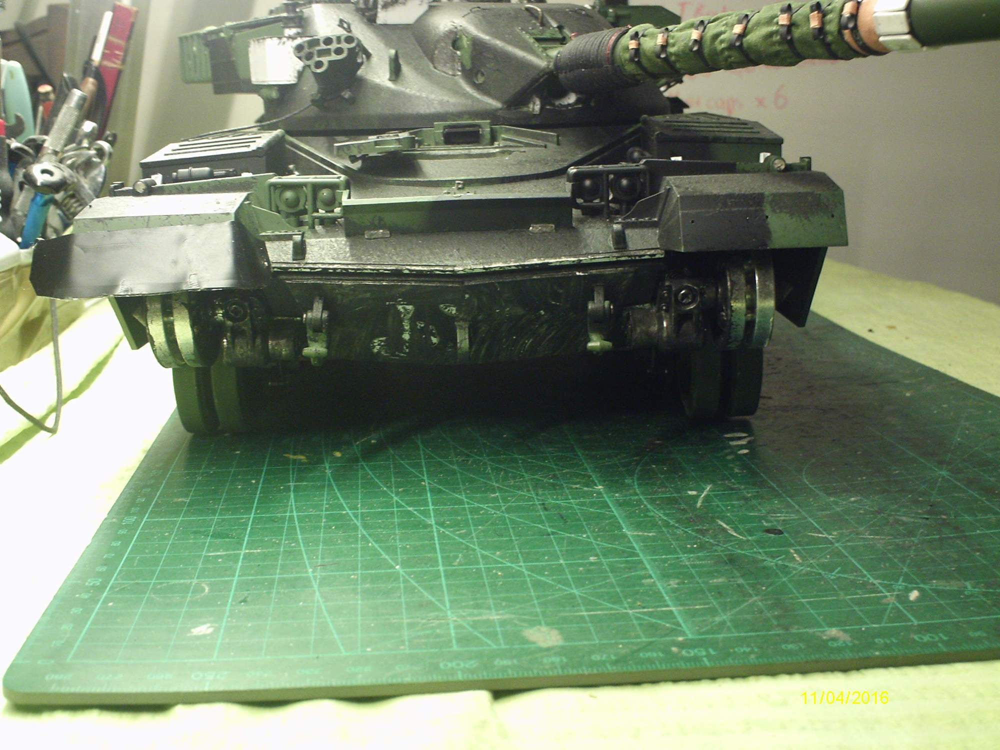

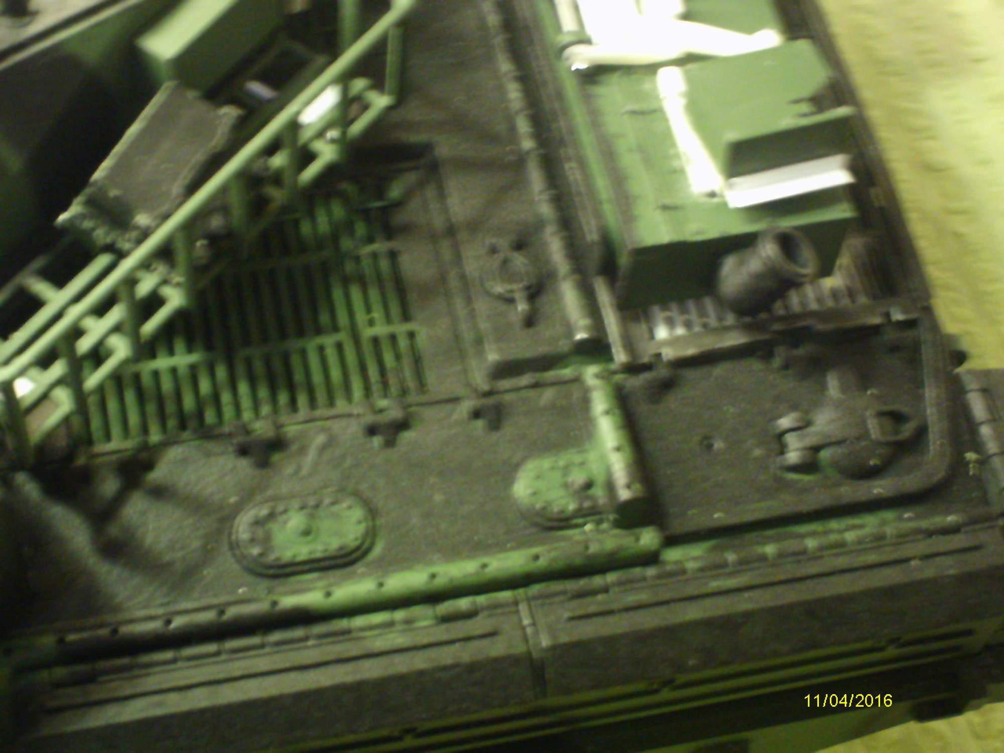

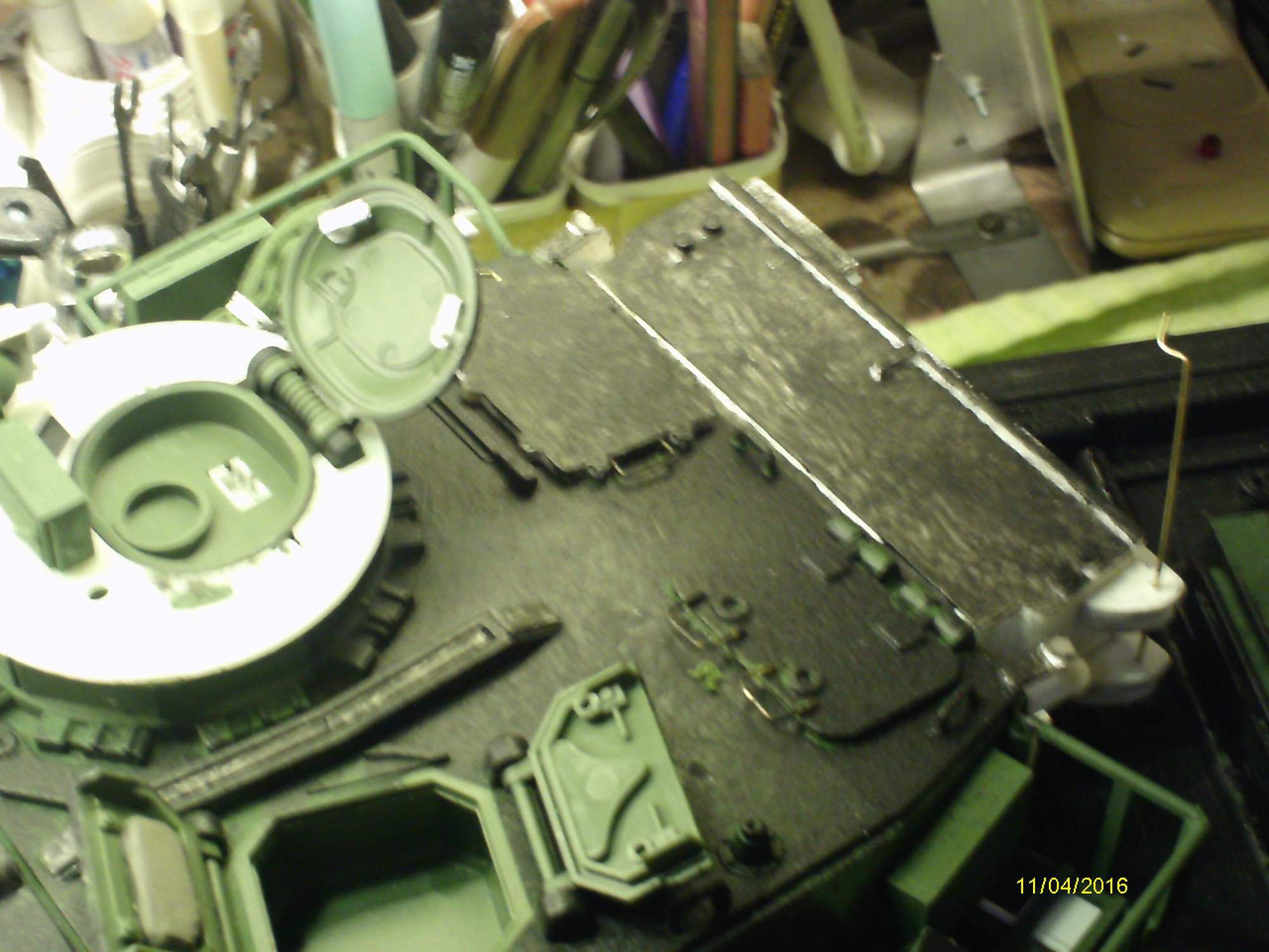

Havoc has been down for Maintenance for over a week now, thought I'd put up a couple of pics to show a bit of progress.
Mal
General fwd view - What A Job added to flat & cast surfaces as texture/non slip. Rubber shock boot to barrel, drilled out drivers periscope, new gunners periscope (shutter moveable) acrylic periscopes still to add
What A Job to cast surfaces & flat surfaces as non slip
Modified the MBSGD's (Multi Barrel Smoke Grenade Dischargers) to more closely look like the actual shape, drilled out the barrels & What-A-Job to the sides & top - cast areas. New Gunners sight - the shutter arm was very tricky & still not quite right
Haya 3D accessory kit provided cupola cover, but kept my own NBC pack (Mk 6)
Haya 3D accessory kit provided new gun clamp, now slightly modified
What -A-Job added to flat surfaces as texture/non slip
What A Job added to the bow plate & idler mounts - needs a 2nd coat - experimented with Flex Tape for mudguards, think heat shrink rubber is better

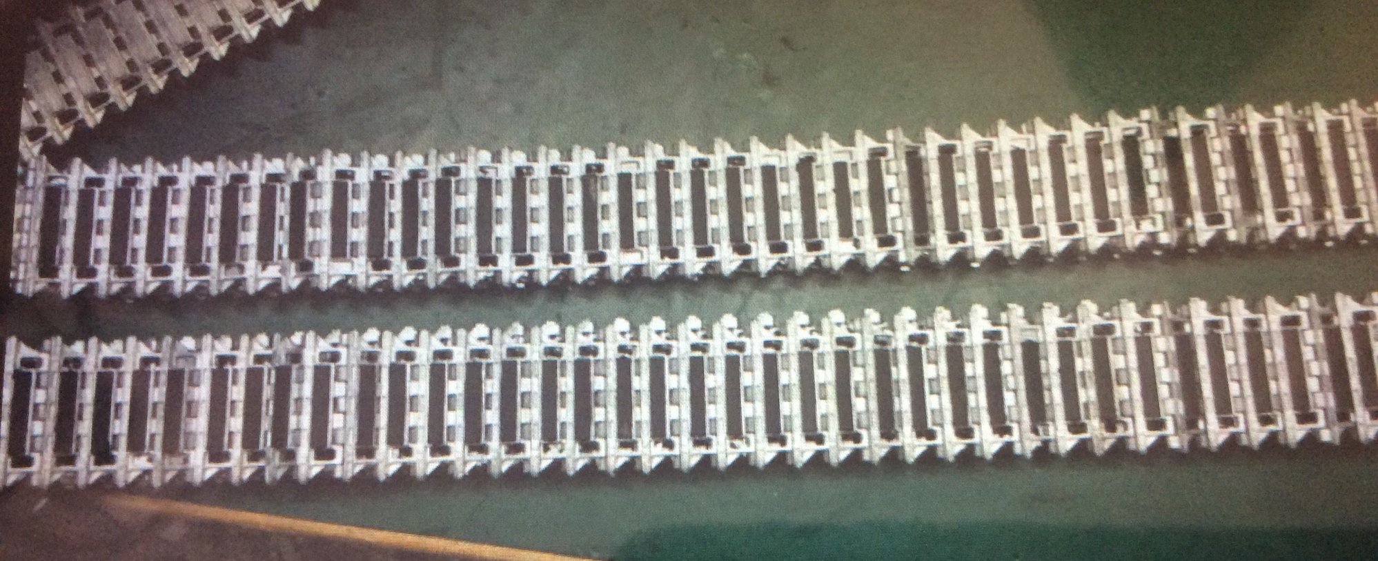

Just a quick heads up to let you know Andrew at Haya ltd is going to release new metal tracks with rubber pads. The tracks in the photos are Hayas pre production tracks in raw metal, the production tracks will become with a black finish. Pleas keep an eye on the Haya ltd U.K. web site for price and availability.

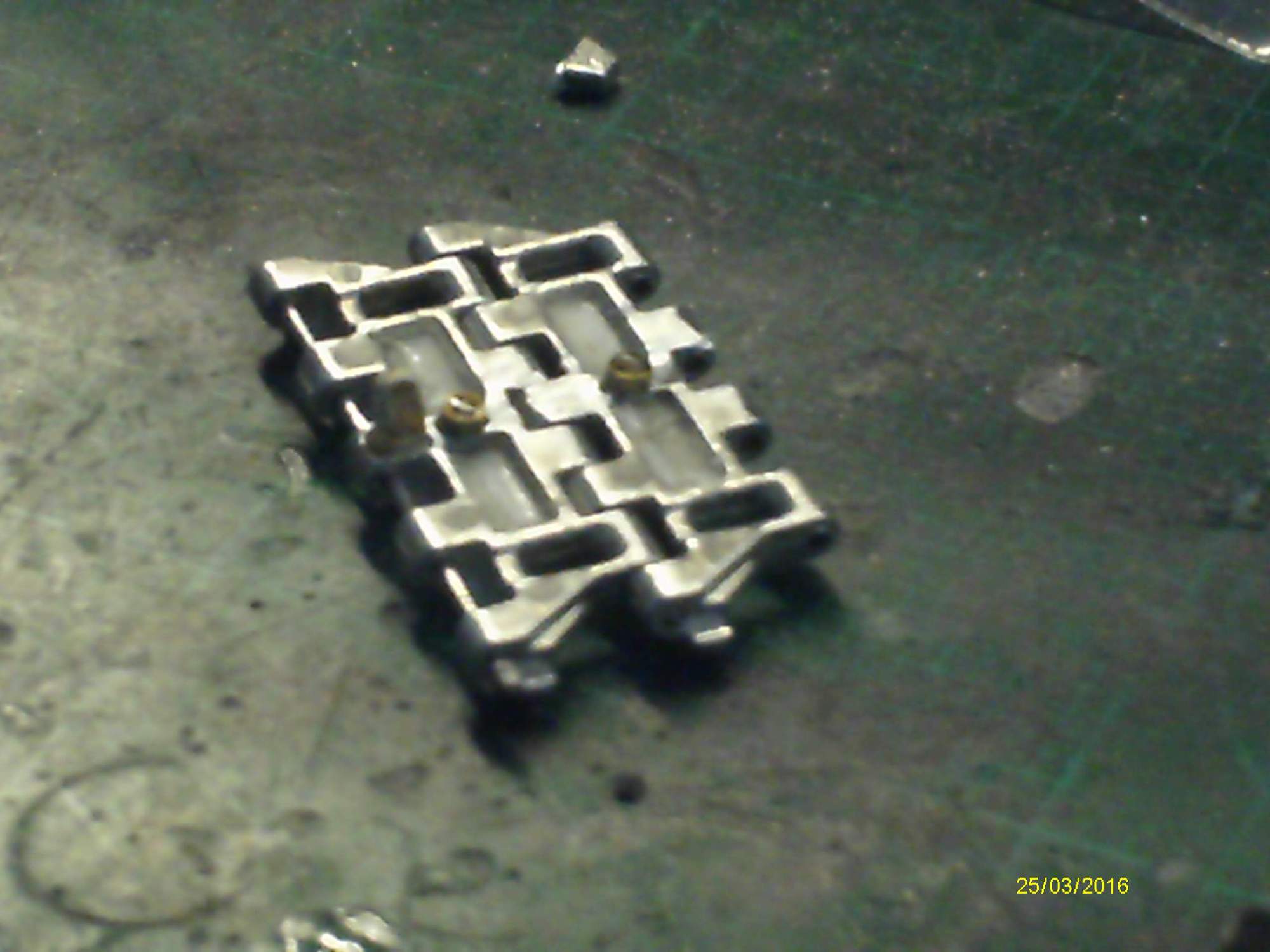

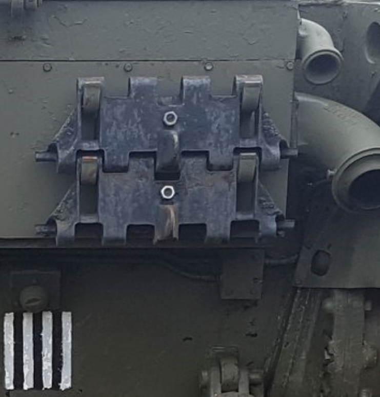

Someone mentioned the 1/25 Tamiya Chieftain as being the basis - my uncle had one of those back in the 70's or 80's - so I know it wasn't the basis, as it depicted one of the Prototype (P models) complete with the 2 piece searchlight cover, with the hinge in the middle & the glacis 'hide the angle" box on the bow - link to the model - https://www.scalemates.com/kits/tami...totype--280554 - it was originally released in 1967 & and has been re-released several times since with modified parts - one of which is the tracks - my uncle's one had rubber band tracks - unlike those in the unboxing review.

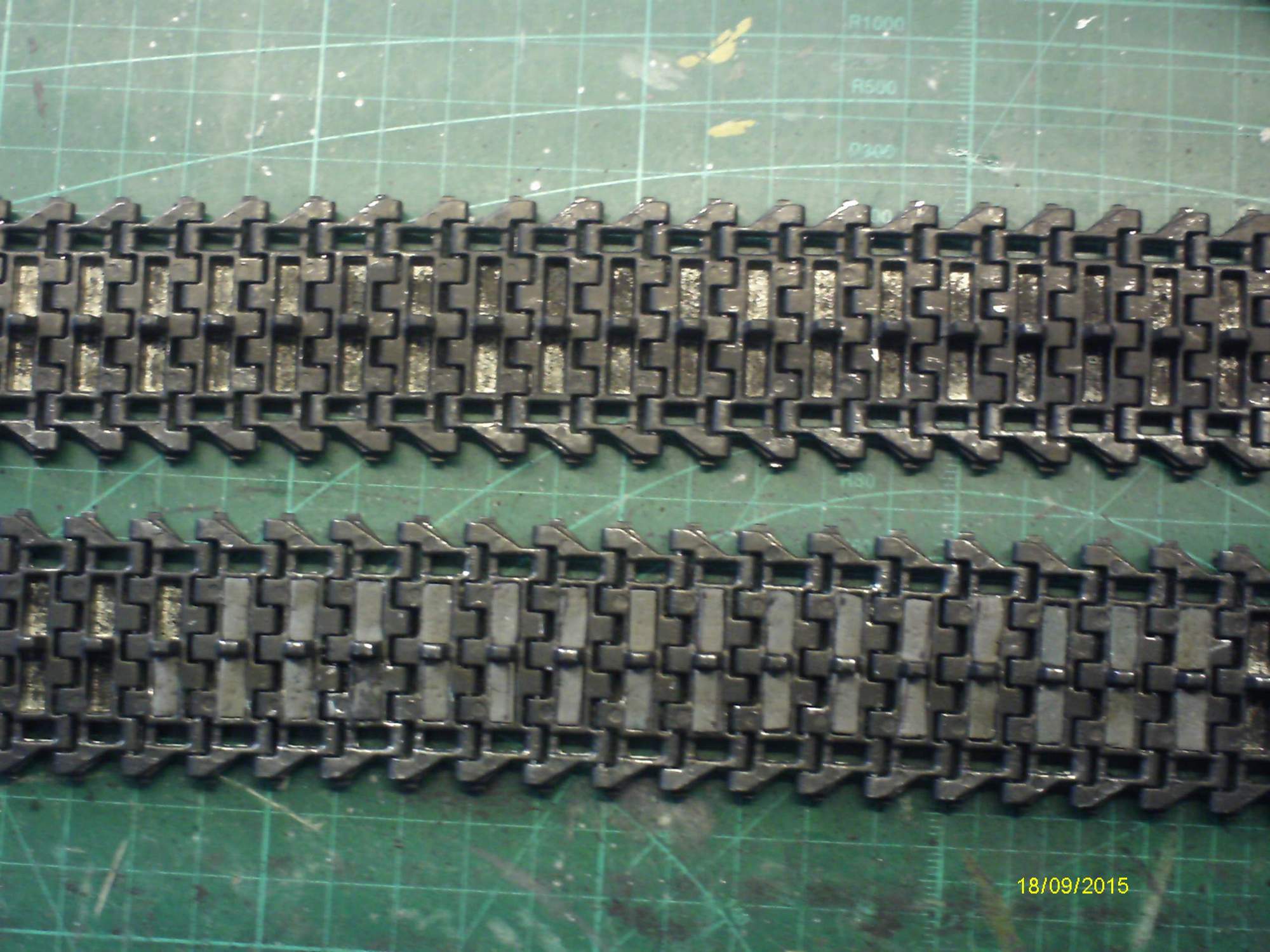

Wow, new tracks - do you have a shot of the back side? Do they still have the hollows in the back? And is the guide horn still centred or moved to the back edge as it should be?
Thought the hollows should be on the front, so a rubber pad could be fitted in them.
Chief tracks with neoprene rubber blocks to fill the hollows on the back - lower track, upper track with unfilled hollows
Guide horn moved to rear of track, nut added to center (secures rubber pad)
Stowed track, note prominent nut & rear placed guide horn
Track side view, note track pin holes are fairly large
Mal
