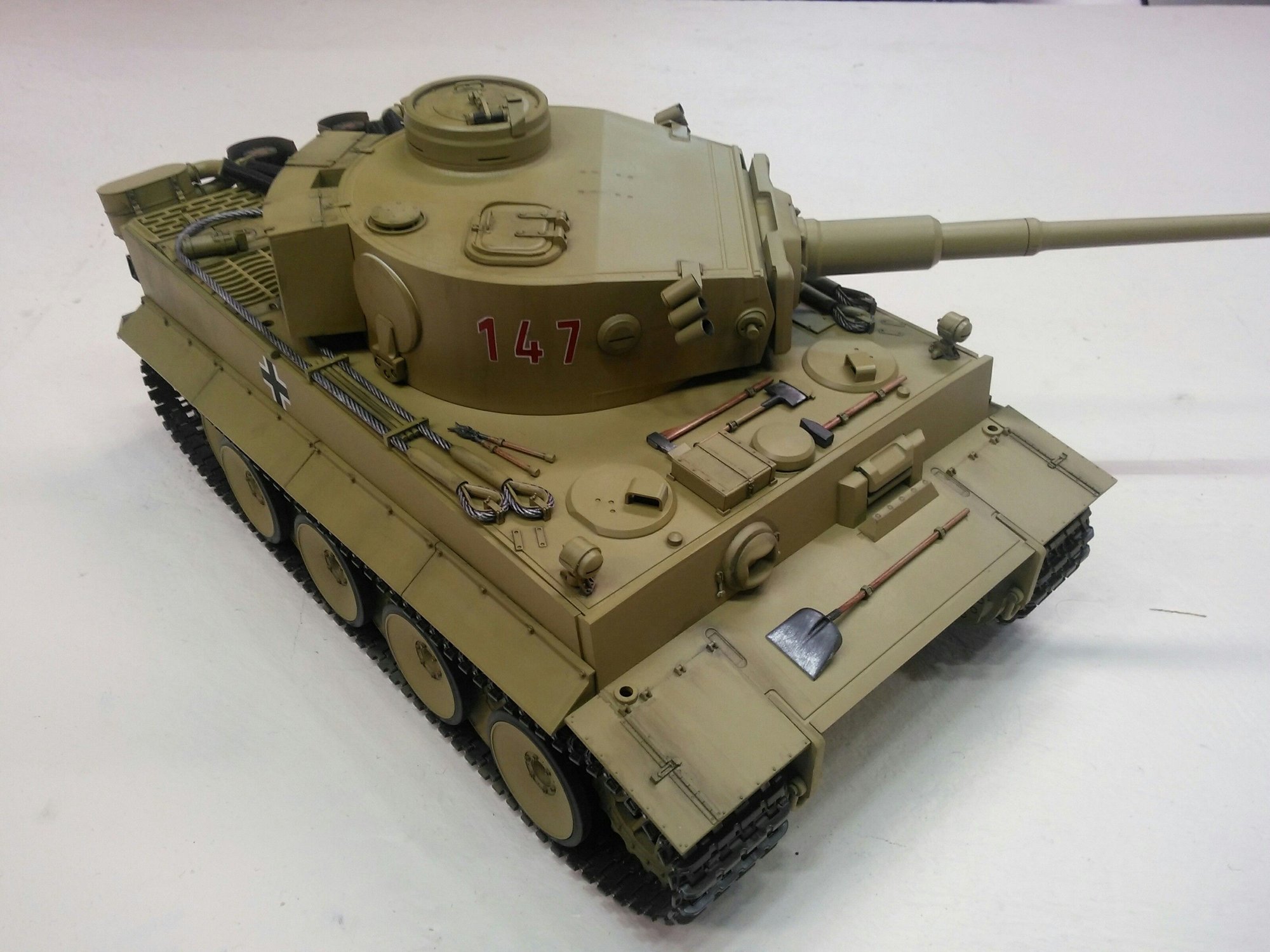

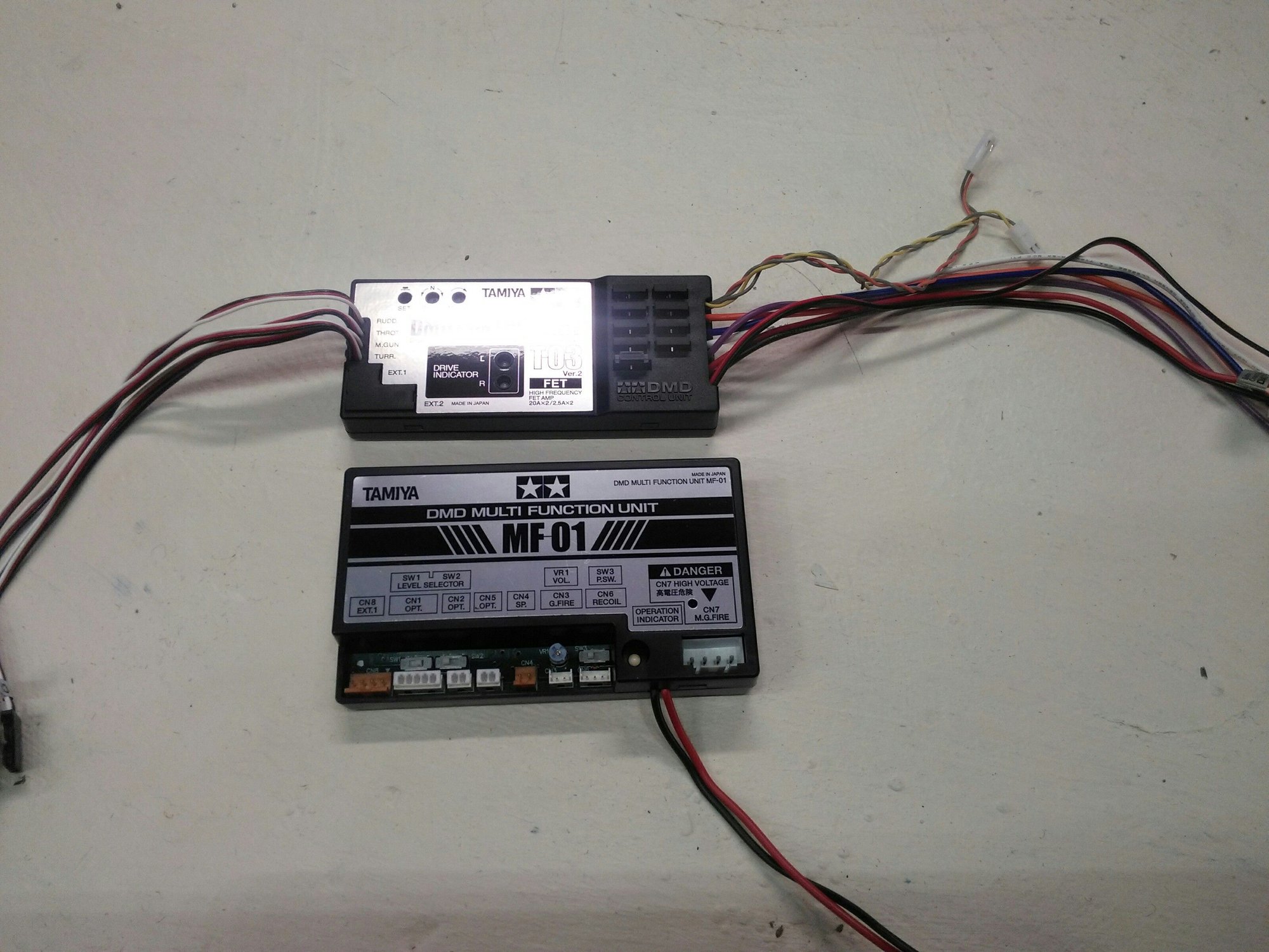

I have a quick question for all you Tamiya electronic experts. I am just finishing up a Tiger 1 and was curious if I could wire the two black boxes together so that they only run off of one battery. The DMD Control Unit & the DMD multi function unit each use a separate battery and I want to splice the power wires together so they share one common battery. has anybody done this? I realize the capacity will be only half of what the stock set-up will be & I don't really care as long as it runs for a reasonable time.
Another dilemma is how to get the battery in and out of the model, the top is held in place with two small countersunk screws that are covered up by the turret and if the turret is pointed straight ahead it will not come off! The only way to get the battery in and out is to park the tank with the turret off to the left so the retaining ears for the turret are lined up in the removal position, what to do?
I am sure there have been a million of these built and so with all the creative skills on RCU I am open to any ideas

No need to cut and join the DMD MFU wires. Answer is yes, use this Tamiya part. Order the part 56014 from the AAF Museum. The part works for all the Tamiya WWII RC Tanks. Go to the AAF web site, find Shop, Tamiya rc tank parts and accessories and I found the part you want under Pershing. And good looking Tamiya Tiger I!

The way the upper hull 'bends' in the center and with the turret tabs are at 12 and 7, I would do something with C4 and use a magnet there... maybe have those 3 screws as "locator pins". (drill out holes and glue in place on the hull)
I installed an Imperial Models Sturmtiger resin kit on a Tamiya TI back in 2005 (and just looked at the Tamiya assembly manual) and if I had as many mini magnets available back then it would have been so much easier.
