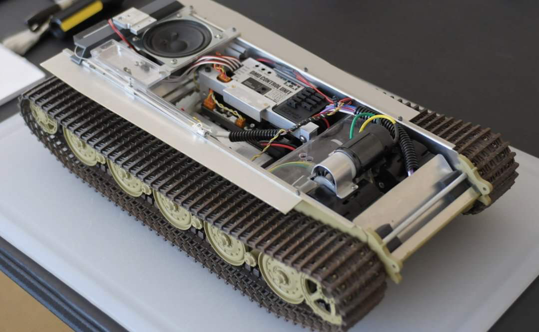

You will want to rough up the inside of the idler clasp and the outside of the idler drum for better adhesion to keep your idler adjustment in place. Springs are useless, if you get something caught in the track to make the springs work, it'll also probably break the track link. Also, if your track set has the pins going in from the inside, take the time to remove each and every one and insert them from the outside. Track pins tend to walk out a hair and it only takes a hair on a KT for the head of the pin to catch the rear plate as it goes around the idler, which will also break a link.
Attached are photos of a rear hull brace you can make from simple brass plate. Since the photo shows a much older KT hull than you have, simply make the plate flat to bolt to your hull sponsons on each side. You can also use the plate to give extra support to the upper real hull since you will no longer have the hull flex endemic with the stock hull. You can put another cross hull brace on the front of the hull, but be careful to position it to clear your transmissions.

My first Tamiya King Tiger full option RC IR model built stock out of the box was a good indoor carpet runner, but a complete failure when participating in outdoor RC IR Tank Club Battle Games.
After a couple of hours or so of club battle play the stock KT hull under the transmission stanchions was deformed, there was a slight twist to the right in the length of the hull plus the model was underpowered, climbed terrain poorly, and was not at all a competitive runner when compared to the other more dialed and upgraded club tanks. For RC IR club battle games the basic KT upgrade list included 400 motors, gear reduction units, gearbox mount brace, metal elevation arm and hull sponsons to help keep dirt out. The KT kit tracks did break links during even slow turns, indoors or outdoors, so I later went to metal tracks and the Daryl Turner spring loaded idler system from ETO Armor, but reluctantly.

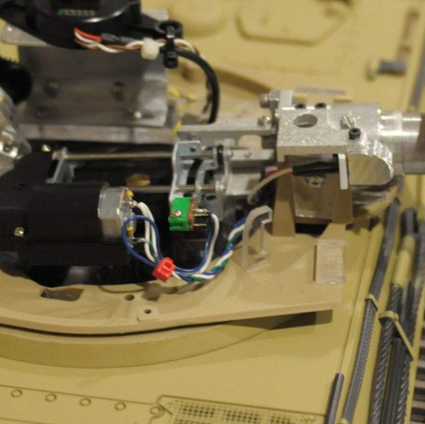

I sold that first KT model on and later commissioned Daryl Turner to design, engineer and fabricate the ultimate Tiger II Porsche Turret RC IR club fighter. After receiving the magnificent hull and turret system back from Daryl, a mutual friend bought the by then finished model from me, as I had lost interest in Infrared battle games. Anyway, study Daryl’s hull, it his total concept on what a proper club fighting hull is. To me, this is a great example of his past and best custom work! The turret elevation and recoil system is a work of art too and all parts are maintenance serviceable. The build uses the DT spring loaded idlers. The project cost was way less than what you might guess. The USA Tamiya KT Porsche Turret static kit was $175.00. Parts and Daryl’s fee for custom work was under $700.00.

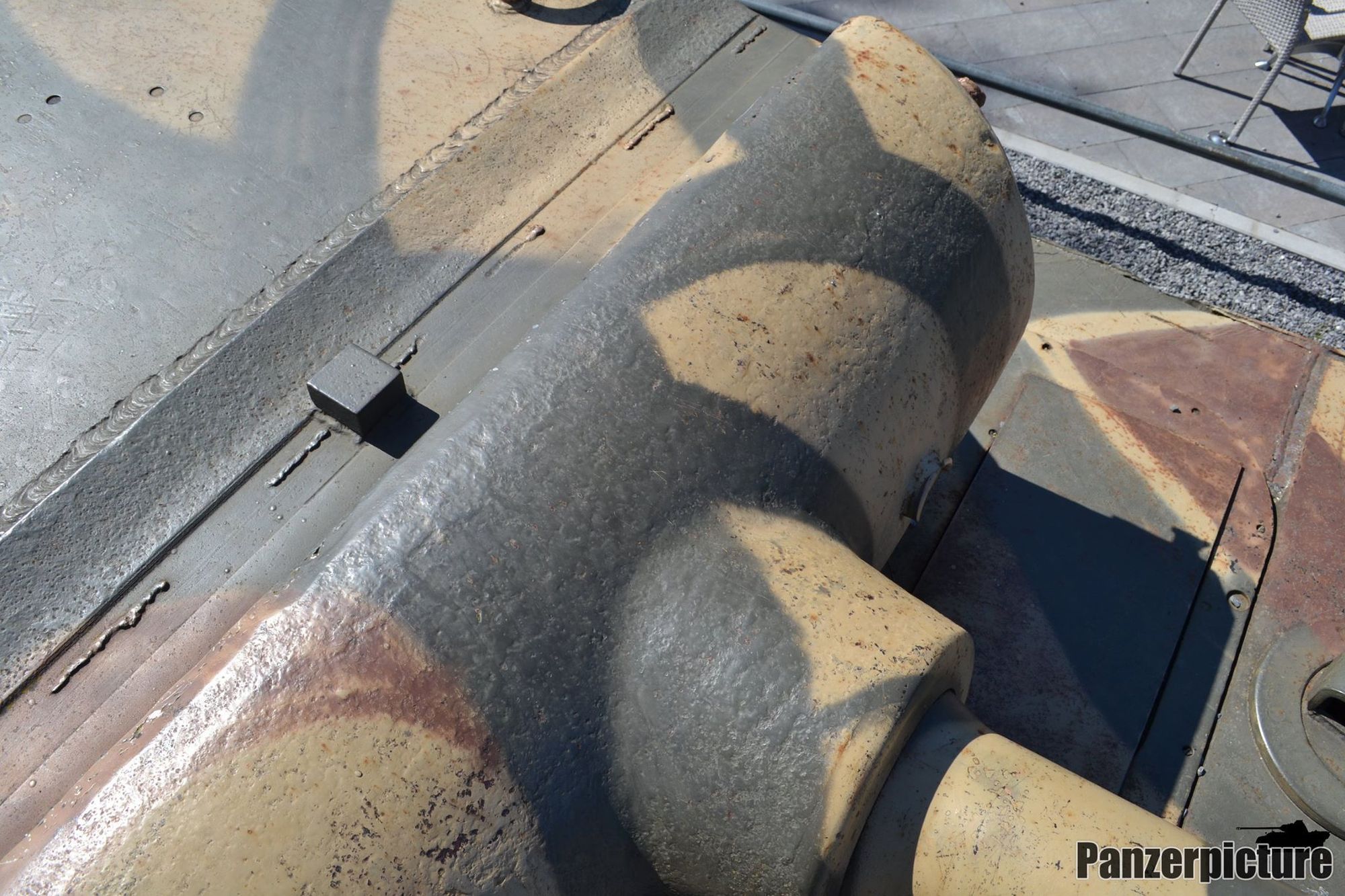

Coming in from a scale modelling background, there is an issue with the King Tiger far worse than the idler, the tracks, or any other mechanical concerns.

See it yet? Really poor form from Tamiya. I know its an old kit, but this forces you to either use Zimmerit or texture it.
The Tamiya Zimmerit is really pathetic. Its very soft, and pretty much unusable. Your choices are either to buy the $100 Atak zimmerit, or buy a tub of putty and spend several days putting Zimmerit by hand, which I feel is the better way.
My build is an extremely late war KT, so no Zimmerit. I won't teach you how to do it. Instead, I'll point you to a really good channel:

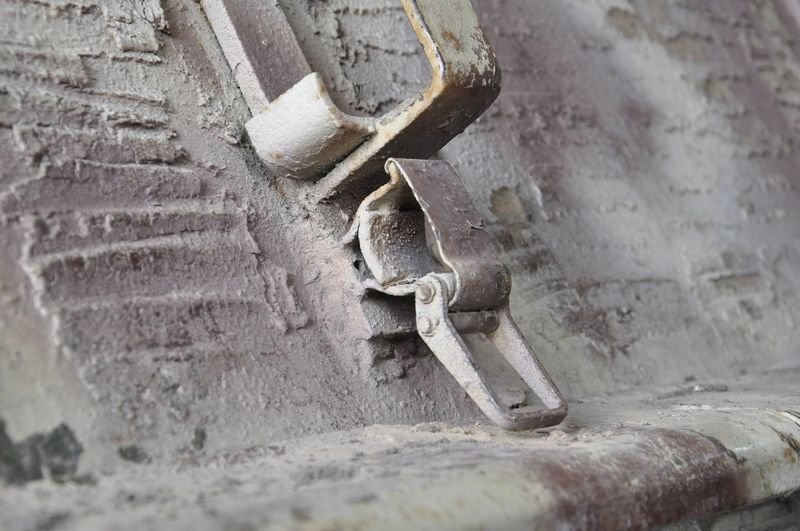

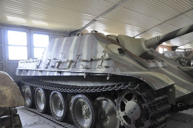

A few photos of examples here:
Artemis2020 (01-26-2020)
Old 11-10-2019, 07:22 AM
sevoblast
Join Date: Feb 2008
Location: East
Posts: 2,952
Received 6 Likes on 6 Posts

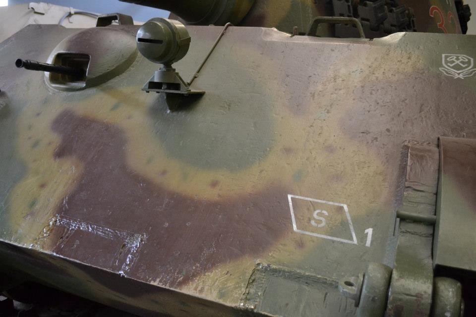

My only advice is don't overdo the pitting and roughness of rolled and/or cast steel. One has to remember that most anything we see today is over 75 years old and more and much of it has not had the best of care. Extensive exposure to moisture and general abuse whilst stored often in open air lots takes it's toll. However, the only absolute is there are no absolutes. Here's a couple from Kubinka including Object 279.
Also, tanks and AFV's in general usually don't last long enough to become a rust streaked fugitive from a junqueyard. That, and no Spiess or Shirt or Starshi Sarjant worth his salt would allow that to happen in his unit.
