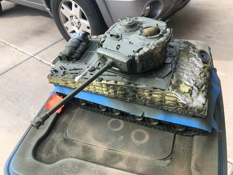

Hello, I am a Sherman-o-holic but the truth is this is the first 1/16 scale project I tried to achieve way back in 2005. Technical issues and some personal failures led to my going with a different up-armored easy eight that is still running after all these years. This time around I just sat down and started the process of making the sand bag racks and eventually the sand bags. Found the brass strip I needed and lots of super glue. I admit the project stalled at that point for two years while life got in the way. Now I have the parts and 6 boxes of milliput to get me through!
Surplus EASY EIGHT project acquired in a trade.
Styrene and brass oh my.
Foil on the trans cover as the bag need to seperate from lower for service

This project was shelved for nearly two years after the bars were done. No time, no funds, other issues came forward. I event parted some of the assembly out for sale. That changed at the last DAK battle when I acquired a set of T66 tracks and enough of the remaining parts to make it all run. It was time to start the sand bags and now I am 6 boxes of Milliput into it.

Foil is gonna stay as a backing and now the set is complete. Added some foil twists to simulate the bag openings. Thus upper parts are now a bit heavy as you may guess so it is time to beef up the the traverse and confirm my innards are still working! I transplanted a set of Pershing electronics from another shelf queen that cannot stop shedding tracks.....

Pushed along and am at the Painting stage. Base coat is Rustoleum Camo Olive. It is a good Primer for the Brass, Plastic, Epoxy, Resin, and Foil. A little Dark for wartime OD but thats what airbrushes are for! Not to mention it dries pretty fast! Second color is Tamiya Earth Brown for the sandbag Base Coat. Then I did different bags in Deck Tan, Dark Yellow, Desert Yellow, and Buff. Next the racks got Flat Brown as the bar stock must have oxidized a bit. Most models I see have the racks tank painted base color but I doubt the tanks got that treatment. Oh Well, Khaki Drab painted over most of the bars.
Next comes a dry brushing with Mission Models Portland Stone. I started to detail some of the stowage and painted the spare Bogie.

Stripes on... Tamiya NATO Black sprayed on with the Iwata NEO. Thinned 50-50 with X-20 Thinner.
