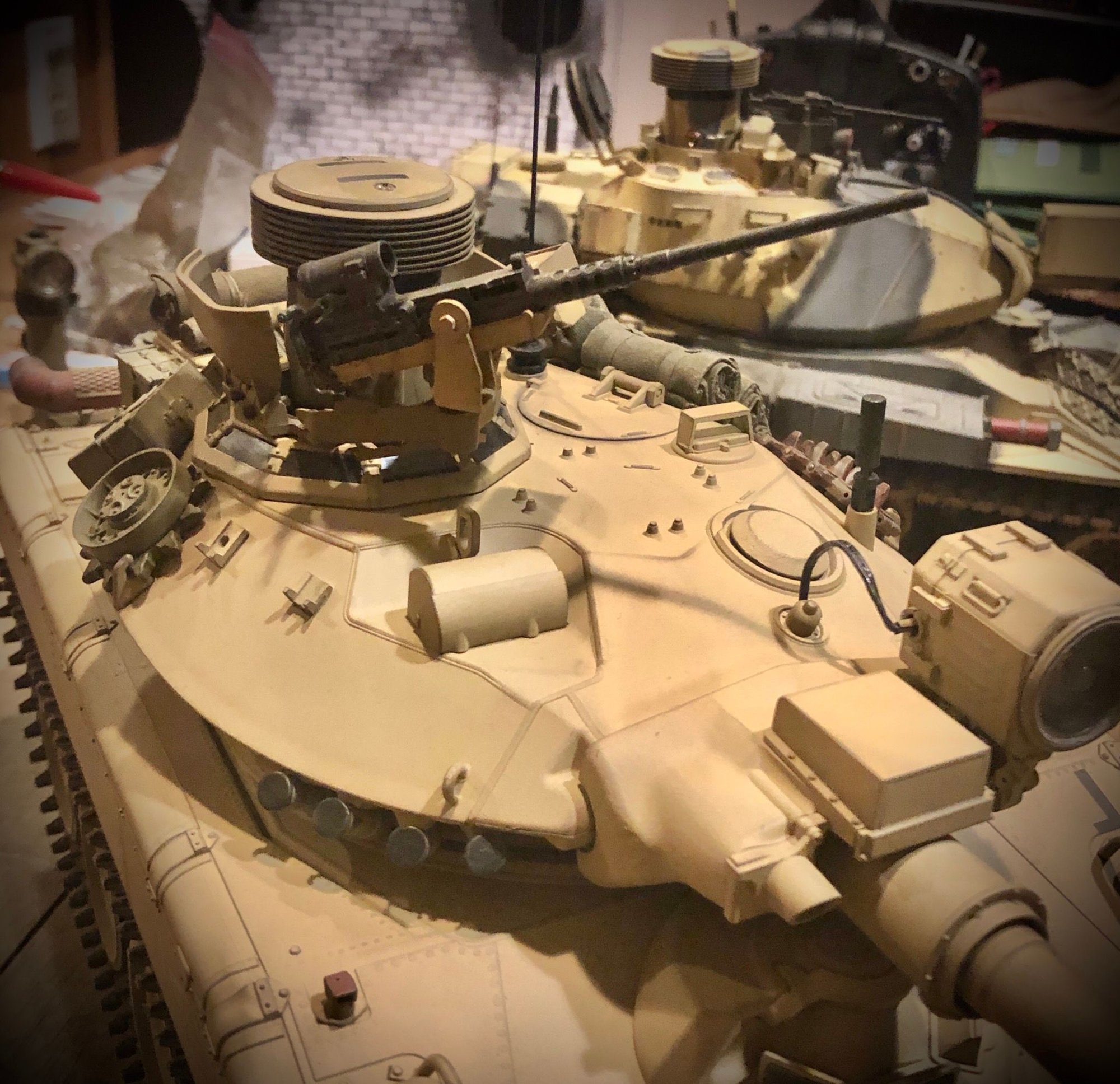

Below are a few photo of a new copula I set up specifically for use in IR battling. I deleted the forward “bullet shields and added a plastic turret basket similar to the one mentioned/shown prior in the review to hold the copula in place. I righteously tested to ensure that even as pictured there were NO issues with receiving hit from the forward 45 degs. and all angles that correspond with the Tamiya hit protocols from 0-75+ ft. Testing was done with the help of a Tamiya M51/M4, Tamiya Abrams and 6.0 HL T72.
IR specific copula installed in turret with standard static/general running copula in the right foreground.
IR specific copula install on turret. NO issues with IR beam interface caused by MG or hatches.
