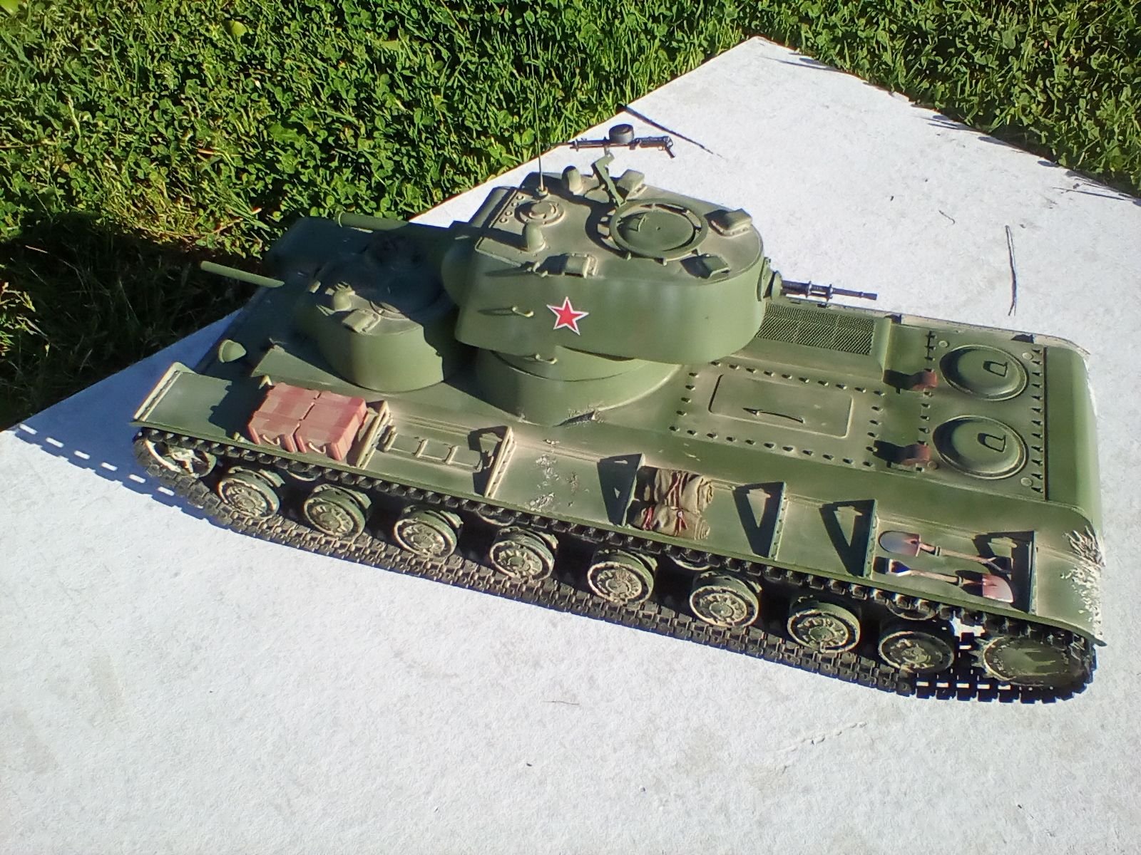

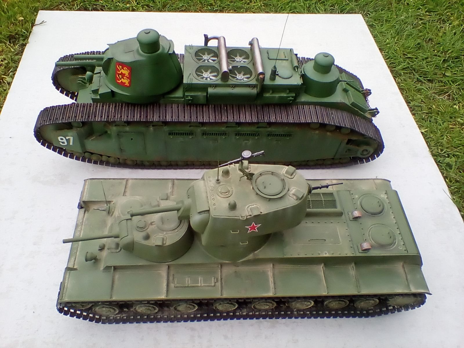

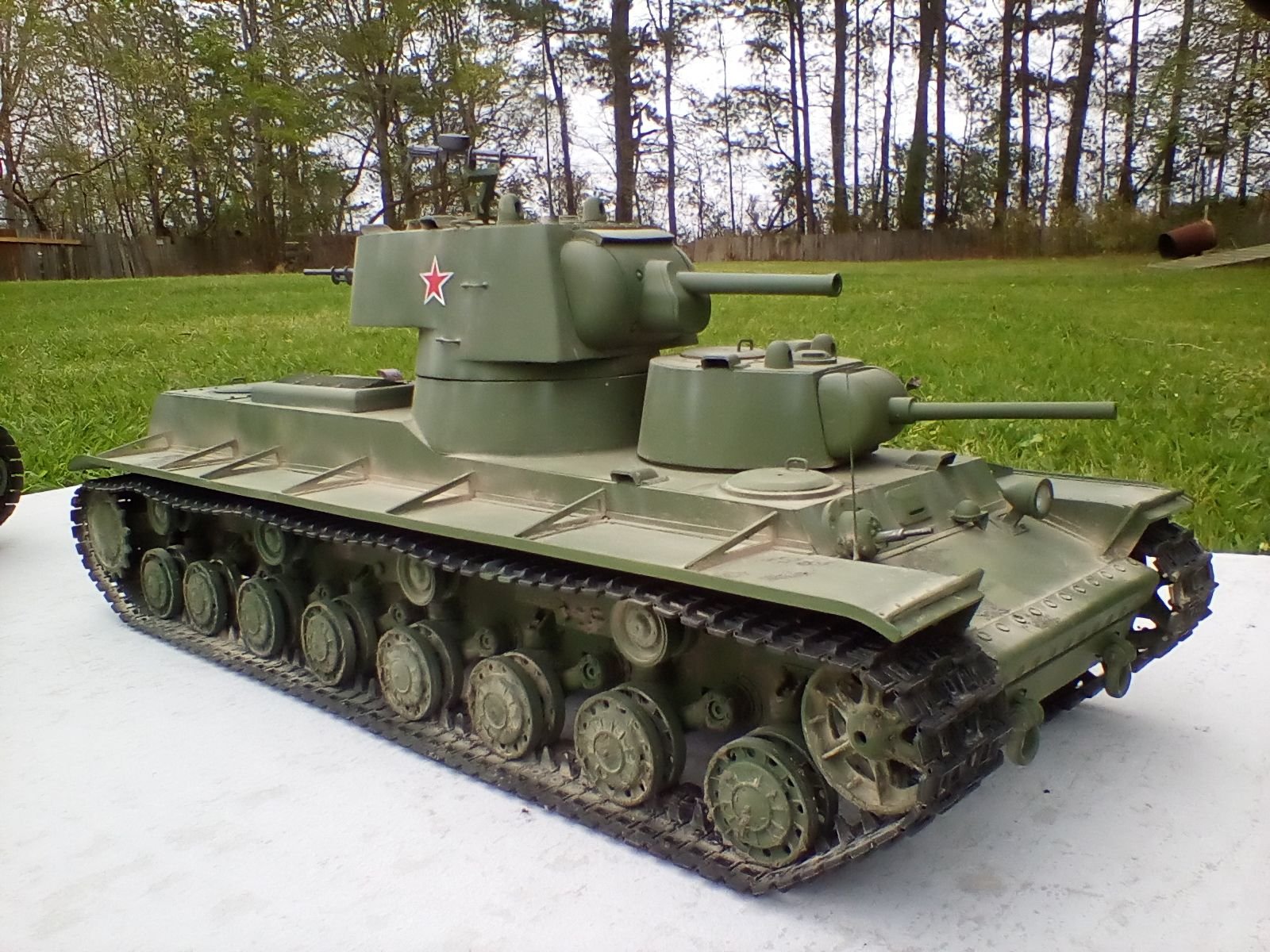

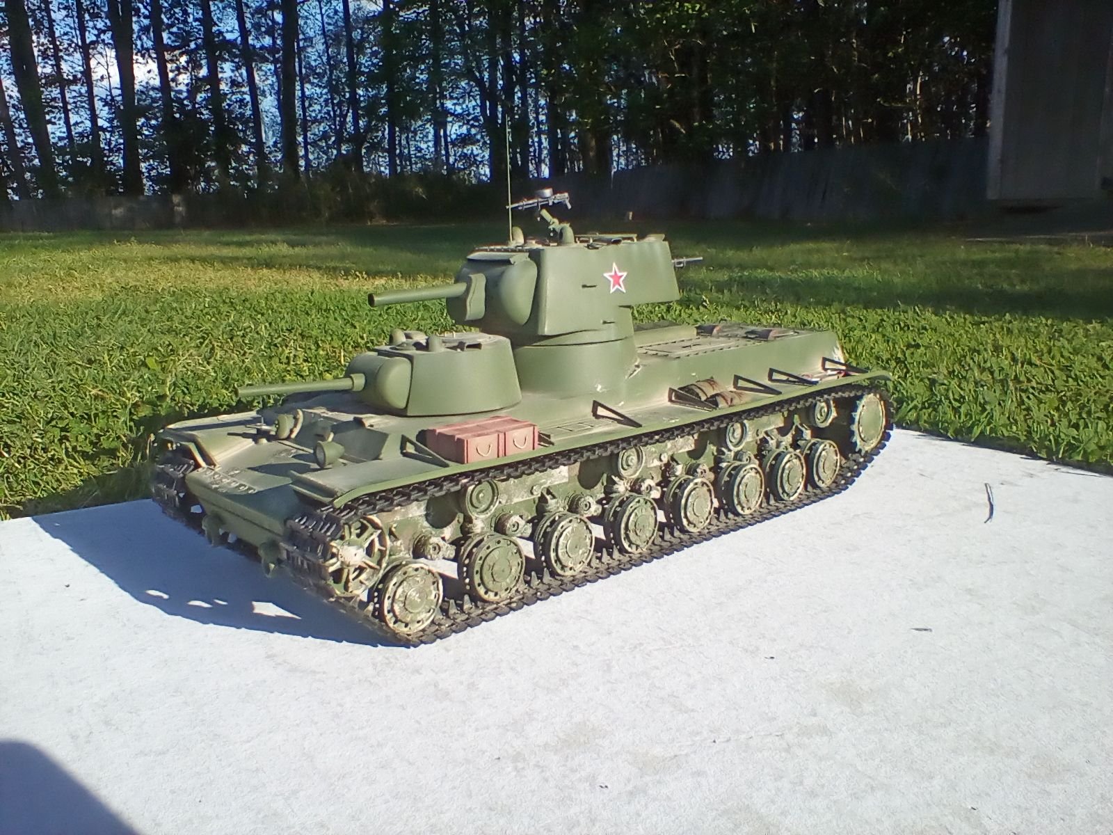

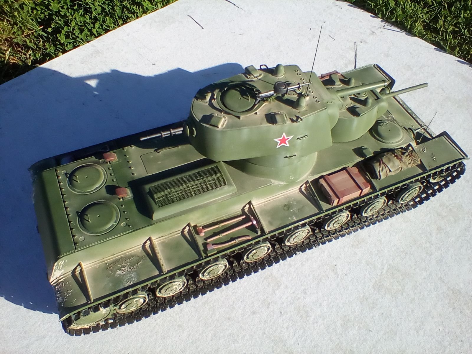

With all this time off from work I am spending a bunch of time in the shop. The 1/16 SMK project is almost all done except for the tools that were stowed on the fenders, I am going to wait before ordering the 1/16 tools but I did kinda finish the paint and weathering (read that as got tied of working on it!)
As of now I left the Henglong radio in the model so that at least I can drive it around to make sure the treads and drive train all work good, when I am convinced it will run good I'll spring for another IBU2 board so I can battle at the Danville tank museum.
I built the model by cutting two Henglong KV-1's in half and scratch building the turrets and upper hull from G10 sheet, same as the Char 2C.
I hope everyone is staying home and staying safe until this Covid 19 blows over!

Thank you Martellus, Today I finally can call the SMK done for paint and exterior parts! I ordered 2 sprue "A" trees for the Tamiya Sherman model from the Danville Tank Museum which had the tools that I needed to complete the fenders of the SMK. I also took the liberty of adding a few crates & rolled up tarps on the fenders just to give it a more "used" look.
I still have to order another IBU2 board so the thing can play with the Tamiya tanks at Danville but that can wait till this Covid 19 gets done running it's course. Until then I can drive the model with the Henglong radio that the KV-1's came with.
You never did build your SMK?
