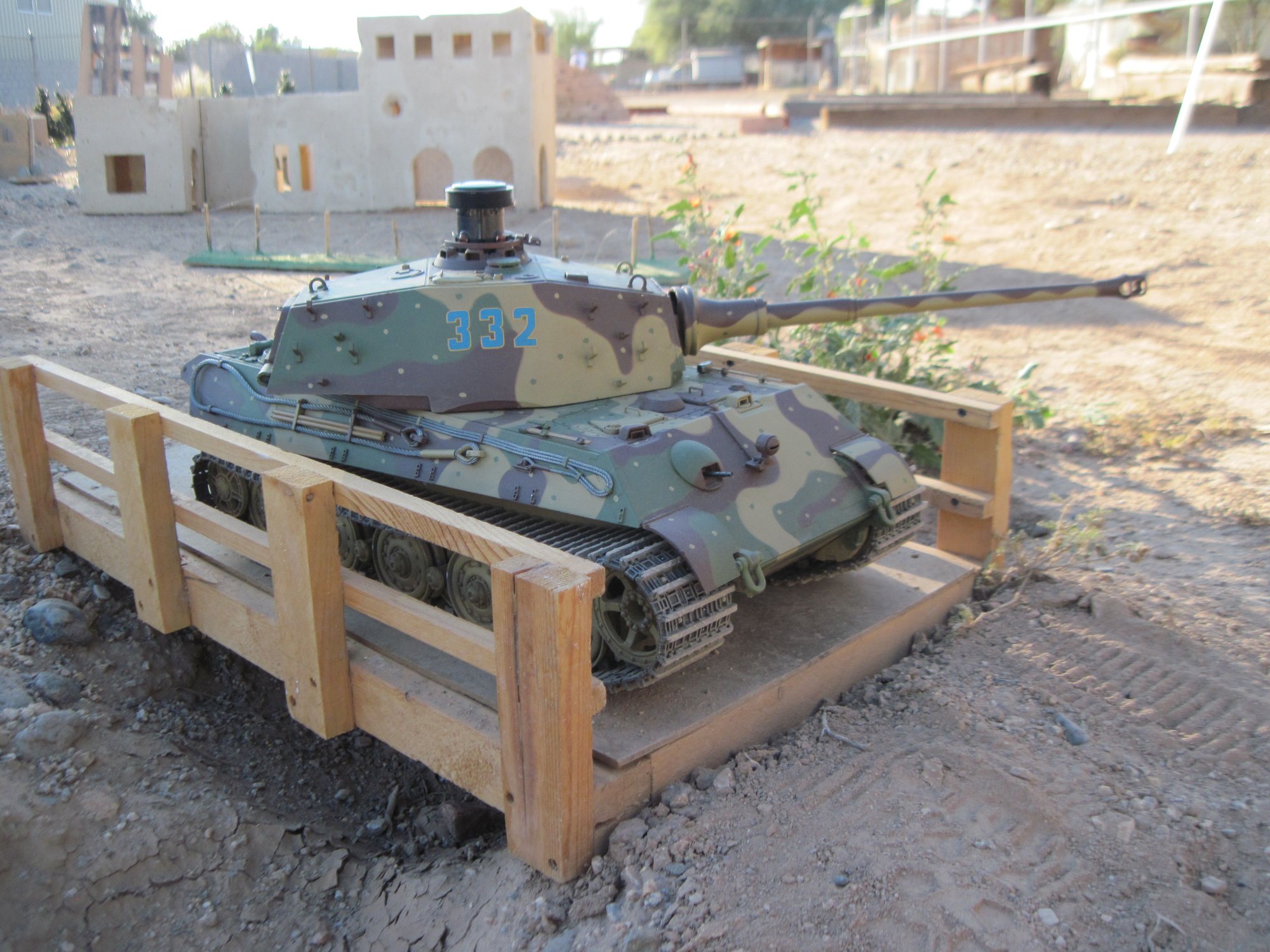

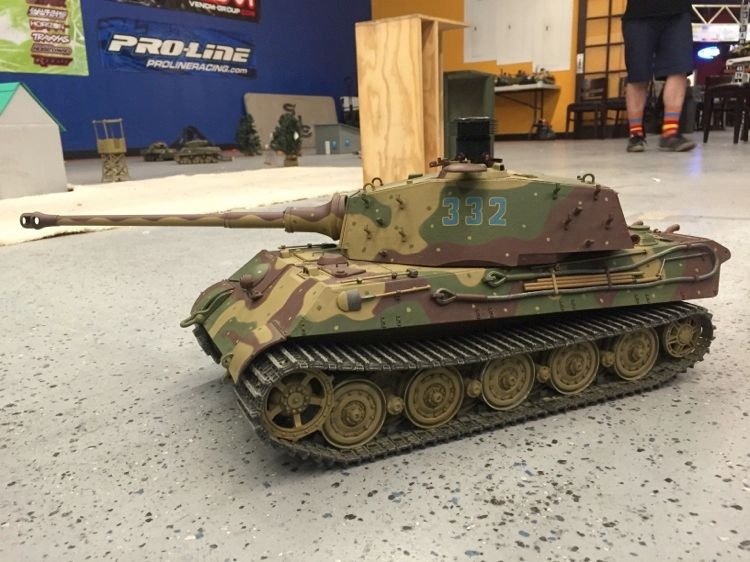

Forgot to mention I have Bob's gearboxes in my King Tiger! Don't have a photo of the gearboxes but do have a few of my Tamiya King Tiger.
Duane
