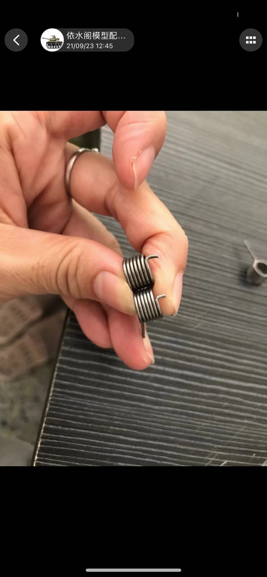

Just got a Pro JP for my son & finding exact same issue. Anyone know the spec for a stiffer spring? Thanks.
Took awhile but as thought, mine appears to be one of those Mon/Fri builds where the workers got the springs screwed up. Have ordered the correct hard springs meant to be installed on front & rear arms from an aftermarket seller. Will have them here within a day for the princely sum of $2.00. Gotta love China even when they screw things up.
