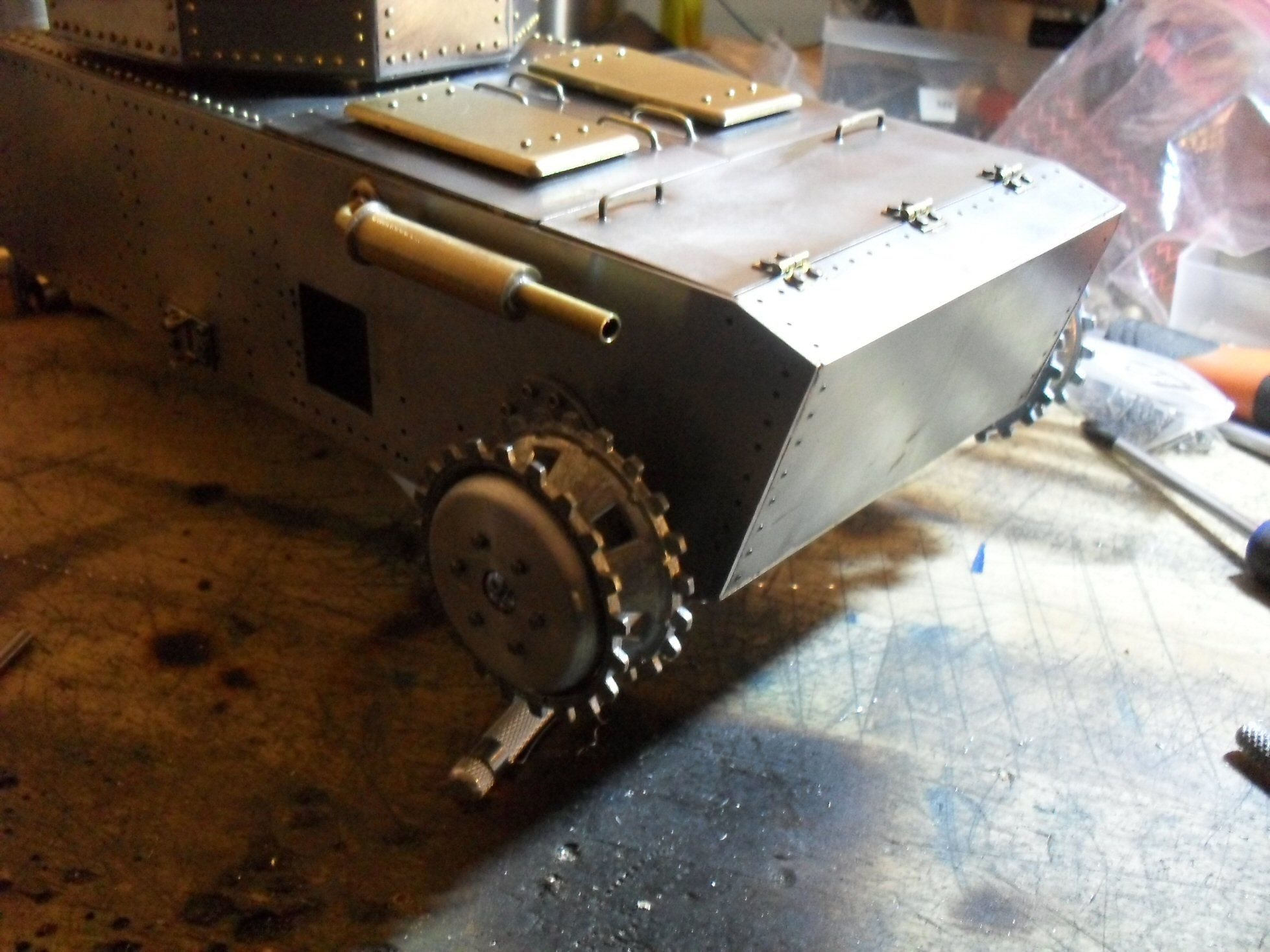

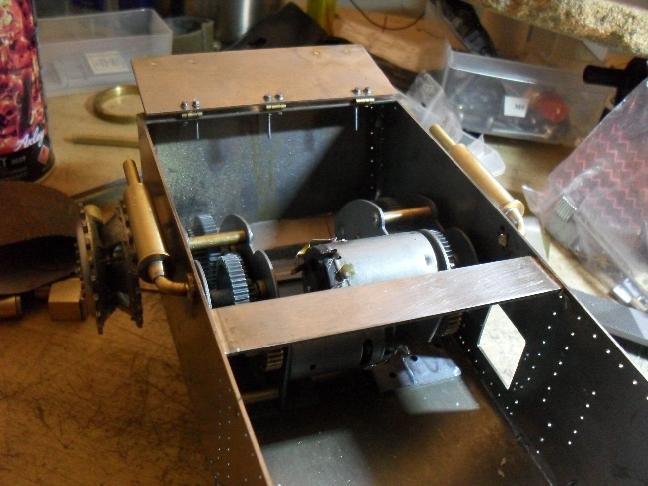

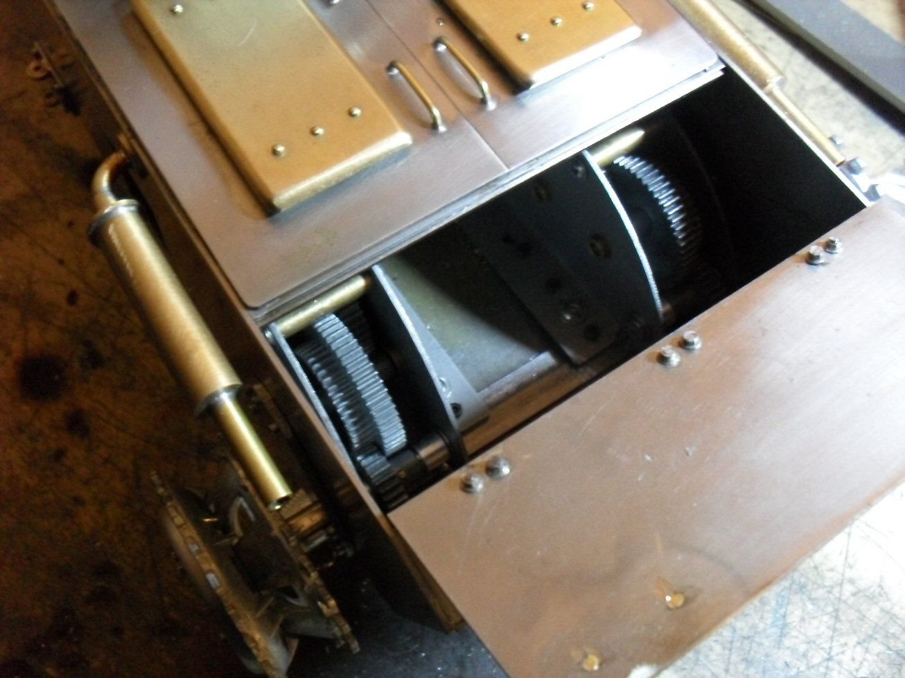

Another big moment today ..... fitted the gearboxes and sprockets. Despite a bit of a mess in original measurements, the boxes went in with 1 mm to spare under the deck. They seem fairly rigid although there is very limited room for anything else in the hull and one corner of one box is visible when the left hand side escape hatch is open. Nothing I can do with that as cutting off the section would leave the integrity of the box much reduced.
The sprockets went on fine.. the big phillips head screw is a temporary fixing until I find something more appropriate.. next thing now is the idlers I guess which will be a bit of a hassle as I am still without suitable taps. Damn you slow ebay deliveries.....

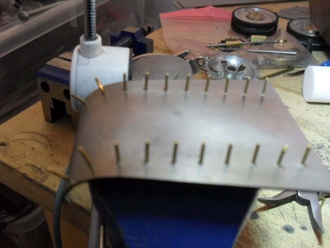

I'd agree with the other poster those rods appear to be a type of track tension device.
As for soldering, you might want to try a technique where your treat the inner side with a good solder flux then place small pieces of solder
at various places ( holding the model on it's side) on the inner side and gently heat the area with as low of a flame as you can get away with.
In this way you should be able to 'wash' solder over a larger area securing multiple rivets at once.
Alternately you could make a tool to actually flatten the inner portion so the rivets actually function as rivets.

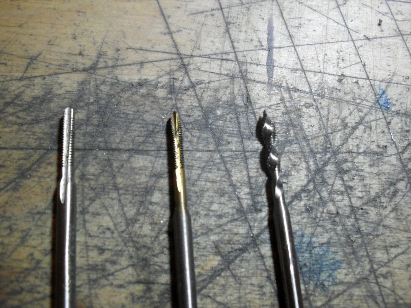

Today some taps showed up! Not from germany, but from China. Ordered two days after the Germany order and showed up quicker. Not often that happens but we are in strange times.
As an aside..... I dont think I have stumbled over these before. I normally use cheap as chips straight flutes (on the left) or the spiral flute taps (on the right) which are great for blind holes.
The one in the middle looks like a straight flute but has a strange cutting edge at the tip. Maybe I dont get out often enough but I checked and I dont have any like this.
Either way..... they really worked well and before two hours were up.... I had a full set of road wheels!! Progress at last!
P

Great job on the road wheels, they look really good. I'm pretty sure that Center tap is a spiral point tap made to go in a machine. They make them different if they're going to be used by hand or in a production machine, like a screw machine or CNC lathe or Mill. The reason the spiral flute is so great for blind holes is because that's what they're made for. If I could only get that through to the people I work for. I keep telling them, for thru holes you want a spiral Point tap and for blind holes you want a spiral flute. Think they listen to me? Because of my occupation I had to educate myself about Taps and what all those stupid numbers and letters really mean and I've been doing this for years, and I've probably forgotten more about Taps than my boss will ever know, but he still keeps buying me the wrong taps!
Old 10-01-2020, 09:12 PM
  #42
lposter
Join Date: Mar 2010
Location: Oslo, NORWAY
Posts: 697
Received 13 Likes on 11 Posts
I did not know there was such a thing as a machine tap. Worked pretty well as a hand tap though! The little cutter on the tip seemed to get it started a lot better. Even better than the usual "first" tap in a set of three.
Learn something new everyday!

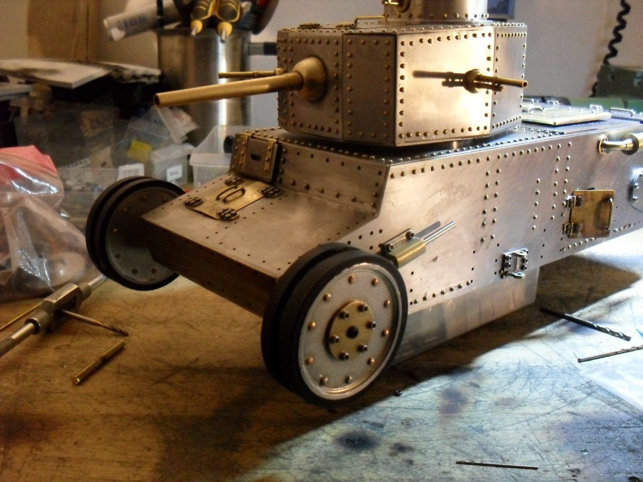

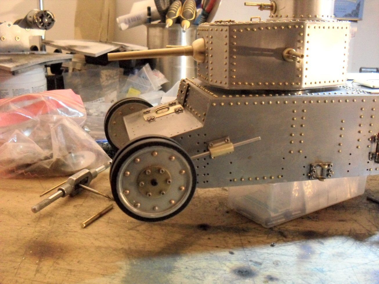

Test fitting of road wheels today. For anyone who remembers a certain Chi-Ri...this could have gone badly but it seem my measurements were OK an dthey have loads of space.
There are problems however. Mostly the fact that they can rotate freely. Im hoping that stuffinga strong spring in there and the guide teeth on the track will hold them pointing the right way.
If not there is no way to fix them in reality as there is very little space in the spring chambers at all.
Im not too worried though. There is nothing that a stiff spring cannot solve!

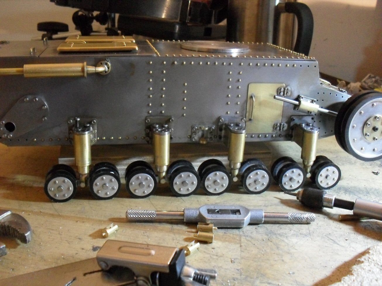

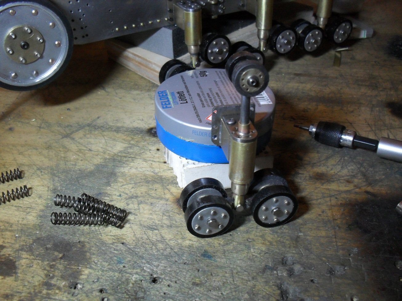

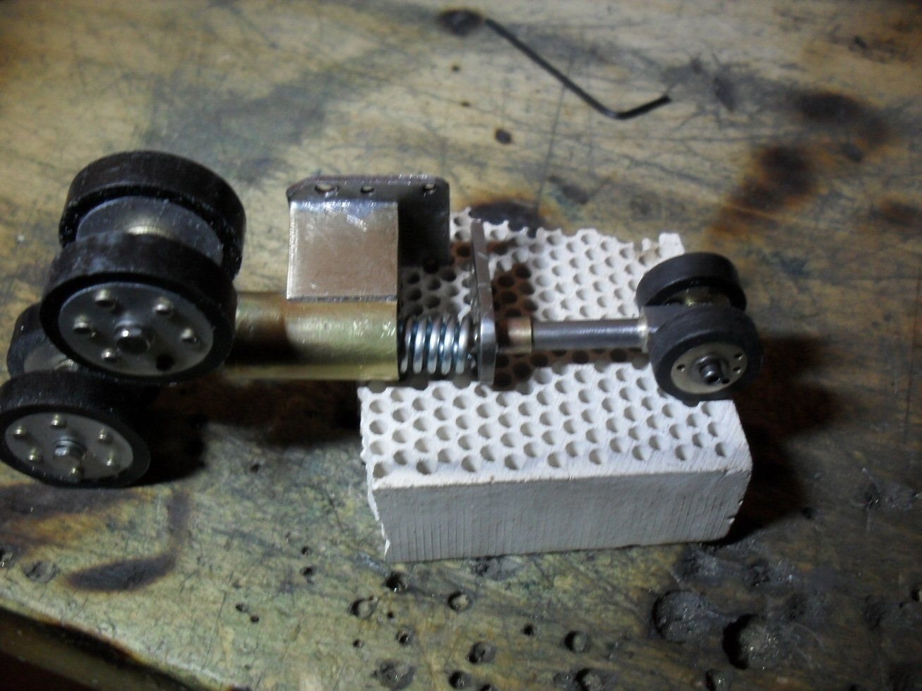

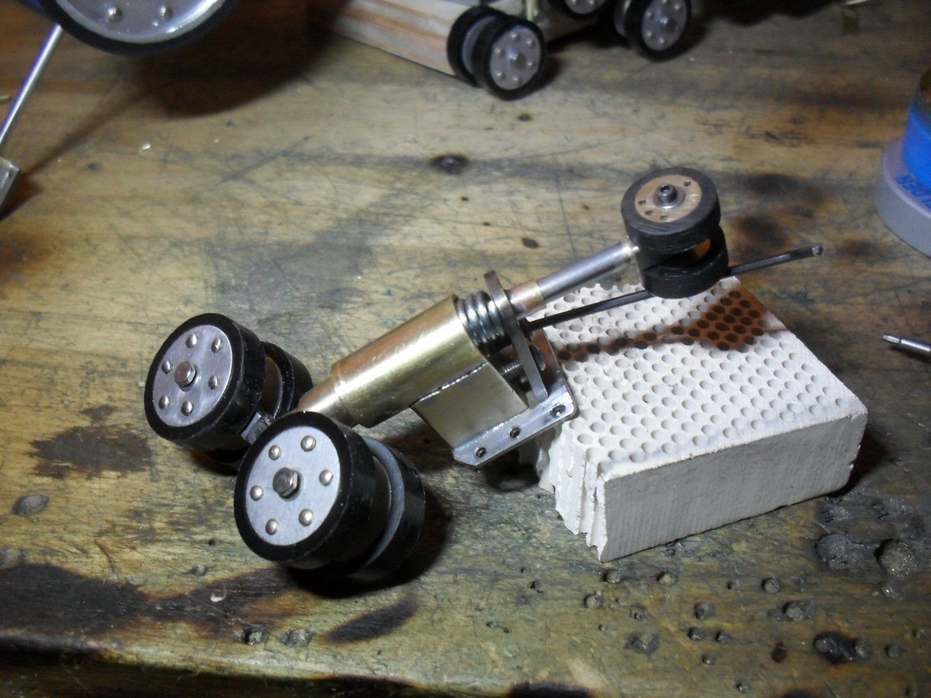

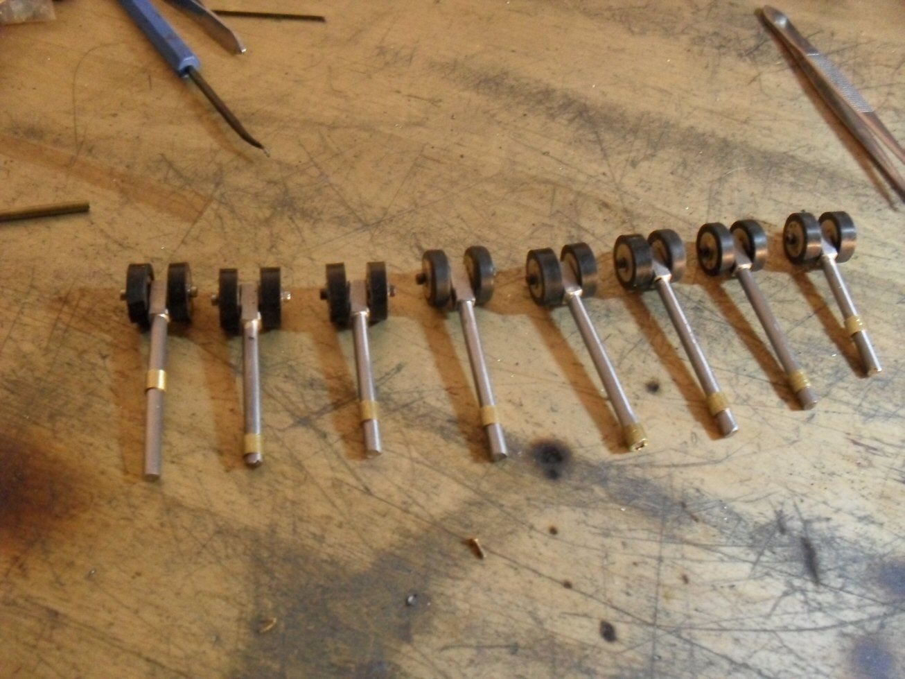

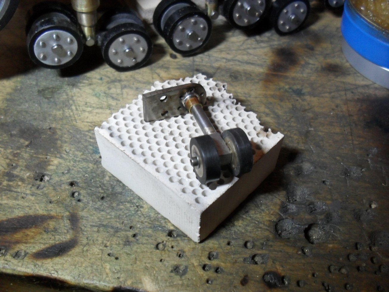

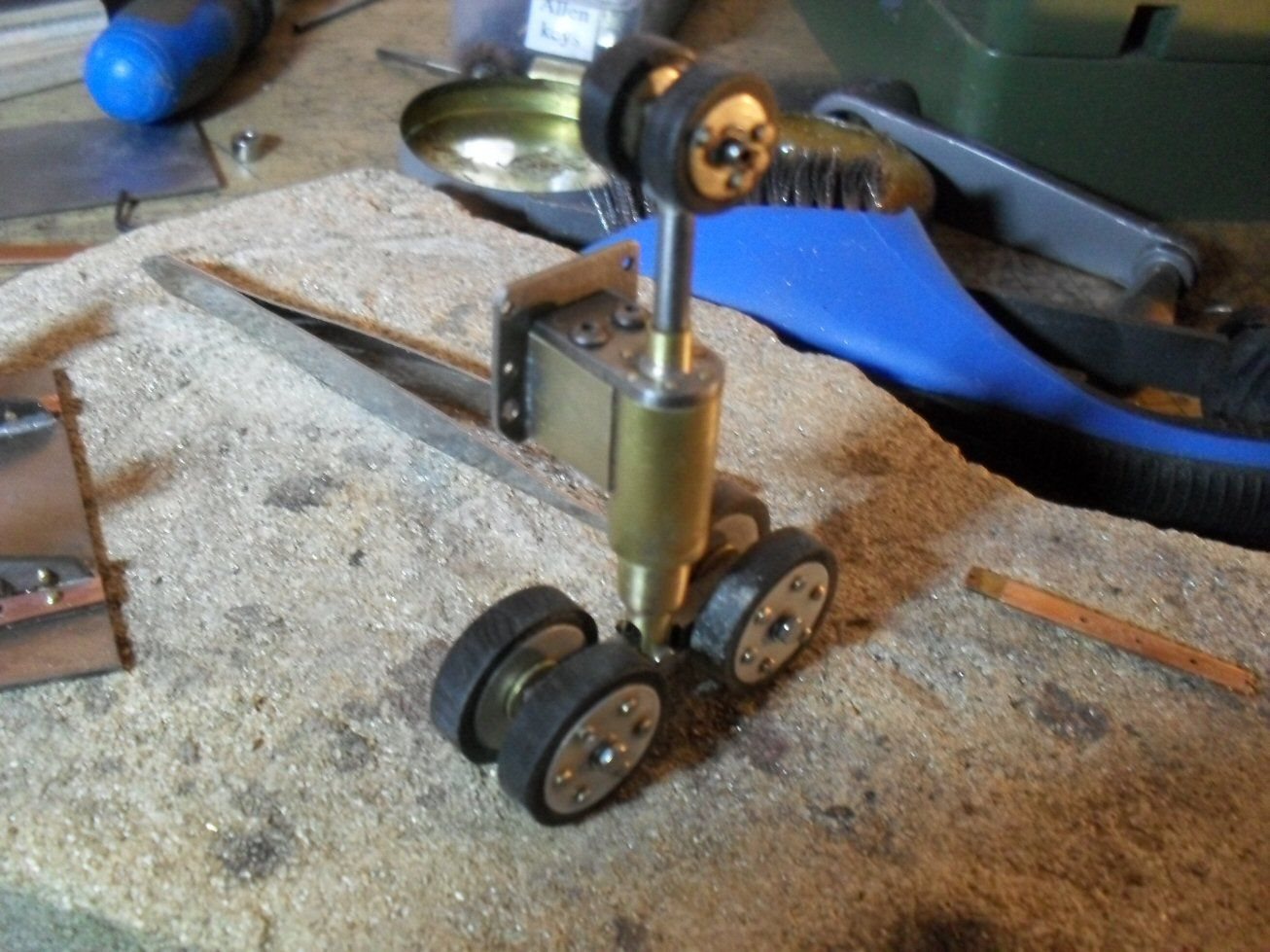

launched into the return rollers today. They are the final part of the running gear as the whole setup is one unit for each wheel.
I made the pillar for the return rollers and mounted the rollers on little axles at the top. The pillar is 4 mm drill rod and the axle is just brass in a little rectangular bit on the top,. They spin nicely.
Then the roller assembly had to be joined to the road wheel assembly and spring chamber.
Cleaned the mess up and then tried to load the spring I wanted to use. This was a beefy thing and when I finally had the chamber nearly closed, I realised it was a bit too beefy. If you need a spring compressor for a toy tank, then something is wrong.
So I changed spring to the ones you see in the photo below and it went fine.
The travel is not huge nor very smooth but its fine. I can smooth things out.
Just 7 more to do! Im not attaching these to the hull as I have work to do on both the assemblies and the hull itself and its a whole lot easier when they are not on the side of teh tank.
Pretty pleased with the start......proof of concept and all that!

Those road wheel assemblies look like landing gear for an airliner! LOL. You're right, that is one ugly tank! But you are doing a fantastic job on it and I am loving your progress and metal work. Will be a really interesting one of a kind model.

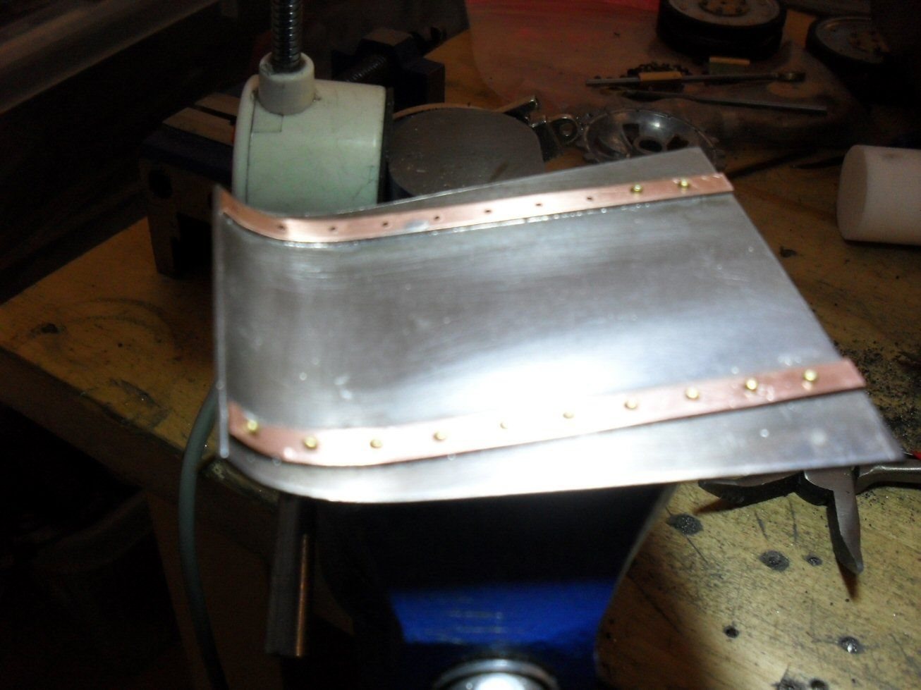

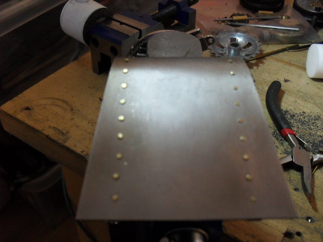

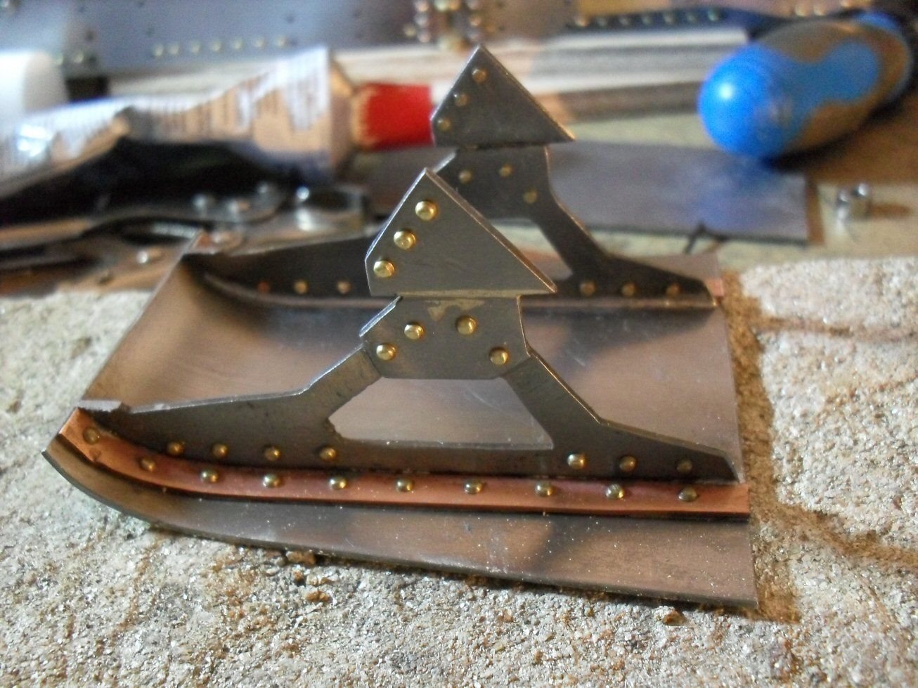

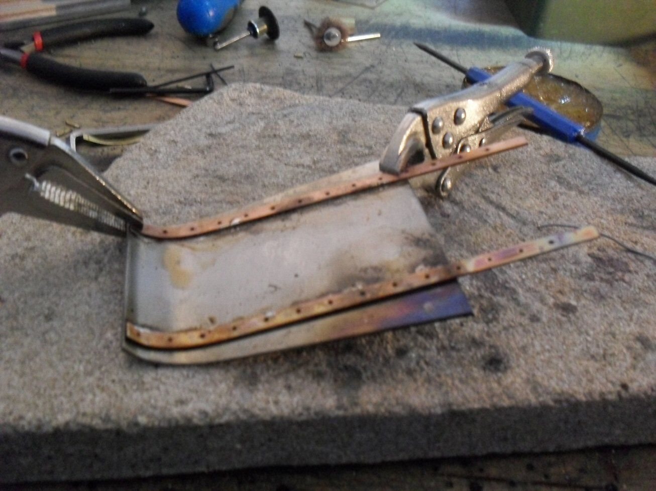

After a few days doing other things, I decided I had to address the last major structural bit of this tank - the stupid trench spanning tail piece.
This is awkward as its a lot of bit that need of lot of filing and shaping and a lot of soldering and it has a curve which is a problem for me.
I bent the steel flat bit around a bar and then shaped the two stuts or skids on that curve (it being correct or incorrect in radius).
The struts are just filed out of steel sheet.
I then cut two strips of copper and drilled holes along them.
Then I soldered these to the steel flat and drilled the holes in that as well using the copper as a template. The solder here is a temporary measure as its going to loosen when i solder in the struts.
So I stuck the rivets in and did as Tanque said I should and just peened them over on teh back to hold the copper in place.
The I just soldered on the struts.
This obviously needs tidying up.
The problem is the bottom. Th etop will be just soldered to the tank but I have no information as to how the bottom was fastened to it. At them moment the bottom edge is about 2 mm away from teh hull and I have really no idea how it should be held. I will have to figure this out.
I also finished off all the 8 running gear assemblies. Those nuts on the return rollers are M1.2! Tapping 32 of those holes nearly made me blind!
Im sorry about the picture quality...I have neither a good camera or skills in that area!
P

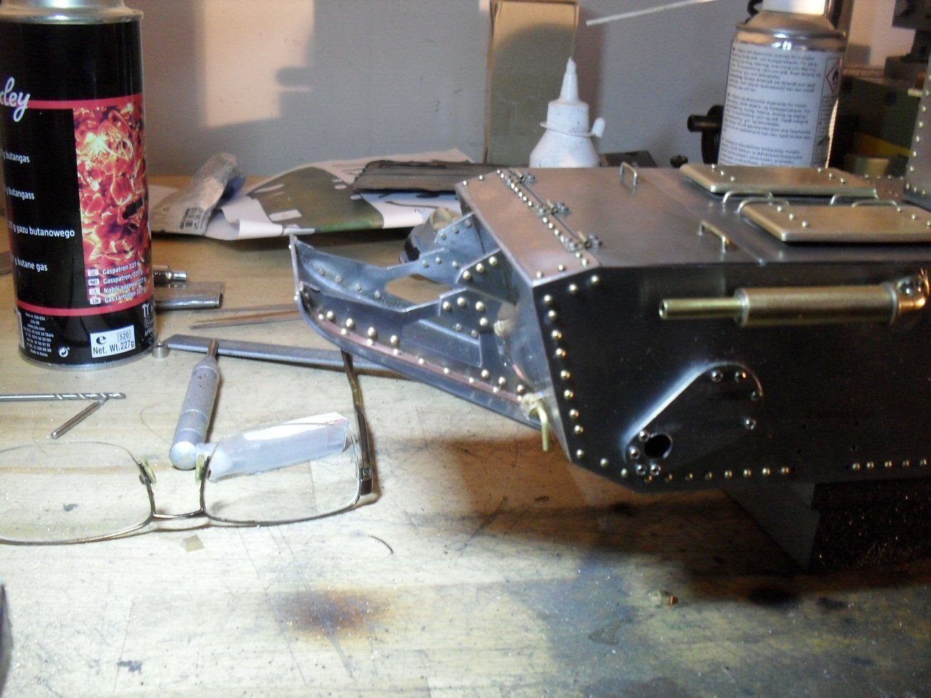

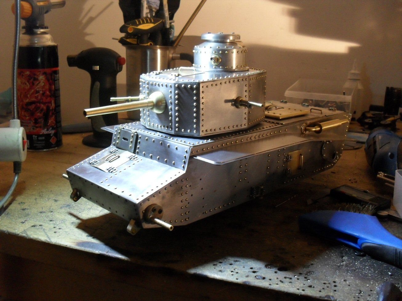

Had to attach the tail piece as it was annoying me. The struts are fine but I didnt know what to do with the bottom as I have no reference. I doubt they just welded the bottom edge on as there doesnt seem to be any other welds on teh tank. In the end I simply decided to have a kind of system with a steel bar that goes through a coupling with one section on teh tail and the other on the hull.
A tricky bit of soldering but it actually went on.
I need to make new handles for teh coupling and it needs some filler but otherwise Im happy.
It also needs a cleaning but I say that everytime and its still not clean.
Last bit to do are the tow hitch mounts on front and back.
P

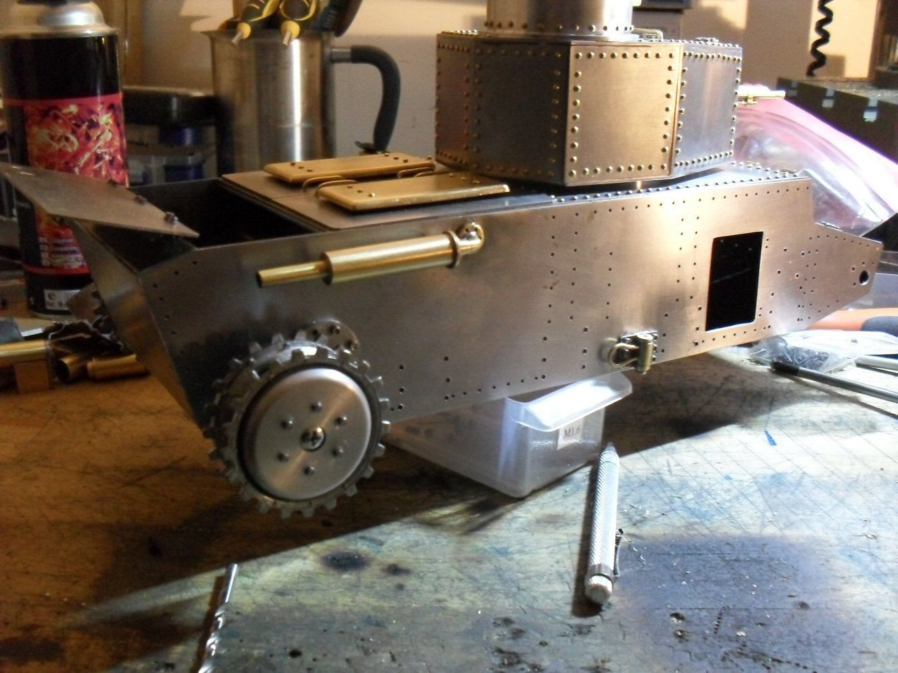

Apologies for the delay ....I had other projects to do and the T-12 took a slight back seat.
Now the mudguards are on and the towing hitches front and back......which means that structurally, this is now complete. Apart from a dozen rivets on the front.
Unfortunately...two problems have arisen.
The first is related to my rear sprockets being two mm to high or so (see earlier). This is a problem as I dont think the rear mudguard bit will clear it. I can either bend them up slightly or just leave the mudguards off which is OK as most pictures dont even show mudguards.
Th esecond is that rust has set in here and there mostly because I used a flux that was acid based and this has started things rusting.
So then cleaning I have been talking about will have to happen. Then final assembly.
