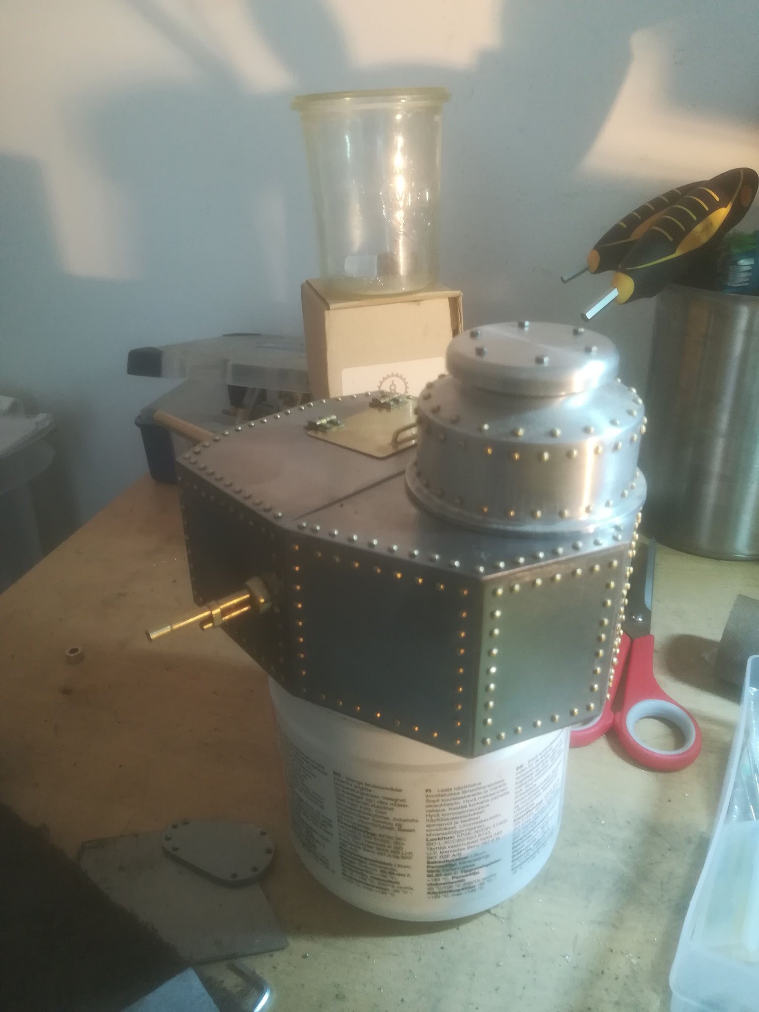

Today I started work on the cupola. Mostly because this was likely to be difficult. I had bought an aluminium petrol tank cap from a local cheap crap shop a while back - I dont know if it was for a car or a boat or what but it had the right dimensions plus or minus a millimeter or two here or there. I had to file off some features and sand it a bit but eventually it was good enough.
It needs two rings of holes around it for the rivets and it was for things like this that I purchased a cheap mini rotary table from Aliexpress for 30 euro.
I havent a chance of doing these rivet holes free hand as they need to be in line and relatively evenly spaced. I rigged up the table on the Proxxon drill and went at it. Normally I dont like drilling tiny holes in aluminium as it never goes well but this time Im using a set of carbide (I assume) PCB drill bits because I think they may work easier on 1) the round surface and 2) aluminium.
An hour later and only one broken bit, the job was done. A degree or two off here and there on some of them but I can live with that. I need to drill a big hole in the front for a machine gun mount and drill another set of holes around the sloping bit and make the top hat bit but I will get to that.

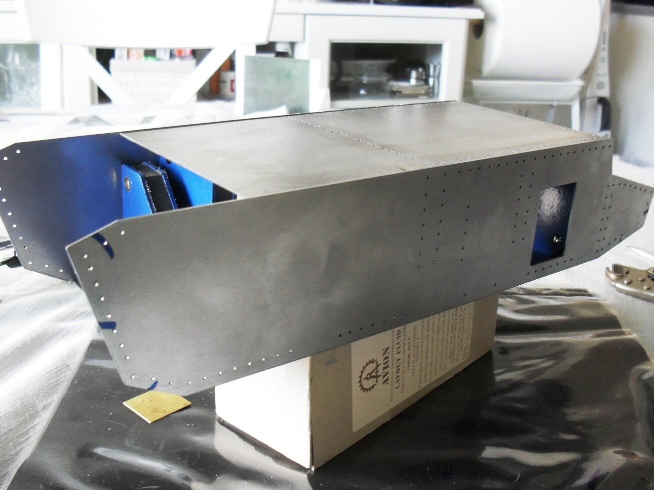

A big moment in any tanks life........putting the hull together.
This was a bit of a faff as there were lots of bits....exhausts, hatches, drive bits.....that had to go together in advance.
Im lucky in that the gear boxs seem to just about fit. There are one or two panels that need tweaking before they are fitting correctly.
Where I have not been lucky is in getting hold of the brass I need for one bit of the running gear. I guess I'll just proceed with the bits i can do and try and be patient.

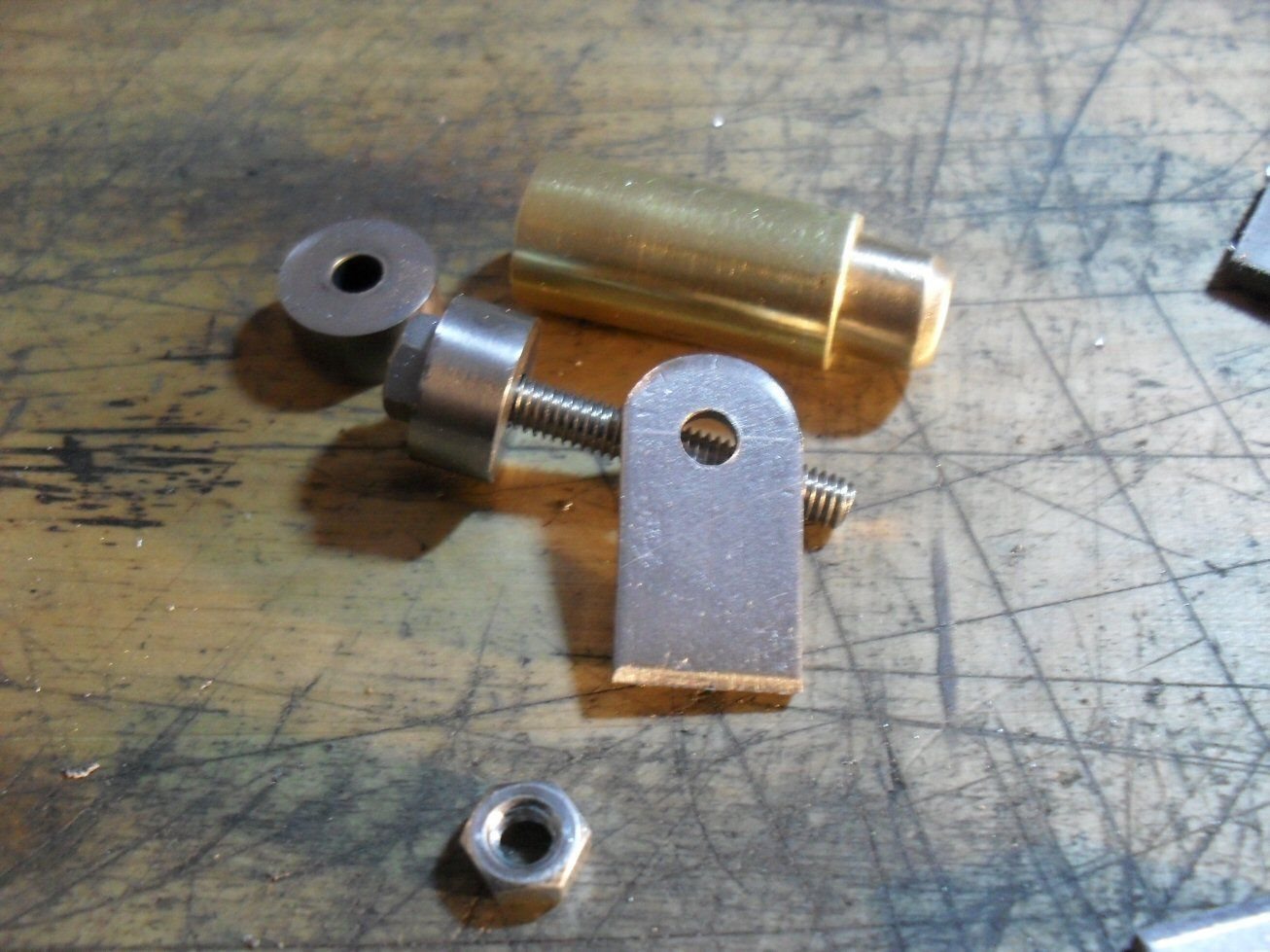

Seeing as I am tapless, I decided to plough on with the rest of the running gear. In this case, the suspension. The first part of this was the housing for the spring and the first part of the road wheel mount.
To make the spring housing, I took some lengths of 12 mm OD, 10 mm ID brass tubing. I then centre bored some 12 mm dia. brass rod with a 9 mm hole and cut some slices of it. These were then silver soldered to the bottom of the 12 mm tubes giving me a 0.5 mm lip all round the bottom of the tubes.
I then took some 15mm lengths of 9mm brass stock and bored a 4 mm hole down the centre. The about 8 mm of 4 mm brass bar was stuffed in the hole so about 5 mm protruded out the end. This was then silver soldered in. Then a 10 mm brass bar was centre drilled 4 mm and some slices cut off. These slices were then silver soldered to the 4 mm stub sticking out the top.
This piece was then slid into the tube. The ring on the top of the short piece catches the rim on the tube and stops it falling out. The little nub on the top of the short piece will locate the base of the spring in the tube.
The top of the tube will be capped with a 2 mm piece of steel which also supports the shaft that the return rollers are mounted on. It counld not be teh same thickness steel as the rest and there will be substantial spring pressure oon it. To make this piece I needed a rectangular piece with a 12mm diameter curve on one end to match the 12 mm tube.
To do this I used my favourite tool I possess - a filing button. These are just pieces of various diameter silver steel with holes of various diameters in them . A friend made these on his lathe for me some years ago and I suppose I have about 30 in a numberof different ID and OD's.
They were then hardened and not tempered. No file can scratch them. They are essentially free, extremely handy and if you dont have machinery,.....very handy.
I just clamped two around the centre point of teh curve I needed and with a few strokes of teh file...a perfect curve. If I was to set that up in a rotary table and a mill, it would take 10 or fifteen minutes. It literally took 3 minutes using the buttons.
Cannot recommend them enough.
These are the top plates for the spring tubes. One of them clamped in the filing buttons.
A couple of strokes of a file.......
3 minutes later

I made the idlers yesterday from a number of aluminium disks and some brass dog name tags. The tires are just rings off a pipe. Dont know what its made of.
The exhausts are made as well, simply fashioned from brass bar stock.If my M2 taps would arrive, I would be on the last lap I reckon.

Finally finished off the engine deck today. Theres a whole lot of rivets to go in but Im keeping that for a night when there is nothing on the TV. Exhausts mounted and its just occurred to me that the tracks have to go under them ....so I really have to be careful with the return rollers.
Next thing is the gearboxes...I cocked up royally with those and got some measurements wrong so there is going to have to be a whole lot of shoehorning and messing about.
P
