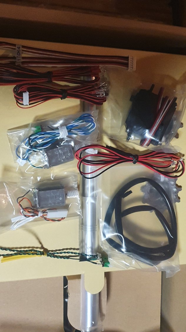

540 motors i think I will run these in first?

The wiring lets hope 100%

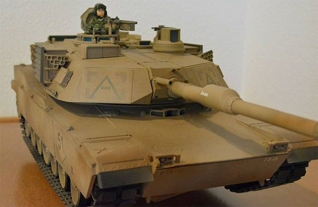

The real thing has this funny, iridescent kinda armored glass and it has a kind of rainbow effect, depending on the angle you're looking at it. A lot of guys have come up with a lot of methods for replicating that effect, some more successfully than others. My attempt wasn't too bad, but time consuming and complicated. Had to order special film for the project. In fact, I have some left over, if you need it I could send it to you. No charge. IF, that is, I can find it. I'm pretty sure I know where it is, but with me ya never know.

The 2003 Operation Iraqi Freedom Abrams Tank my model represents did not use the red visions blocks. They came later after laser attacks on the crews required a solution. That is my understanding from my build research, though I don’t know where I found that information, now, almost 3 years later. Tip: Spec Ops makes a small Abrams red vision block sticker sheet that I used for the sold build 2 Abrams; find the Spec Ops red stickers on Facebook. Or use “translucent“ Tamiya blue or red air brush paint for the vision blocks. I used the Tamiya blue translucent paint on my keeper Abrams.

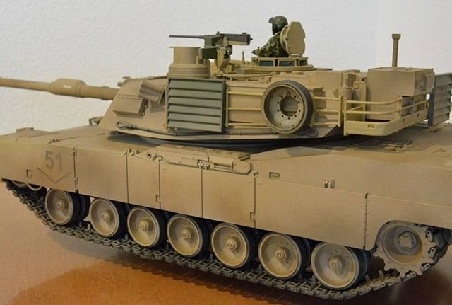

Hi, cool video, works for either HL or Tamiya Abrams builds. Have modeled both. John
HL Abrams, modeled several years prior to the Tamiya Abrams
Using dirty blue vision blocks, though not all installed in this photo.

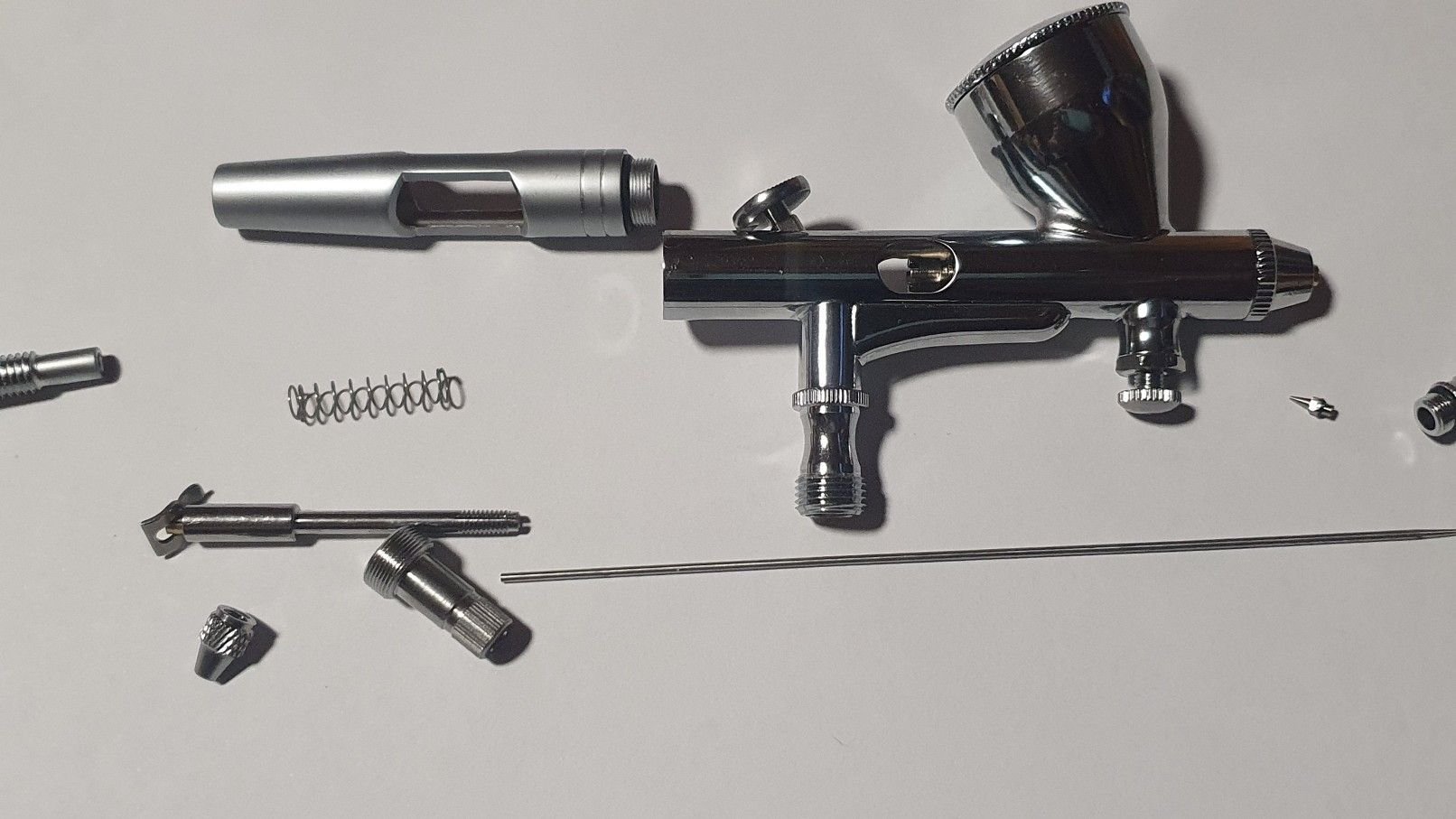

I use this as the all purpose airbrush get good results all the ability to control the flow of paint with air mixture adjuster at front extra bonus function.
not cleaning it properly last time i used Opppps.
Prep for spruce painting
Now cleaning and set up for action I use silicon grease seals up nicely on threads no air leaks and protects o rings and lastly easier to brake disassemble for cleaning.

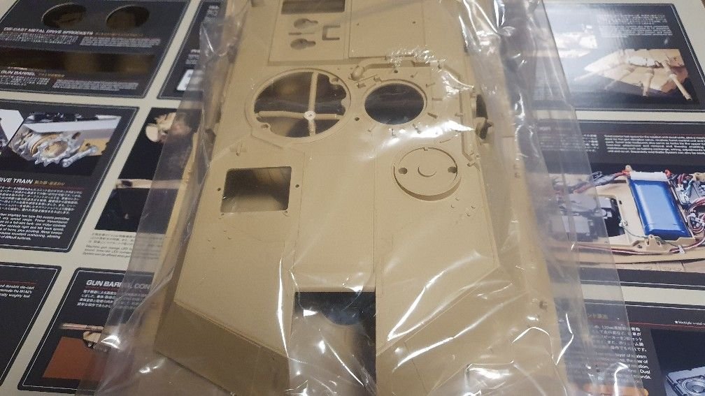

Pictures soon just for future reference do not panic if you can not find C spruce x2 they are hidden inside upper deck with turret rings.
