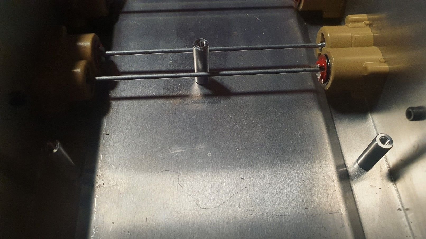

Front Support bar install

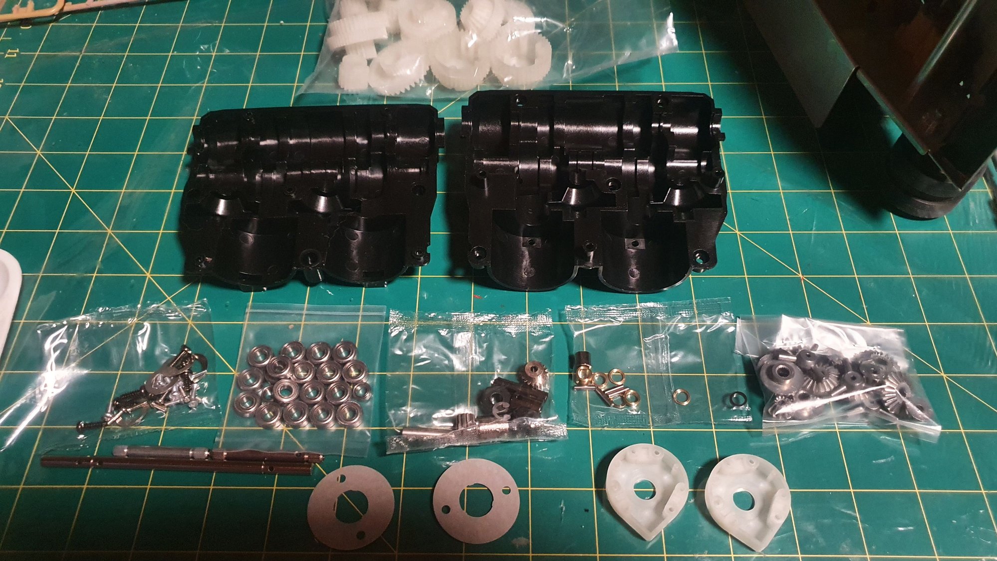

Three extension mounts for gearbox all though the gearbox is exactly the the same as the Tamiya 2A6 leopard the external drive is a little different included are ball bearings to support the shafts perfect

Gearbox assembly very easy just follow diagrams in the instruction manual i have placed the kit gears in for the time being and will replace with metal final drive at a later date .
Just make sure the drive cogs are measure exactly 14.5mm from base of can motor to the end of drive cogs

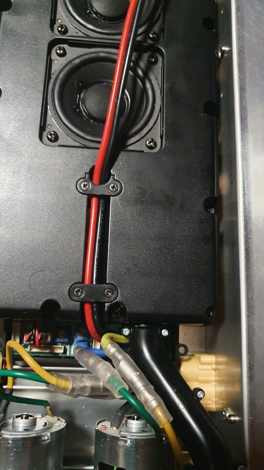

Speaker box with dual
Well designed Tamiya
speakers

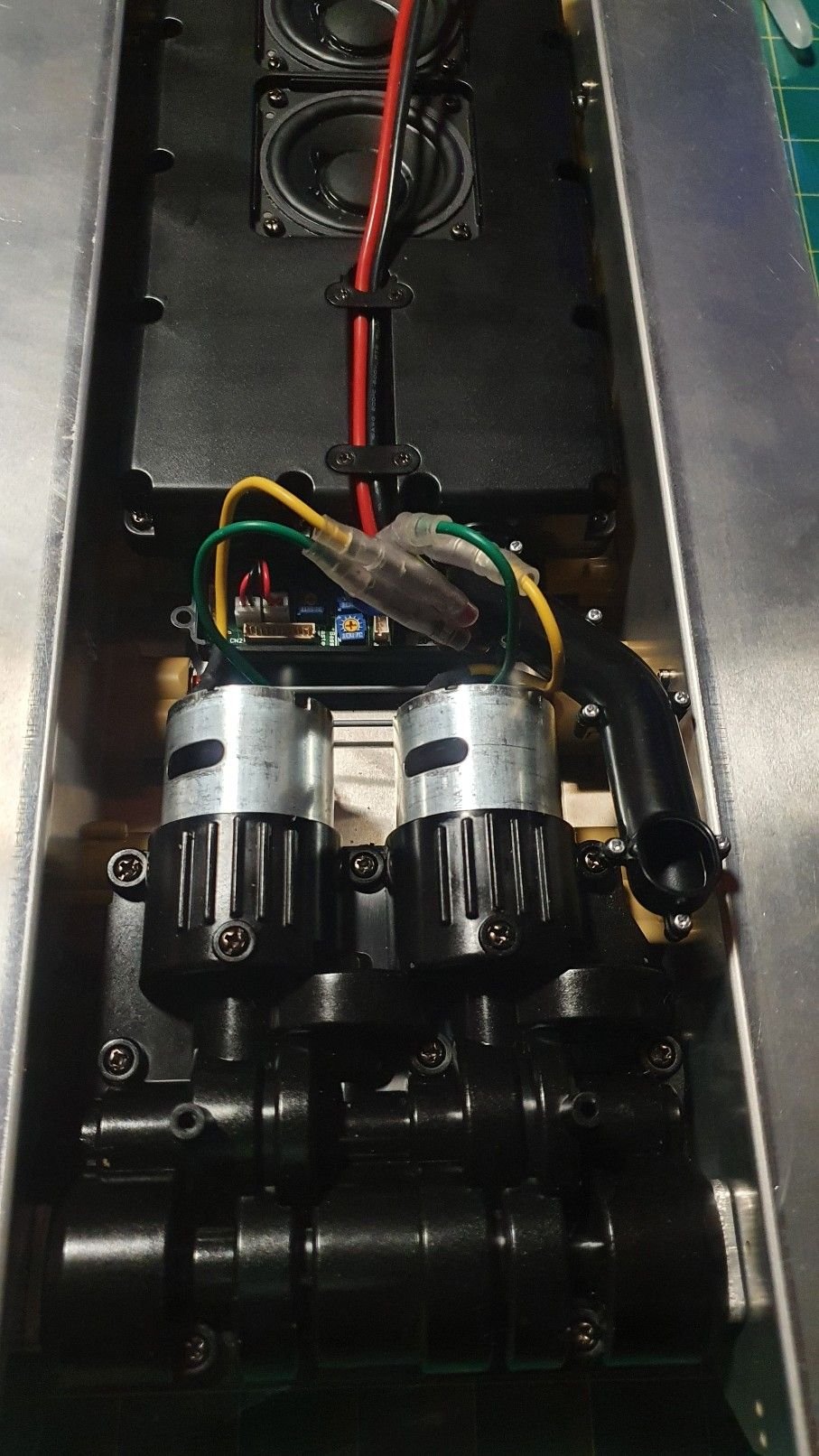

Finally fixing speaker box 4 screws front
and 3 screws rear securing gearbox and can motors
