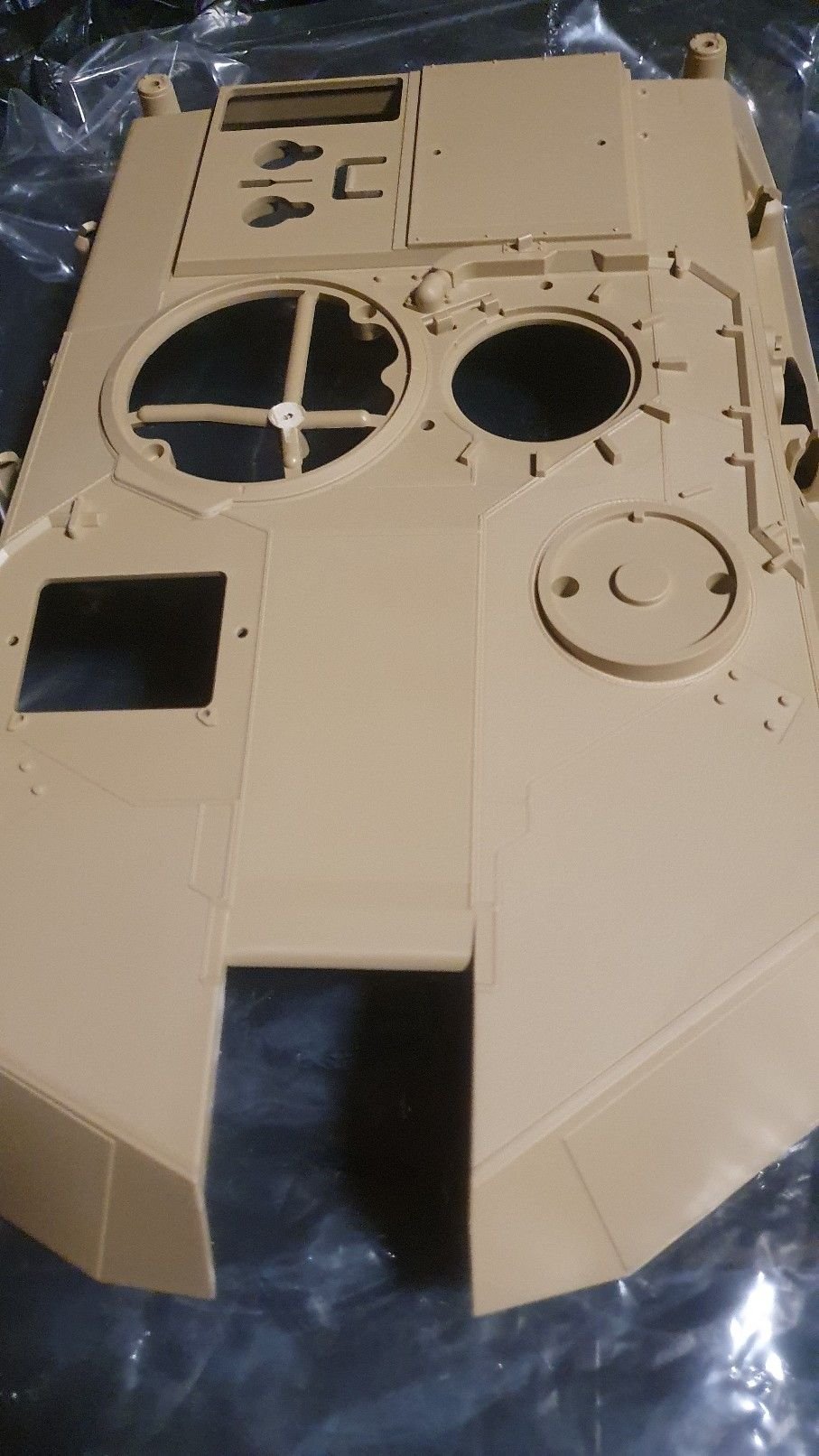

Moving on busy morning i manage today too lay down the anti slip have a look
Old 09-15-2020, 07:53 AM
  #91
SERVUS
Join Date: Aug 2020
Posts: 160
Applied cement then spray medium very fine sand will only stick too the areas where anti slip is then allow overnight drying wash the over spray off with water .
let's see how super dry 😁

Sorry i forget to mention you did a good job you will see all areas turn white with ruff texture , suggestIon is getting a large soft brush gently remove excess
I did this as demo probably a better way
now that is anti slip ☝️👍
