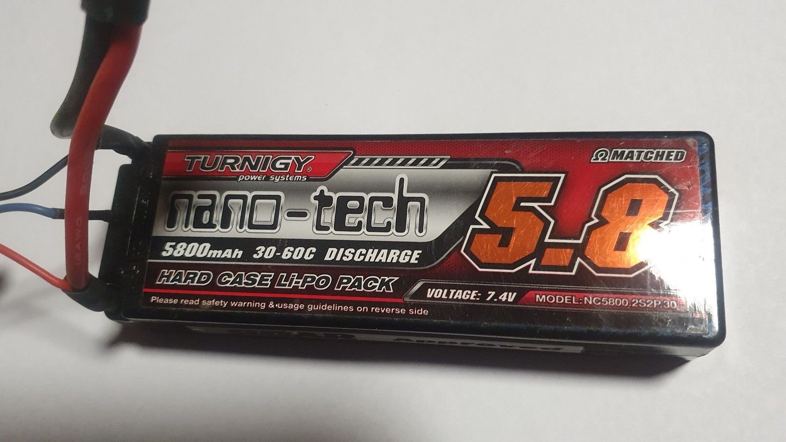

Well Tamiya you lipo the battery holder impressive 😏
perfect fit finally large capacity lipo's
now able to leave a lipo alarm on also

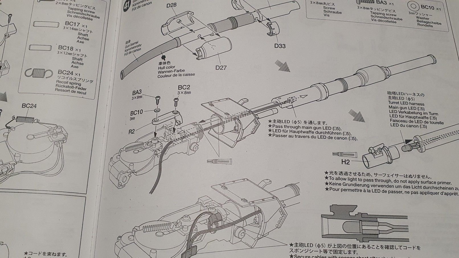

Assembly front trunion and MG paint , Add 105mm barrel attach recoil
Mg Led and barrel flash Led

Tape off only paint these sections .
cut a section of optical fibre 42mm to insert into mg with fine sand paper clean ends to ensure maximum light reflection.

Barrel and Recoil attached easy to install like the design .
just have to cut 42mm of optic fibre to insert in Mg .

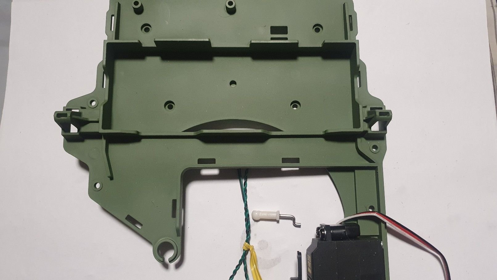

Limiter switch and servo for gun elevation screw and measure the horn end to the bend in rod with a ruler 8.5mm
Total of 2 limiter switches 1 for recoil barrel and pic above for Turret ring gear .
