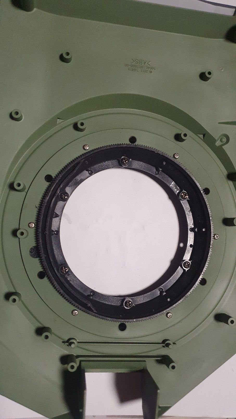

Install rotation ring
Everything is perfect lipo power.

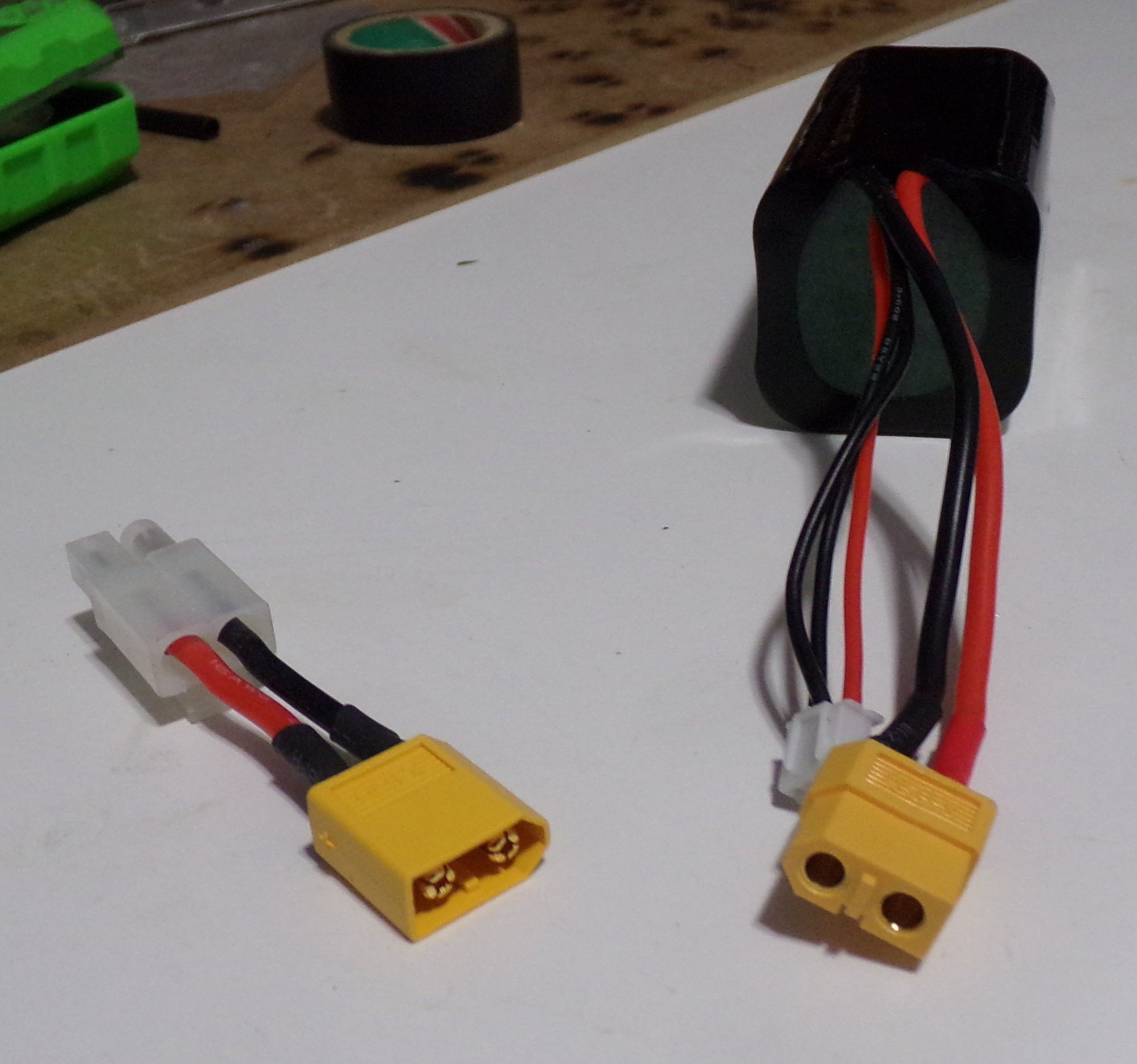

change banana type leads toTamiya type plug.
plug on at the moment XT60.

The xt60 connector that came on your battery is a very good one and I use them on all my tanks. All LiPO batteries from HobbyKing that are 3000 milliamp hours or more come stock with the xt60 connector on them so it just makes sense to switch over to xt60 connectors in my tanks. They're also much better connectors than Tamiya. For the 6s lipo in my 1/6 scale hetzer I went with the xt90 connectors. They also make an xt30 that is smaller.

I have converted to the XT60 connector on my batteries also. For the tanks I haven't converted to the XT60 (yet) I built myself a gender changer cable so it doesn't stop me from using them based on batteries.

just super impressed with Tamiya now able to use the higher capacity batteries.
Excellent crius i will have a look at the connectors thanks for the advise .

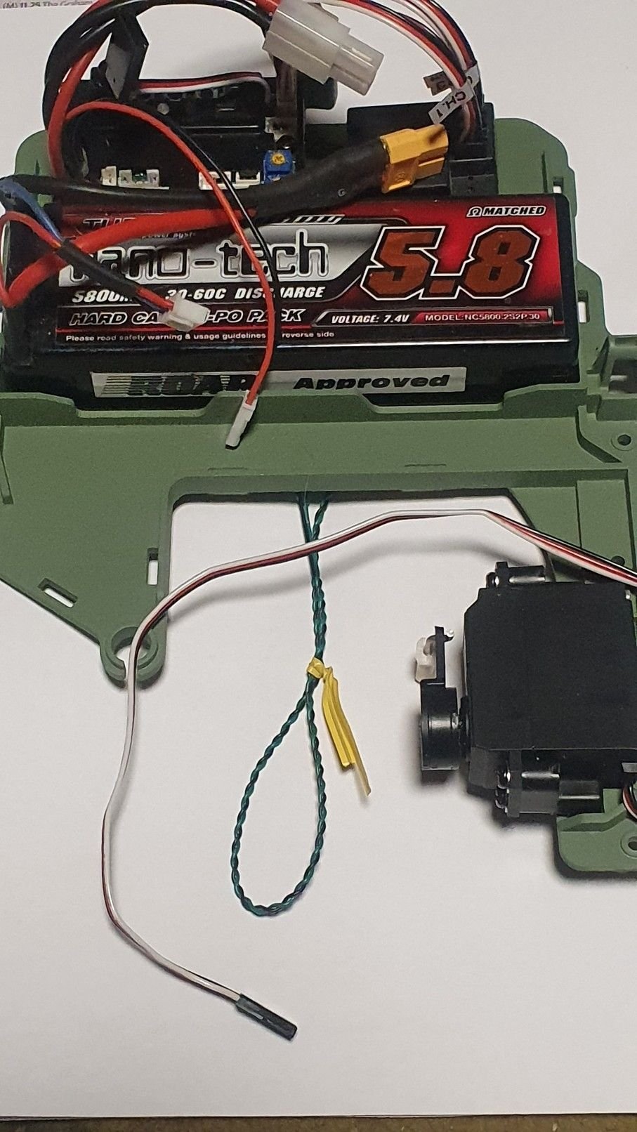

test fitted make sure everything fits in turret

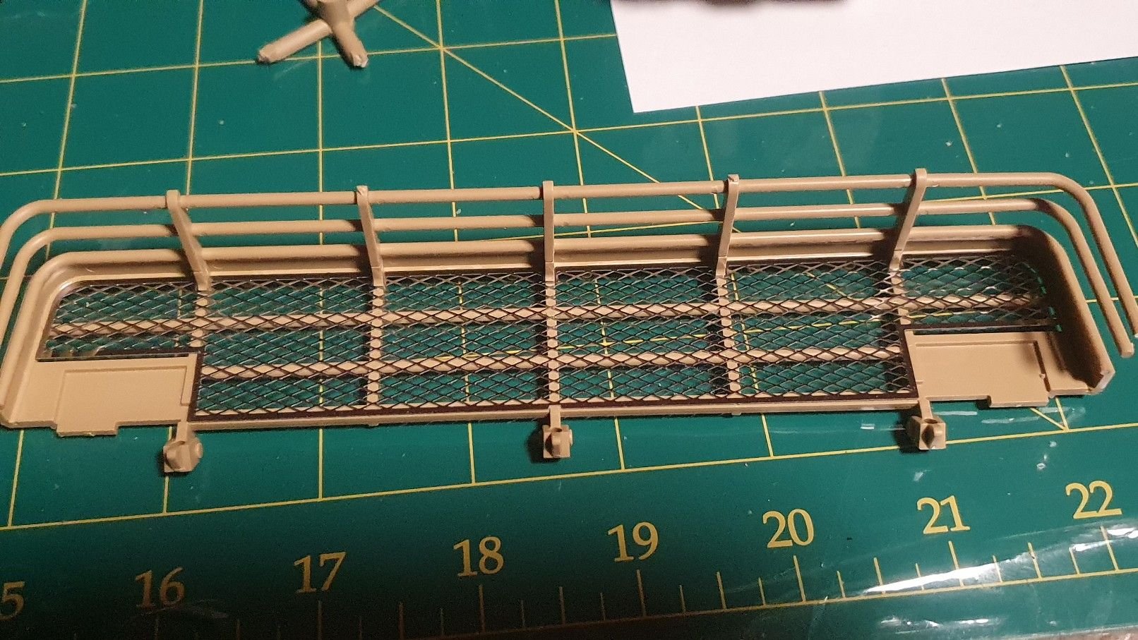

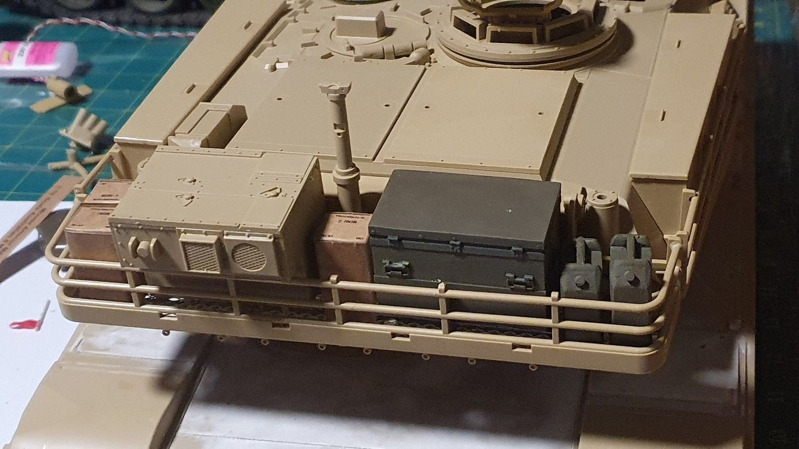

Working on Bustle rack and other mods upper turret.

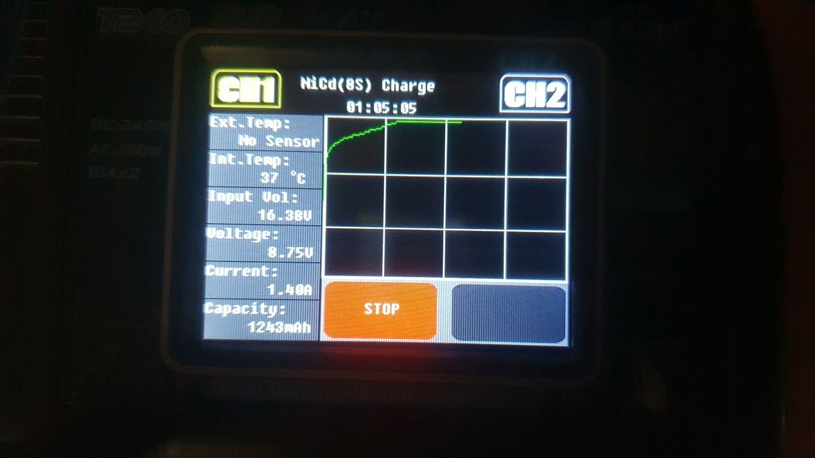

Charger
Duo charger able too charge any 2 types of battery at the same time 1s to 6s , Nicd , LiPo , LiHV , Pa etc.

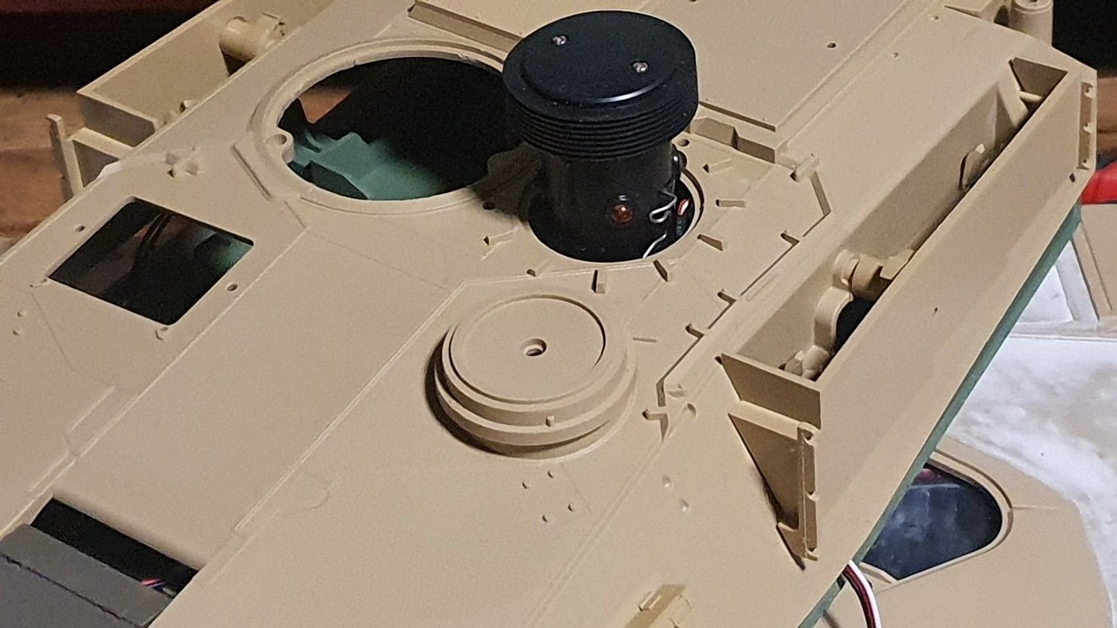

Working out where to place hidden battle system IR emitters can be installed in cupola and just looking for a nice spot to place the 4 hit lights to fix IR in place in cupola use gorilla grip 👍
Seeing i have a mushroom I will just show you what it looks like if you decide to use it .
The locking mechanisms to secure the upper turret are simplistic and work a treat

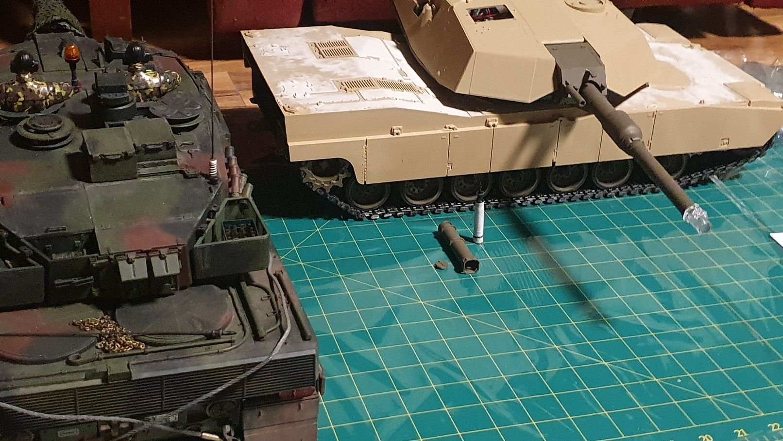

Work on a figurine ?
Down to electronics store pick up ir immiter x1 ,recievers x 4 , 2mm x4 SMD Led , iR bulb make a hidden battle system
Also decide to run additional leds off light circuit for copula , loaders hatch, driver hatch.
only come on with lights.
will not notice till battle day 😚

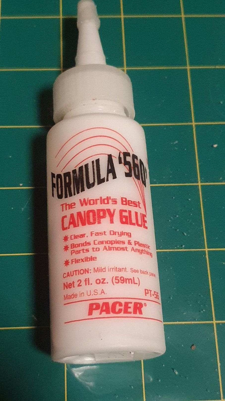

Another product i highly recommend is glueing in clear plastic, headlights , vision ports copula , Driver's hatch vision blocks is canopy glue it dry's clear you can not mess it up perfect
Gone is the mistake of using Ca glue we all know what happens when it goes wrong a mess.

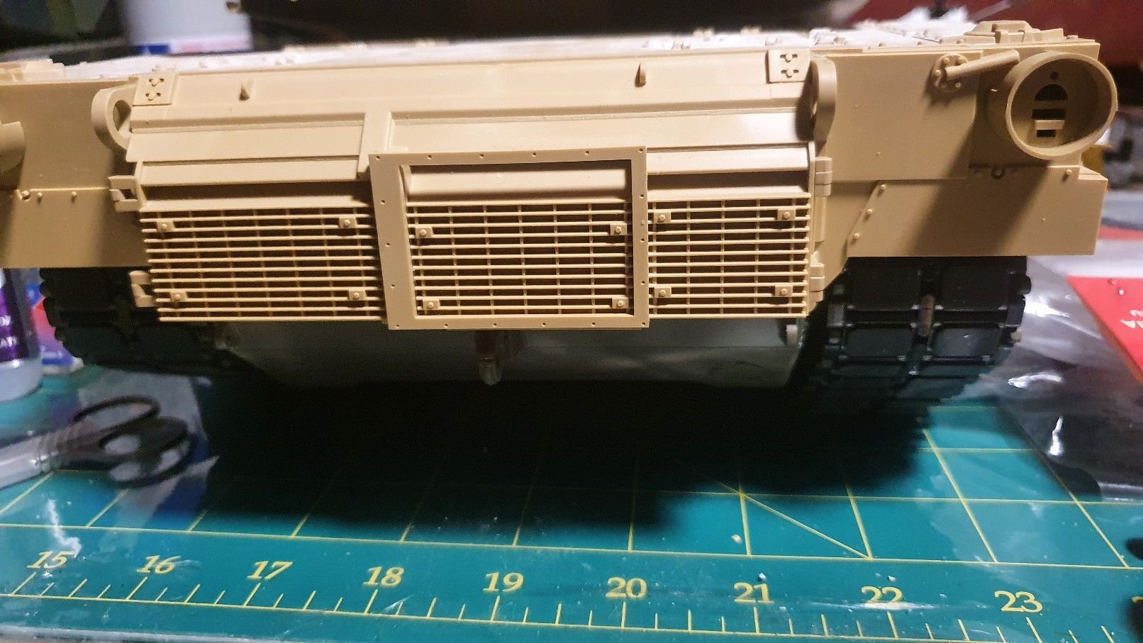

Ready for primer using a lite grey on upper hull
Two screws with lock nuts fixed to rear securing the hull the front only requires slipping under support bracket this is also easy too remove sliding rearwards .
