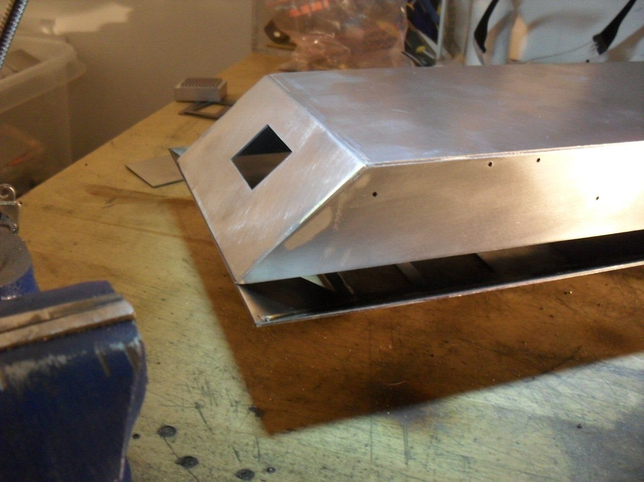

For a numberof reasons, I had to assemble the bottom of the hull. I don't like doing this before the running gear is ready but in this case I had to. I left some indicator holes of where things have to go so they should help.
The bottom was easy to assemble with no issues at all.
The biggest potential problem was that the gearboxes would not fit but they do with headroom.
But then I got a shock when I looked around the back...... the bottom is, and I have no idea why, two millimeters too long which is producing a very unsightly gap indeed.
Short of redoing the bottom (which is a lot hassle) Im going to have to fix this somehow which won't be easy. My plan would be to solder some 3 mm thick brass along the upper rear lip of the bottom. Then file this down along the width of the hull bottom thereby shortening it.
This will also introduce a narrow vertical surface that should not be there but Im goingto have to suck it up and live with it.
The suspension is leaf spring. My plan for this is to use junior hacksaw blades - they are springy, the right width and all I should have to go is grind the teeth of and cut them to length.

Looks like Da Vinci's tank! Nice work! For the 2mm gap - can you still add a small extension plate to the top hull? Shouldn't be that hard to hide 2mm.
When I scratch build I always build the tracks, wheels and lower hull first. Those are the most difficult - and the tracks <or lack of> can derail a project..

In the end, I just used a hot air gun to get the back plate off, ground a few mm off here and there and then reassembled. Luckily enough this time I got it virtually spot on! A bit of filler and it will be just fine.

I dont actually have a lathe or mill but Im fairly happy using a coping saw and filing to shape.
the sherman set up may be the way to go. Wheels are easier than a sprocket.

Just in case anyone thinks Ive been slacking..... despite the problem with the sprocket (which I am working on solutions for), I didnt waste time and did some bits on the hull.
The grills on the top and back are simply Intel heat sinks from an old pc, filed down and mounted from the back. The gun I bought from RCTank, the exhaust is scratched and 90% done.
The front glacis needs some bits, the rear glacis needs finishing and the entire body needs filler and sanding. The lower hull needs a lot of work (hatches, idlers, return rollers, skirts, hitches).
I got some PzIII lights for it but Im not sure as to them being possibly too big and they have no lenses ( I dont know how to make them either). A notek light needs fitting as well.

Got some more work done on the top hull. I tried the staples and plastic headlight tip I got on another thread but after ending up burning the plastic, my fingers and the sleeve of my sweater, I ended up with two lenses of dubious quality.
But Im using them.
I started modding the sherman sprockets using large steel washers which I still have to finish. Mounted my road wheels and the gearboxes. The position of the gears had to be raised 7 mm so they are standing on a set of brass standoffs. Lucky for me the top of the hull still fits.
next will be the idlers and the solitary return rollers. Then the skirts.

Big milestone for the Maresal today...full set of wheels and a set of tracks. Still, filthy, still not finished.
But I reckon the finishing line is in sight and a final spurt to get the skirts done should be doable.
For some reason its reminding me more of a Jagdpanther than the Hetzer its supposed to inspire but who knows......

Looks really good! Glad you got the sprocket situation worked out. The Sherman sprocket looks great with the faux cover plate. Tracks actually look good too. Glad you didn't give up on it!

Finished this Maresal as far as I am concerned. Missing an antennae but any old HL one would do (thats the fitting I used).
Added the obligatory Stug III for size comparison. Which is appropriate given that it was against the Stug that the Maresal shone.
Reasonably happy with it. Some things I would have done differently or not at all. Now it joins a growing list of tanks needing paint and electronics!
