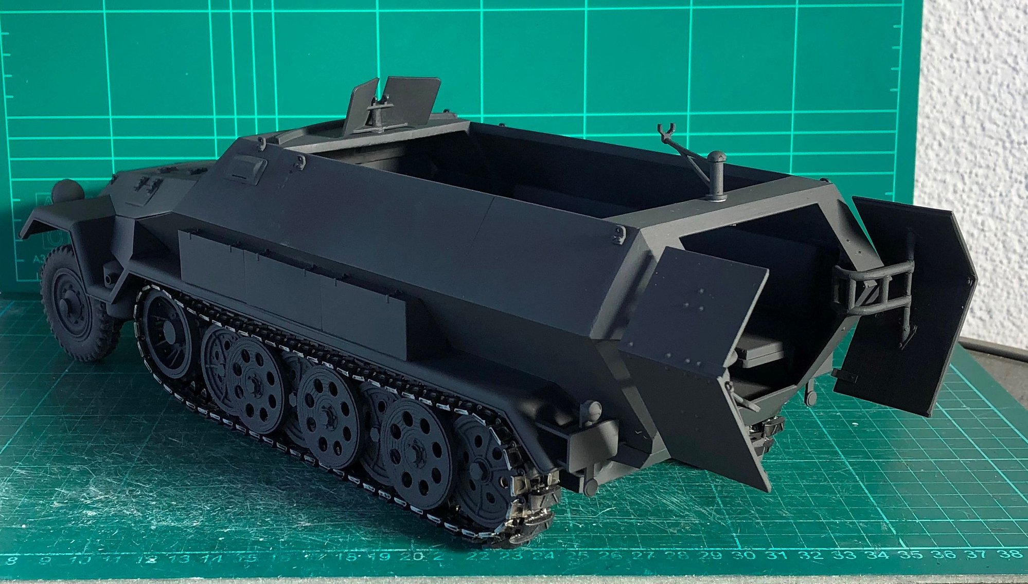

Let‘s start the brief build report.
Pictures of the hull and the motor deck…
…after little reworking it fits …
Mounting the back panel…
Next is the track gear…
…the idler mount…
…and the bogies.
Movement of the bogies should be good enough.
Mounting the tracks for checking again…
(almost looking like an alligator )

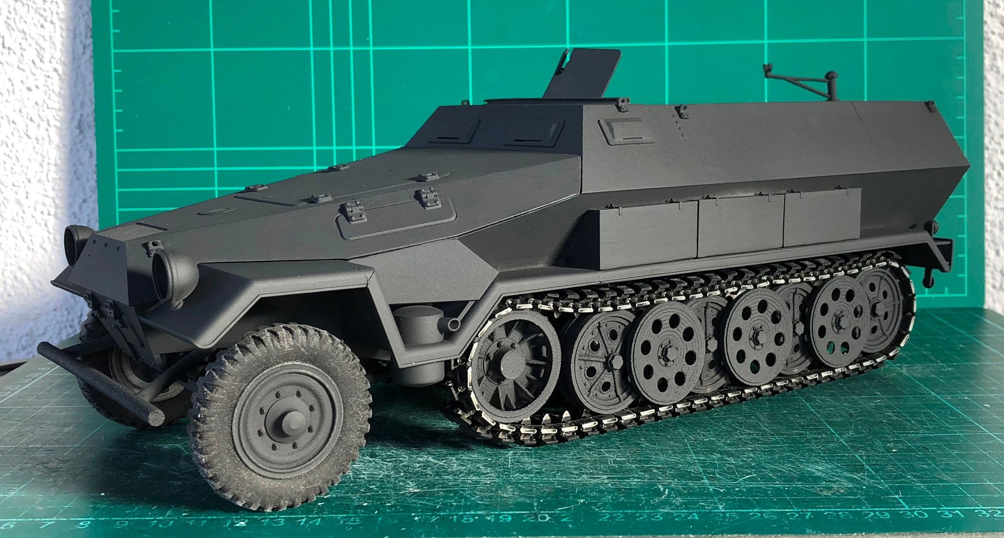

Some progress to report .
first are two videos; one with metal tracks...
...and the other with printed plastic tracks
After applying a dark grey primer this is the current status
To compare the size or scale respectively, there is a tank commander from Classy Hobby 16004 next by.

A little update...
It needed a longer time until my "Berta" was able to make the first moves outside, but today it worked
Some work have do be done, the build isnīt finished yet.

It looks good, but I'm not seeing a lot of movement on the road wheels. What kind of suspension do you have in there? Are they just fixed axles, or does it have an actual working suspension?

So it does not have an active suspension, it just lets the bogeys pivot in pairs. Hmmm, not exactly what I was looking for. I'll hold out for the wcp model because I know that's going to have an active torsion bar suspension, just like our model tanks do.
