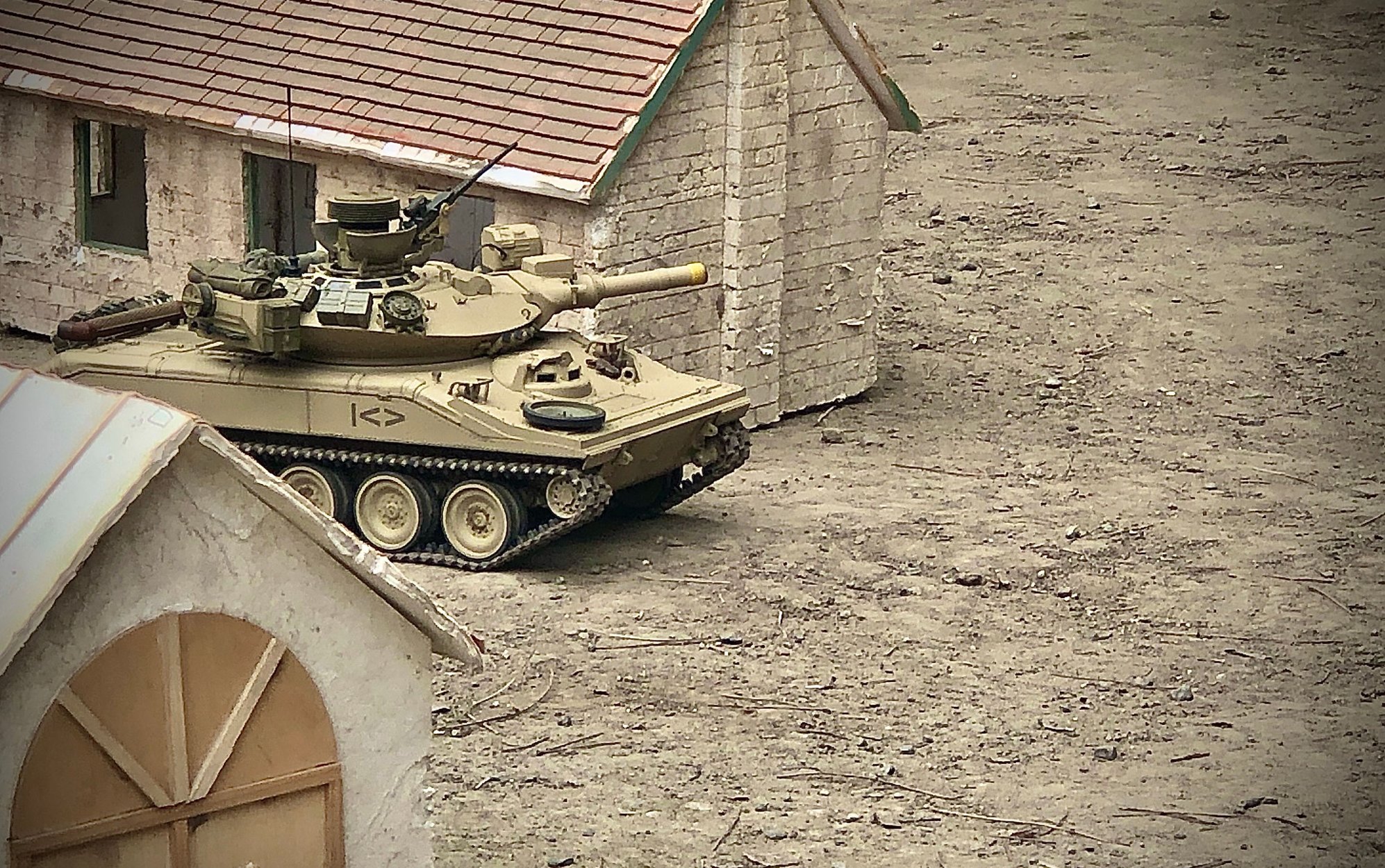

Mine is doing well. It is still one of my favorite tanks to drive and fight. Mechanically it is a solid tank except for the weak tracks. One has to learn to be easy on the throttle and not making overly aggressive turns.
I highly recommend a radio with “dual rates”. This helps with tuning the power curves which smooths out the handling and helps to greatly reduce issues with the weak tracks.
Here are a few oldies but goodies of my Sheridan having fun. I have a bunch more and a number of videos of it on my Instagram @ fsttanks. Feel free to check them out.
Strips are just shadows.

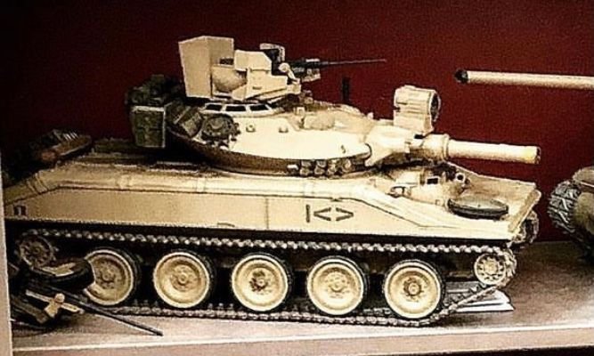

Personally, I'd rather see rubber road wheels than rubber track pads. But that's just my two cents, and obviously Tamiya didn't call me to ask what I th ought.
How tight are you running your tracks?

I keep my tracks set with just a little “doop” in them as pictured.
