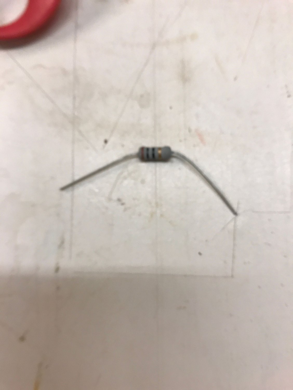

I've been known to make my own with a 10 ohm, 1 watt, wire wound resistor. If that might interest you. I can post a video after work that shows its performance. I have it in my jagdpanther and it makes a ridiculous amount of smoke.

My apologies for the delay, this is what I did in my JP.

That's a taigen smoker, but they're almost exactly the same as the HL smokers. I simply replaced their element with the 10 ohm 1 watt wirewound resistor with Kevlar cord wrapped around it, and attach the 25 mm fan to the top, after drilling a hole in the top of the cylinder and another hole going into the smokebox, both 1/8 in Holes. When I get a chance I'll see if I can find the videos from Normand that I originally used, but maybe someone else knows where to find that and will provide us with a link?

Default Resistor
I think I have the 10 Ohm resistor not sure if wire wound but the Kevlar wick no.
