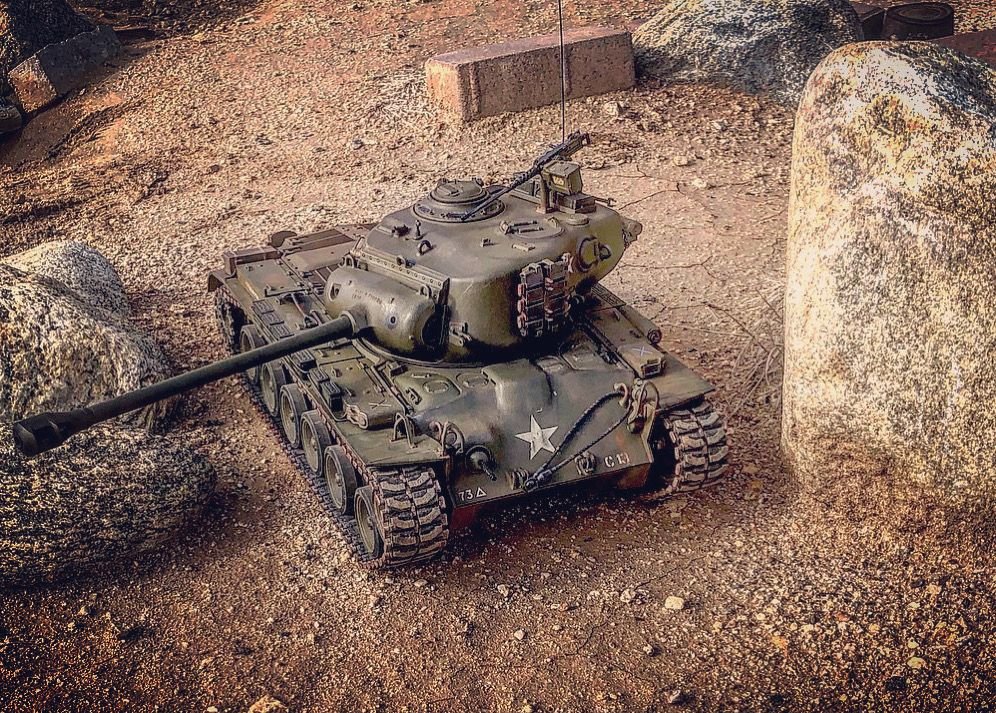

I just finished my Tamiya #56016 M26 Pershing build.
Like with some of my other builds / rebuilds I managed to capture some of the more interesting moments and collected them together in an Imgur Diary as I went along with the build.

Nice build sir. Many older solutions to the compactness of the interior off this vehicle have been major surgery to the innards. Are any of those 3D files readily available?

Haven't really given it a thought to upload the files to somewhere since they're not exactly complex to reproduce either.
Kinda curious though, how would people solve this issue the classic way - Other than just accepting their fate and not turning their turrets ( makes me sad )

Turning the turret is no issue for myself and those I know with Pershing when running the tank. Small zip ties and heat shrink tubing keeps everything in nice neat wire bundles so nothing gets caught or snagged.
Now turning the turret to access the battery for charging is a hole other issue. Fortunately in my case I use a larger 8.4v 5000mah NiMh battery so I can leave it in the tank with a high level of assurance that it will have no issues while not in use. I have never not had enough power even after periods of long storage to turn the tank on and turn the turret to the removal position and gain access to the battery.
If by chance the battery was totally dead then it’s back to the manual hand turning method which frankly does S**K.
To make things fit a little better myself and others have omitted the “mechanism deck” (MU2). It’s kind of a redundant part.
The M26 is a pretty good tank Tamiya design issues aside. You will find when you start driving yours that it is a fun tank that has few if any real running vices in overall handling and performance.

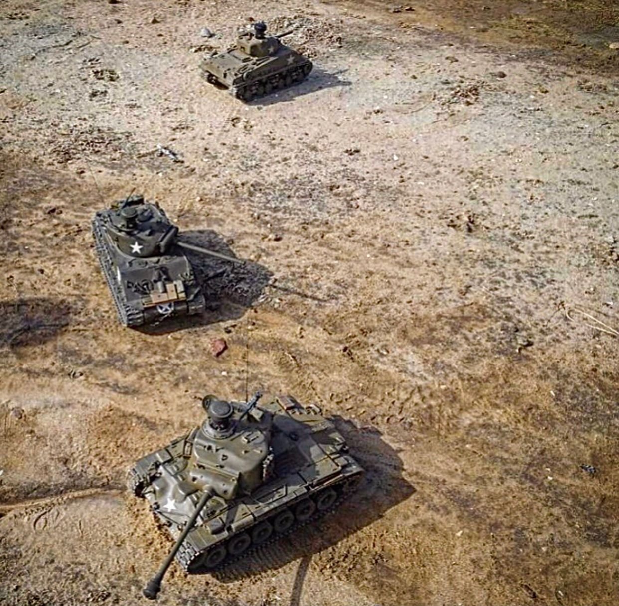

Here are a few photos of my Tamiya M26 Pershing.
Tamiya M26 Pershing with T84 track.
Tamiya M26 Pershing on lower corner of photo during recent IR battle day.
