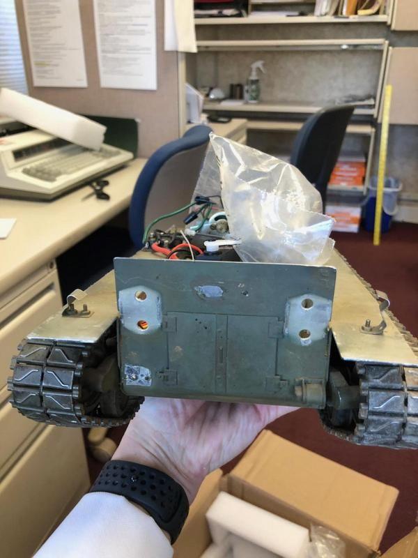

Back in winter I received an inquiry from a gentleman in US. He had a tank his father built for him in 1975 which had ceased to move and he asked if we could fix it. After consultations with Daryl Turner, our resident hobby genius, we agreed to perform the repair.
Here are the images of the tank as Daryl received it. The original build was indeed 1975. The transmission used dual clutches to move the tank and speed was a very simply electro-mechanical device, servo operated. The gentleman had installed a new radio with modern servos to control the functions, but the clutches after 45 years had worn out. The tracks, original from the kit, were in good condition albeit with the usual Sherman knock kneed idler problem plus a couple of the road wheels with their poly caps had decided to go on holiday.

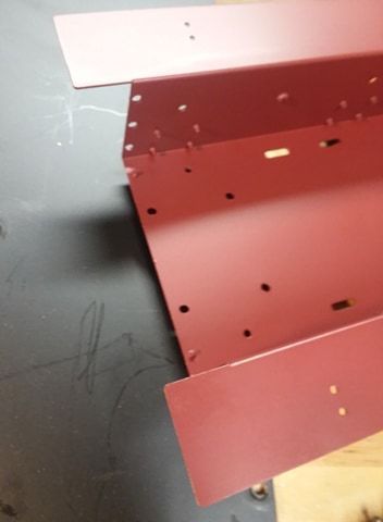

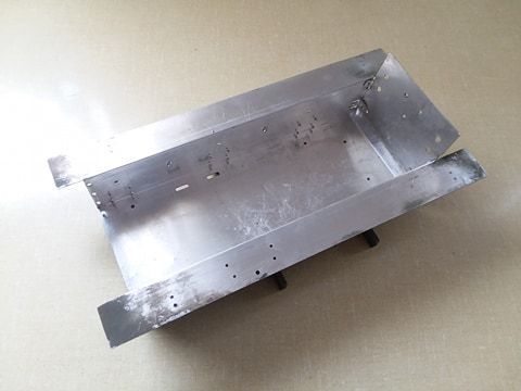

First things first. Everything was removed from the hull, the hull was degreased, cleaned and minor bends and dents were straightened. New hull front extensions had to be fabricated, then hull was primored and painted. Next, ETO transimission was test fitted to the hull. Transmission is a bolt in, geometry of the Sherman hull has not changed in 45 years, nor has the sprocket mating protocol.

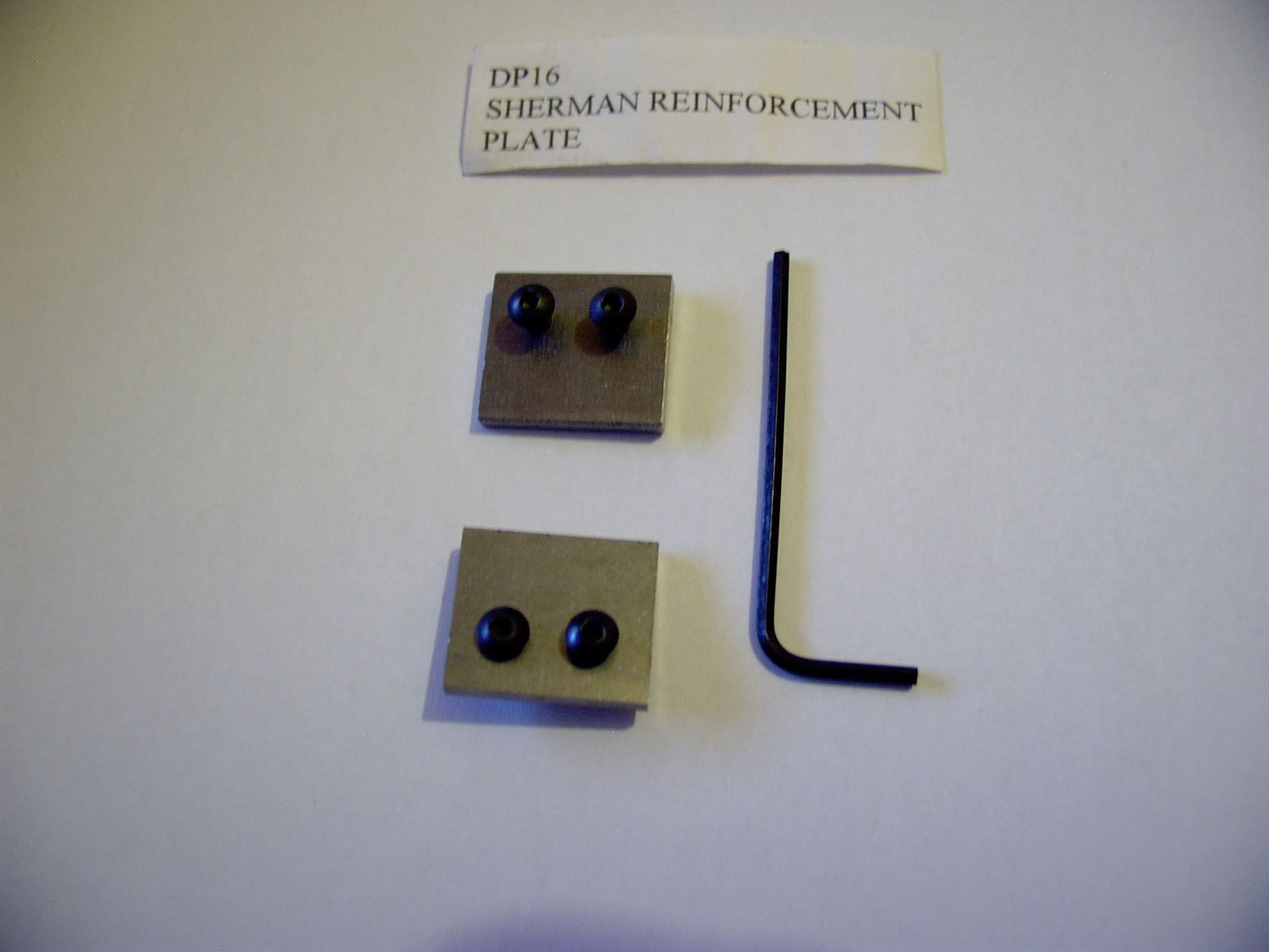

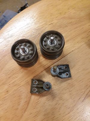

One of the weaknesses of the Tamiya Sherman from Day 1 has been the idlers, and they have not changed to this day. Daryl some years ago developed a simple small plate to go on the inside of the Idler adjustment slot at the hull rear. This little plate greatly strengthens the hull in each side at the idler. He also, and so have I, added bearings to the idlers. This solves the knock kneed look of the idlers over time and greatly enhances track retention. Unfortunately, this little plate is no longer available, but it is simple to make.

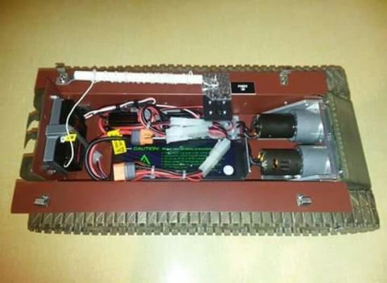

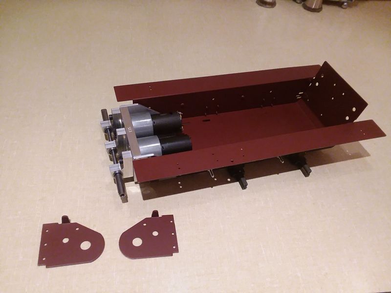

Next step was install the transmissions, obtain new electronics for a simple speed and direction control and make the necessary retainers and such for the electronics. The owner had installed a simple pistol type radio and receiver suitable for an RC car, but not quite up to snuff for a tank.

I have gently tried to take idlers apart but never been successful. How do you get them apart and what size bearings do you install?
Old 04-30-2021, 08:48 AM
sevoblast
Join Date: Feb 2008
Location: East
Posts: 3,025
Received 22 Likes on 21 Posts
If memory serves, it's been a few moons, a good whack on the back of the idler mount and the center retainer/cap shaft comes out. I'll go through my records and see if I recorded all,and if not I'll get the info from Daryl. However, the best source I ever found for bearings in the States is Avid. Never a problem with them, quality of bearings is excellent, price is good and service better than good. They have a huge offering of metric bearings. Always get rubber sealed if possible, not 'metal shielded' unless that's the only option. Rubber seals keep everything out of the bearing race. Metal shield allow dust and fine grit in.

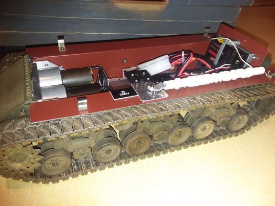

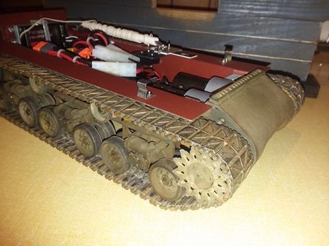

Daryl custom built an aluminium electronics and battery tray with a bracket for the radio receiver. Everything is neatly tied in and down, and he installed basic instruction labels as to what goes to what. He also from his stash of NOS parts found the needed missing parts on the rear hull plate and installed same, matching the colour rather well in my opinion. Daryl's work is of excellent quality and very well thought out and applied. He test ran the little beast after installing the radio receiver and making sure everything worked as it should. Please notice the idlers at the rear are no longer knock kneed so the tracks will stay on forever.

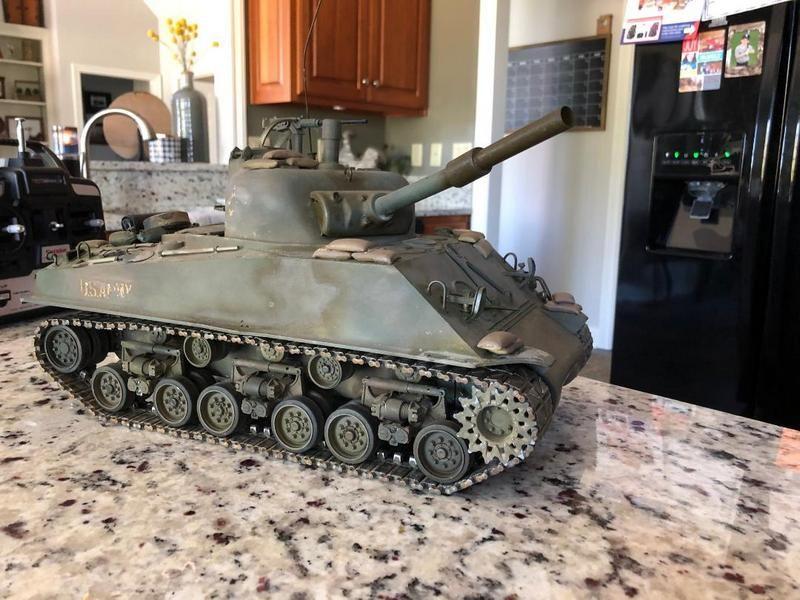

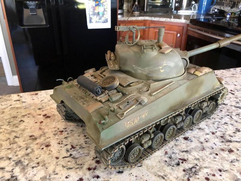

Project is completed and delivered to the owner. To say he is pleased is a bit of an understatement. Final images of the restoration, images of the tank complete, images of the owners two sons. Their smiles says all, and Daryl did one heck of a job on this effort.
