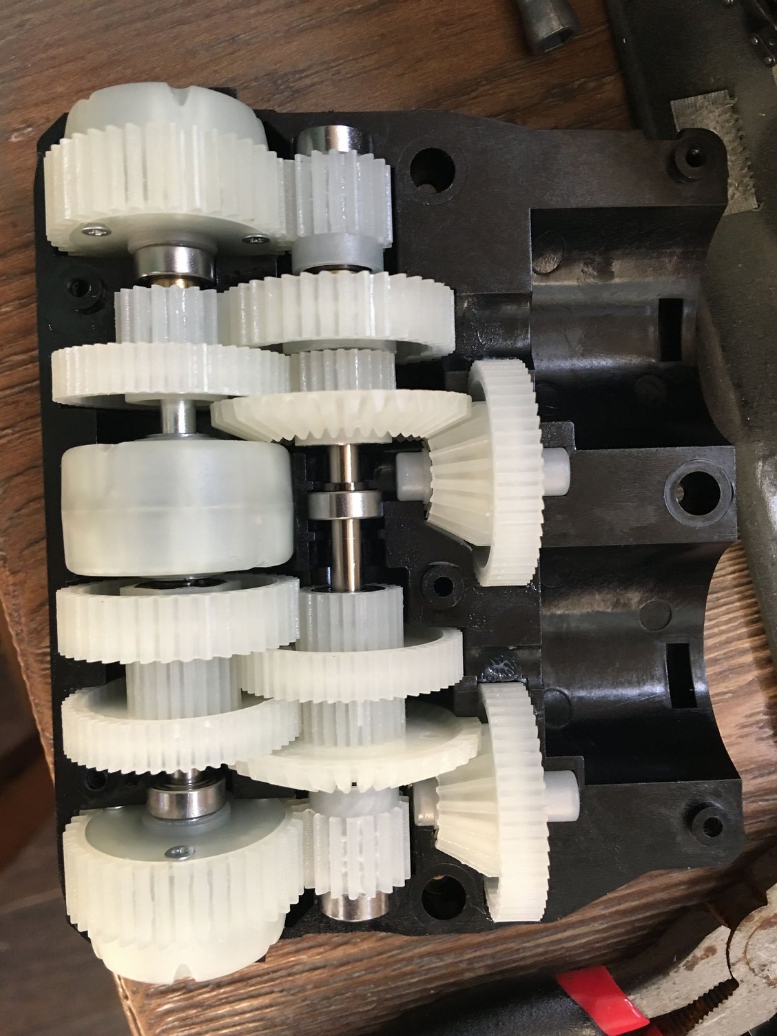

So finally got it built (type 10), gear box drive motor works, steering gears won't turn. Both motors working fine outside of the gearbox but when I install the motors into the gearbox the turning motor will start to strip the gear that meets up with it. Anybody experience anything like this? I have it built exactly as directed as far as I can tell. Is there another page of corrections I'm missing?

I have built all 3 of the Type 10, M1A2, and Leopard 2 and I can tell you even after building two they are still tricky, it is very likely that you got something wrong or one of the metal pins fell out of place when you were loading the gearsets into the case, other than some durability of the final drive differential cases there are no known issues with these transmissions I am aware of.
I am always humbled when i assemble one of these and do a manual test without motors only to find I fat fingered something and have to pull it back apart to see a silly little metal pin fell out and then reassemble and everything then works fine.
Do yourself a huge favor and not proceed until you can get a set of the DKLM metal upgrade gears. This will save you more headaches down the road. If you wish to proceed here are a few basic questions to start off with.
1. Can you spin the “turn side” of the gearbox by hand at least several rotation? If you feel any binding you most likely built it wrong which is super easy to do and rather common. There are a few gears that are almost identical and will fit where they should not. 2. Have you swapped the motors (and pinions) around to see if you have a bad “turning” motor? Just because it will run while not under load does not mean it will run under load.

The pic looks good, (not the photography but the install)
Seems it what is not seen that is the issue
As mentioned before a pin partially out
Or check the planetary gears that one of them is not binding or mispositioned
Lastly check the cover for possible warpage, one set I had had slight warpage and I had to use slightly (read about .5mm) larger bolts to tighten the assembly together and remove the warpage

Got it sorted. One of the gears was the wrong gear, replaced it with the proper, very similar looking gear. The build was complicated by the fact that I had many extra gears. I had to order another gear bag early on because the first bag only had one of those hex nut gears. BTW this build was a major PITA, mainly because of missing parts. And my photography is perfectly adequate!
