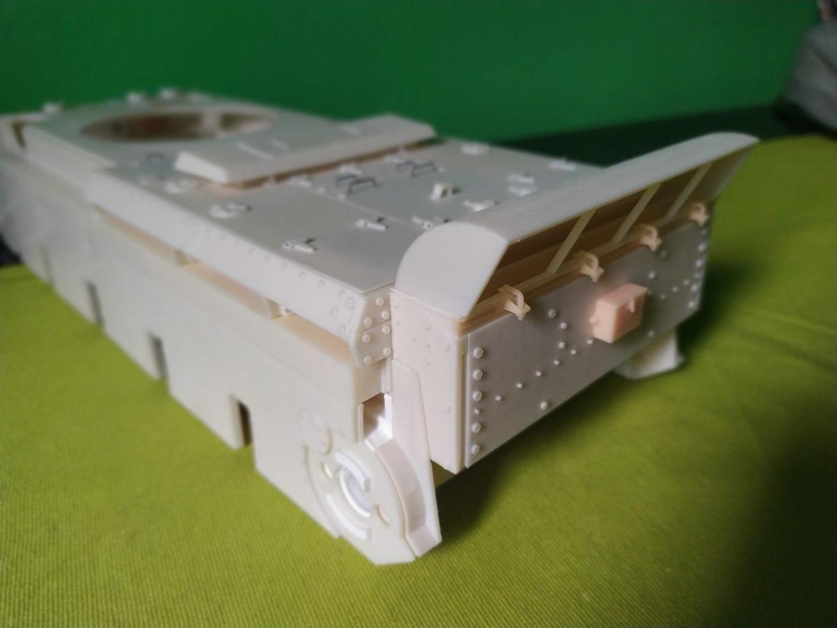

Have finished 3D model of the turret.There are some of my favourite details.
I am pretty happy with the results.Going to make pictures of the turret soon.
Printing tracks right now.

Have some news.Engine covers and the exhaust.

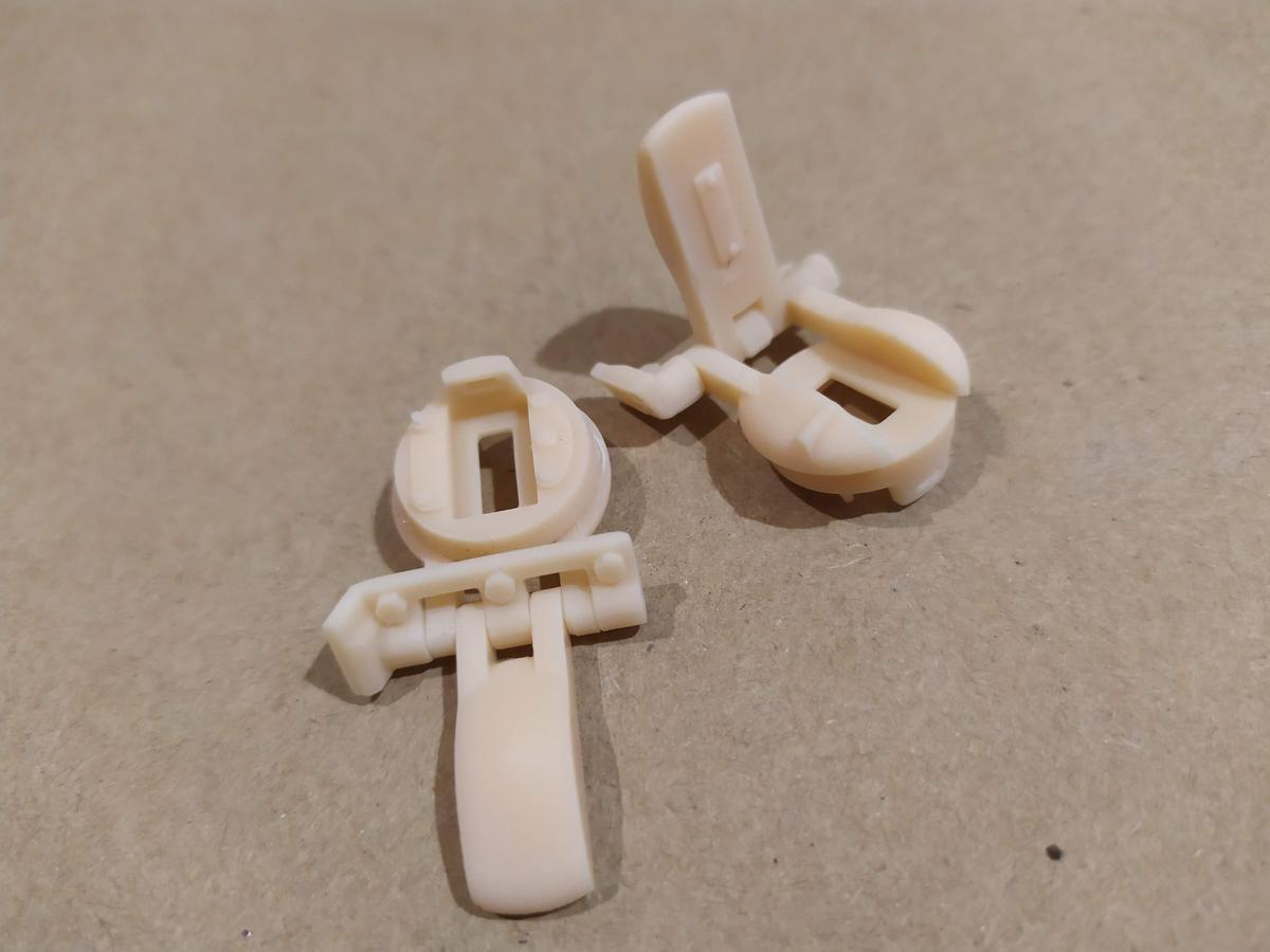

Turret is painted with a primer, all parts are installed, including that PMMA lens.
Light is working, of course.It will be included in the next video, with all other details of the turret.
For now, i have this video with the Commanders hatch.
This hatch contains 5 movable parts.
