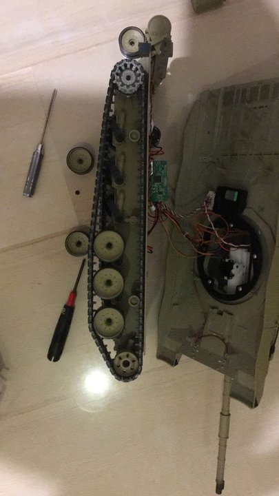

But as you might get the feeling, that's only half the story isn't it, because it is. This setup lasted me for only an afternoon's worth of IR gaming, because the plastic tracks stretched, causing track throwing issues, which led to the plastic clutches wearing out as well. But while it lasted, it was fantastic - the tank so light, and its tracks were broad, affording low ground pressure and great maneuverability. With the day cut short, its back to the maintenance depot then...
The PDSGB gearbox was new at the time, given that it worked like the other Tamiya gearboxes in my modern tanks, I got one. It was a well made piece of kit, but what I wasn't prepared for was the weight, which was so bad it sagged the rear end, and setting higher preloads in the rear springs didn't help much. In the end I scrounged the 4:1 unit from my Heng Long Abrams to make the suspension work ($130 for the PDSGB and $80 for the 4:1).

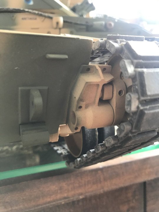

Dragging her butt on the ground
Using the highest settings for spring preload on the last three roadwheels didn't help much.

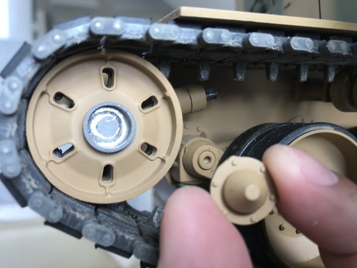

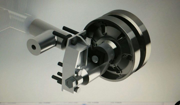

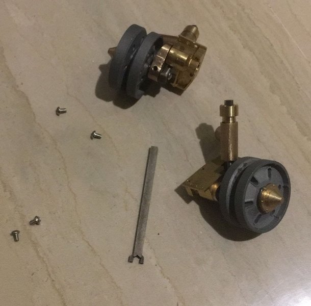

Fixing/adding a working track tensioner proved to be the most expensive part of the endeavor. DKLM RC had a beautiful CNC piece for $250, but with no other options I went for it. In for a penny, in for a pound! (I did find out Heng Long eventually revised the Challenger 2 to have a built-in track tension, you lucky people! I have always had good experience with Tamiya's Leopard 2A6 tracks, which are made of hybrid materials of high strength steel for the end links, plastic base with rubber pads, and I got a set for the Challenger ($90). The stock sprockets' teeth are of a different spacing, so a bespoke Challenger-style sprocket with Leopard teeth spacing was used ($50?).

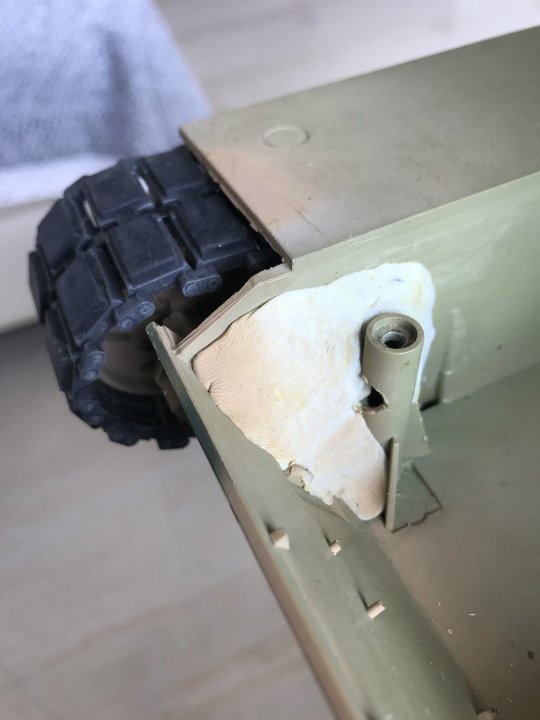

The front hull was reinforced with epoxy to offer more rigidity (note how thin the plastic is)
Track tensioner in CAD
The mounts are machined brass, and the idler wheel is metal (not too sure if it was a metal 3D print or cast, due to the rough surface texture)

Other nice features - a magnetic hub cap covers the axle stub. The idler wheel rides on ball bearings.

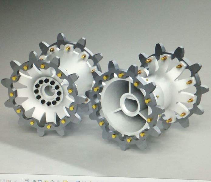

Challenger 2-style sprockets were made with Leopard 2 teeth spacing so that the tracks could be used

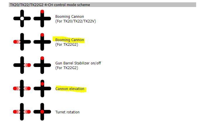

It is generally fairly simple to set up the Clark board - all of my non-Tamiya tanks (T-55, Abrams and this Challenger) have had, or still run Clark boards. However I tended not to use the tanks very much due to a fundamental difference where gun barrel control and main gun firing is different from Tamiya's setup:

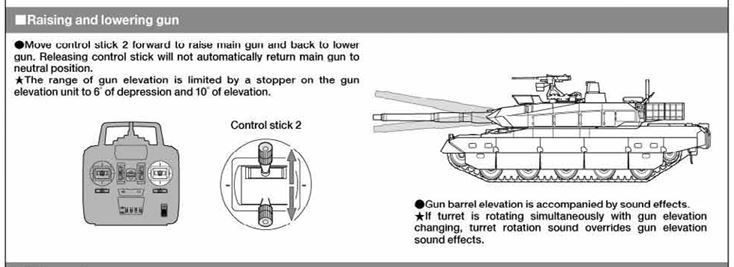

Raising or lowering the barrel of a Tamiya tank is as simple as pushing a stick up or down.

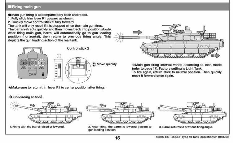

Firing the gun is only slightly more complicated because you need to activate the trim switch. But its still working off the same stick.
In contrast, Clark requires you to combine the axis of two sticks in order to manage your gun barrel, as well as fire the gun. In practice (and yes I have tried), in the heat of battle, I have either turned off my engine sounds, or worse, put my tank into neutral such are my hamfisted actions when the enemy is near! At least for me, when things get hectic, I want my controls to be as simple as possible. As mentioned above, I had some time, and a fancy programmable Spektrum DX8 transmitter, so I started playing with the mixes to see if I can program a Clark board to work like a Tamiya (yes, I asked Clark to provide a Tamiya mode before too).

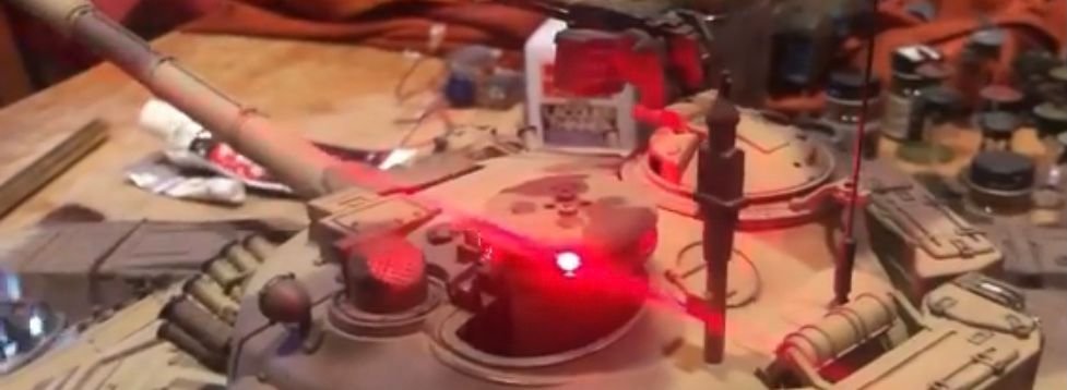

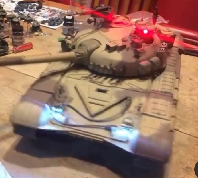

LegoDEI receivers are far more **sensitive then Tamiyas. They can be easily configured with 45deg. shades (optional) to mimic the Tamiya receivers performance. But this is not recommended for use with the basic HL 6.0-7.0 system especially if the player is new to tank combat. The point to the 360 “hit” sun shade is to help balance the engagement between Tamiya systems and HL especially if newer players are using a HL tank. HL tanks are generally faster in shooting, turret speed and turning. The 360 shade balances this advantage with making them easier to hit. More advanced player that understands how to properly set up and use a 45 degree hit shade do use them and achieve performance equal to the Tamiya receivers.
**The LegoDEI receivers use four IR receiver bulb at 45 degrees to each other and four very bright hit indicator LEDs (red or blue options). The receivers are also very low profile. The four bulbs make the system reliable in taking hits from all angles. The problem comes when “new tankers” install them incorrectly. They often do not a-line the bulbs in the correct orientation (front/rear/sides). So then when using 45deg shades instead of the 360 shades this causes issues with the traditional “hit zones” (they become TFA zones) we expect from properly set up Tamiya receivers. As a matter of reducing any issues we recommend the 360 shades at our games and thus have few issues when they are used.
LegoDEI IR receiver indicating a hit. This is a 360 sun shade.
LegoDEI IR receiver installed on HL 6.0 T72 receiving a hit. It is tied into the rear tail light port of the system so it flashes with the headlights. Hard to not see it take a hit.
LegoDEI IR receiver with 45deg sun shade(same look as the 360 shade) mounted on HL 6.0 M4 Sherman. The hatch and MG do not effect or block incoming IR beams because the bulbs are very sensitive so the receiver can be placed lower and less conspicuously in turret hatches. This tank mimics the performance of a Tamiya IR receiver when “taking hit” at angles.
