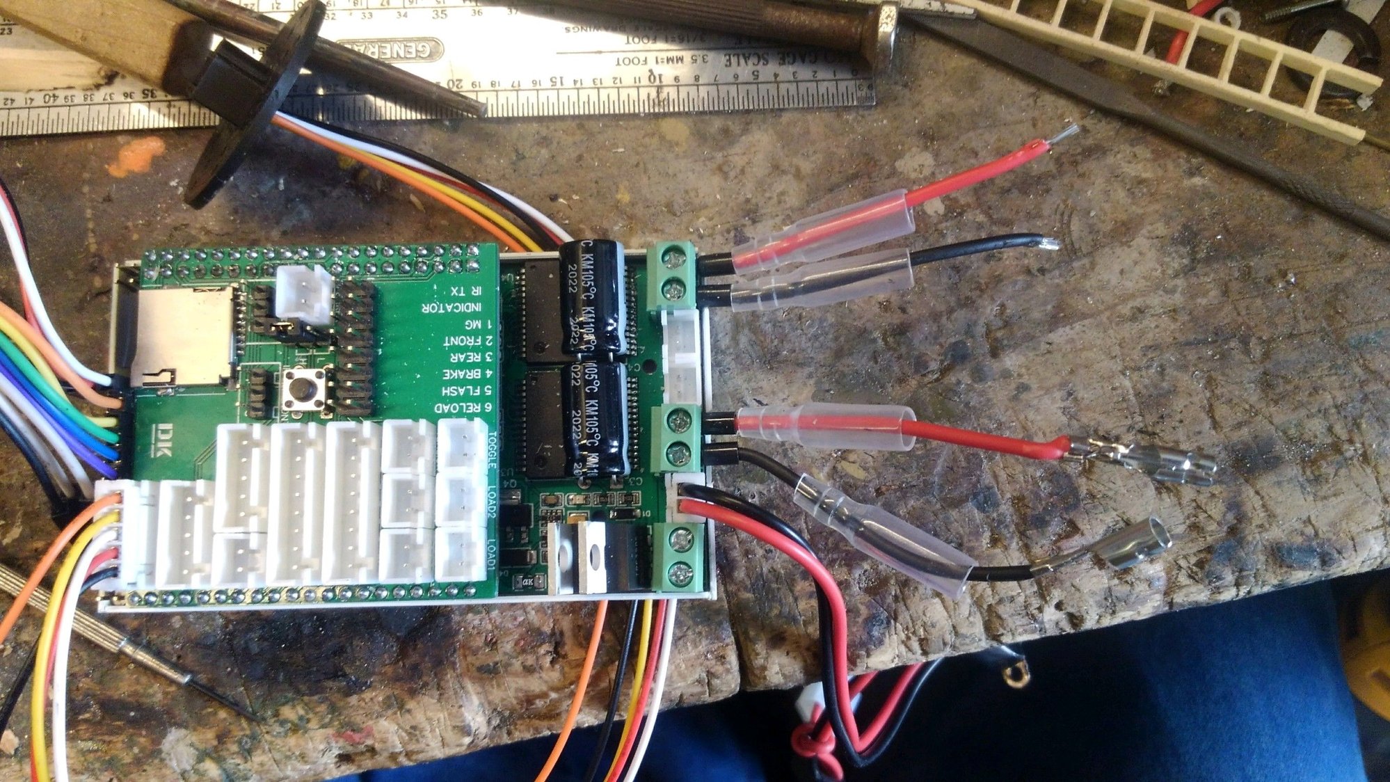

DKLM RC has recently started carrying a new TCB made my an associate of his in Russia. DKLM is the only place I know of currently to get this board.
First off, let me say this is review, first impressions and a critique. I will point out good and bad as I see it. Also note, I have been in contact with DKLM providing requested feedback for firmware updates and modifications through this weeklong process of setting up and testing this board.
This board is available here https://www.dklmrc.com/DK_Tank/p2389473_21001608.aspx
Further info and setup manual https://dkmodule.com/tank/description/
Now, first off, this is very much like an IBU board the way it is set up with an SD card and an INI file text.
Sound sets for tank variants are fairly limited right now but, they are just wave files so you can create your own or, if you have an IBU you can copy the IBU sound files to your pc, rename them to the required file name scheme of the DKTank and then move them over. Some sounds will not correspond to the DK sounds so pay close attention to what you do.
The DKTank offers lots of options for setting driving parameters including breaking steer and super spin as well as wheeled vehicle servo steer. Also dual motor trannys and clutch drive or propulsion dynamic trannys are supported.
I wont go into all the options available here, go read the tech sheet on your own to learn all the tiny details.
Some cool highlights, there is some spare output options from the board and allows you to set up your smoker to come on when you get shot up and KO'd in IR battle. A neat option.
I had a hard time getting the smoker to tun on with the corner position of the sticks. After many many tries I got it to work once and could not turn it off or make it come on again other time. Other option is to use a switch on a radio channel.
It offers HL IR plug in as well as Clark sytle IR base cable plugged in and tamiya apple protocol for IR.
You can configure where you want your speed reductions to take place during the IR hit sequence as well.
The sound on this thing is amazing and super loud, louder than a tamiya, what an amp it has. There is an option for using a channel on your remote for either a knob or a 3 position switch or default to the master volume setting in the text file on the INI. Also offered are setting the individual event volume sound levels like MG and gun fire and engine and turret traverse etc.
Like I said, there are lots of options, I compiled the instructions into a word document and printed it out for ease of use.
One thing I was unable to figure out was if the board would support using a tamiya recoil unit. There are options to set up and operate the airsoft gun via timing and spring tension for mecanical recoils but no specific place to plug in a tamiya recoil unit.
Recoil with a servo is fully programmable timing and reversible.
Where I ran into a glitch was with the track recoil. The track recoil has two settings, one toward the rear and one to return forward. I cant imagine why you would want to have the tank return forward after the jerk back from a gun fire shock but its there, I can only think of the violent HL track recoil to shake the bbs up and feed them into the airsoft gun hopper properly.
Any way, the problem I found here was trying to turn off the forward track return after the track recoil. I tried 0, .1 and 1 and no matter how I set the forward track return to turn it off or minimize it, it still returned forward just as far as I had the rearward track recoil set. So it looks really stupid and is annoying. After a few days of testing that I just turned off track recoil.
Another place I found a glitch was with the servo elevation on the stick. When I elevated my gun all the way up and then let go of the stick, the elevation servo would go limp and droop the barrel a little. Then, when I pulled the stick down to depress the gun, it would jerk violently up to the top before it began to lower. See here...
gun elevation

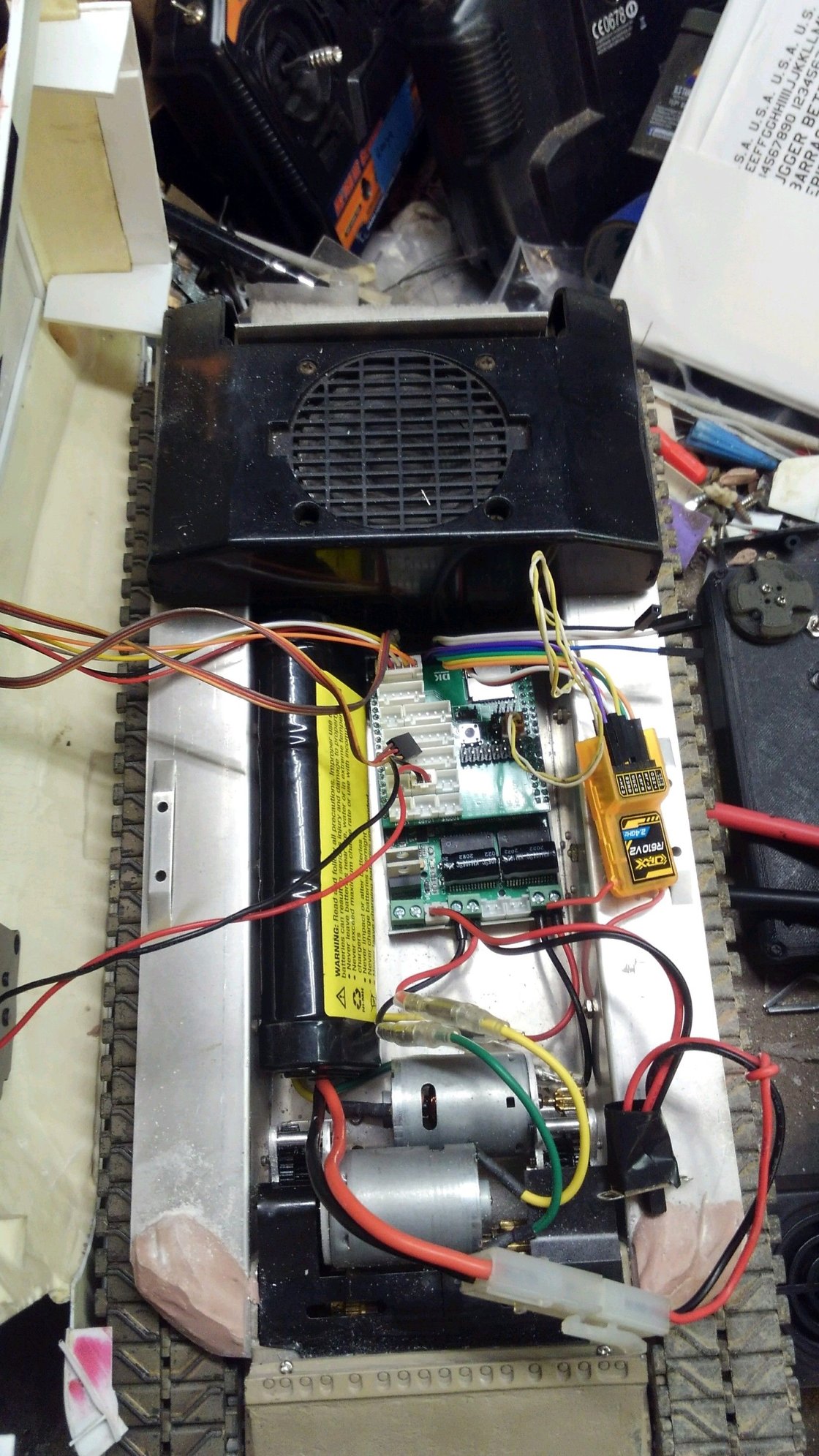

I have the DKTank installed in a stock tamiya sherman chassis and I just felt it was way too slow even at full speed.
I checked my hobby king TH6 radio on my PC and pushed the throttle travel up to 120%, the max, and it was still slow, it didnt seem to make much difference at all.
So on the bench I began to test and take readings
With my radio set at 120% of travel the battery read7.6 Vdc no load and 7.3 under load at top speed.
The voltage going to the motors was only 5.2v each.
If I pushed my trim all the way up, it delivered 6.6 volts to each motor. Still quite low and slow
I wondered if the board was draining off the power for operation so I tried an 8.4 Nimh
No load voltage was 9.2v, under load at top speed was 8.8. The motors received 6.5v with the trim centered and 8 with it all the way up.
Now obviously you cant drive with your trim all the way up but this was proving something to me, that the DKT board wanted to receive more stick travel input than my cheap hobby king radio would provide.
So I got out my Spektrum DX8
on the 7.2v Nimh at 7.3v under load, the DX8 radio had the DKT delivering 5.4 Volts to each motor. Just a tad more than the HK radio at 120%
Now I was getting somewhere...
I moved my servo travel setting up to the max at 150% and then the DKT board delivered 6.5 volts to each motor. Thats it, as fast as I could go.
So now I decided I need a bearing, something to compare the test results against.
I have a tamiya sheridan system here that is installed in another tamiya sherman I have that has not been finished. This is the newest MFU Tamiya has produced.
My DX 8 radio is already bound to that RX in that tank.
So I pulled it off the shelf and moved the 7.2 NImh battery over to it and verified my settings, throttle travel was set to 100%
The Tamiya Sheridan MFU put out 7.2 volts to each motor at full speed.
So there you have it, I would expect that the DKTank board would be able to deliver about 7.2 volts to each motor at 100% of stick travel but it only does about 5.2 - 5.4 volts depending on what your radio is. Now there are ways to push that up with a very fancy radio, but still not to full voltage spec of the battery.
So your going to have a slow tank.
After my correspondence with DKLM they have provided my feed back to the designer and I hope that he will be able to resolve this issue with a firmware update and make it put out full power.
For now, its too under powered for how I drive and battle most of my tanks so I will set it aside hoping for an update to it unless I decide I have tank that it would work ok in as is.
I also recommended that an option be added to make the Machine Gun fire an IR burst at values that will trigger the IR like clark offers for options for LAVs and such that dont have a large one shot cannon.
I also recommend that if you get the adapter cables with the bullet plugs for tamiya or HL7.0 compatibility that you slide the rubber grommets down and solder the connector onto the wire as 3 of mine all slipped off their crimp quite easily right away during install causing me to pull it all back out and solder the wires.
My overall impression is once the throttle motor voltage issue is resolved and hopefully the other glitches fixed or remedied this Tank Control Board will be revolutionary for play especially with clubs in IR battle. I have high hopes for it despite my current situation with the board I have on hand. If you dont mind a slow tank right now, this board is a great option. But if you battle your tanks or like them fast, you better wait a bit until this is resolved before you go buying one.
