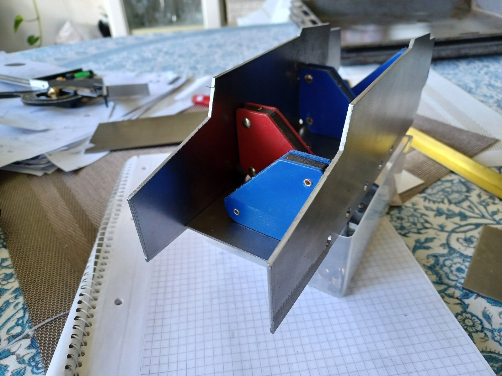

Here are the first humble pictures of my knacker. Sorry that they are crude and not exciting but from little acorns......
2mm steel has been used to rough out the two sides. The front is still to be done...Im waiting for the gears cover which lets me determine the shape of the front walls.
Oddly enough, it seems the swingarms on either side swing in different directions. On the right, They swing forwards (counter clockwise) and on the left they swing the other way. So I have to start making those arms soon.
This tank cannot weigh more than 6 or 7 kilos so I am hoping standard motors suffice. If not....I am taking up another hobby!
