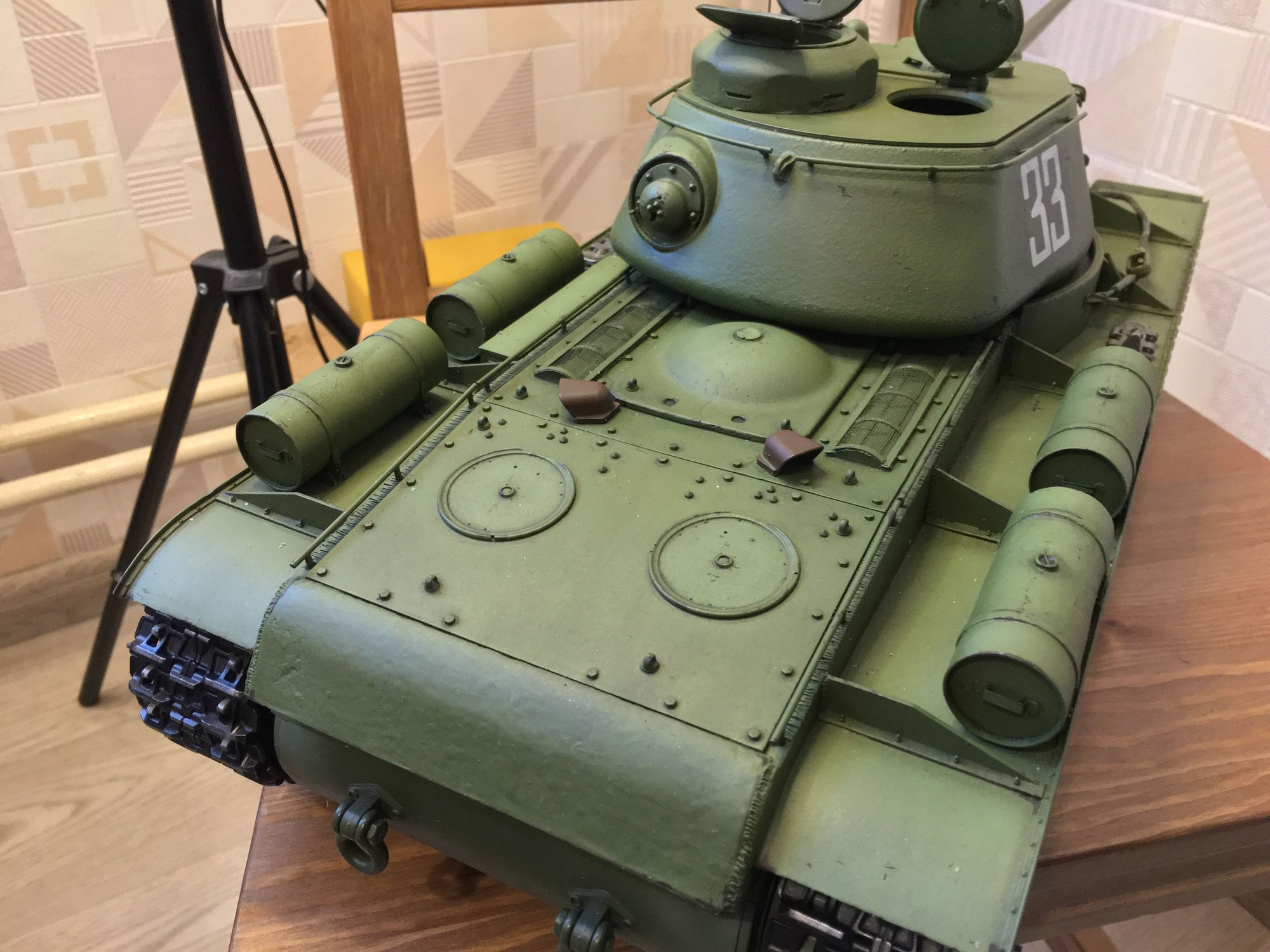

The details went to the painting. There will be number 33 on the turret

Before sending it to the customer, I conducted testing. The result in the photo((. Taigen forgot about the quality
Old 01-20-2022, 10:04 AM
Artem RedArmy
Artem RedArmy's Avatar
Join Date: Sep 2021
Location: Moscow, Russia
Posts: 66
Received 64 Likes on 38 Posts
As a resume . The quality of Taigen has become even lower. Replaced three balancers, two sloth tensioners, three torsion bars. It took three months to make the model, I used early wheels, tracks from JS-2 taigen, driving wheels HengLong. The turret has a recoil and lifting on the servo, IR battle system. Rc module - DK TANK
