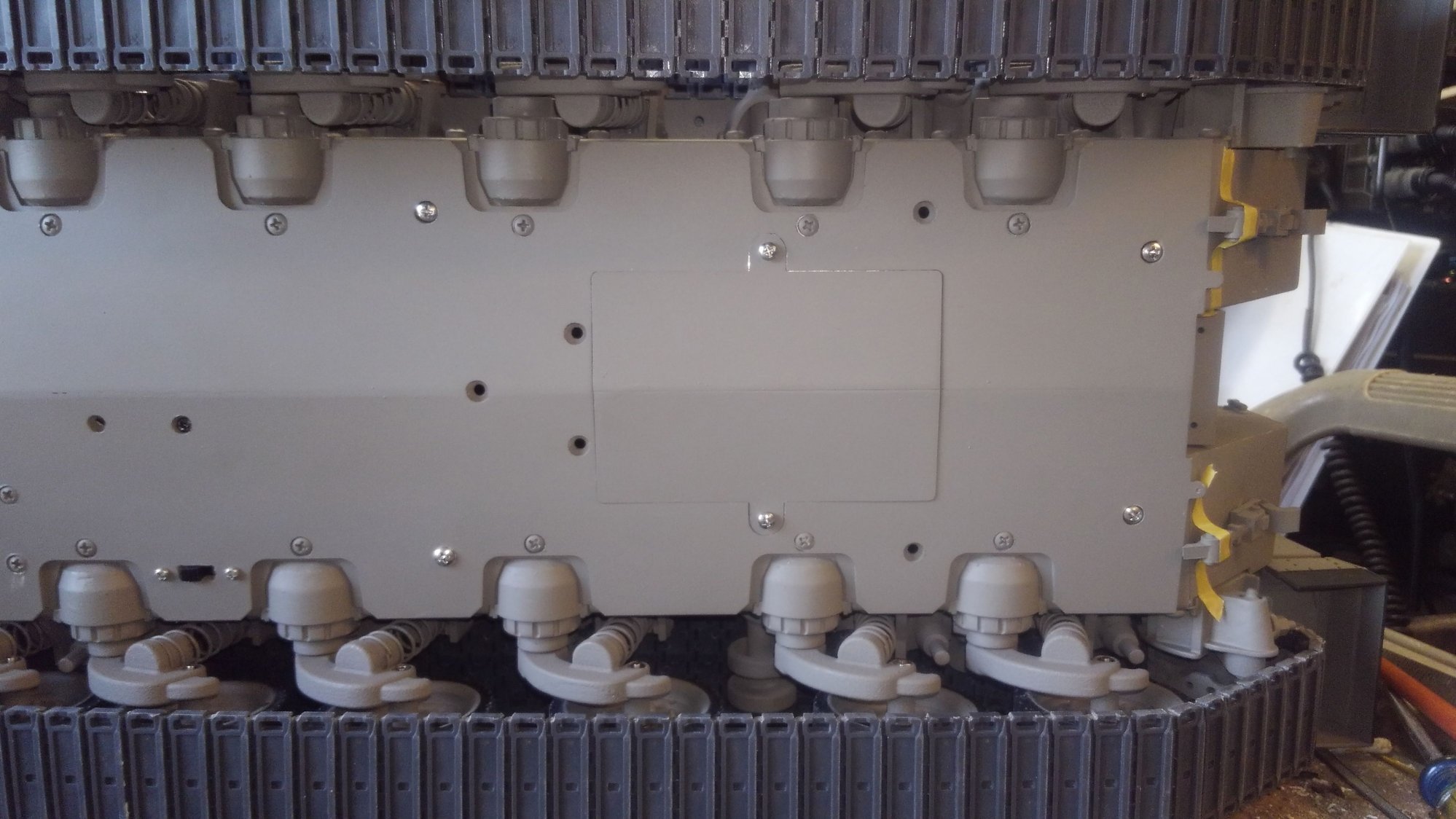

As you can see below, the plastic under chassis armor plate just popped off. I glued it back with rubber cement
