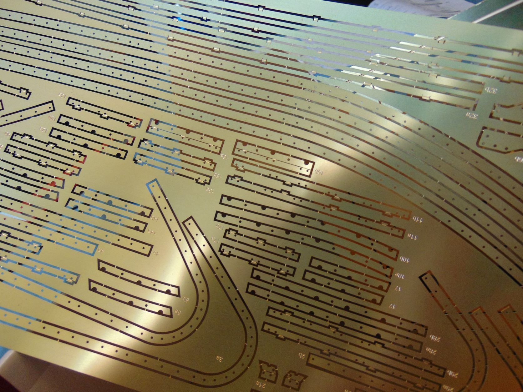

more close-up pics, the gearboxes are sealed and its chain drive to the drive sprocket
The radio options suggest a 9 channel radio to operate all the features of the VCU (Hooben's electronic board), though I will go with a HL 7.1 for battlesystem options and more intuitive stick control

Do you have to bend those photo etched parts?

There are two types of methods Hooben used for folded parts, the first is a tab fold insert (for curved type parts) and second a continuous fold for straight parts. In both cases there is a tiny etched line to fold on so no need for straightedge and vise.
herrmill (03-23-2023)

Most of the photetch is flat mounted (no fold)
