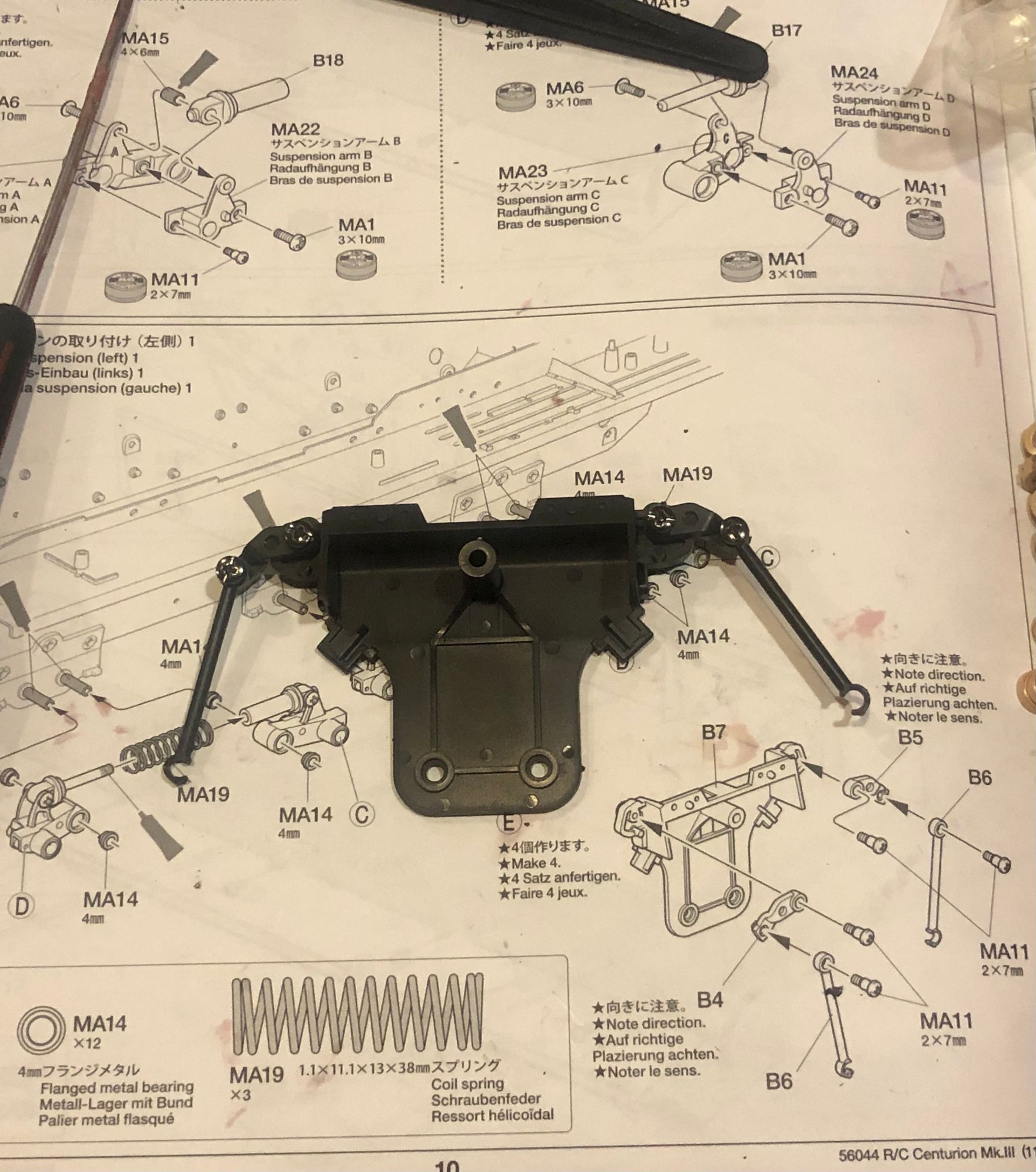

Build photos continued.
The thin vertical plastic arm linkages are simply cosmetic and I suspect they will be damaged easily. If I was going to attach the side skirts I would have left them off as they would be unseen behind the shirts.
Jumped ahead because I was curious. I had a set of sealed bearings for some of my Tamiya tanks and found that the Centurion uses the same size bearings.

The idler arms and mounts are metal and use the now traditional Tamiya “grove and slot” type of adjustments. The idler wheels are styrene plastic with bearings. Similar to what Tamiya did with the Sheridan.
