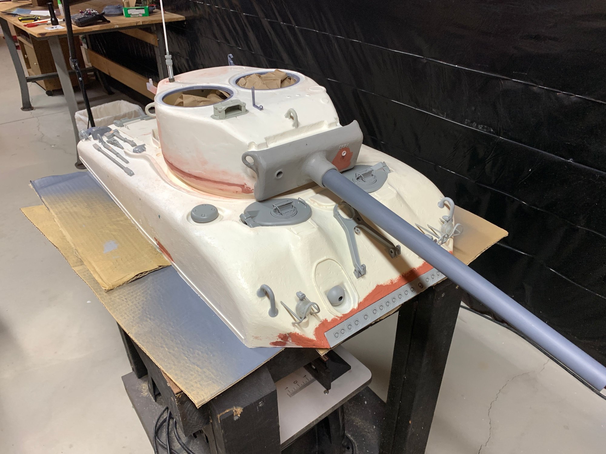

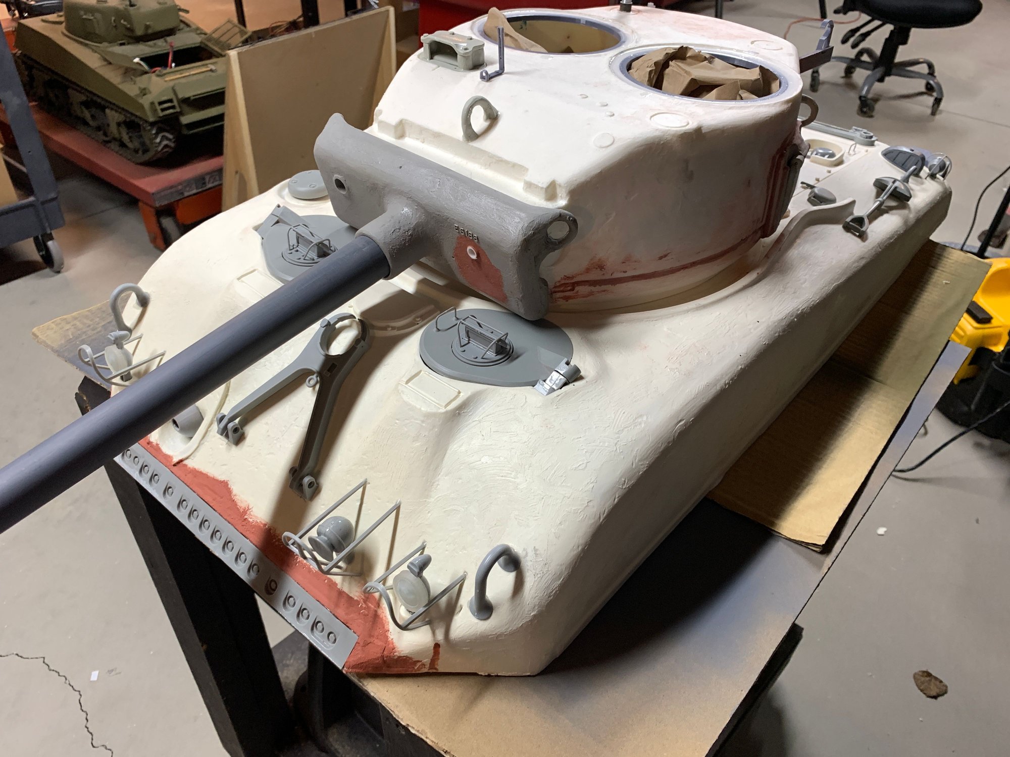

More progress, ready to prime and paint, test run video next week (hopefully)...
Test fit to lower chassis. The 76mm does have a taper to it, but you can't tell from this shot, must be the perspective. Wheels are off and being painted. This is going to take a LOT of paint!

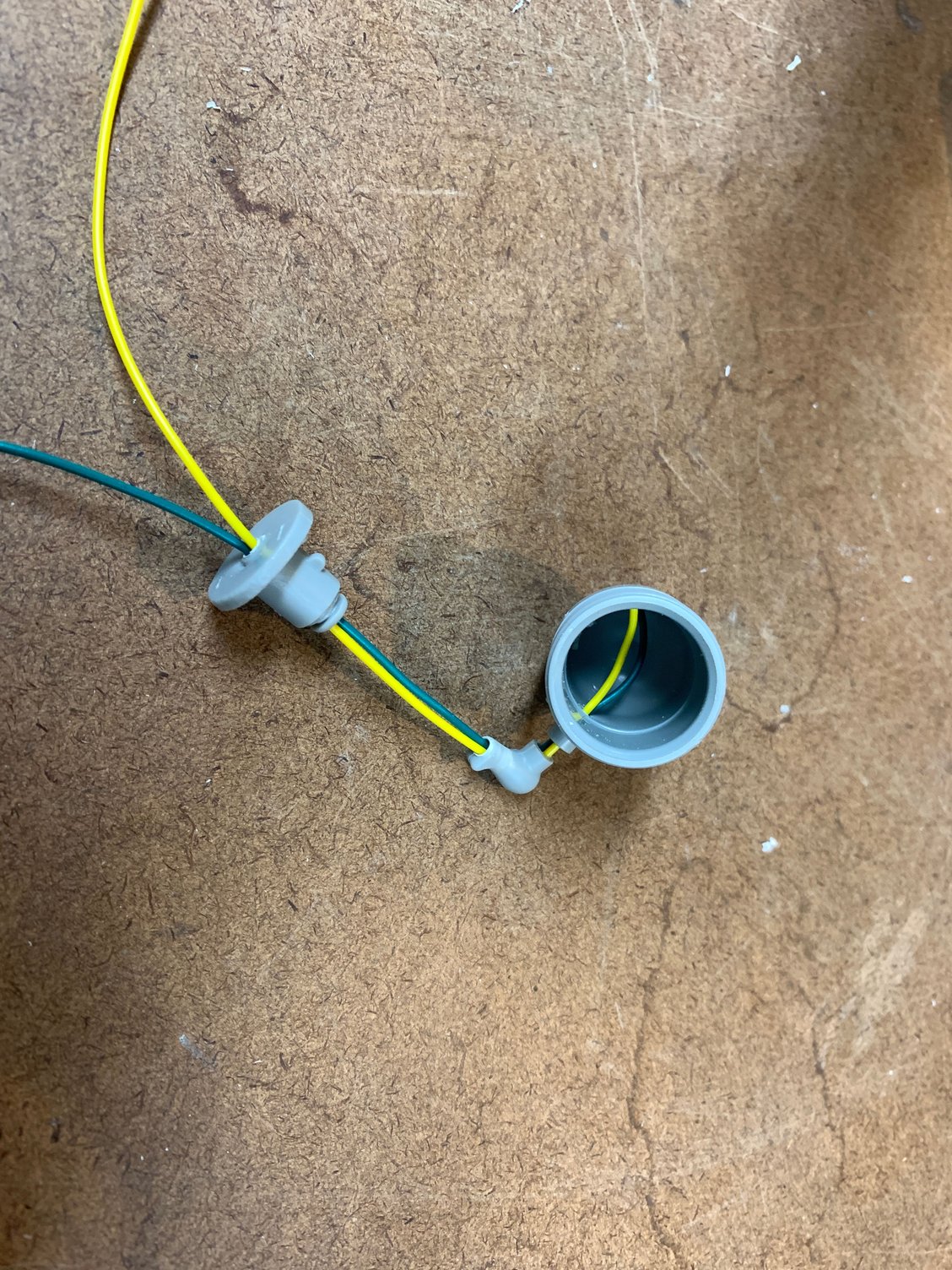

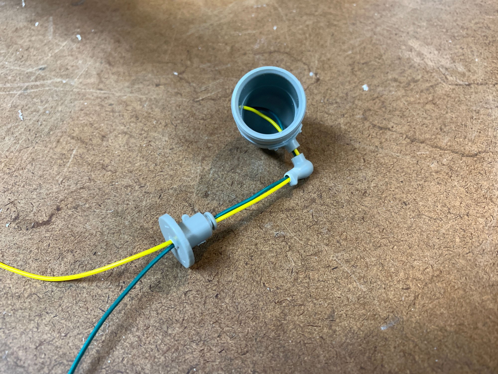

Adding a white LED to the turret spotlight. Just enough thickness to get two wires through.
The light will be stationary. I could have made it so it turns with one of the knob controls on the transmitter but that was going to be a lot of extra work. Maybe on the next tank, I can always retrofit it.

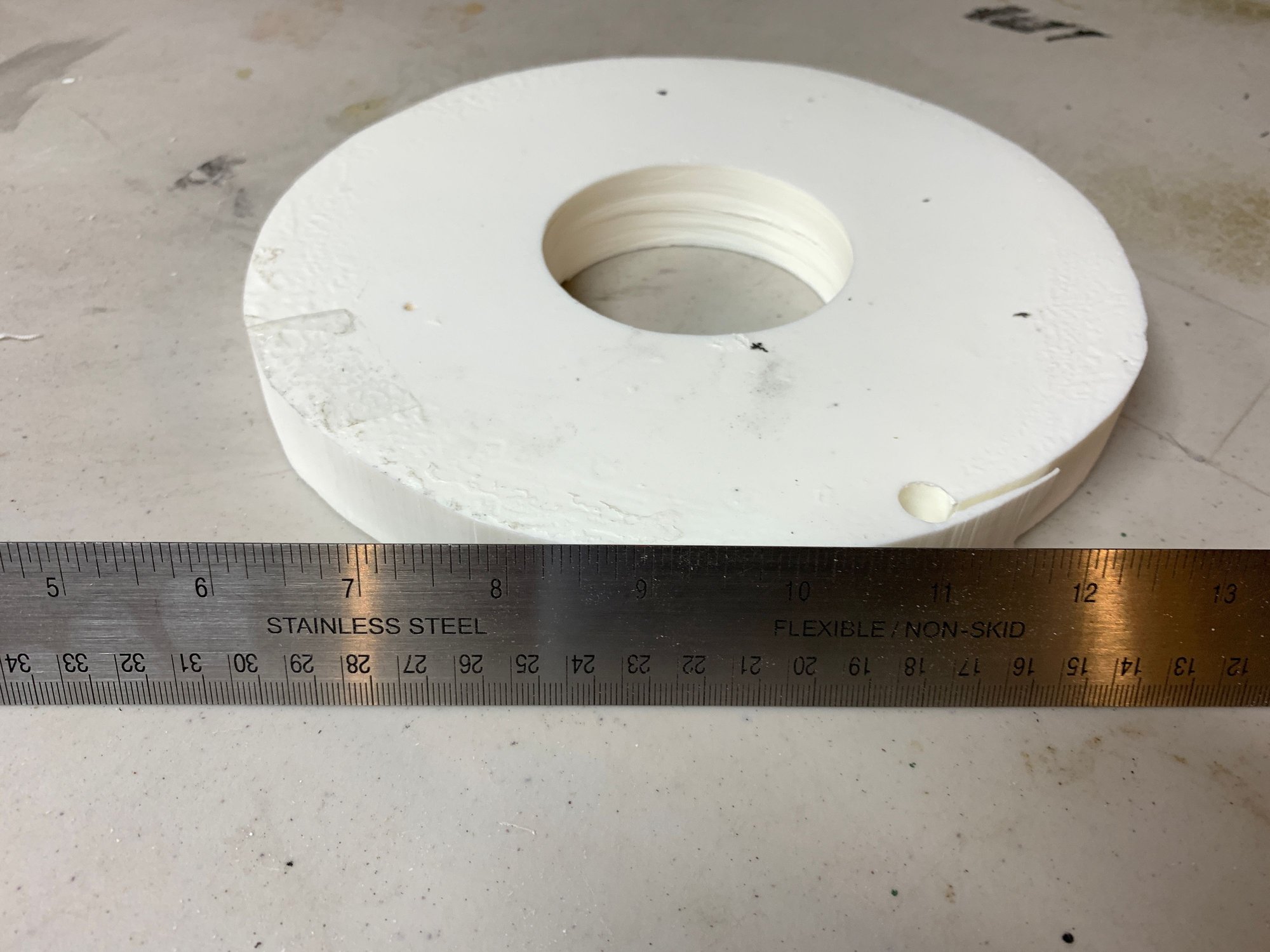

The turret kit was great at having a T23 turret option. One drawback was it was molded with A LOT OF EXCESS RESIN! I used a grinder bit to scrape the interior walls to reduce the weight. This huge chunk was at the bas of the turret. I driller the small hole at first to run the wires from the lower chassis to the turret. I then realized there was
too much excess resin so I removed this giant piece. By the time I removed all the "unnecessary" resin I probably cut the weight in half.
Getting ready to prime!
You can see the 3D printed headlight lenses in this shot. I'll cover the lens portion with mask and then remove after priming and painting.

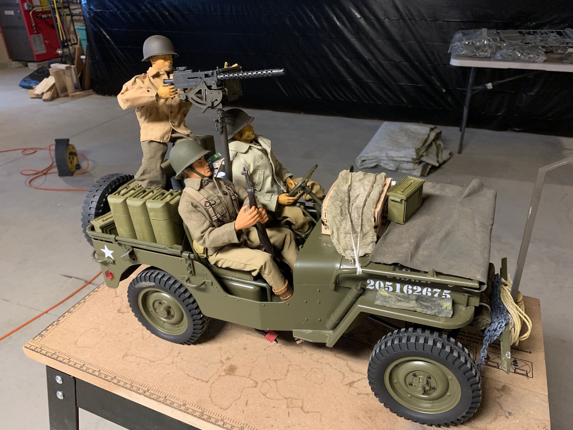

This is the .30 cal I had in mind, I've replaced it with a different model on the jeep so it's currently a spare, and of course you'd have to open the muzzle, but I'd be pretty tickled to see it mounted on a very cool tank. And yes, I know the ammo belt is on the wrong side, it's not permanently attached.

Here's a pic of the .30 cal and cradle. The guy in the back was a quick stick figure I mounted, it's been replaced with a normal Joe

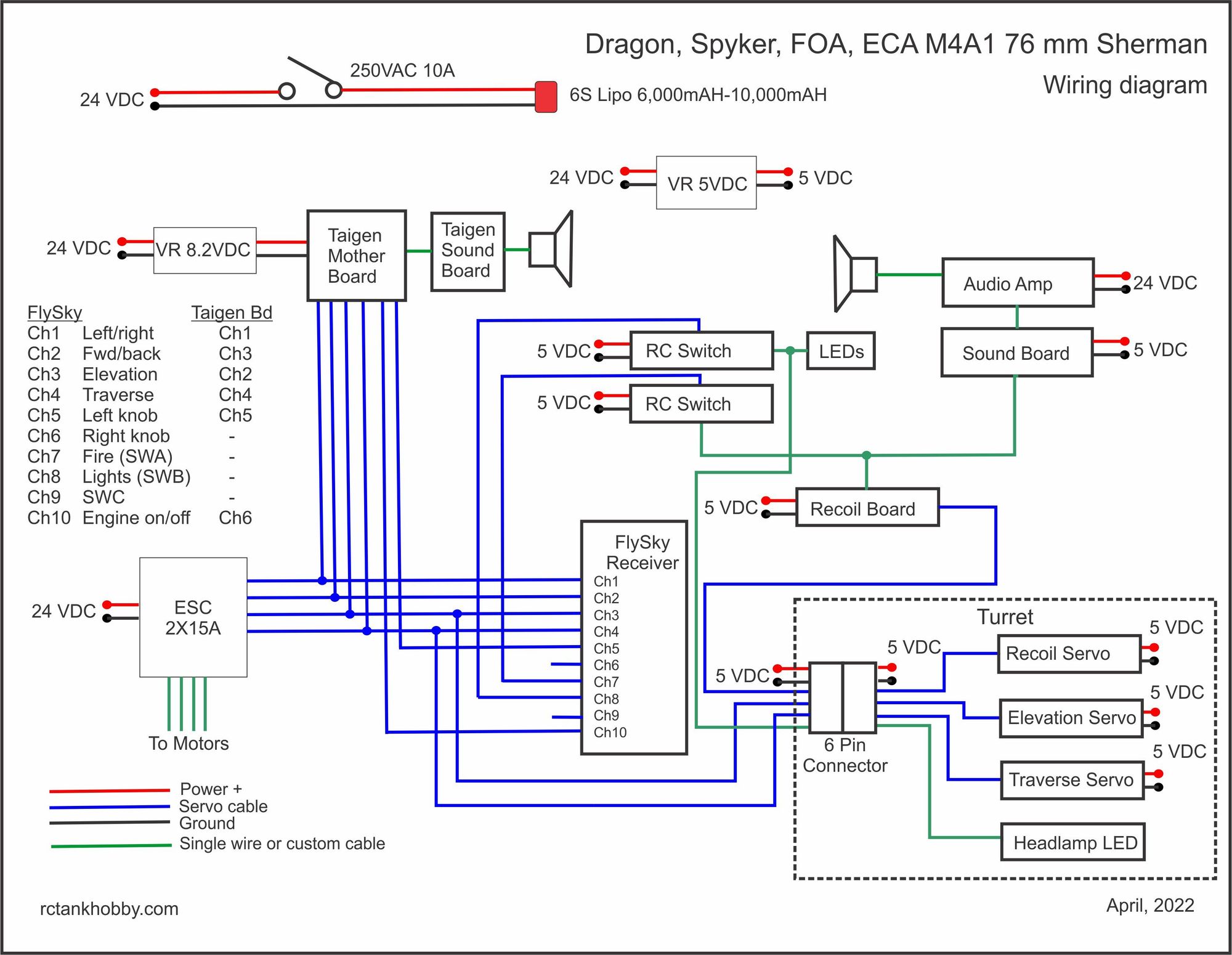

For anybody that is interested in the electronics. The ESC is a Sabertooth from Dimension Electronics, I have good result with their products. Yes there are two speakers in this tank. The Taigen board drives one with engine and turret sounds. The way I configured the system I couldn't get the Taigen "fire" sound so I put a separate sound card in. In regards to the firing I like to have as a separate channel anyway. There are two voltage regulators, one for the Taigen board (8.2 VDC) and one for the lower voltage components (5 VDC) like the servos and sound board. I have two channels that are free, one is a knob and the other a three way switch, so that is maximum, mid and then minimum. Not sure what to use them for yet, if I use them. Need to do more current draw and temperature tests. A quick test on level ground the current draw with a 6S lipo is about 10 amps at full throttle. I'll post some pictures next time I take the top off. I have a few digital displays showing various voltages plus one of those Lipo monitoring modules that shows full voltage then each cell's voltage and then repeats. It also has a sound alarm for low voltage.

Great Videos - it turned out excellent. Thanks for sharing your schematic. I have a couple questions being an electronics-noob:
1) Whats a recoil board?
2) How do the 2 sound cards sinc together? Or maybe they don't? Or you use one for motor? The other for gun noise? Sorry you may have already said this.
3) Are all the 5V powered from the Sabertooth (it has a 5V terminal -at least the bigger ones do)? Or a 5V bus /terminal block /VR from 24VDC?
4) Assume the 250VAC 10A is the master switch rating?
Great stuff, gotta get me a big 6S LIPO to test on mine!
Best regards,
Bob

Hi Bob,
1- See my response to Crius. I've used these for many things beside recoil, like pulling the trigger on an Airsoft gun (although now I use the MOSFET triggers).
2- The sound cards are not synchronized. All the sounds (except gun firing) come from the Taigen board that is connected to the receiver. The gun sound is tied to the channel that fires the gun, so they are completely independent.
3- I use a separate 5 volt regulator, I think 5 -7 amps to run all the low voltage stuff, also a separate regulator for the Taigen board that wants about 8 VDC. Both regulators are powered by the 6S Lipo. The Sabertooth 5 volts only powers the receiver. I needed more current for the recoil, traverse and elevation servos.
4- Yes, usually switches have AC power ratings, so that particular switch can handle a lot more current at lower voltages. If I recall the tank peaked at 14 amps but generally it's draw is below 10 amps, that switch can easily handle those currents at 24 VDC.
As a note I originally ran this with a 3S Lipo and a Sabertooth ESC. It was too slow, I didn't even bother to test climbing ability but immediately switched batteries to a 6S and was very happy with the speed. Then I put 10 pound weights in the chassis (only the lower chassis was assembled at this point) and ran it around inside and out in the back yard on some hills. I was a bit concerned that the 12 volt motors would burn up on 24 volts but so far so good! I measured the temperature on the motor casings after running it a bit uphill and over obstacles and the maximum I got so far is 155 F. That should be OK, if it gets to over 175F that could be a problem.
