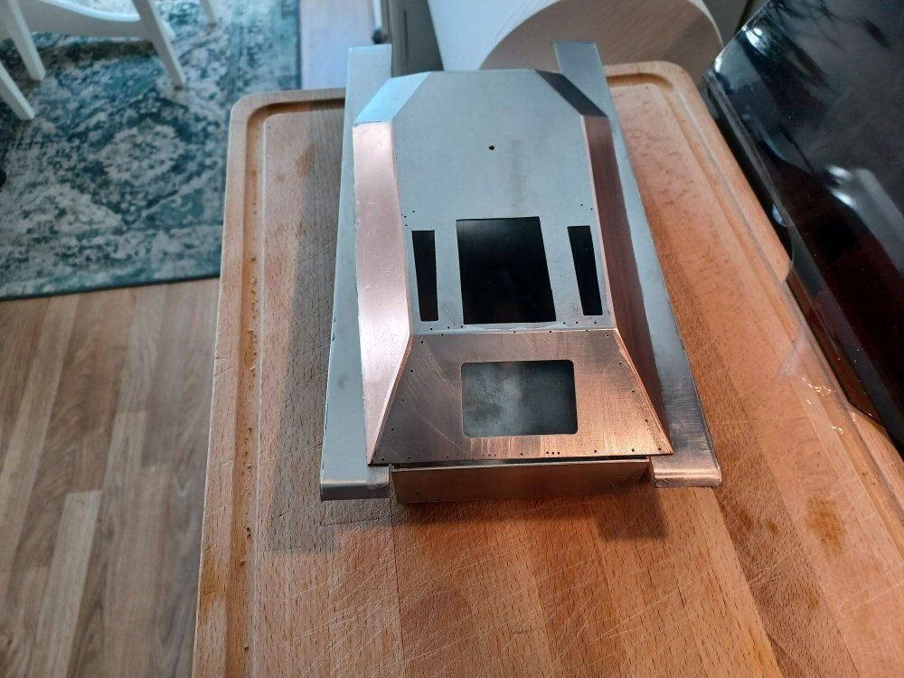

Started fabrication of this one simply to be able to say I started it. Simple enough but the side panels will be trickier.
I did my side panels last night and after a few false starts and some wasted effort... I got them on.
I had to go with copper panels as my false starts used up the bits of steel of I had and the only thing left was a sheet of copper.
Its a bit .......Liberace........for my taste but it will do as it will get painted at some point. Aside from teh fenders....I reckon thats most of the donkey work on the upper superstructure done..... (famous last words probably!).

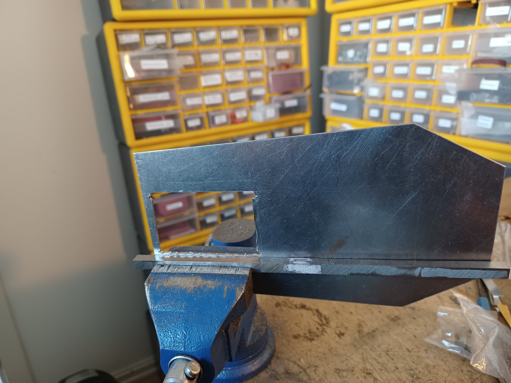

Today I approached the fenders. Which have two problems..... the first being that there is a lip along the whole length and the second is that there bends both front and back.
Normally I use short brass angle (like pictured) and then just solder it to the underside of the fender along the length.
Like this one:
This usually works fine and if there is a shallow bend or curve, in many cases the brass can handle it. But the last time I used this method, the brass "kinked" outwards on the bend and the sanding to smooth it caused the brass to be extremely thin at the bend.
This time I decided on another method. I cut two strips - one the width of the fender and th eother about 10 mm.
Then I carefully soldered the thin piece to the end of the wider piece along its length. I didnt cut the thinner piece to the actual length of the lip (2mm) as its impossible to keep a strip less then about 10mm from warmping. Once soldered on, I simply trimmed of the excess with a dremel and then simply filed and sanded to get a nice smooth lip.
The rough version and the "finished" version are shown below.
Both fenders were made twice as long as needed as if problems occur its often at the ends so I could then trim off the ends if they were no good.
To get the bend....I cut a series of very thin slots in the lip with a jewellers saw at both end. Then I made the bends around a steel bar in a vice. This made most of the cut slots close up on each other with no kinking in the lip. The remaining gaps can then be filled in and sanded smooth with filler. Along with any voids in the soldered seamline etc.
This is how they will look in relation to the top of the hull.
Pretty pleased with how that went...... thought it would be a hassle but it was all done in the space of a couple of hours.

So I went back to the hull.
A major blockage in progress was mating the top hull to the bottom. The top had a load of angles and does not sit stably on the bottom. Any mistake I had made in those angles was going to show up, probably as a skew between front and back...where the front glacis lines up fine but the rear doesn't or something equally poxy,
The fenders have to serve as alignment along the length of the hull so that the top is sitting as it should. Using lots of magnets and temporary fixings, I got the fenders on and the two halves aligned nicely. Filler will solve what solder could not.
The sharper eyed will notice two potential cock ups in my measurements. The first of these is the where the rear of the top half meets the rear of the bottom half - there is a substantial gap.
My measurements however are OK I think ...because in real life there is also a shelf or lip along that back edge. I point it out in the picture below. So all I have to do is add some steel along that top edge, shape in a bit and it will be as in real life.
The second is the gap between the side glacis plates on the top half and the fender. But in pictures I see online, there is also a large gap (see picture). Im guessing that in real life, the fenders actually are part of the bottom hull and the top was plonked down on top? Either way, the gaps exists and whether or not I leave them there is a matter of aesthetics and my personal taste. I am leaning towards filling them in. Its a simple matter.
On the plus side for me.....were the curved lips on the fenders. I had slotted the lip along the curve and then bent it to avoid kinking (see previous post). My plan had been to fill it with Bondo and sand it smooth to remove the slots.
Instead I flooded it with the solder from the back side of the lip and once hard, gave it a lick with a sanding sponge. The cut slots are barely visible and once it gets a proper sanding and shaping, there will be not trace of them at all.
very pleased with that indeed.
