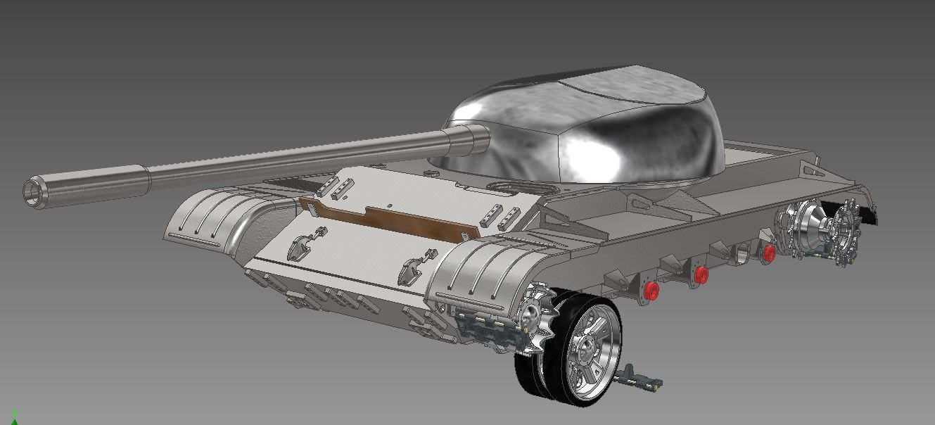

edit: I'm pretty sure the quoted 1620rpm is the speed of the output shaft, not the motor.
My intended top speed is about 10mph (not exactly scale, as the top speed of T-55A is 31mph), and 1620rpm should get me there (I can even limit the top speed). The sprocket diameter at the track pins is about 57mm, but even if my calculations are off, it should be close enough. for the turret I'm going with two of GoBuilda's 2000 series 25-2s, one in standard mode, the other in continuous. They are far too fast to be scale, but there is some gear reduction for turret rotation, and I can limit speed too. For ESC I will try to get one of Kim Olsen's MTCU.
anyway, here are some design progress pics
WIP

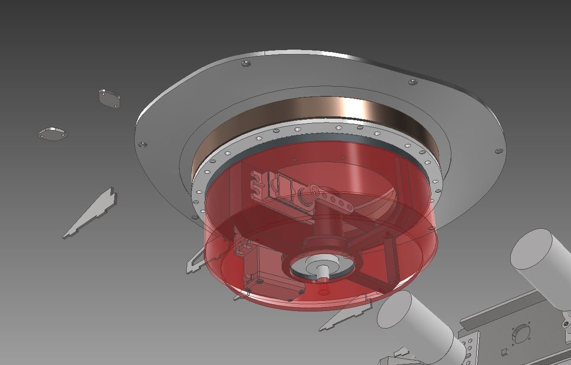

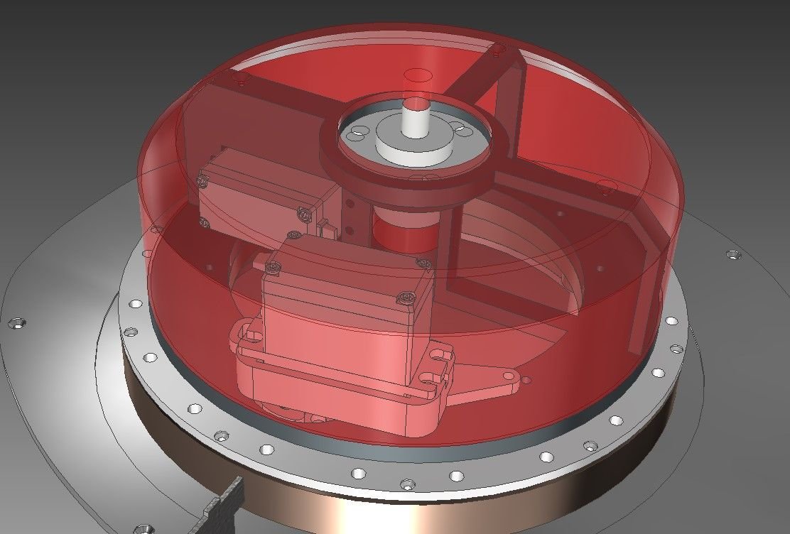

changed up the turret traverse servo setup, now braced
hange
