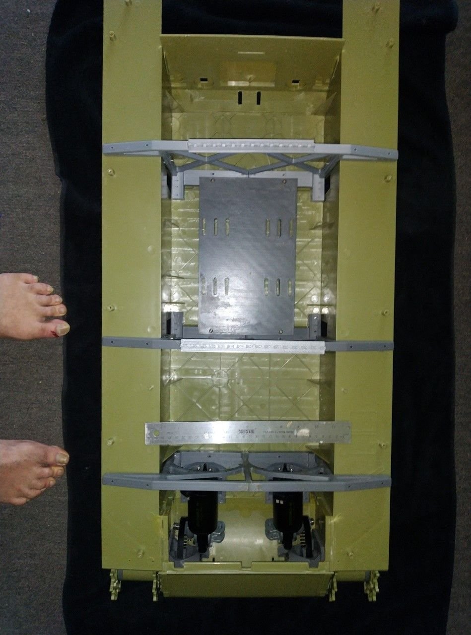

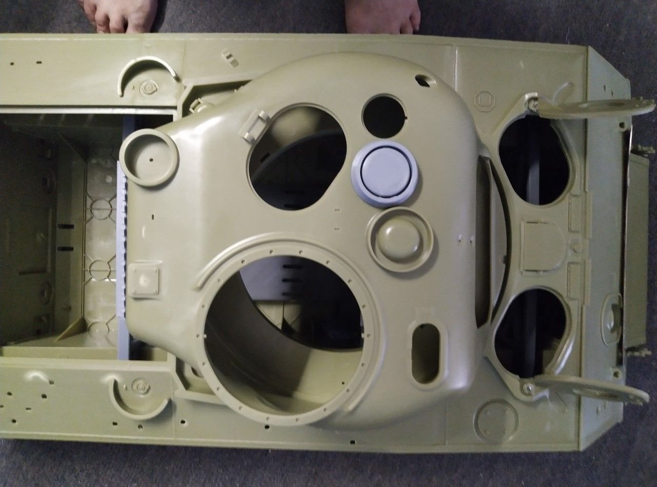

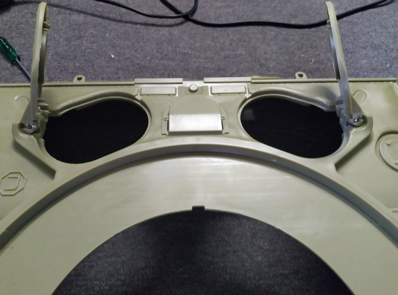

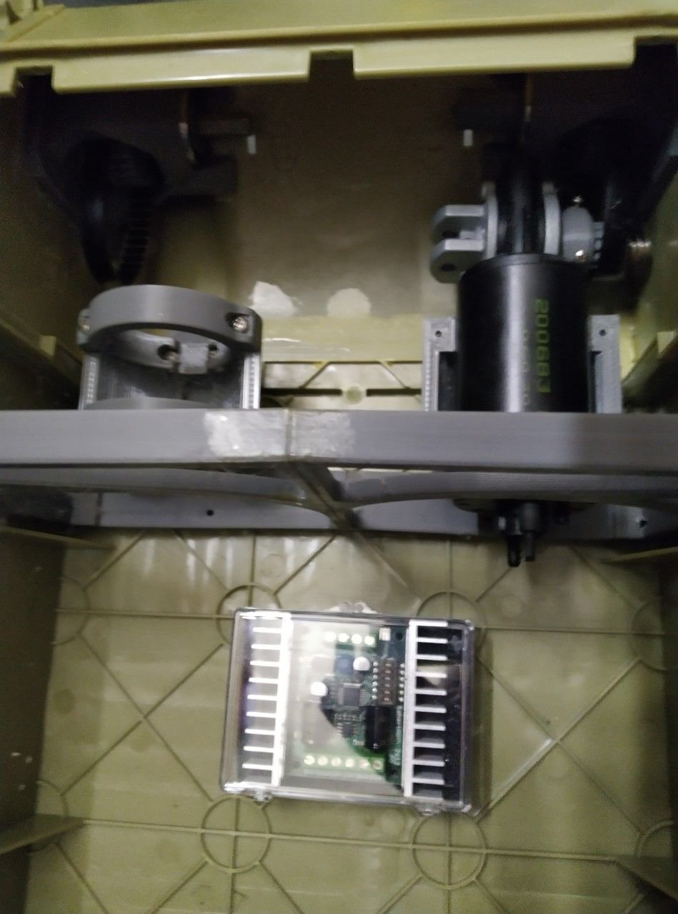

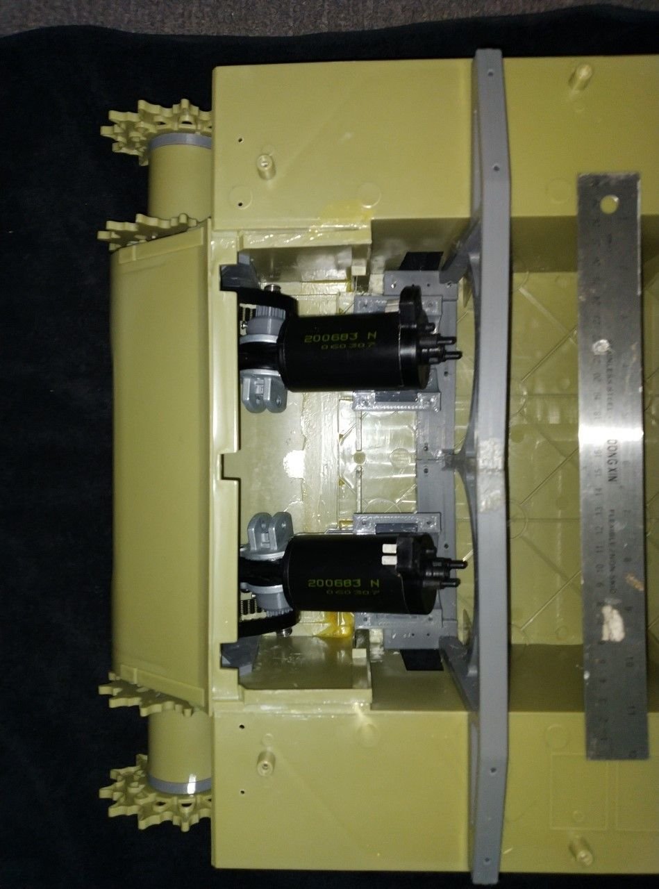

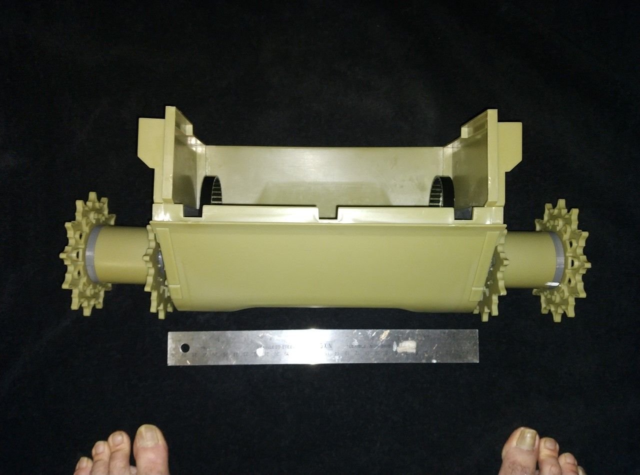

Thought I'd better post up , I know this tank and system has been done to death but anyways .
Way back at the start before the bushfires, Covid and 4 once in 500 year floods in 6 months .lol.
Ryan from Spyker's bits I 3D printed. That guy is awesome .
Anything grey is 3D printed .The motors are just sat in there for a photo op .
An early air blower print in grey .

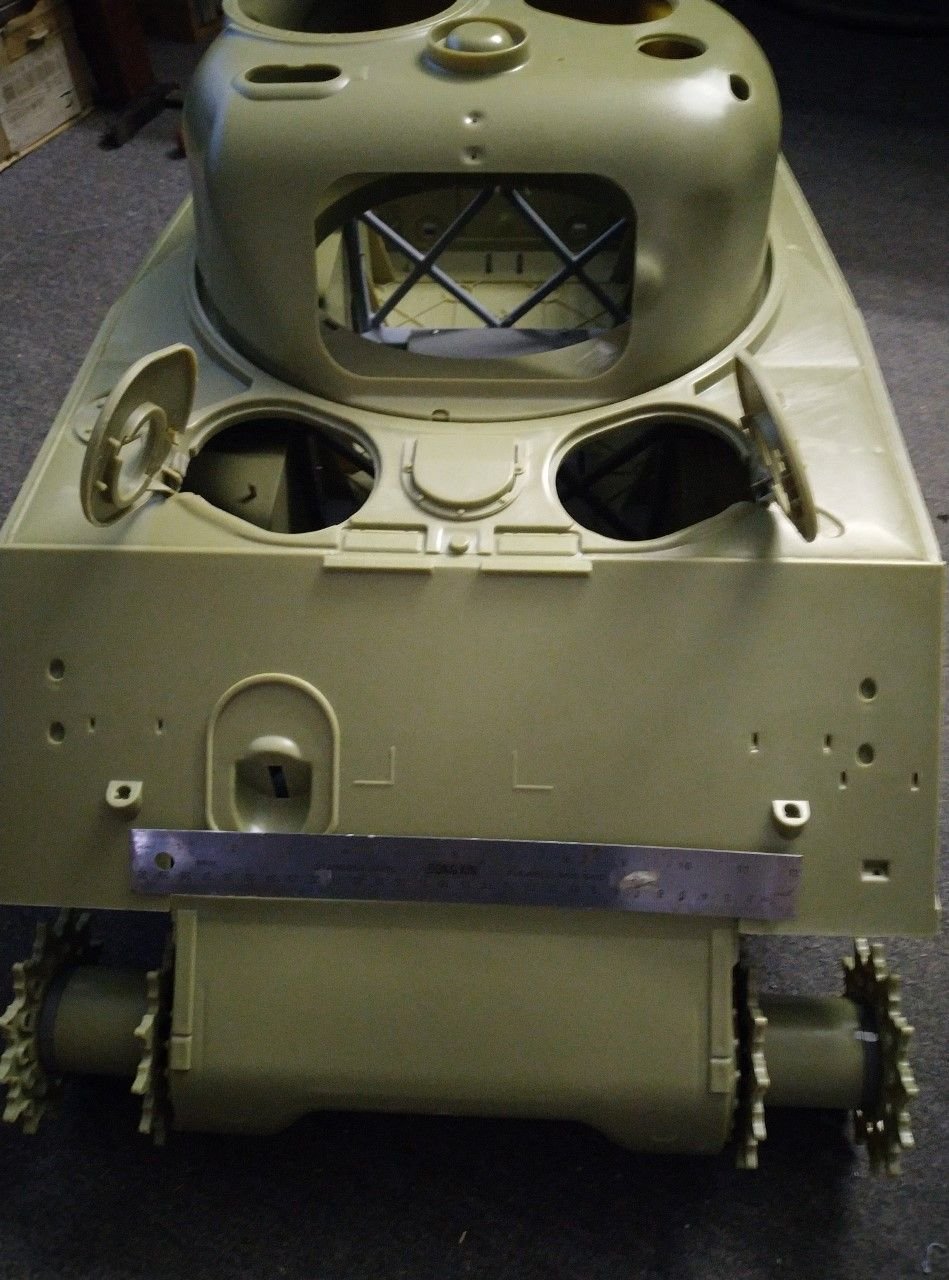

Hatches up .
Hatches down .

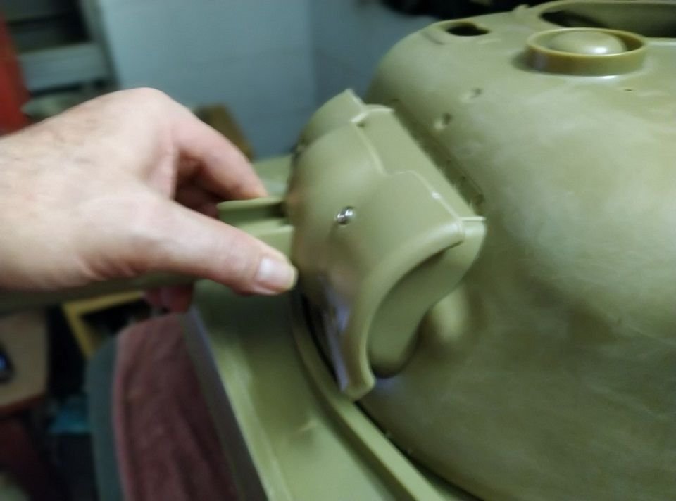

My first effort at fillet weld lines .
Updated effort. I'll sand and fill in the welds with the dust then a heavy coat and I think those weld lines will look decent .
I've skipped way ahead of the first photo's as you can see I'll go back to the grind now .

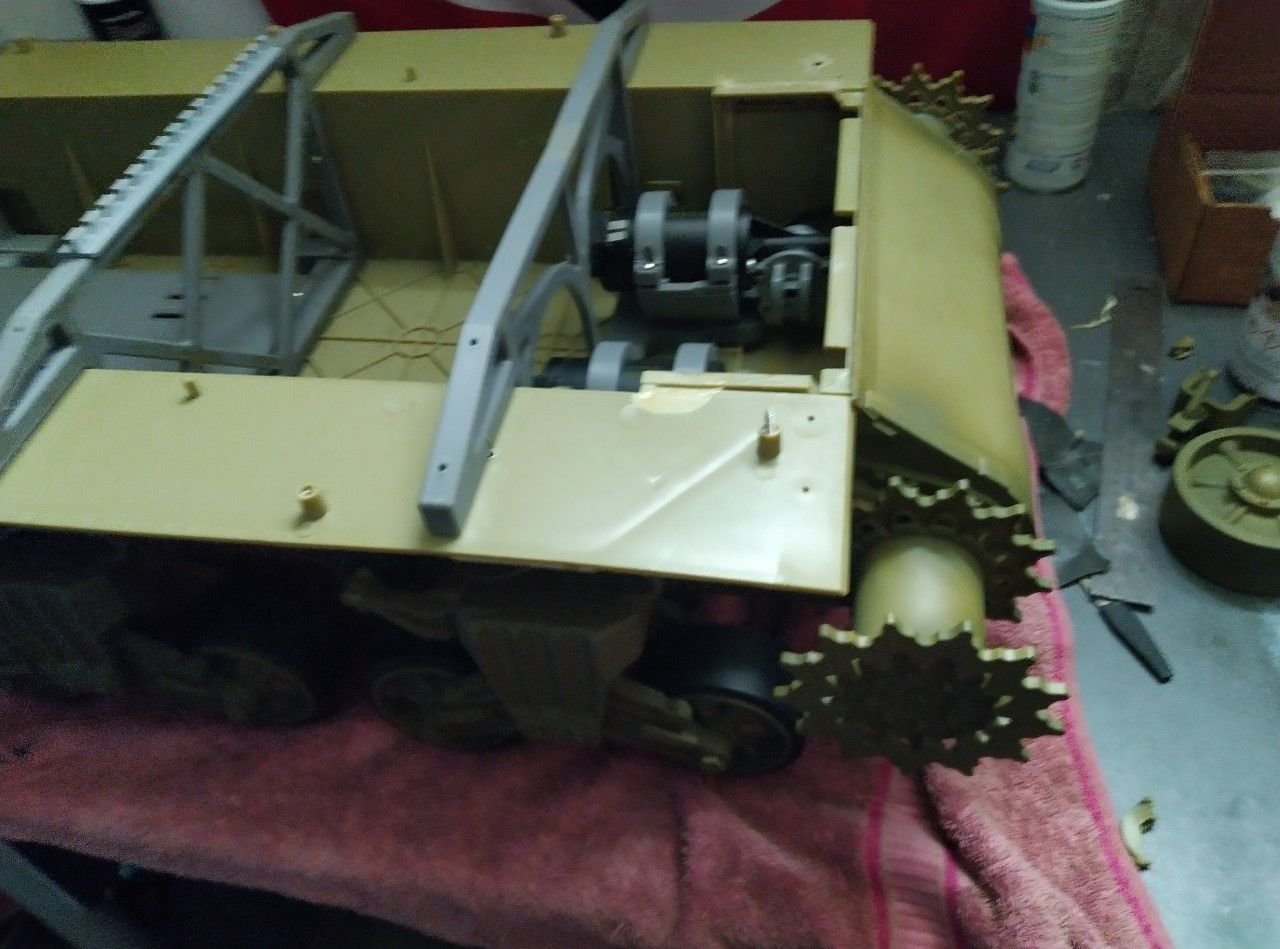

All the bits to a working bogey hanger .
First coat of all the suspension bits .This is the real color as my cheap ass mobile phone flash photo's wash out the olive drab a lot .
Most bits laid out for a photo op . Notice the wash out from the flash .
The finished product this X 6 . BBK soon .

I took this one to show the dark contrast against the upper hull , but failed badly as the sun came out .

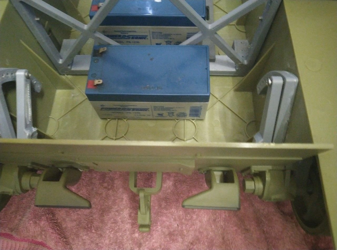

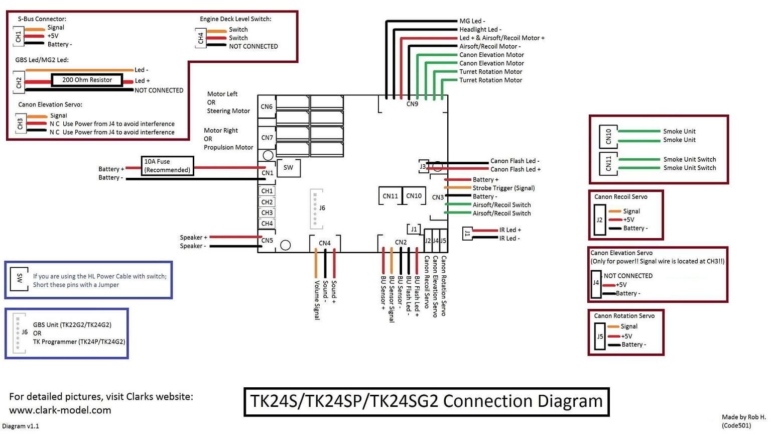

A pic of the Sabertooth 2X12 ,where it might end up is on this side of the frame work higher up in case it goes thru water .Crappy pictures I know but that little Sabertooth is a work of engineering art up close.The Sabertooth is like a BEC system as well as it feeds 5v back to the RX .I have an 8 Channel PWM PPM SBUS Signal Converter to split the SBUS to 2 PWM channels to the Sabertooth as it will only run that way as far as I know .
The 2 12V Lead acid batteries to drive the motors will go here somewhere to counterbalance the weight of the motors up front . A smoker, speaker and some other stuff has to live back here too ,so I'll do some lay ups soon .
The TK24S flow diagram I'll run this on 2 X 7.2 S2 2200mAh 35C LiPo's in parallel . I have a cannon smoker with flash and an engine smoker so I'll have to hotwire from the Taigen/Heng Long plug ins .Maybe from CN9 .What does the Engine Deck Level switch do ? Anyone ?

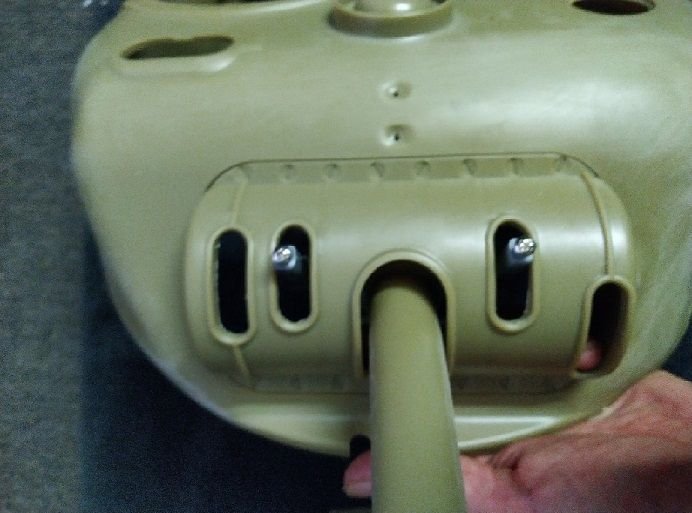

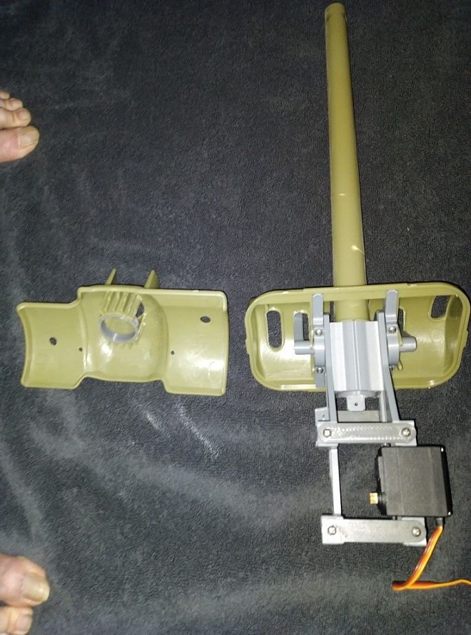

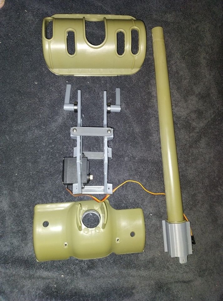

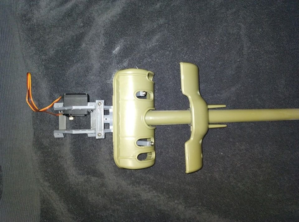

CHRONOLOGICALLY THIS IS THE FIRST BIT . Now without caps !
No 2 .
No 3 .
My bad the blurryness .
Last ,you get the idea . I have to pull it apart and sort out servo throw's, lock tite and the snugness/straightness of some of the bits. Cheers out .

The barrel and mantlet look really good, did you get those from Spyker?
Old 07-20-2022, 05:32 AM
Biasphere1
Join Date: Jun 2021
Posts: 50
Received 8 Likes on 6 Posts
No Crius they're stock Dragon parts.They'll take some work though, look at the barrel tip on pic 2 and you'll see a little underfill near the tip/muzzle .I'll have to fill that and a few other bits in. There's indents on the turret too I'll fill as well.

Got a Q here
I have the board delivered with this yellow thing in the SW port , well half of that thing I think the top half maybe the removal tool (I don't have) . So yea why is it like this I guess Kenny from DAKRCTANK sent it like this for a reason but I don't know why . The Clark site says this "HL tank already have power switch on battery cable path, so additional switch is no longer required, just to short pins in this port by jumper or connect to a switch cable and keep it switched on". So does that mean keep it plugged in ?
I can get most everything to work so I think it means keep it in .

That is a shorting jumper, it's intent is to short two header pins together.

Clark designed it as a port for a switch to turn the board on and off, but most people have one main battery switch to turn the entire tank on so it's not needed. Therefore they put a jumper in the socket to make sure the board would come on when the battery voltage is applied using the main tank switch.
