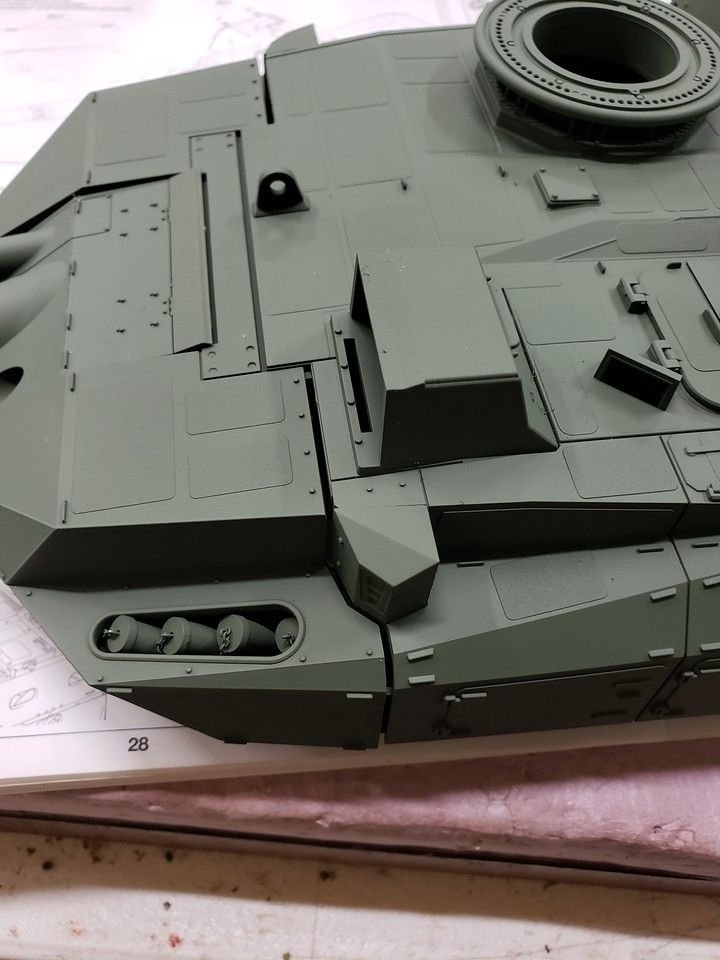

While most of the assembly has gone along swimmingly, I ran into an issue last night. Installed the cannon onto the turret lower, and then went to install the front, upper piece of the turret. Let me tell you now, I would rather have left the mantlet off and slid it on afterwards. Anyway, after some wrangling and cursing I managed to get it down and into place, only to find that it dosen't sit flush on the lower piece of the turret. There are gaps at the front. Then, just to get an idea of the whole thing, I slid the turret rear portion on as well. It doesn't fit, either. Well, not well. Not what I'd expect from Tamiya. Pics below. Ideas appreciated..
It's not screwed down in this picture, but IMHO it shouldn't need screws to hold it in contact. I've checked for stray wires/etc, I don't see any points of interference anywhere. I should mention that if I try with the gun not installed, it sits nice and flush.
The rear of the removable part of the turret is flush against the back of the turret bottom. Everything else appears to be lined up correctly.

Mine is not quite perfect either, honestly the front nose of the turret and main gun mantlet was the only tricky part of the entire build, I did what I could to get it as close as possible.

Being familiar with the Gun Elevation System from my L2A7+ it looks like gluing the Top Front to the Bottom to close the gaps is not an option as otherwise servicing the GES becomes impossible as the top barres access to the screws holding the sintered bearings.
My best guess into solving that problem would be to firmly tape the parts together for the gaps to close under the tapes tension and then dunk the entire front section into hot ( not boiling! ) water causing the stress to be relieved.
If that is not enough then you may have to disassemble them again and ever so slightly "overbend" them ( again with hot water ) so they'll relax into a position where they're naturally closing the gap.
As for the huge gap between the Front and Rear Section... Is that with the in Step 49 mentioned Mechanism Deck ( MD ) and all the Magnets on it and the removable Rear Section present?
Is the MD properly installed? As in the protrusions coming from the lower Turret Section going into the cavities of the MD being properly seated?
Can you show us a picture where the bottom of the still detached turret with both the all-around seam between the top and bottom and the gap between the front and rear are present at the same time?

So now I'm wondering if I don't need to adjust the screws, in the top turret section, that serve as attachment points for the magnets. That might get rid of some of the gap, and I note that the turret top doesn't sit flat on the platform. So I'll play with that and see what happens. When I feel up to getting out to the shop, that is... picked up a case of the Covid and it's got me a little undermotivated to do stuff...

So I played with the 4 screws, on the bottom of the turret top, that actually mate to the magnets on the turret lower. Fit is much better... much, much better. I kind of figured it would be something stupid like that... now I'm going to let it sit here on the bookshelf for a week or two while I decide what to do about camo... not that there are many options in that department.

Good to see you managed to close the Gap - Would have been really surprised to see Tamiya pull such a mistake 😁
