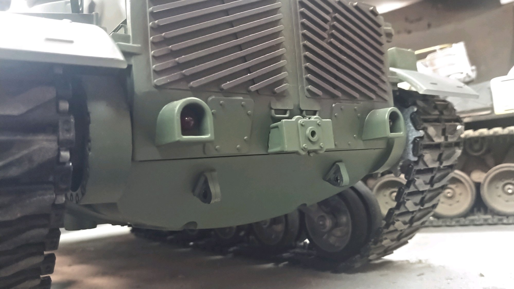

I also cut the tow hooks off the rear towing lugs before I mounted them to the hull and cut down the front lugs to match the size of the front lugs on my DKLM OKMO M60 and drilled the appropriate holes in them.
Finally I mixed my own Olive Drab paint color FS 24087. While AK and others make an OD named 34087 (flat) its actually closer to the WWII color which is probably from the 1980s update of the militarys color reorganization where they changed the olive drab color and numbers around. But 1950s/60s OD in the Army was a dark semi gloss finish and it varied between two color shades. One was more on the green side and the other was more on the brown side. So I just matched the color of 24087 I used on my Willys Army Jeep of the era. Tamiya orange and black mixed 2/1 which is 66% / 33%. If a lighter color is desired a 70/30 mix can done but 75/25 makes it lighter and closer to what you think of as WWII Od.

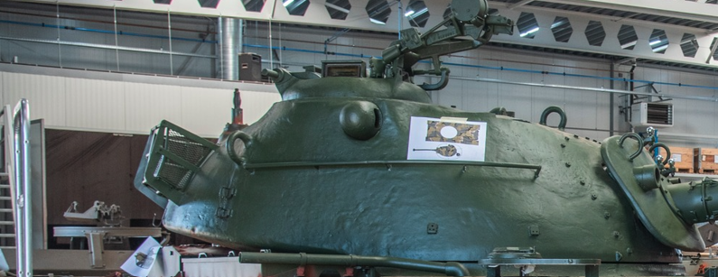

As introduced in 1960 it utilized the same turret as the M48a2 but had a 105mm gun fitted.
Hi Rich
I was surprised to see this statement. The M48 turret is similar to the M60 'Slick' turret, but definitely not the same.
The M60 turret is squarer at the rear upper.
M60 Slick turret rear
M48A5 Turret rear upper
M48A5 Turret rear upper - curved
Both photos of the M48A5 are the same vehicle, Colour change due to lighting.
I figured you must have written that in haste?.

That looks like an original plain M48 turret you were comparing with. That has a lower shorter bustle.
The M48a2 and M48a3 had a higher slightly extended turret bustle than the original M48 had.
When the M60 came along they used the M48a2/a3 turret but installed a 105mm main gun and a new designed commanders cupola.
M48a3 tanks were a modification really of 48s and 48a2s. Some had 3 return rollers some had 5 I think. But when the M48a5 tanks were created by adding the 105mm gun much later on, they used all the m48 series so you really see a major mixed bag of them from one take to the next.
