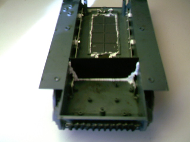

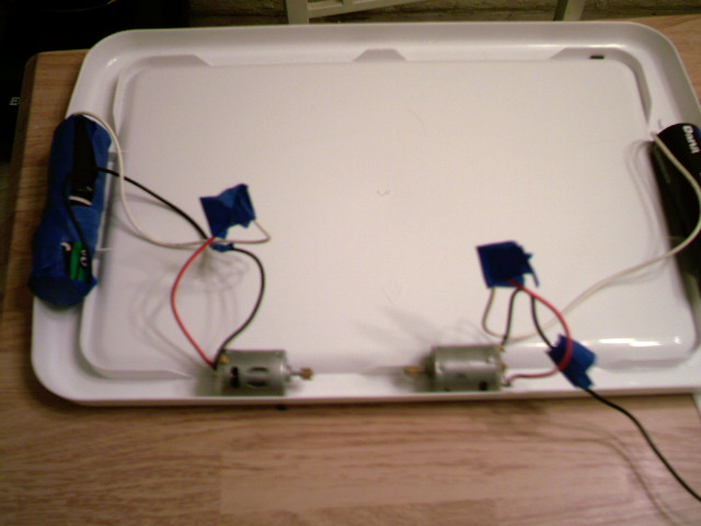

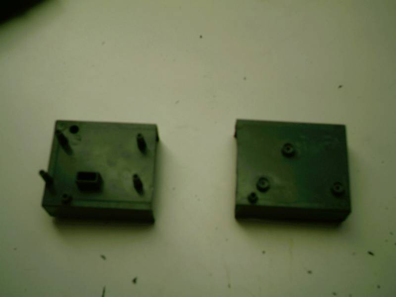

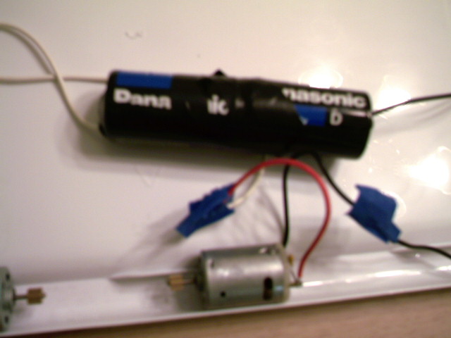

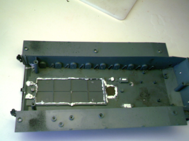

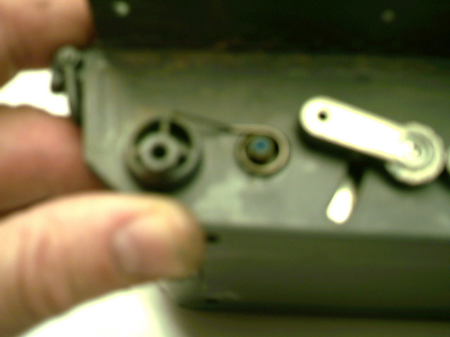

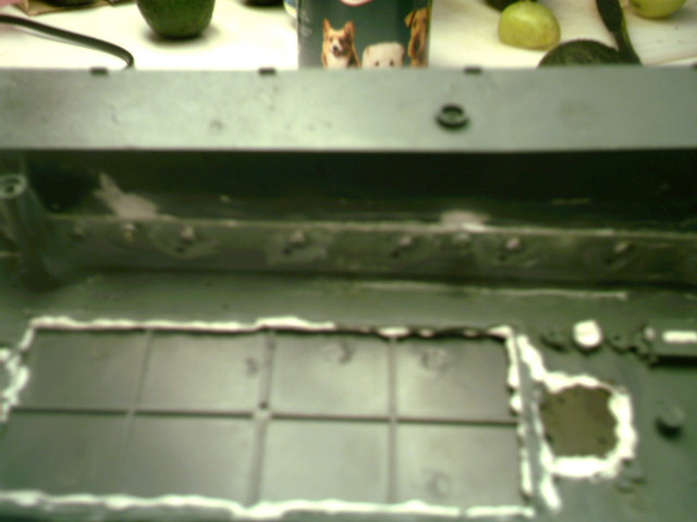

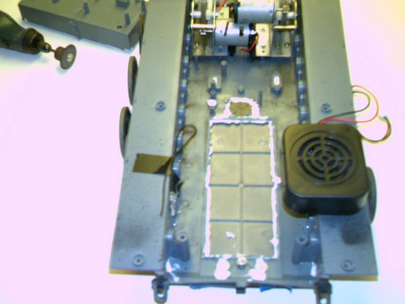

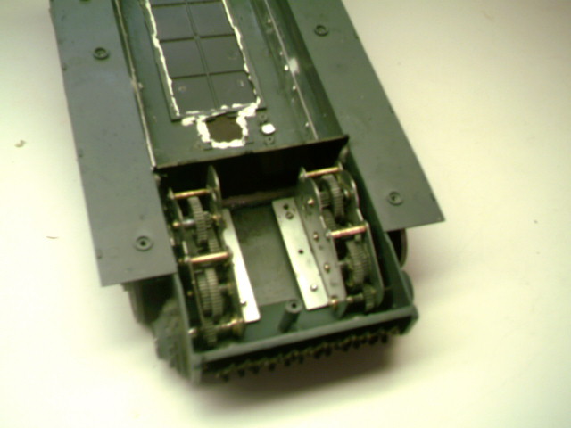

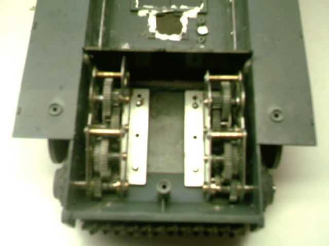

All,

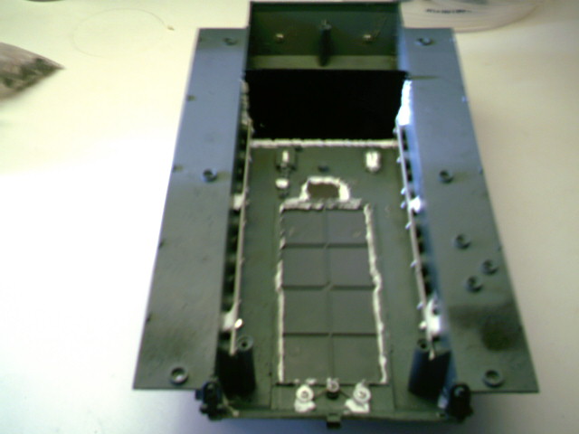

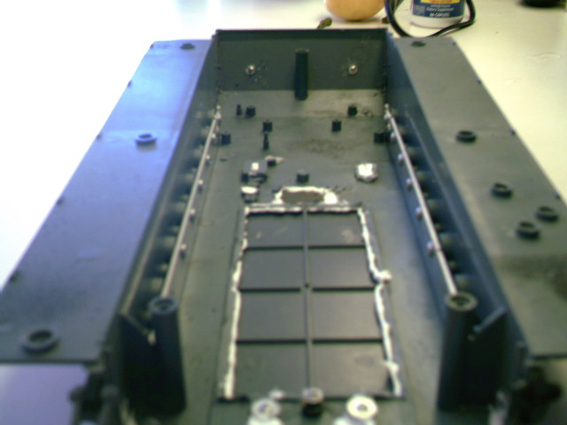

Well finally my first Tiger 1 modified metal and some corrections will be made! I think that I am about half way done! I took much from what I have seen and, I have put my own ideas on few things!
I cut out that battery compartment and will use it later to mount switches and possibly boards! The white stuff you see is called plastic weld, and it does that very well super strong and you can sand it, and paint on it, that will come in handy later.
The Blitz

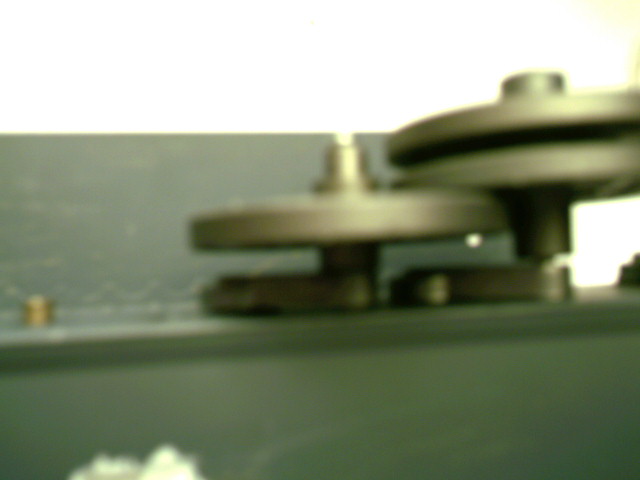

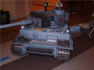

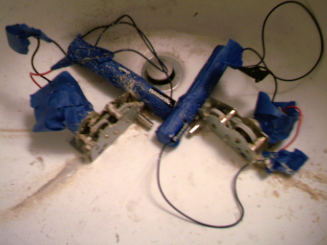

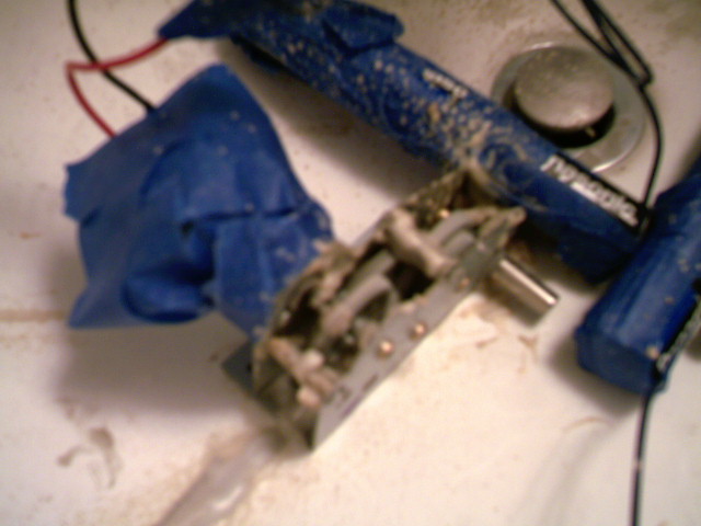

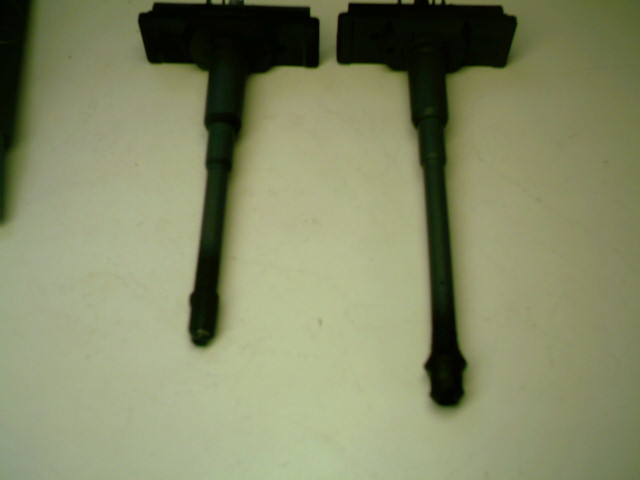

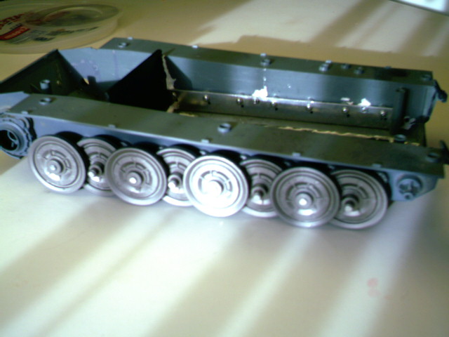

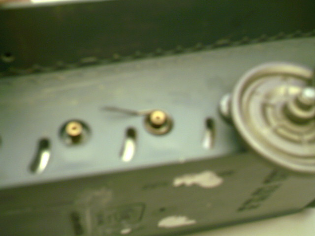

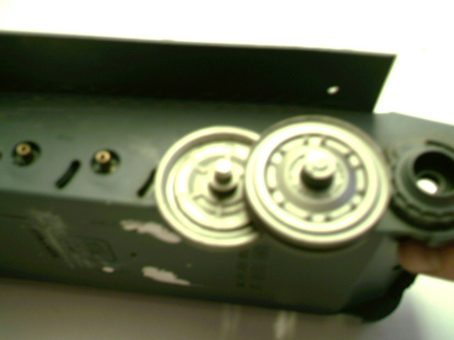

At least one New guy has asked if breaking in the motors and gears is necessary? Well if you want about 20 percent more power out of your cheap motors, and you want your metal gears to roll as easy as your plastic ones did! Then Yes, IMO it is necessary, and easy to do, here are a few pics!
Then I go over the metal suspension steps by pictures and a few tips on that like shaving off about 3/8th inch from your roller wheel axels. to adding loctite to all your screw points!

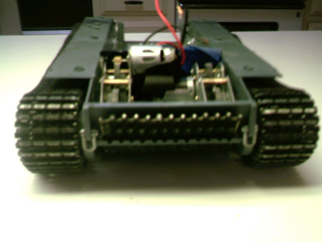

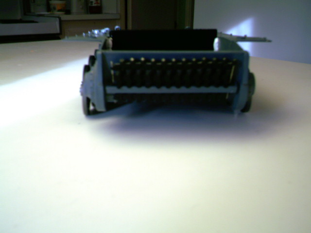

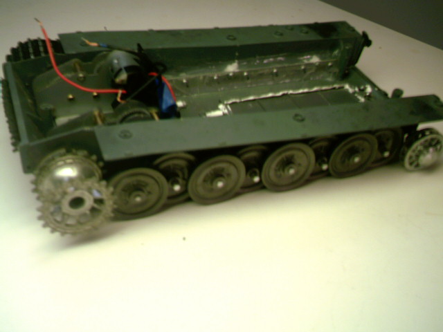

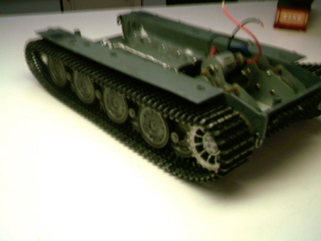

This next section I am still on the hull of the tank checking the stance, and movement of the metal roller wheels. I will be water proofing the hull with silicone, it is a tank it must be able to go through at least 3 inches of water, IMO! I want to make sure that my fire wall between the engine compartment and the crew is not only stable but not going to hamper the engines in any way, at the same time adding strength to the hull as a chassis cross member!
The Blitz

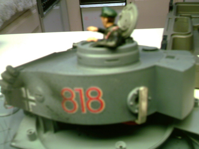

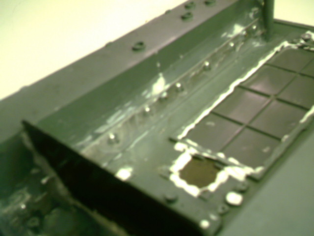

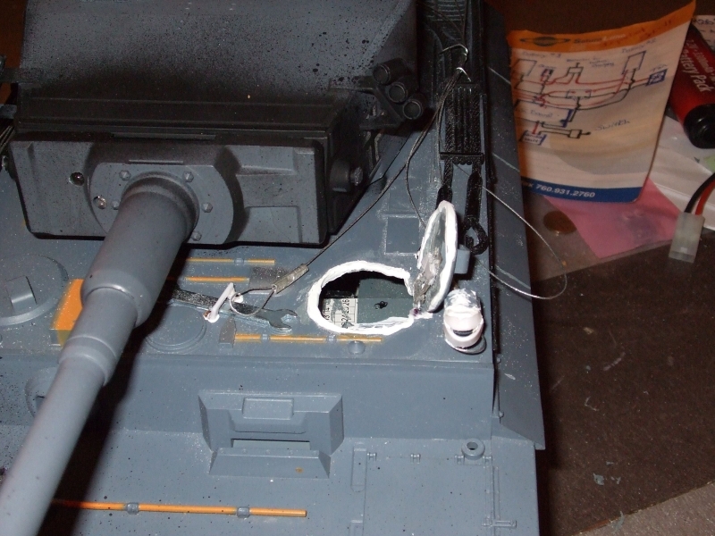

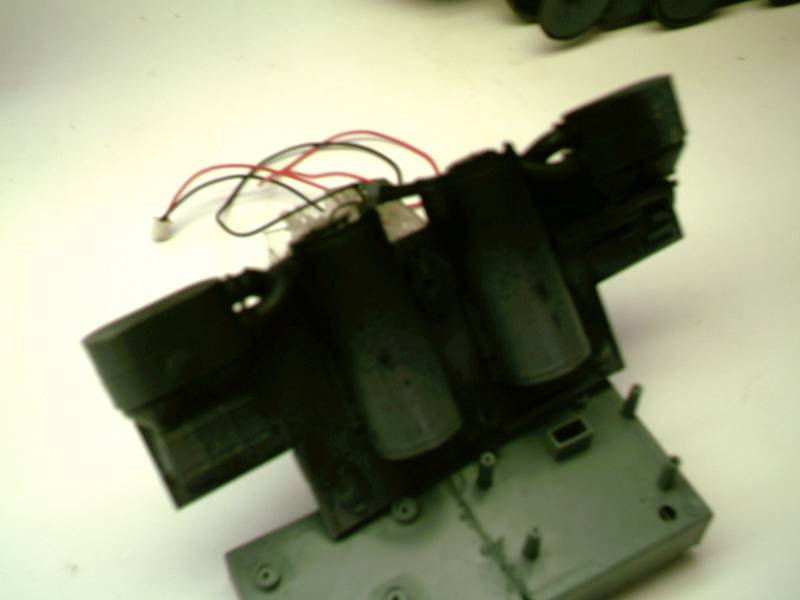

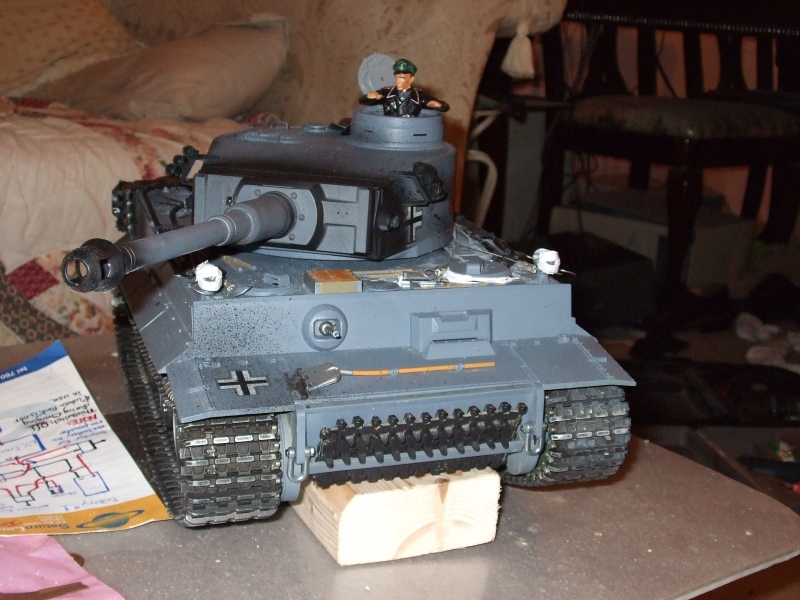

Next are some pics of some of the standard corrections plus my version of the Super Gun ( Super Bright Yellow LED for the Muzzle Flash)!
The Blitz

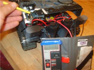

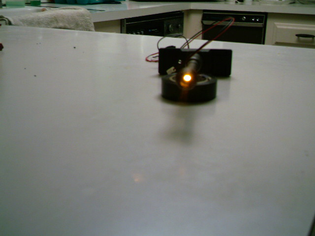

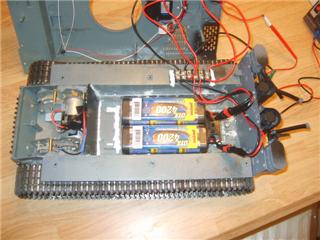

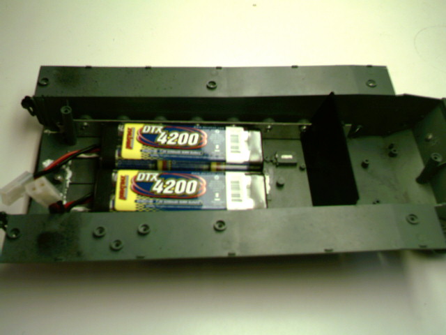

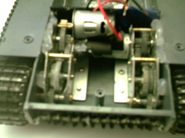

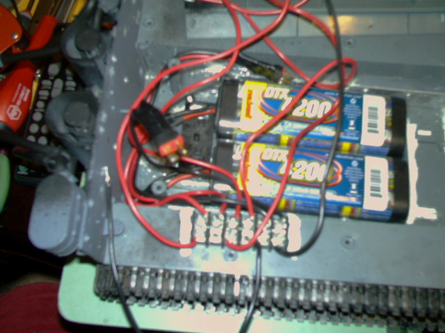

Its time to post another update!
I have wired up the two batteries, using W.S. Dean connectors! I am installing a single charge port for the two batteries! I have a mini switchboard designed to select either battery for charge or either battery for use as the tanks power! I am using a 3-pole switch to initiate the charge port and select one battery at a time to be charged! I am also using the Heng Long on/off switch as overall power kill, and a separate 3 pole switch that will select which battery will be initiated to power the tank, the middle pole on this switch is also an off switch! This is kind of over kill, but at the same time if I get in a hurry at a battle, I don’t want to plug the charge port in by mistake when the power is still on going to the tanks, ESC board!

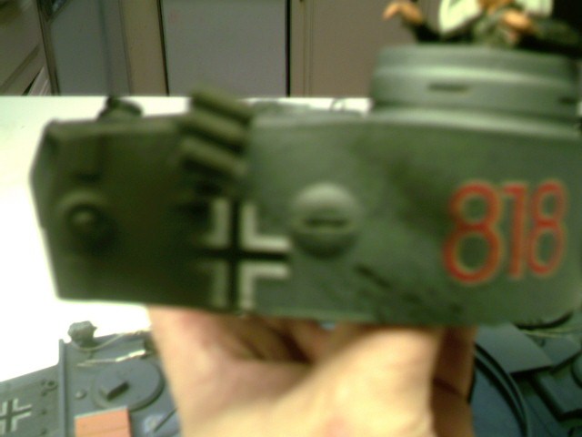

I have a few pictures of the head light covers that I have crafted myself along with the hatch, it looks rough now but after it gets painted its not too bad, that comes later! The tank is coming together, I am still deciding on what ESC board is going to run this tank??
the Blitz[sm=shades_smile.gif]

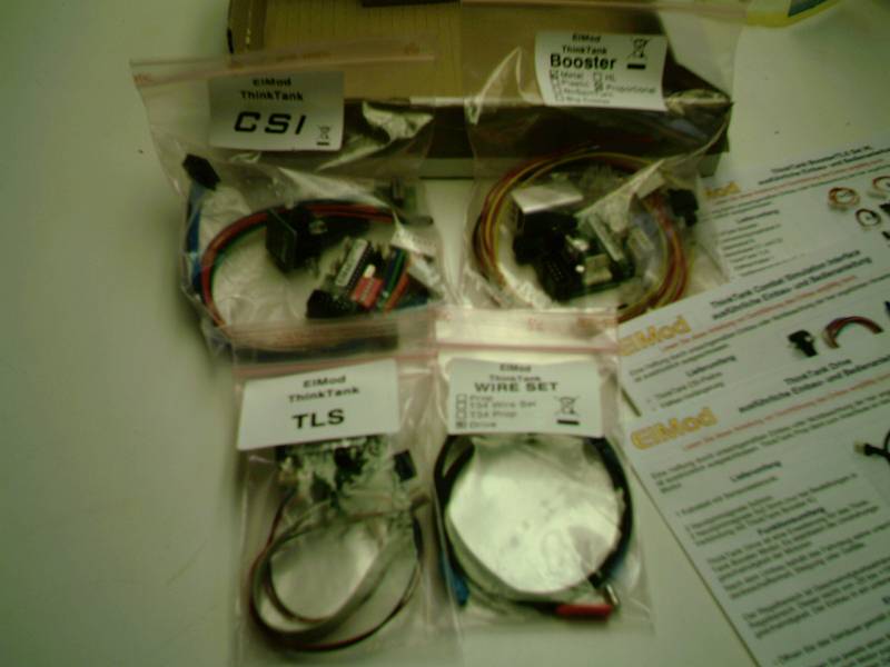

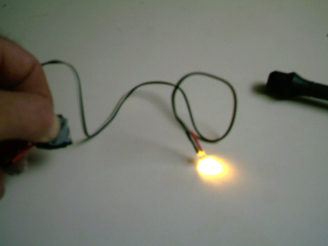

EL MOD UPdate! I got it working but combined with the Heng Long boards, I still have no idea how it interfaces with the Specktrum radio and receiver and i tried everything! After reading through the manuals again I believe that I will need the Prop 6 setup, I am slowly getting their lingo down and understanding what does what! What I did was use EL Mods Think Tank Booster K/M setup and at 11:45 pm it rolled back and forth on the carpet, finally LOL I am charging the batteries fully, and well see how well this beast will run, it sure is Heavy!
the Blitz

The el-mod gear is great, but the instructions are clear on the simple things and obscure on the less-obvious bits. Pretty much unbreakable though!
Yes, Wacky the product is well Engineered, and the neat thing is its potential to go far beyond Tamiya electronics as far as realism in the tank! If I sound critical at times, it is only becuase I want to see this product succeed! Other then being a little pricey, (But you GET what you pay for, and a hole lot more) we just need to simplifiy it, and that can be done!

I'm still waiting on my El-Mod complete upgrade to arrive(hopefully this week)
Then the whole business gets installed in my Elephant(H) conversion.
My El-Mod system was installed in my HL Jagdpanther conversion, but because the Jagdpanther was so heavy(10lbs), it wouldn't turn well or climb(which is why the upgrade).
And my setup is the prop version for use without the HL boards.
I thought the sound from the El-Mod was just fantastic.

Here are a few more photos for the Techs out there, and I have a shot or two of the hatch and lights painted! I think that they look better that way! The stock look of the HL Tiger 1 lights bugged me, but now I like them! Is it because I changed them and they seem more proportional to me or what do you guys/ gals think? I take can take some honest criticism!
